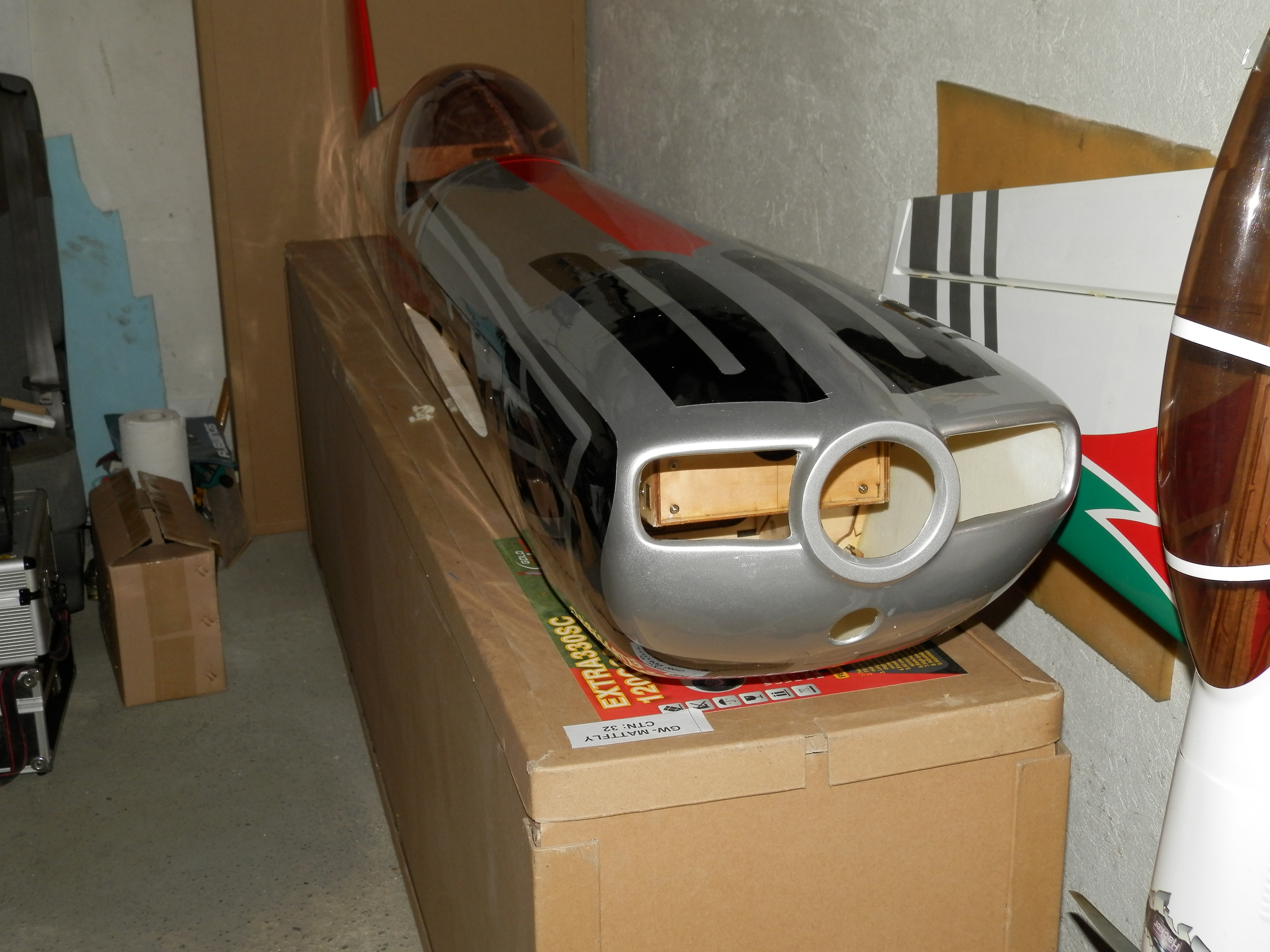

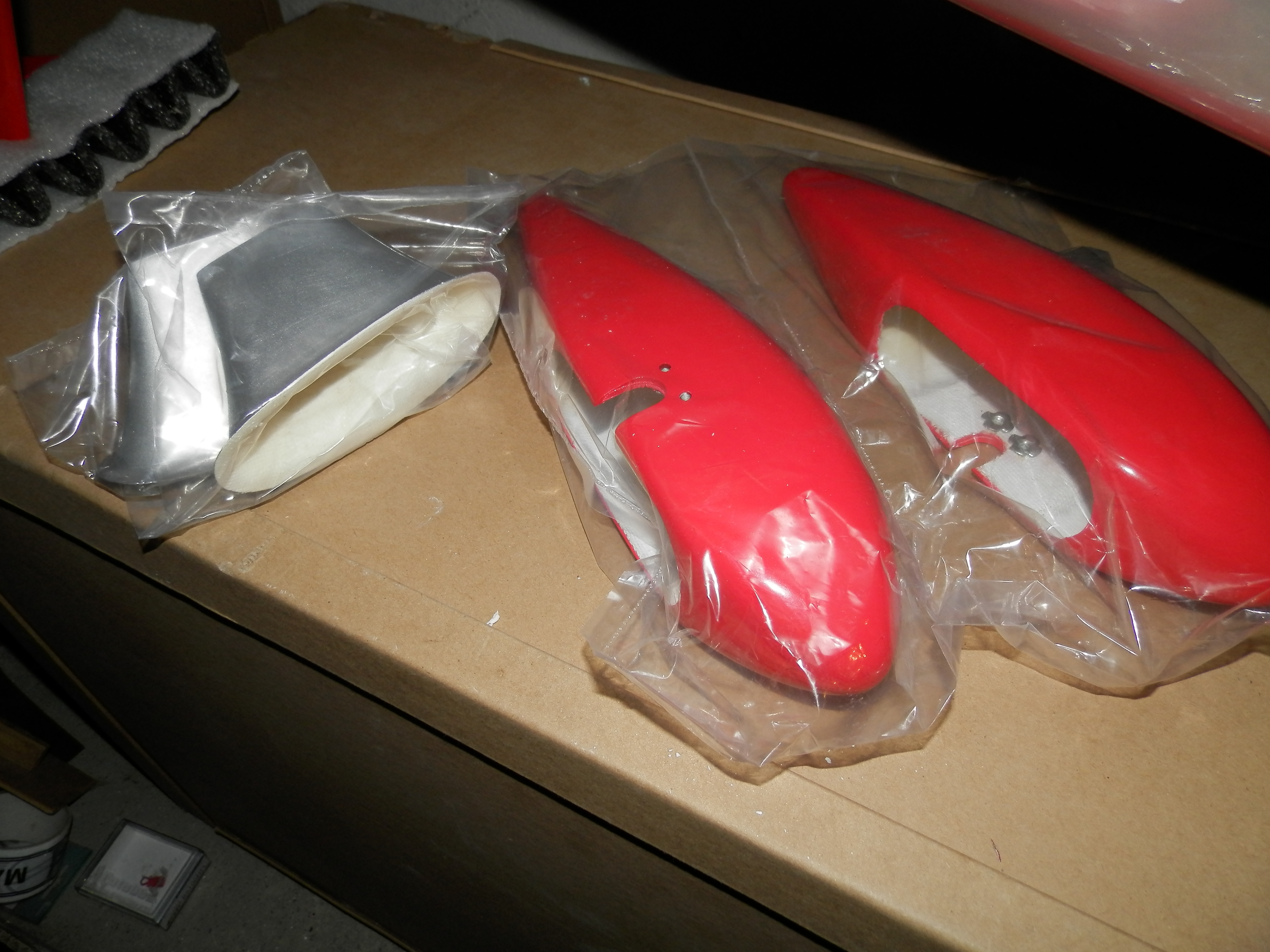

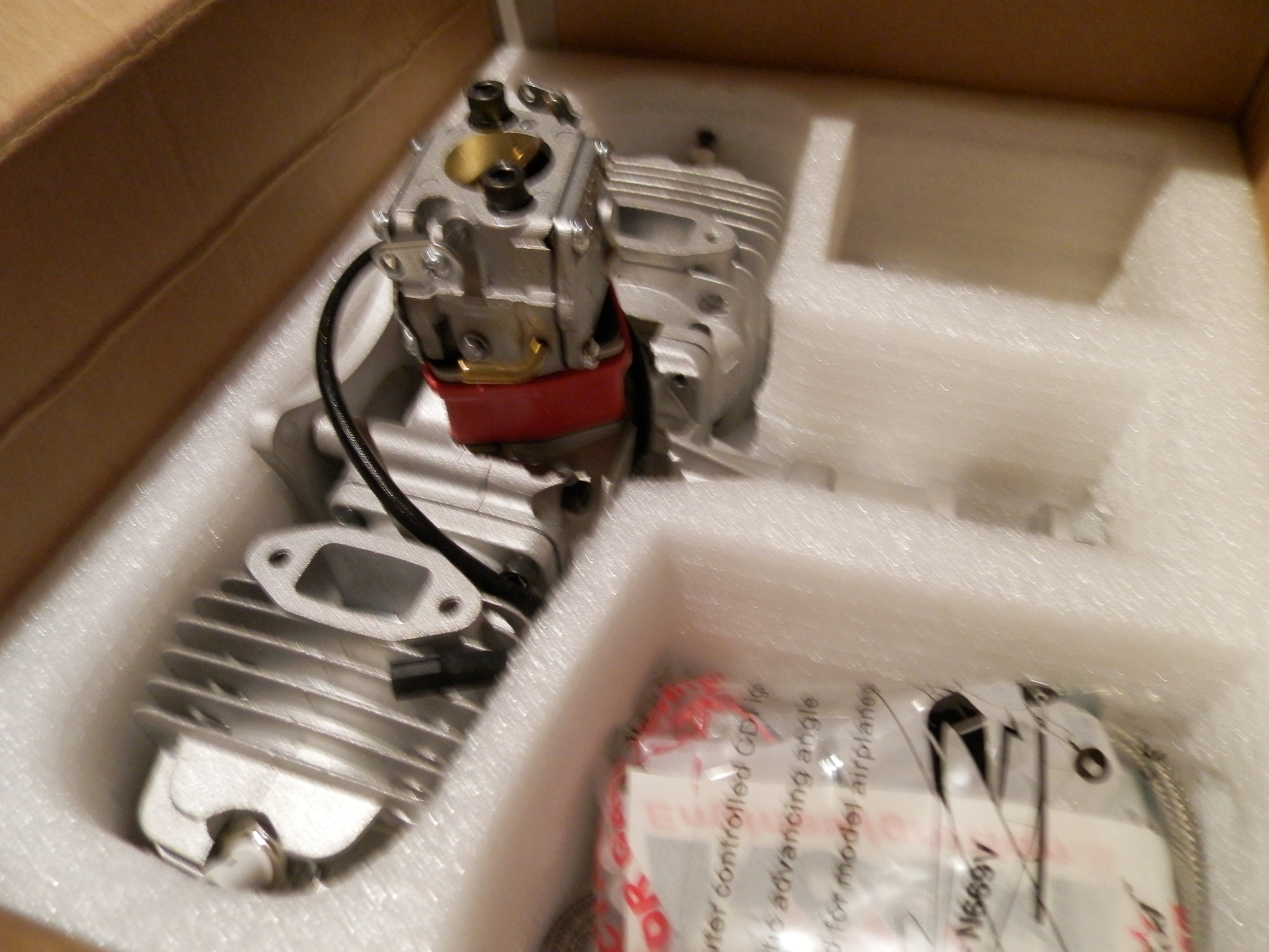

Hi everybody, I,ve just bought my new and firs 100cc plane :flyer:, the sturcture is really light and strong, the fuseagle and the ving are renforced with carbon and the firewall is renforced too wiht alluminium parts.
I will use the EME 120 with muffler because of the weight.
tomorrow i will start the cunstruction with the landing gear! :thumbup:

which engine will you be using in this plane?
I have bought the EME 120cc with the xoar 28x10?i hope it will have lots of power... for the other things of the set-up are for the electronic unit the ALEWINGS minimac adj and i have to choose the servos, maeby savox 1230SG Monster Torque Steel Gear Digital Servo
SnowDog
Sounds like a great setup!

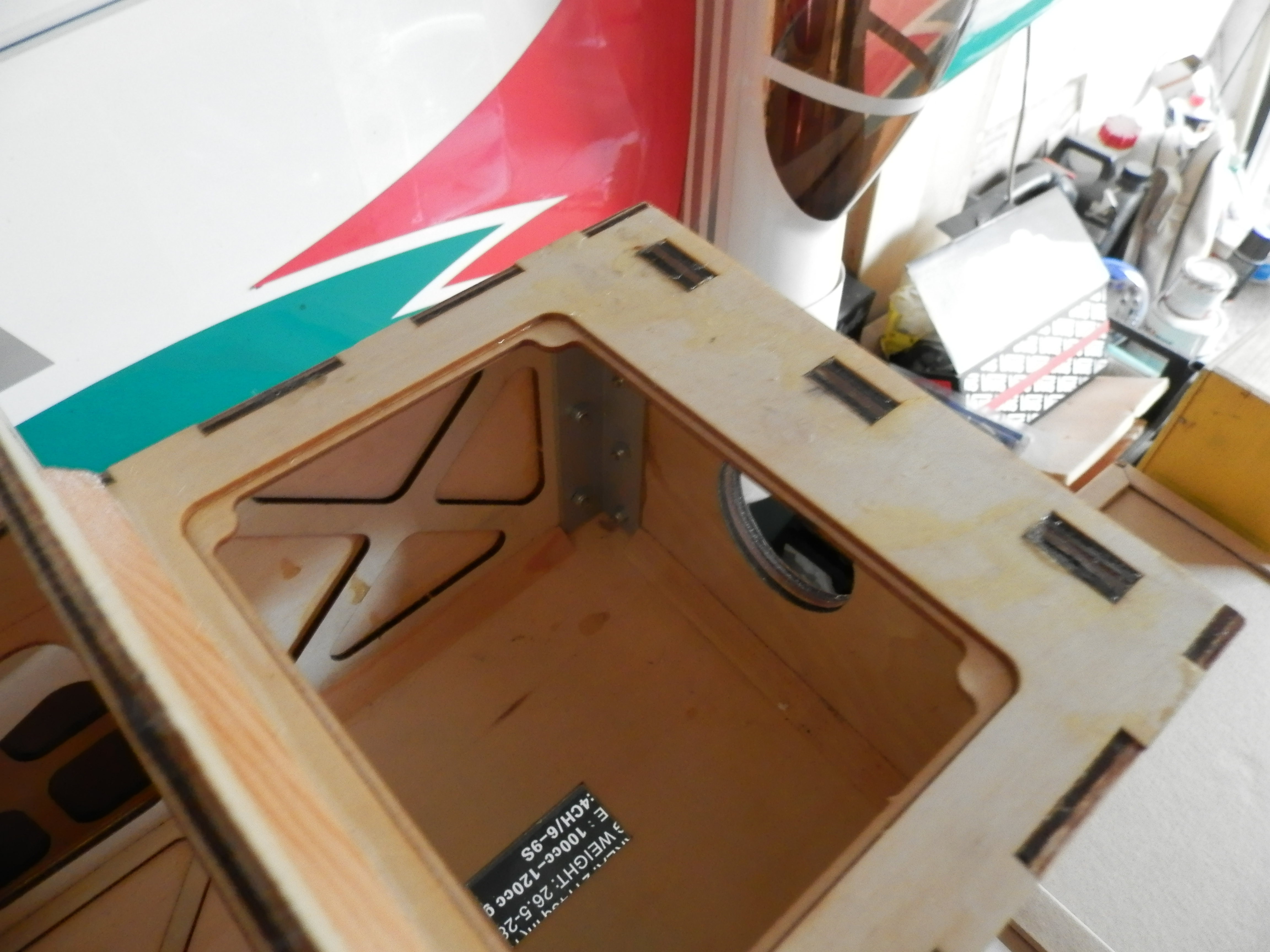

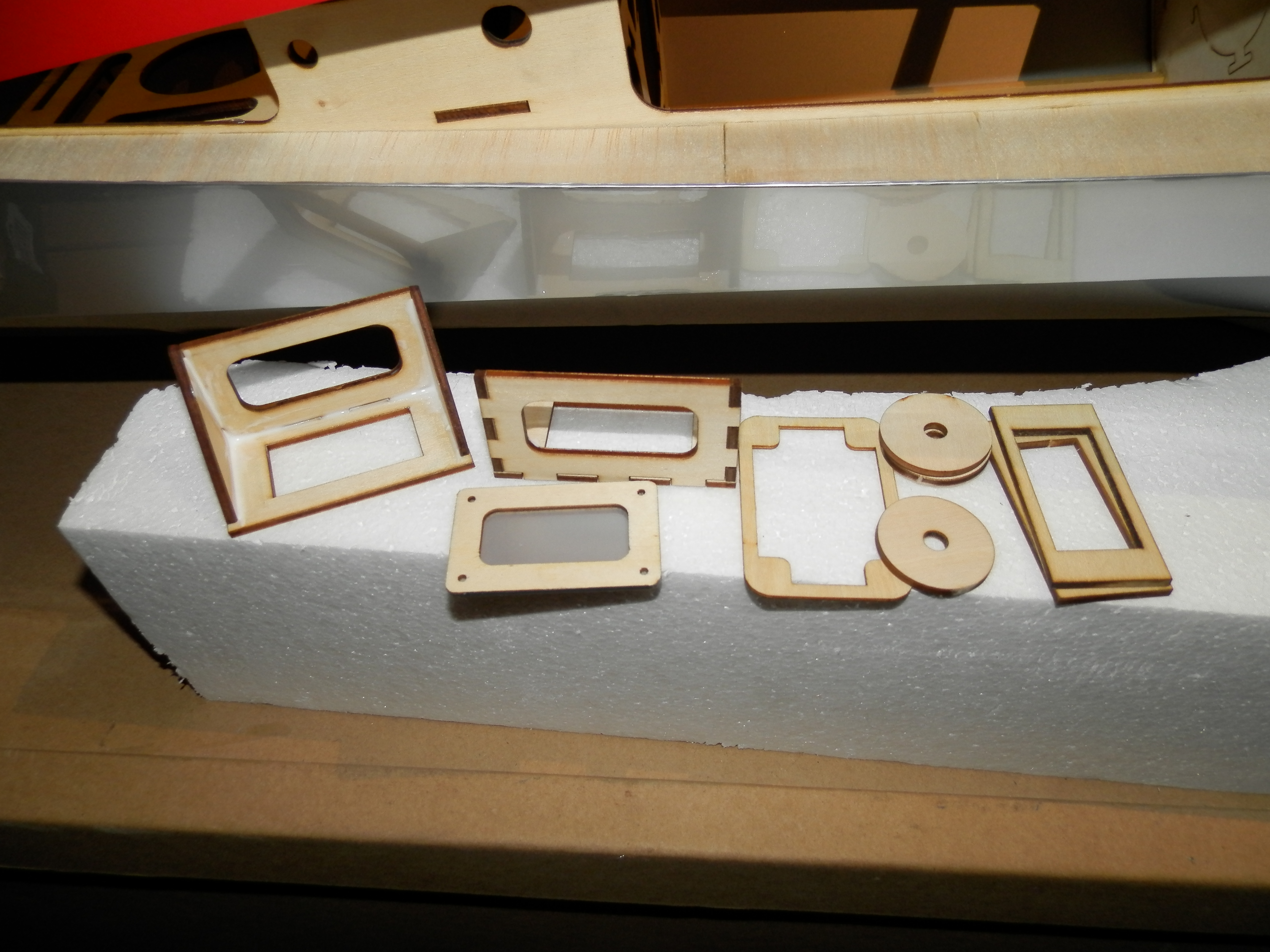

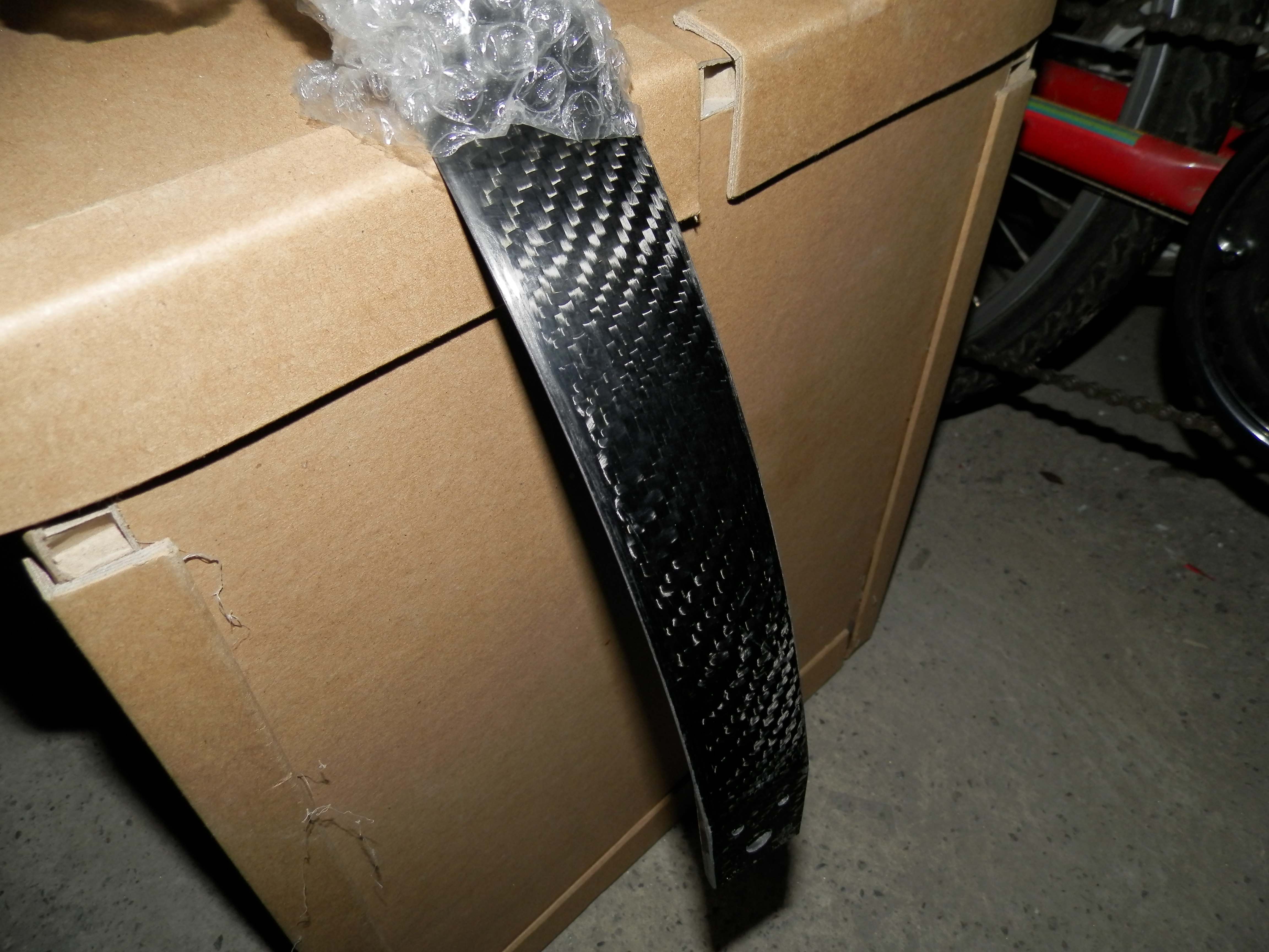

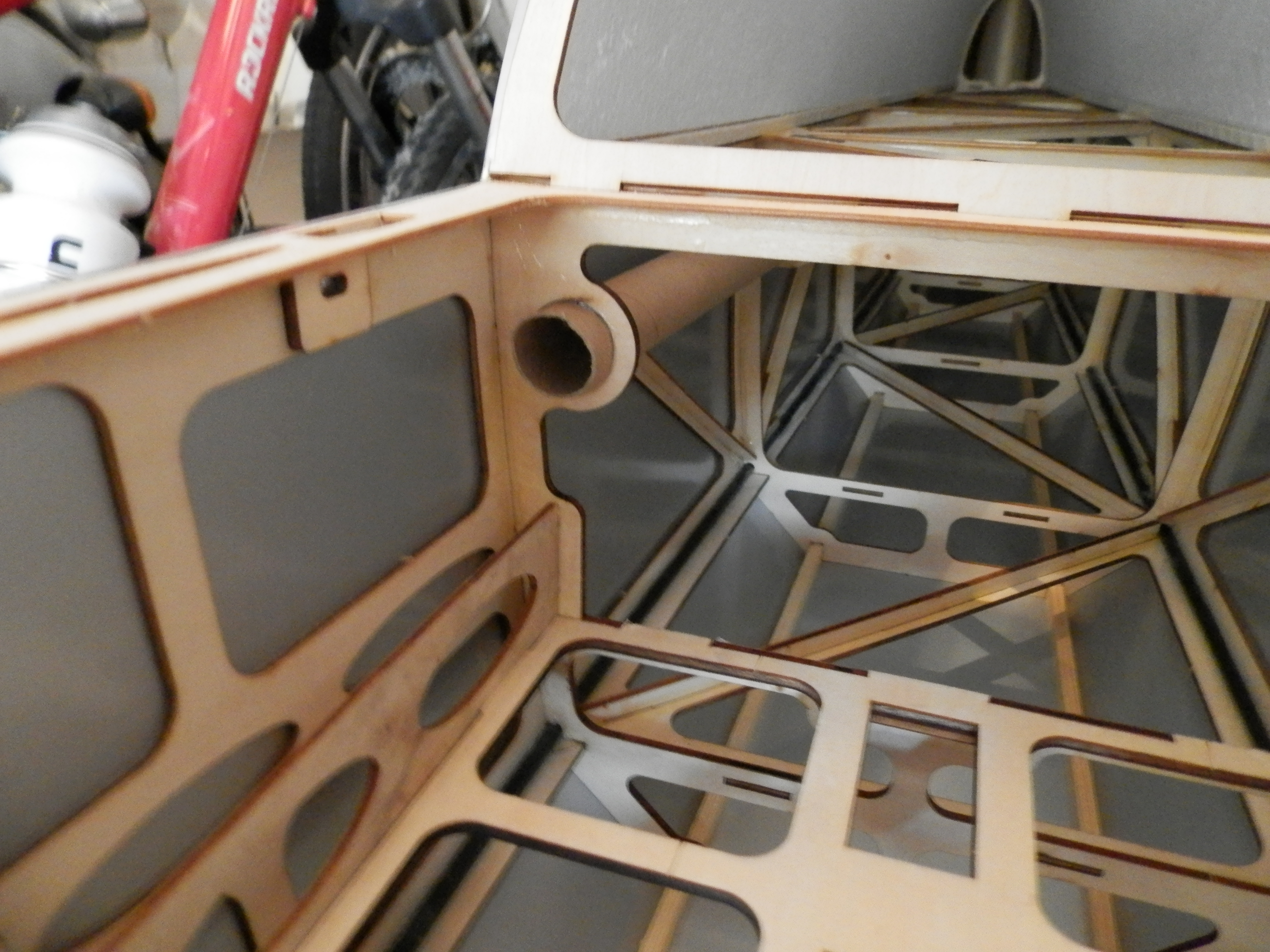

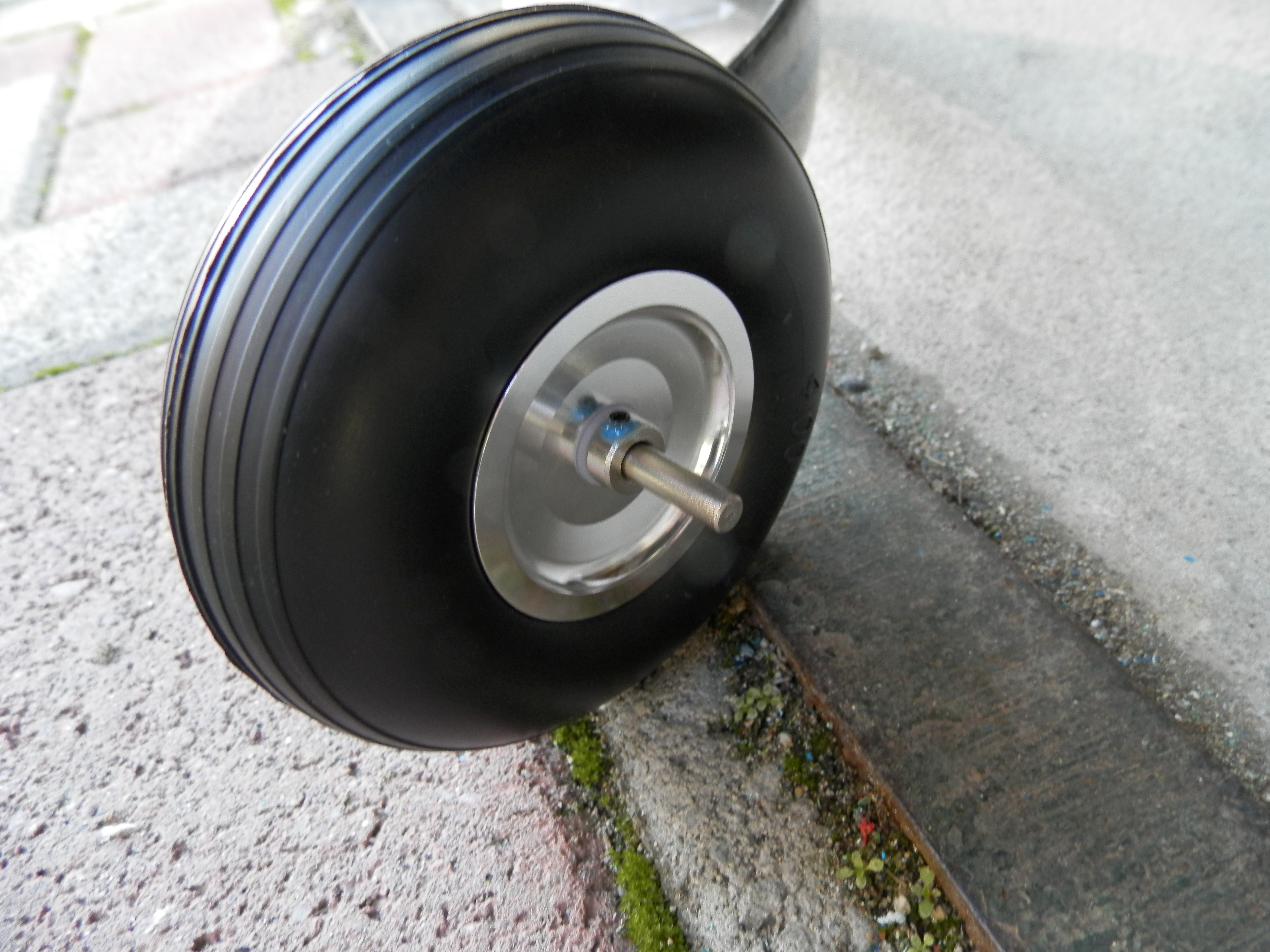

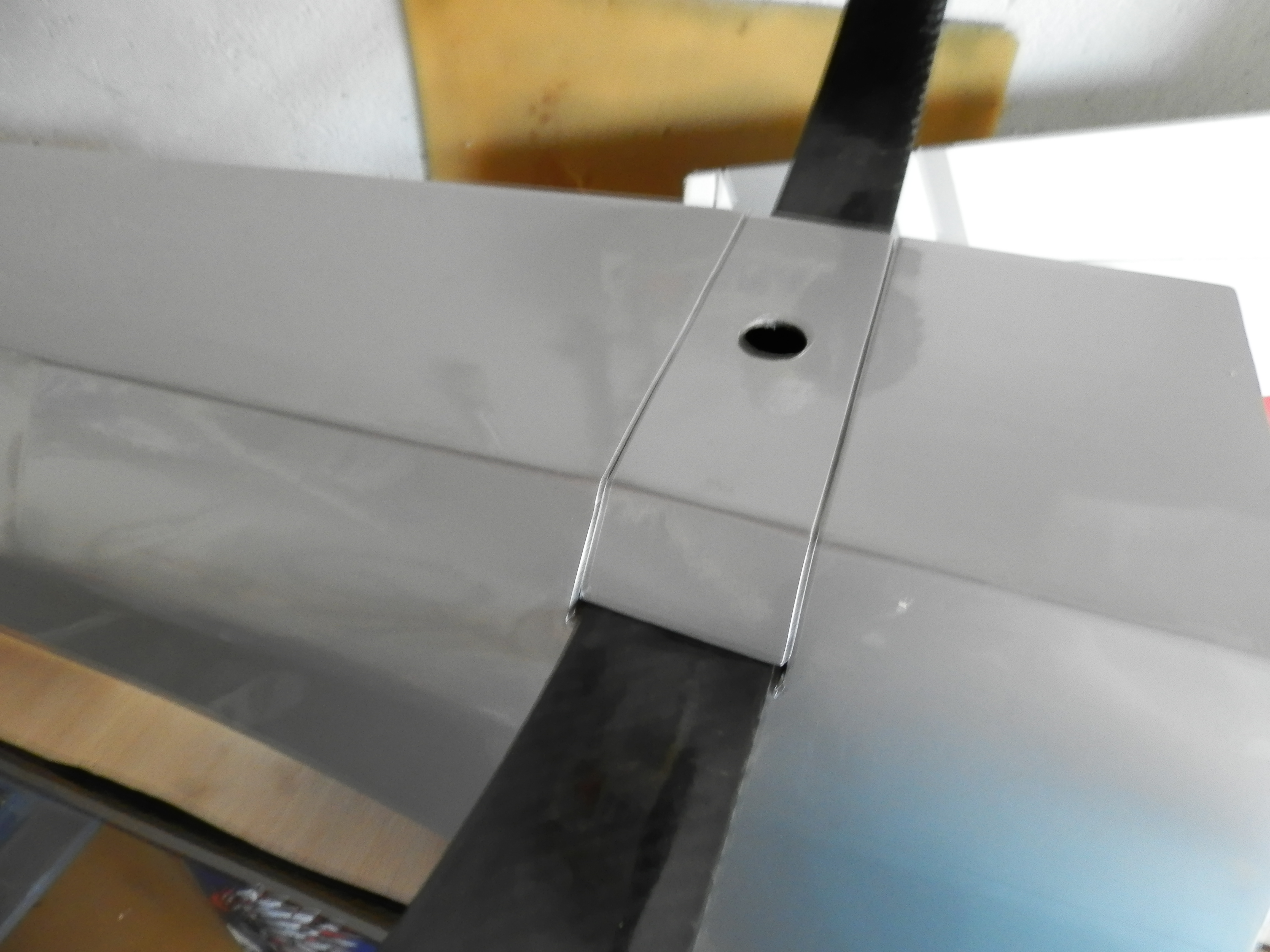

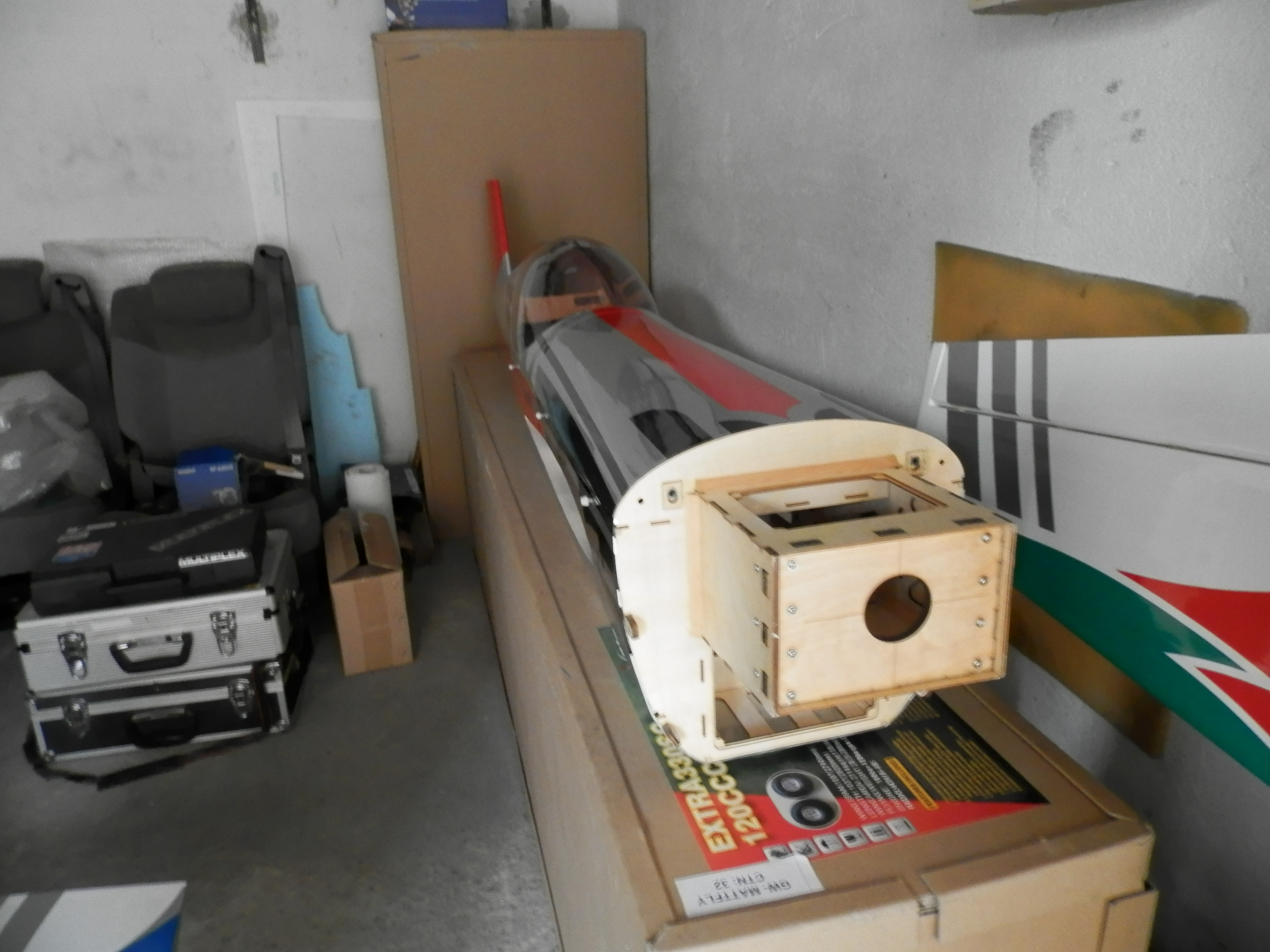

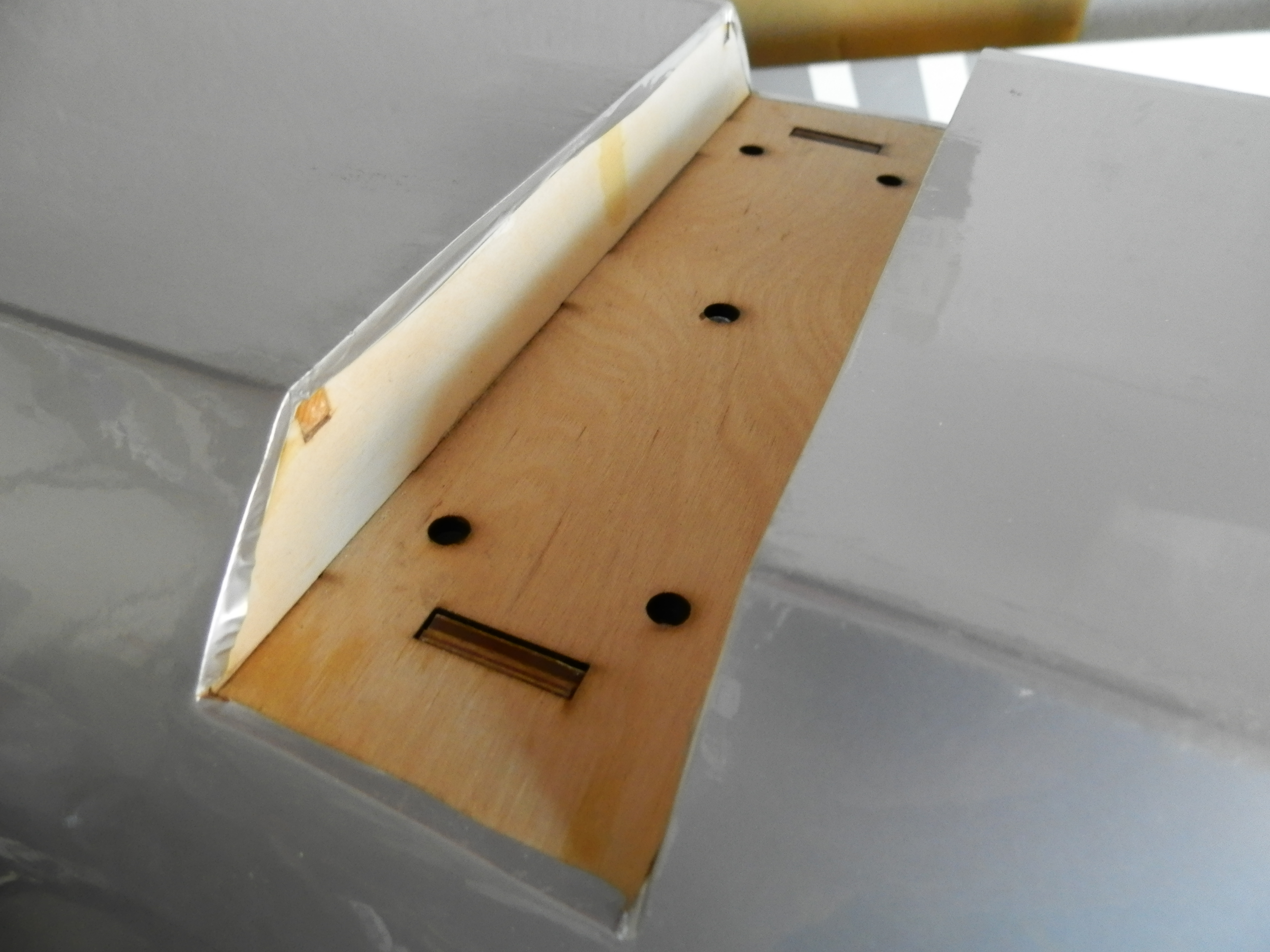

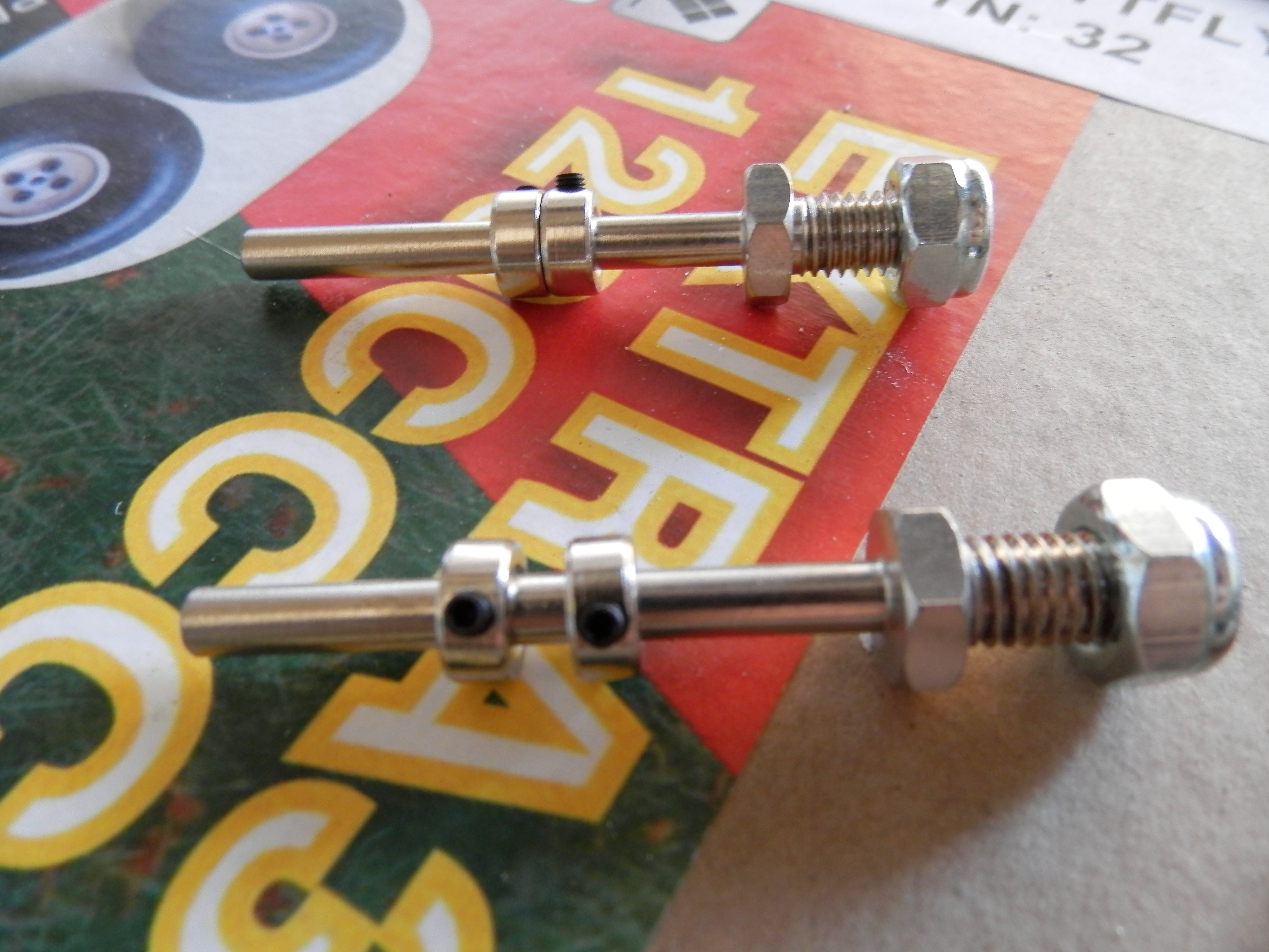

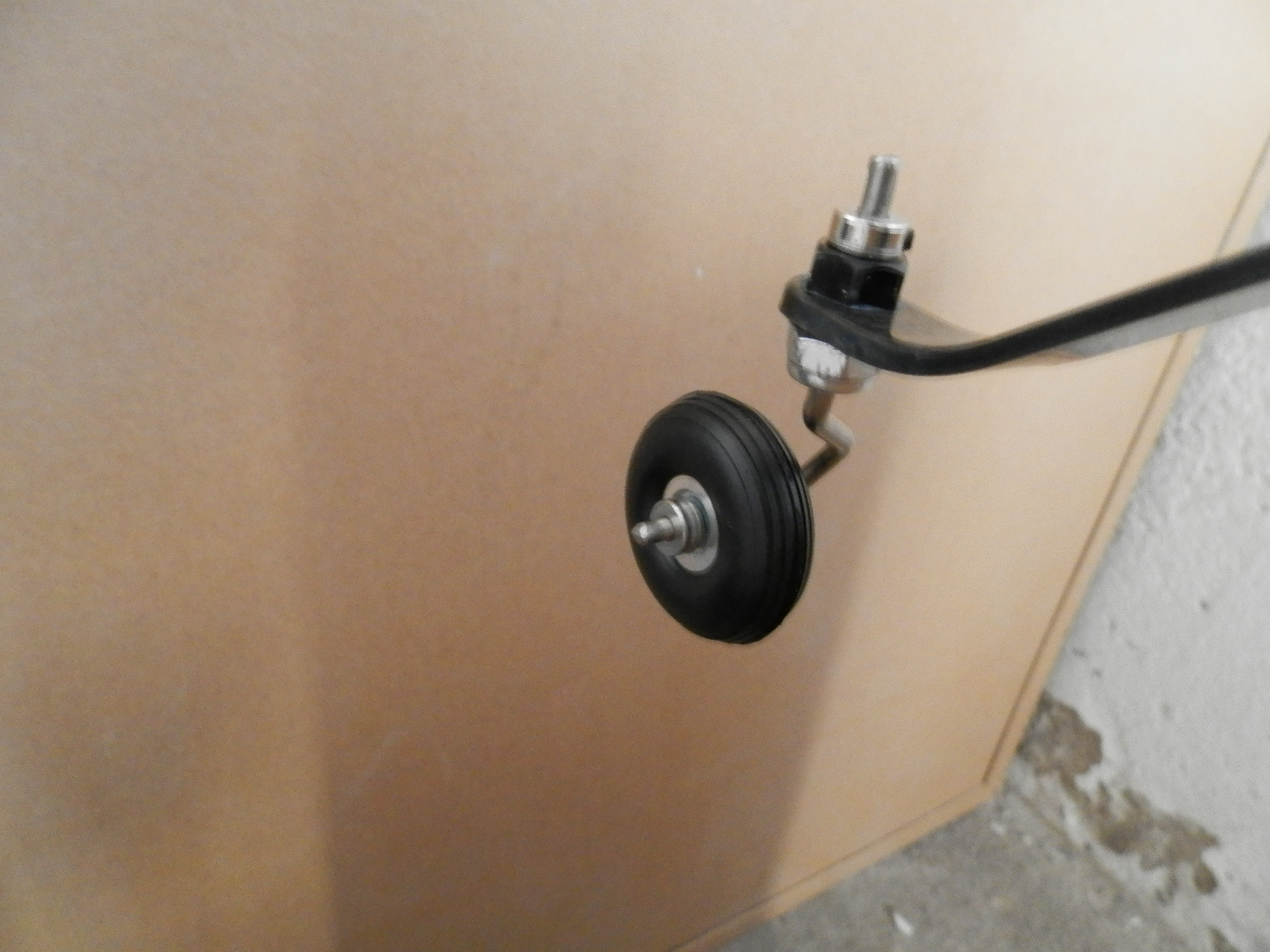

today i've started to assemble the landing gear, it is very stong! and the alluminium cnc cutted weell are amazing!th only things that is not beautiful is that isn't there a specific manual :facepalm: and i dont know what some wood parts are (photo down)

In the first picture, I think the triangular ones on the top left and directly adjacent to it are designed to allow you to secure one of them behind the firewall and then mount your throttle servo in the rectangular opening. There are other threads on this forum that show this type of setup. The rectangular ones on the far right look like servo "frames" which you might glue on the fuselage for the rudder and elevator servos (if mounting on tail of plane), or perhaps for the aileron servos. The round items are probably spacers for the firewall for mounting the engine at the correct offset, or more likely to use behind the firewall as washers for the bolts which secure the motor to the firewall, unless they supplied blind nuts for this purpose. Like you said, tough to know for sure without a manual!

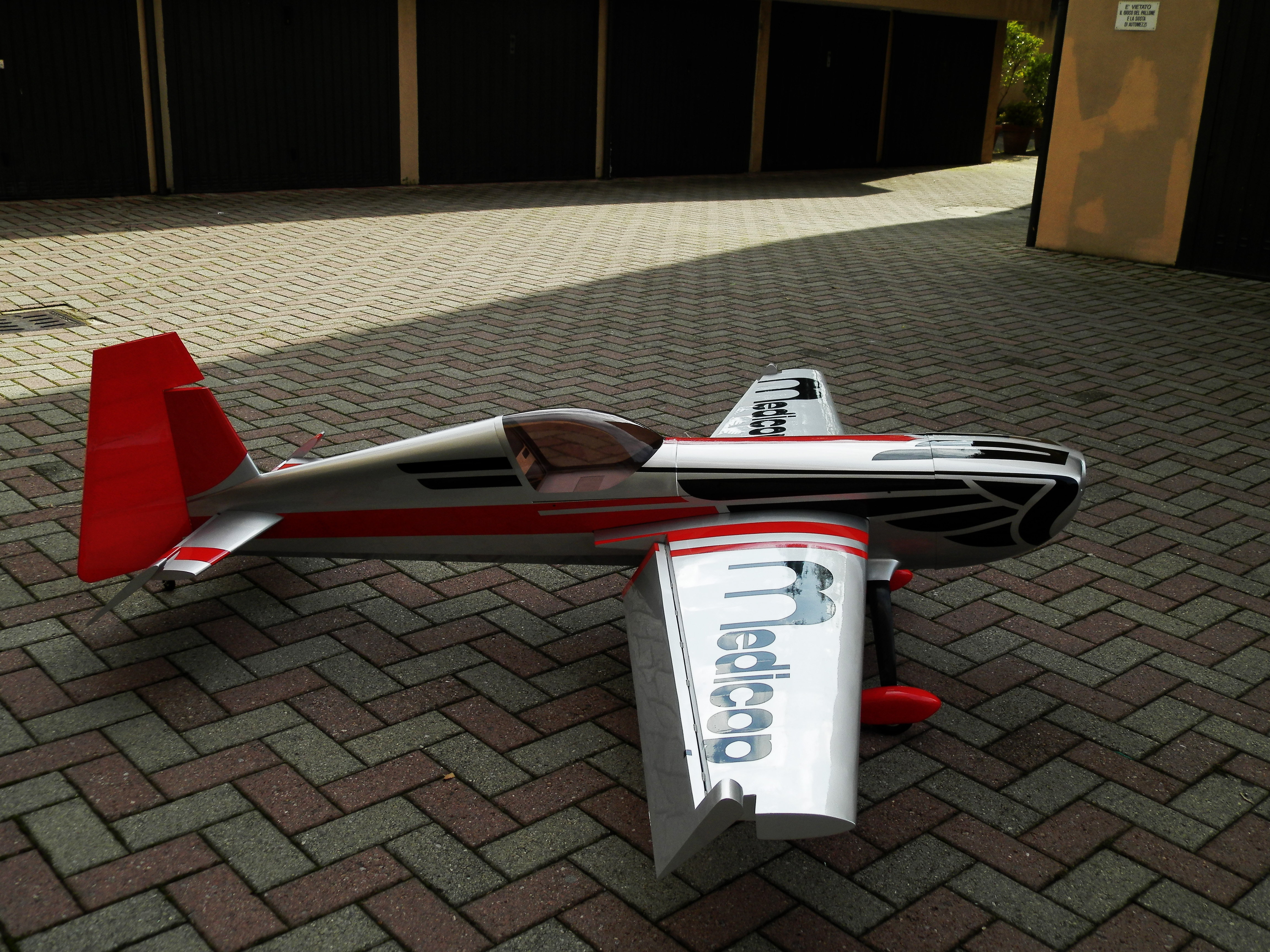

One day I tack the plane an it looks really great! :flyer:
