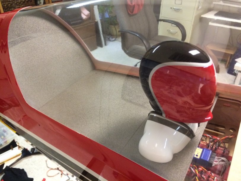

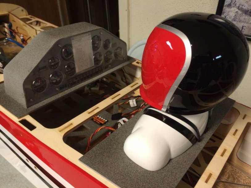

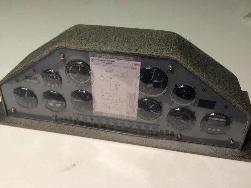

I didn't particularly care for the covering on the instrument panel.........basically seemed a little sloppy from the factory. I removed it and added a 1/16 balsa back piece and then painted it with texture paint. I think it looks much nicer now.

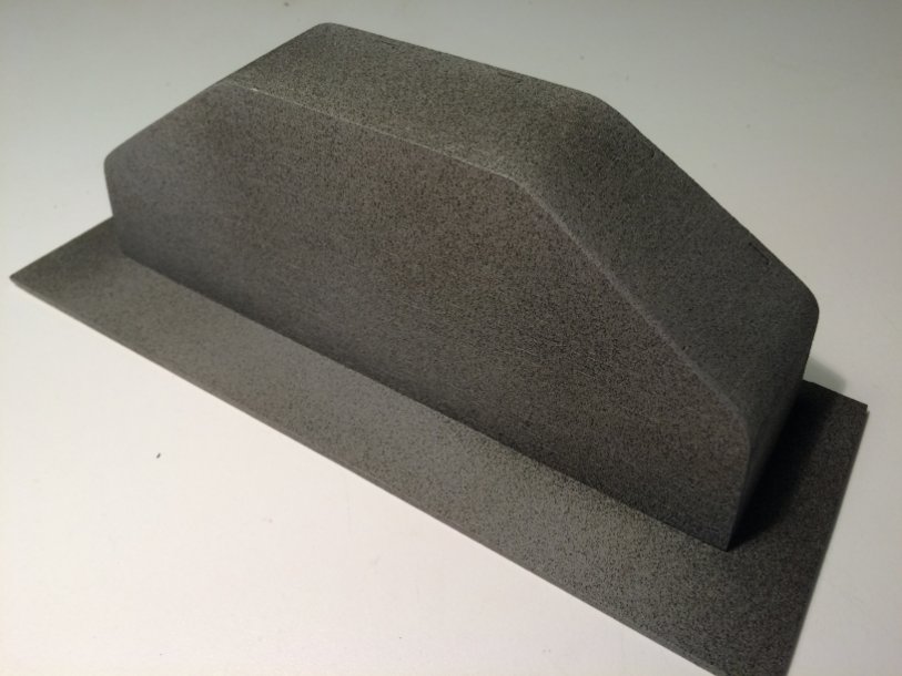

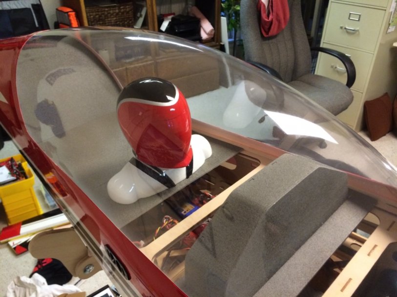

Fitted in the pilot base and painted it with texture paint as well. The pilot is secured to the ply base with zip ties..........looks like an extra set of shoulder belts. The pilot is very secure; much more so than using screws through the bottom. This little assembly trick was provided by @Ohio AV8TOR.
Must be a puzzle on how to get the foam board decking into the canopy.........LOL. I cut mine in a couple of pieces and painted them with the texture paint. Tried to paint it with a very light coating but the solvent may have warped the piece that I was going to use in the forward section of the canopy. I haven't installed it yet as it may not lay and glue flat. If not I'll have to make a piece from some balsa.

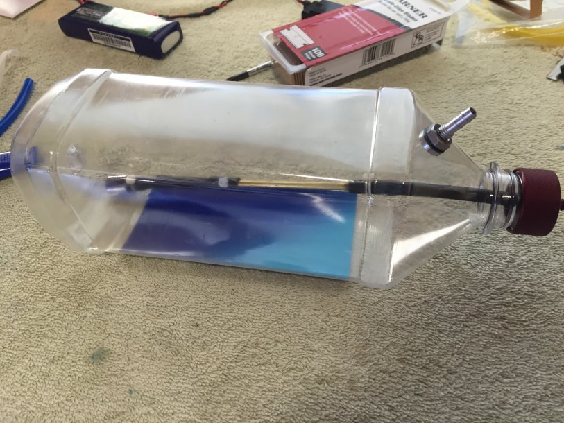

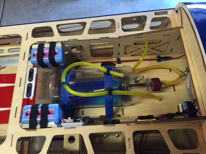

Today I replaced my cracked Fortitude tank with a PSP cap and Fiji bottle. Almost looks like the same tank. I tried contacting Fortitude and never got a response. Besides the tank cracking the clunk line was pretty stiff, and I kept fuel in it like the instructions say. Also the clunk line shrunk and the clunk was a good inch from the back of the tank..
For the Fiji bottle I used Viton on the clunk line and a heavy clunk along with a piece of brass tubing in the middle of the clunk line. It was so easy as long as it holds up this will be my tank of choice. My vent line is too short and I'll have to replace it otherwise I'd be done.
