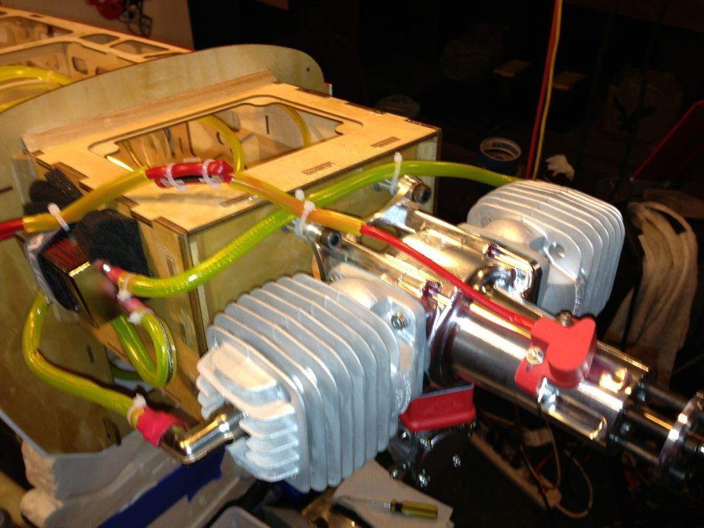

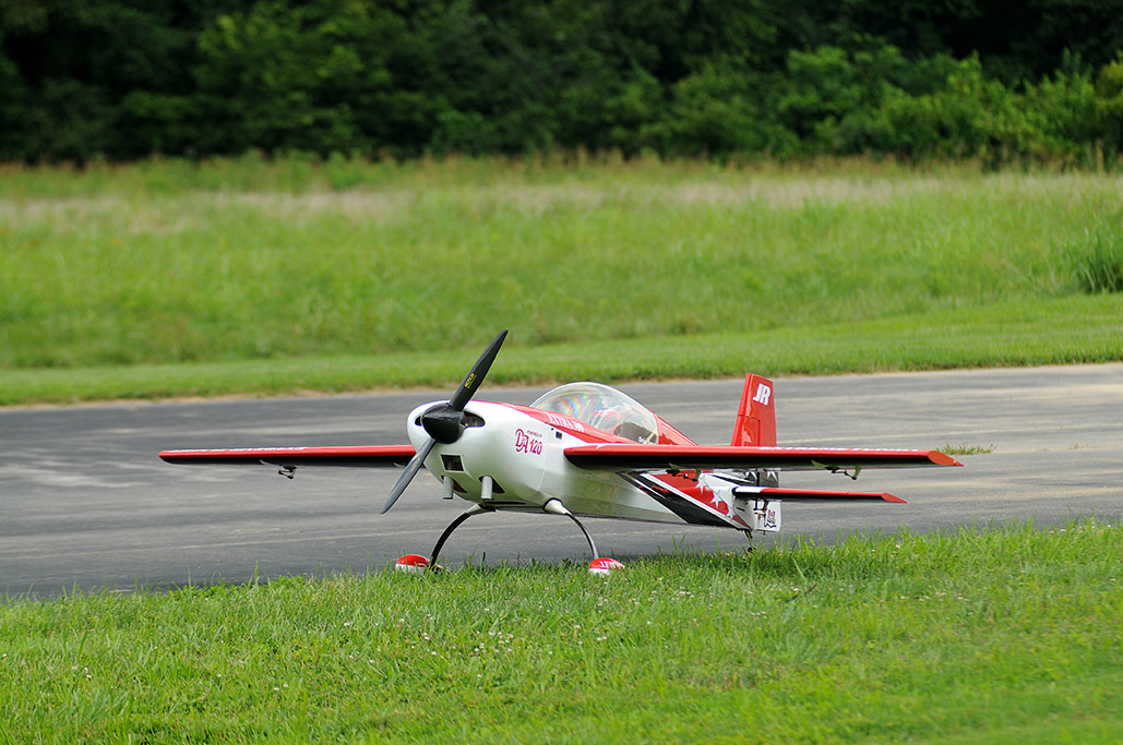

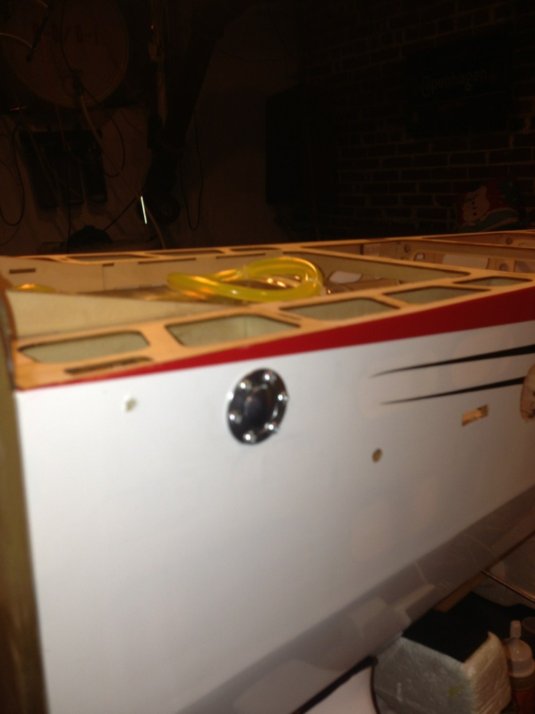

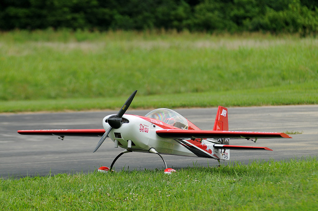

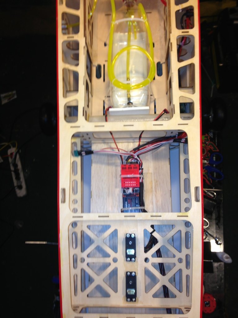

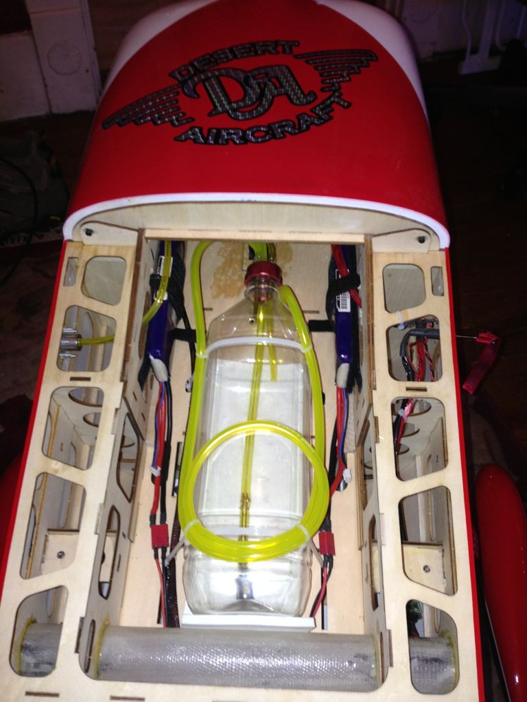

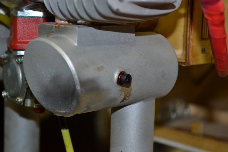

Just finished mine a couple of days ago!
Setup: DA-120, Hitec 5995TGs at 2s lipo voltage, SmartFly micro power expander, 2x2s 4000mah lipos, Tech Aero Ultra IBEC, Vess 28b w/ 5" CF spinner, Graphtech tailwheel, 50oz Fiji bottle w/ Fox Fuel Cap, SWB arms, Extensions, wiring, shielding and fuel dot from Taildragger RC and graphics from B&E Graphix.
