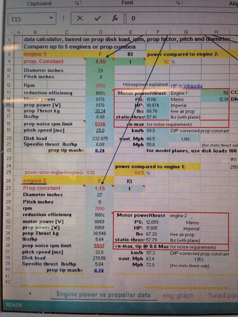

Falcon 27x11 was 7000 RPM and yet again seems like a sweet spot for the 120. I guess there is a reason all the competition pilots run this prop. Great throttle response and good power. The smaller prop disk allows easier and cleaner tumbles and pitch maneuvers. Not insane power like the 29" prop delivered, but that is a relative term. I will punch this into the spreadsheet to see thrust and HP when I get time.
Here is the data from the spreadsheet. Very interesting. I corrected this for density altitude. Almost the same static thrust, but the 27x11 has a much higher pitch speed. The 29 must unload more as it was
ripping and the 27 was not.

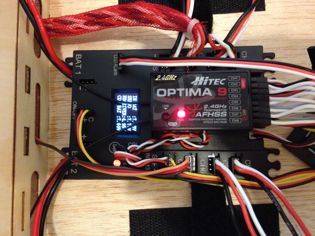

As I'm transitioning my airplane over to Hitec control, I replaced the spektrum powersafe receiver with this:

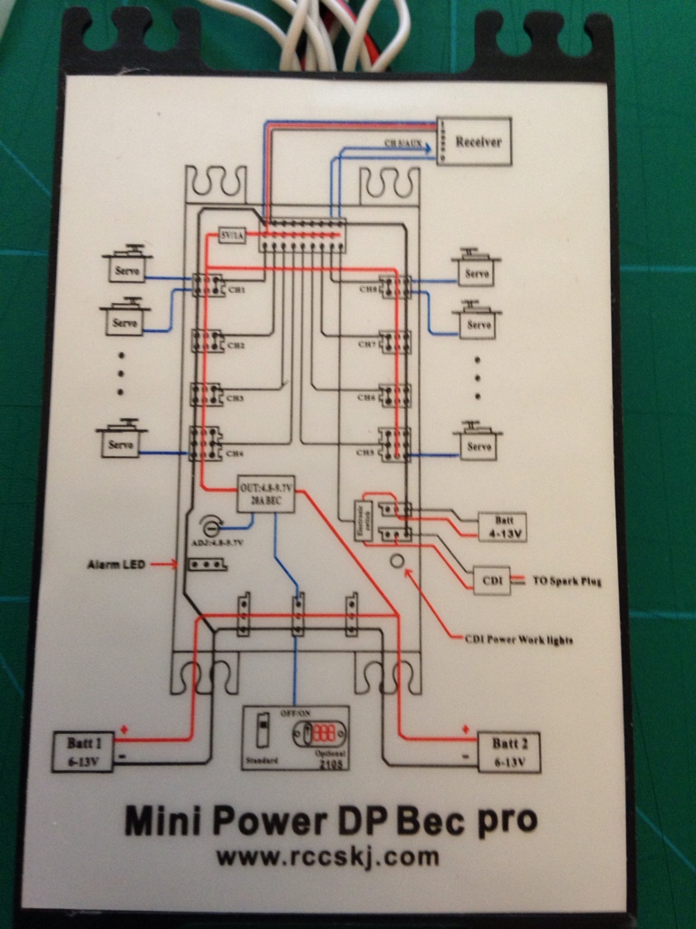

Got my new Optima 9 receiver paired up to my Aurora 9x, and powered through a RCCSKJ power board, perfect for my 104. Available from [MENTION=2470]RedwingRC[/MENTION], it comes with 8 channels plus a ignition kill, so 9 total inputs. I love how simple it is to setup, and it even had the wiring diagram on the back!

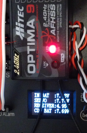

Best of all, it has a bright, easy to read voltage display for double checking flight packs before take off!
It shows input, output, rx, and ignition voltages.

Nice setup Gyro.
I use the powerbox Comp SRS on mine with two SBUS 3 channel Futaba Rx.
Only 5 flights so far, but rock solid.
The powerbox has a neat little function where you can check for lost info packets at the end of each flight, and so far its faultless.

amstd7
I have been debating on that same power system for my 104 Gyro, looks simple enough, thanks for sending pics.
