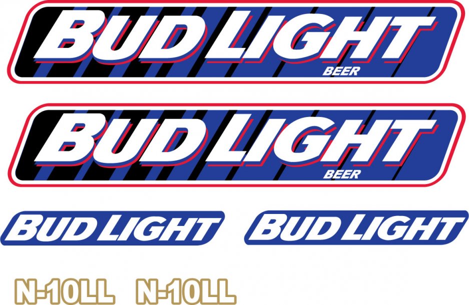

Did B&E do the Stars and Stripes as well, or are those from the EF graphics? Plane looks real nice with the later Bud Light logos on it.

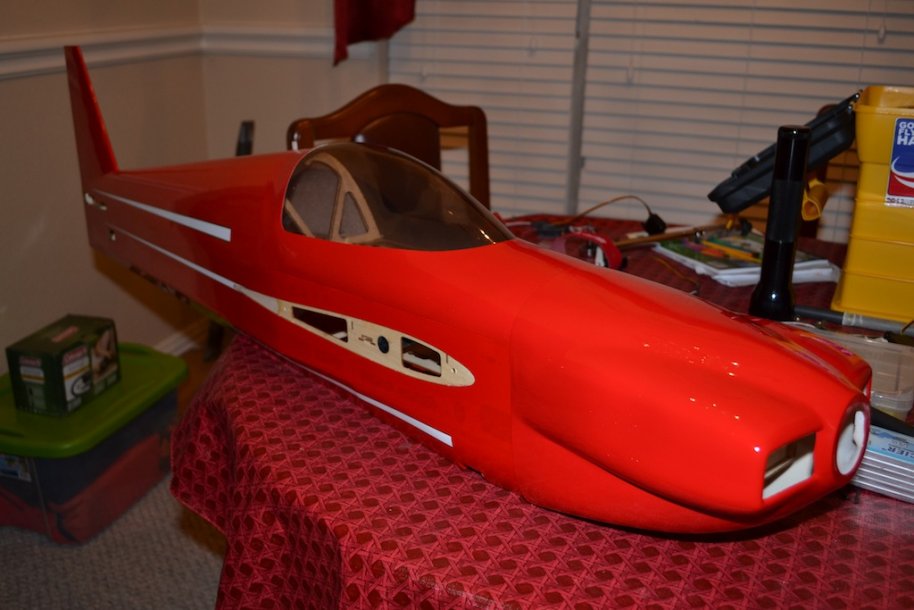

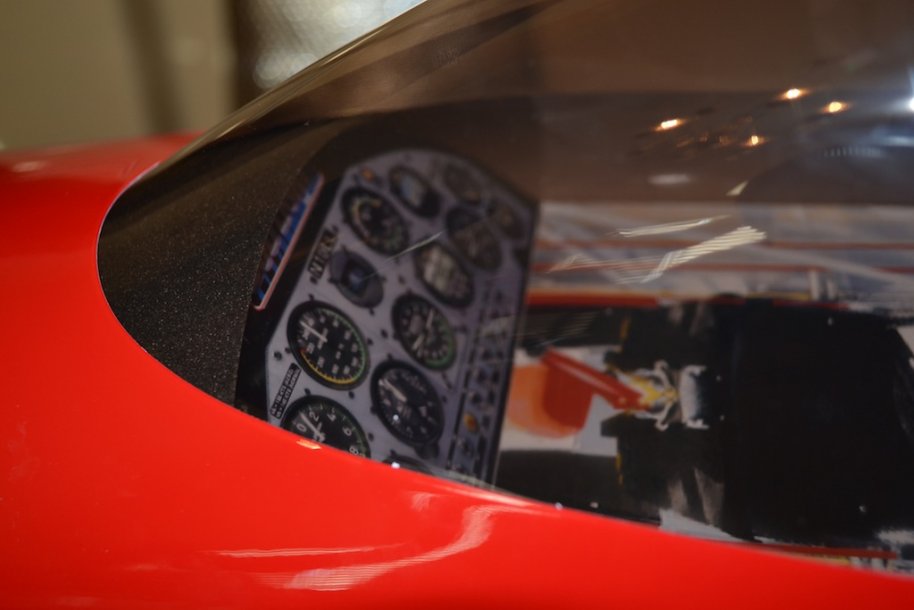

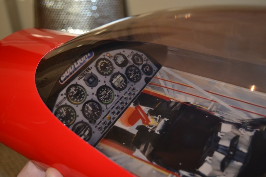

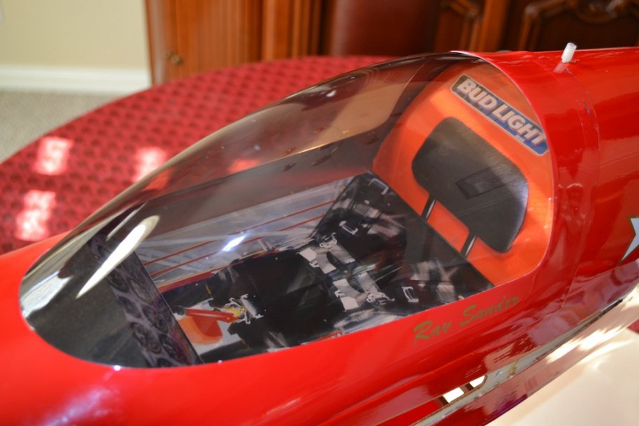

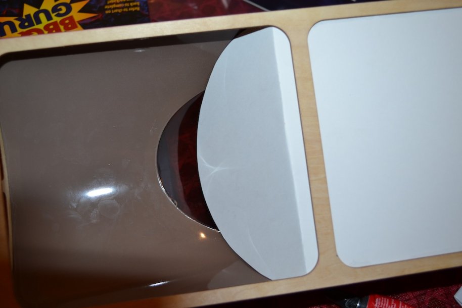

I wanted to fool around and do a realistic cockpit so Tim H and I came up with this which we sized up and then printed on photo paper. I could not find a way to cover the opening in the front of the clear canopy so I concocted up a dash hood like on my full size Piper Arrow. This was easy to do and I get a lot of compliments at the field.
View attachment 931 View attachment 932 View attachment 933 View attachment 934
WOW! BEAUTIFUL MODS OHIO! Go OSU! Roast those Ducks!

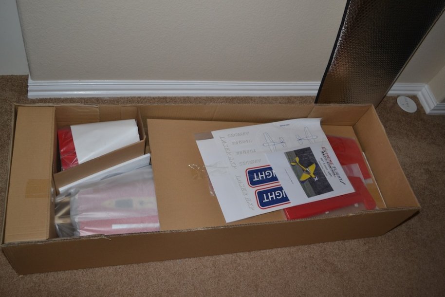

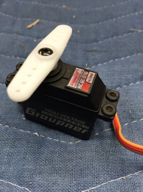

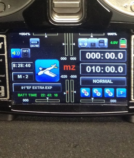

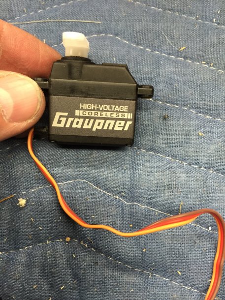

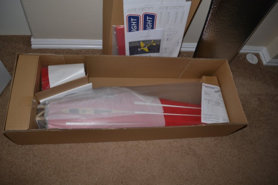

Got mine last Monday and am finally getting some time to assemble it. I'm
Going with Graupner HVC 660 mg.bb HV servos. About 130 ozin of torque and 60deg @.12sec.
Also be using my Graupner MZ-24 tx and 8ch rx as well as a Graupner esc. I'll be getting good use from the telemetry with this one.
Awesome job on the cockpit details. Years ago I did something similar by copying onto photo paper but I lost the files and the website.
Do you know where to go on the web to find such photos or still have them?
