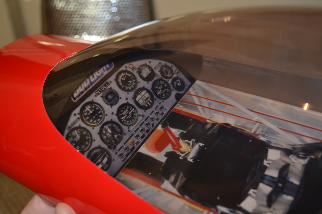

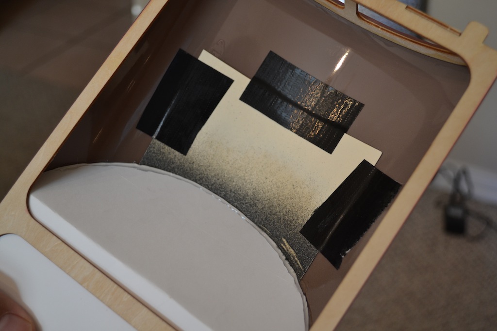

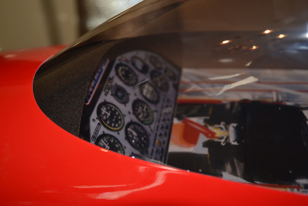

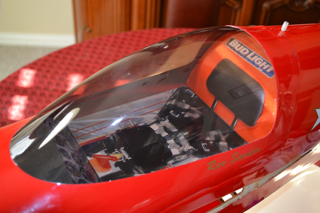

Well I liked the way it looks this morning so I glued it and and called it done. I like the effect of the manila dash as it is comes out away from the canopy giving it a nice 3 dimensional effect. I did use some welders under the card stock but used some tape to hold it in place during gluing. Pressed the top of the printed dash top against the card stock from the inside to remove any gaps and placed a bead of welders around that.
