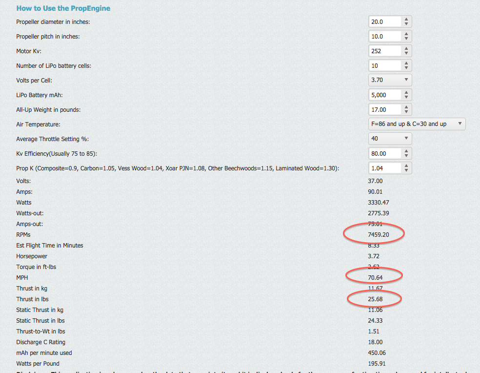

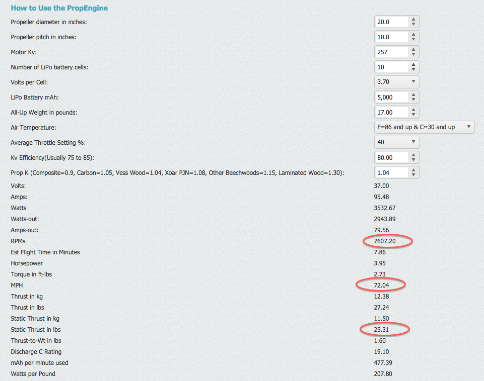

So I admit that I am not as serious as you guys for having the absolute max power and I agree that the DA is more powerful than the VVRC 40. But is gaining 140 rpm's switching to a tuned pipe really worth it? I may be wrong also in what I just did but I ran in Jim's PropEngine a 20b (at 10 pitch) and tweaked the Kv to get as close as I could to your rpm's. To me switching from the Pitts to a tuned pipe is only a 1.4 mph gain and is actually 0.37 lbs of thrust less. I am not sure I understand how the thrust comes out less nor if I am using this calculator right. But if I am is the cost and frustration of the tuned pipe really worth it or what else am I missing?

With the 20x9 Alan was getting a little over 7800rpm to get a better comparison to my 7460.
In the calculator it looks like you used 10 pitch for both props? I think the Prop K value needs slight adjustment too (1.05 for carbon 1.04 for Vess wood)
I was more thinking about how much I loved the 20b on the Extra at 6900rpm with the 40cc and how 7600 compares to that.
It's looking like the pipe actually provides a 300-400 rpm boost on the same prop as the pitts.

My bad Joe I looked to quick at yours and thought that was on a 20B as well, so there is a 1.98 pounds thrust and 8.47mph advantage.
