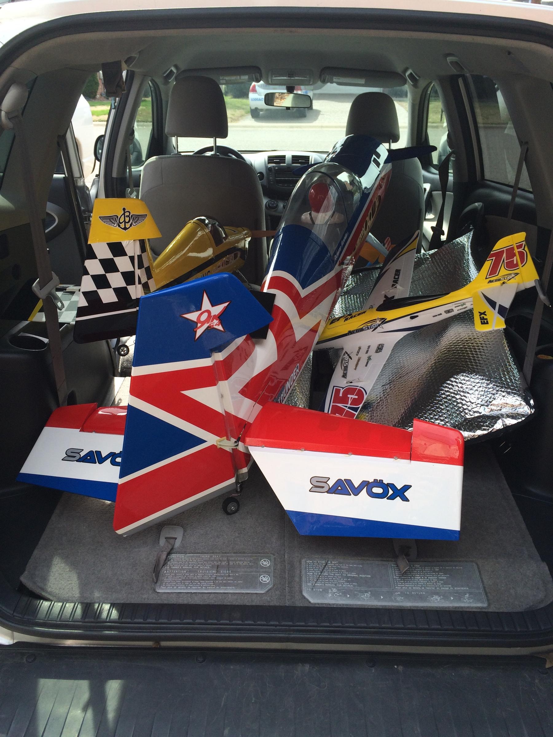

Size deceiving Rav4
91" Yak, 64" MXS, and a go fast plane all comfortably fit in my daughters Rav4 :thumbup:
