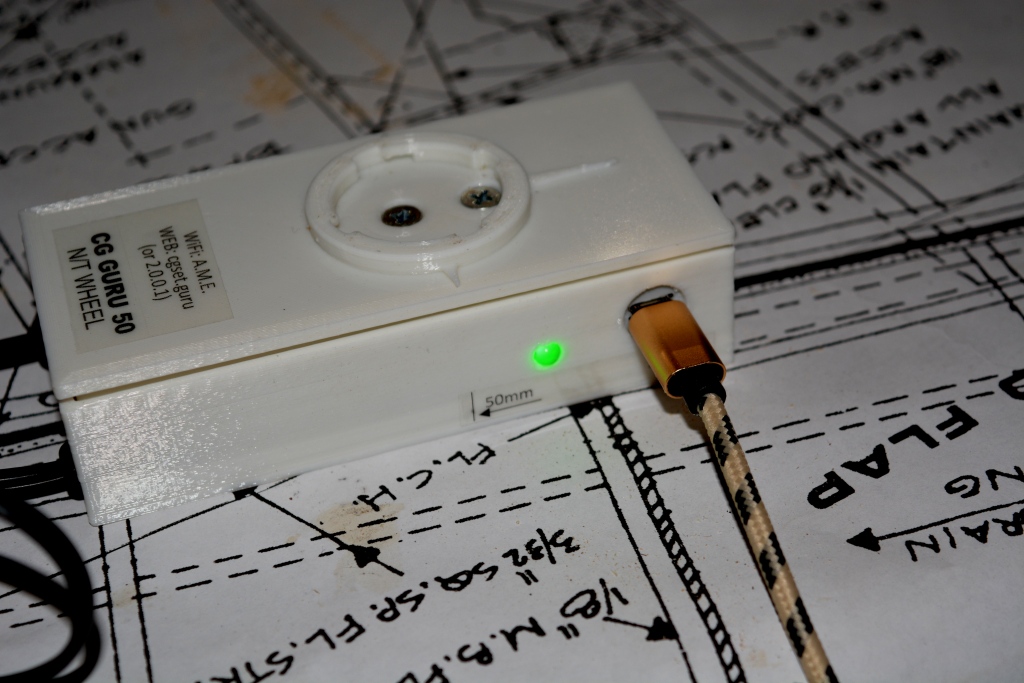

plug the unit using a cell phone charger , making sure it is not over voltage

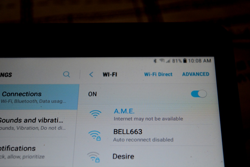

check for availlable wifi network , you should see A.M.E. as you see here click on this one to open

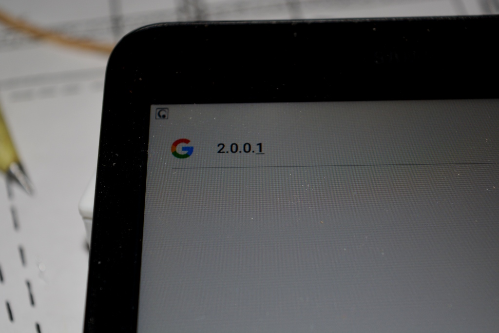

click google search, and enter 2.0.0.1 as you see up in the photo,

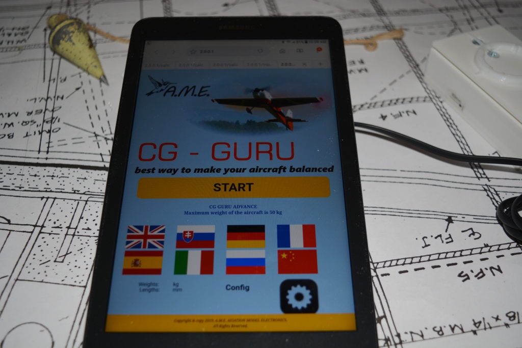

this will open immediately
You can do the same for your cell phone or laptop
