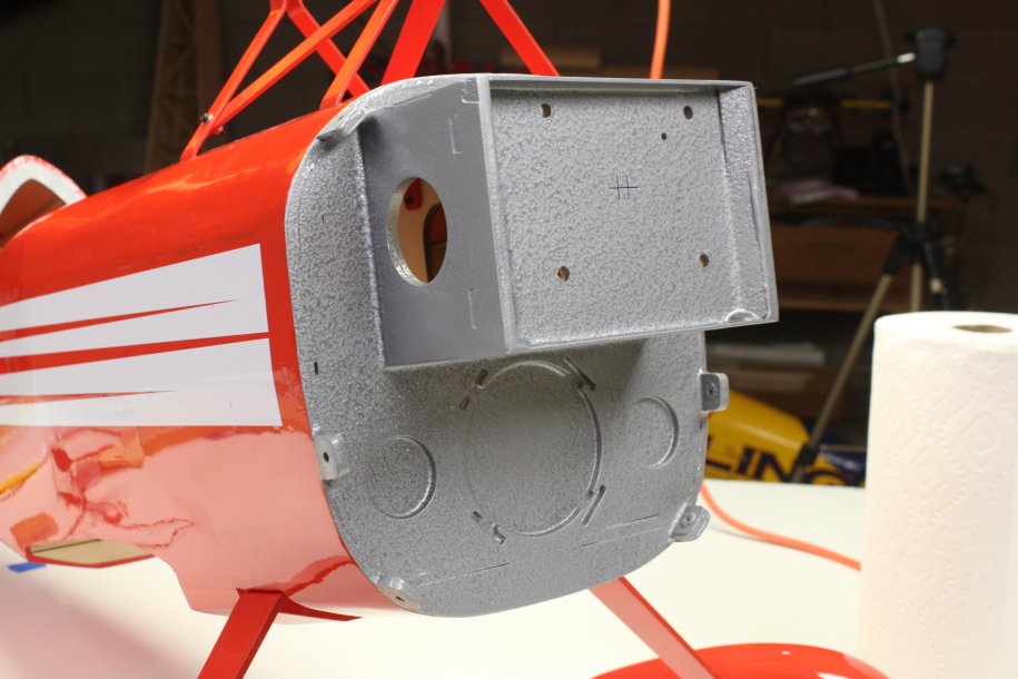

Has anyone used Rustoleum Hammered silver spray paint for a firewall before? Everything has been sealed up with epoxy and sanded so I just need a nice top-coat for it.

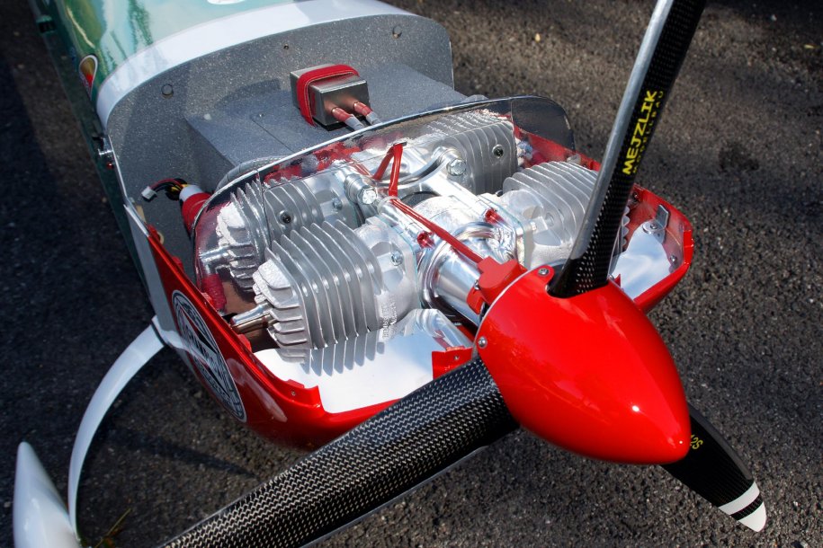

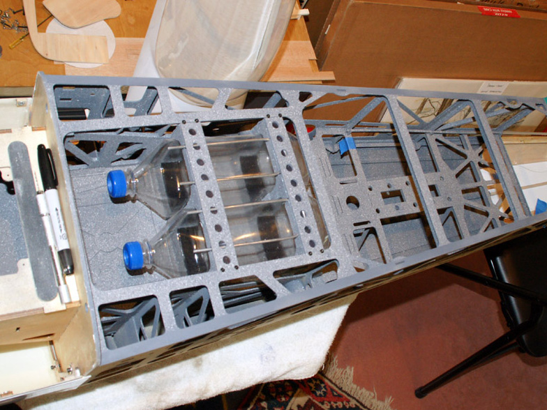

Bart that will work. I used the Rustoleum Textured. Also use primer first, it will take less of the hammered to cover.
I prefer not to use any of that stuff, unless it is in a hatch. A light coat of grey primer, and a uber light coat of make it stone.
Just be sparing with the spray, otherwise, you will add some unnecessary weight. Unless you need it for ballast. :)

too late! did a coat of silver rustoleum over the epoxy and then enough of the hammered silver to cover and have a consistent textured look
those globs of epoxy were in there from the factory, I probably should have carved them out.
