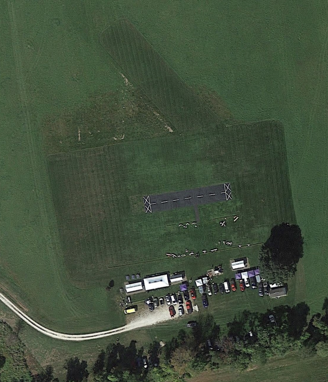

Our grass field was always cut to about 300’ x 400’ and some pilots would make it over the area chop the throttle and land in that area. Our club installed a 30’ x 250’ Geotex runway, it is large enough for most of the flyers. We still cut about 250’ x 400’ grass area for the bigger models or those that prefer grass. The Geotex runway has improved the taking off and landing of many pilots. It has also widened the scope of models that can be flow at our field. Many smaller RTF models, EDF jets and aircraft with wheelpants don’t have any problems. I would at least recommend marking you grass runway with lines to sharpen your members piloting skills. Pic included is runway 150x30 later extended to 250
