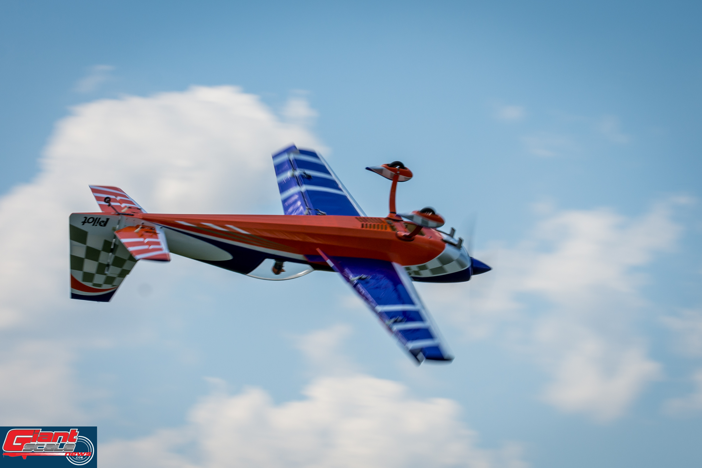

  5. @gyro this picture says it all! Take a look at the covering on the belly of the fuselage. The twisting made me look further and you can see that the front of the plane is AHEAD OF THE TAIL in the roll!!! You can't time pictures like this one. It should be a reminder that if you are doing some serious hucking, make sure you are checking the joints in the airframe every now and then :) Great picture!

    Nice catch, it sure is twisting. Joe Smith was having problems with his aircraft and equipment all weekend... Hope he gets it all sorted out, he left with two crashed planes.

    Yeah, it was hard to watch... 3 of his flights were ended prematurely (2 mechanical).

    Two engine failures on two of the flights.
    My personal guess is running too lean on too hot of day, while flying a routine with too much full throttle and too little airframe movement through the sky for cooling.
