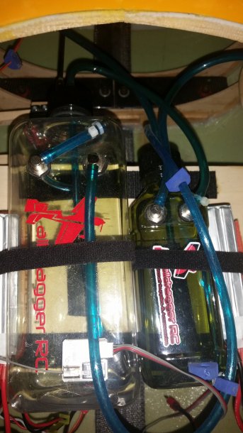

Here is a pic of my MX2 fuel system set up. Its an actual header tank system.
Carb line ones from the small tank pick up line. Vent from the small tank goes to the pick up line of the larger tank. Vent is the actual overflow line. Pinched off 1 filler line, and the other one is the active fuel filler.

The main key to the dual tank setup is making sure the lines off the T-fittings to the tanks are the same size and length. I run dual 32oz tanks on my Edge with a DLE 170 and it works great. I would go to a single 50oz tank but, that dle drinks gas for some reason and I would hate to run out of gas during the 2nd sequence of Intermediate class :) My GP-176EVO on pipes in the 330LX, I currently have a single 50oz tank and usually land after 2 sequences with about 1/3 tank left, which is a nice comfort level for me.
@Jetpainter would you be kind enough to make sketch, do not understand the balance tube between the two tanks. Thanks.
Look at the first picture in the thread and you will see that the fittings in the left side of the tanks loop together. Not strictly necessary, but since the fittings were already in the tanks he just connected them. That way the vacuum in each tank will be equal and should help in equal draw from each tank.
