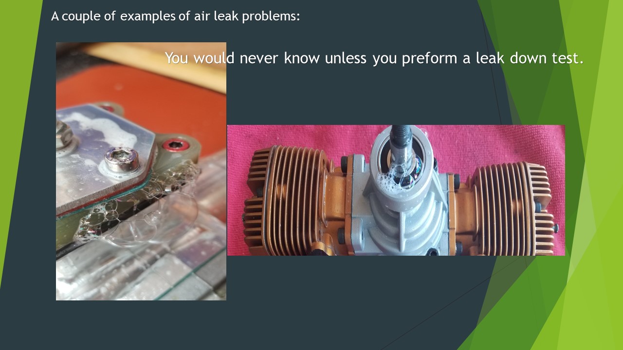

These leaks include anything coming from the crank seals,cylinder head gasket, base gasket, the spark plug threads, intake manifold, or exhaust manifold. No matter where these air leaks originate, they affect the performance of your engine, making the engine difficult to tune, and are not normal for a healthy engine and will eventually end up costing you your engine if not the whole plane.

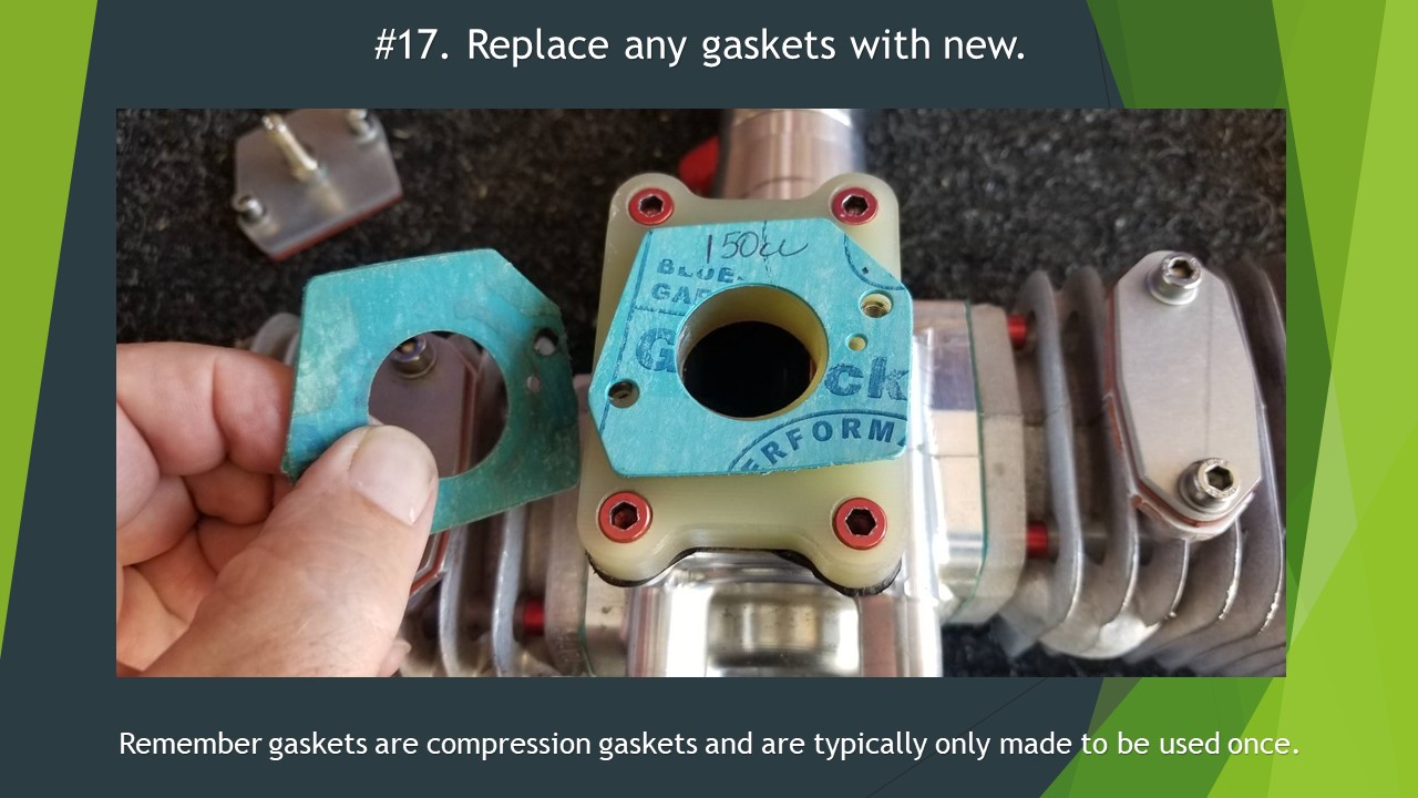

The biggest mistake I see allot of people make is when they rebuild an engine with new parts and skip the leak down test.
I cannot count the number of times where I have rebuilt an engine with new parts and then performed a leak down test to find a gasket that was not sealing properly or another part that was causing a problem. The leak down test is imperative and ultimately becomes a form of cheap insurance against the time and money that has gone into the build...

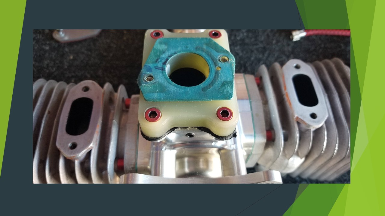

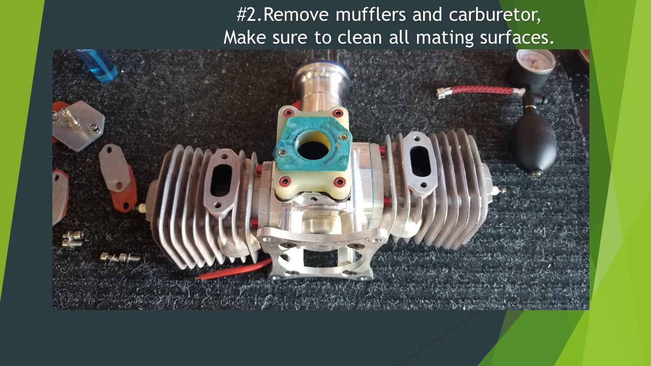

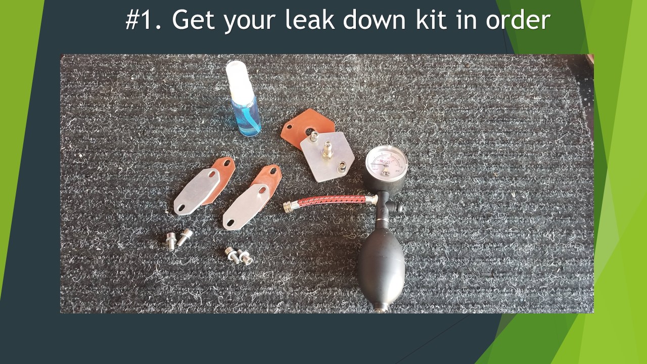

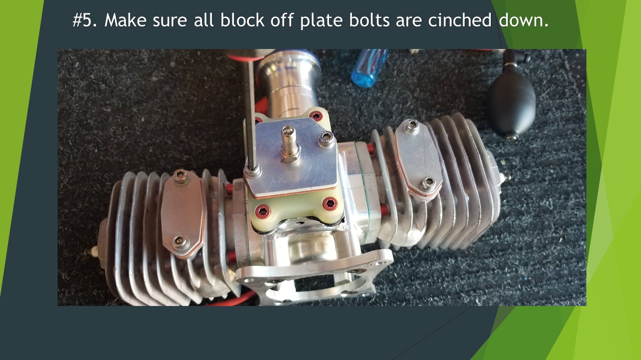

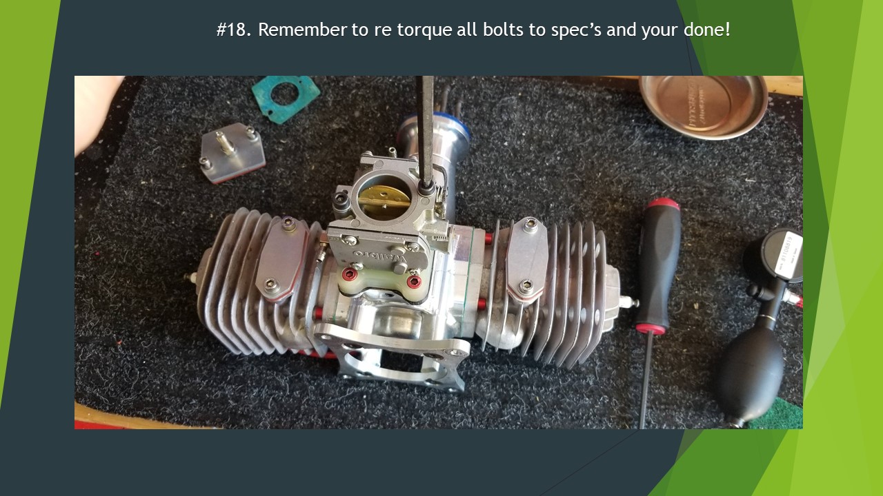

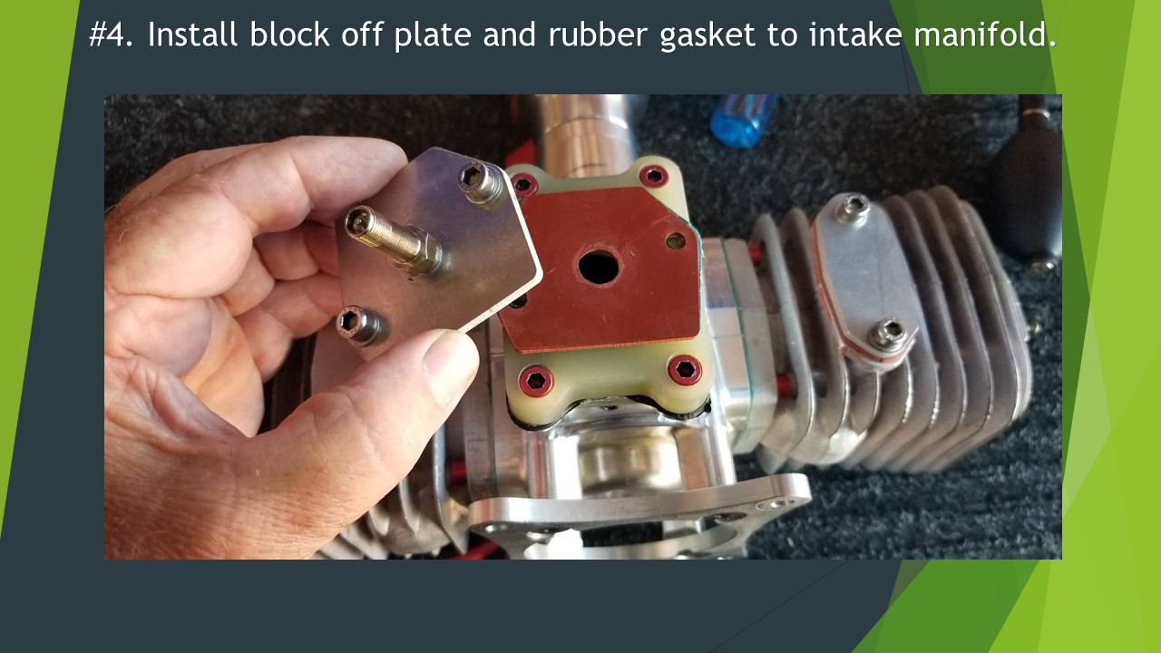

1. To perform a leak down test on the engine: cylinder, head, reed cage, intake manifold and spark plug must all be installed and torque correctly. Exhaust pipe and carburetor must be removed.

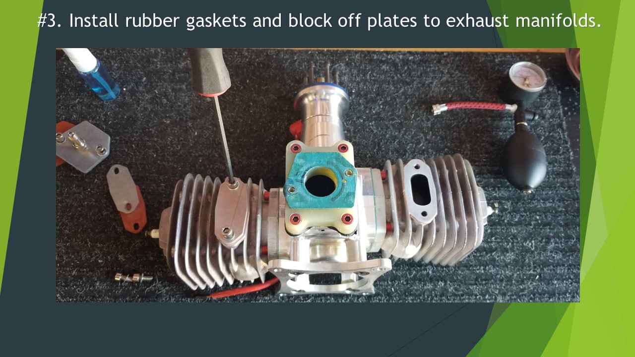

2. Seal the exhaust ports with the correct size block off plate and rubber gasket.
3. Seal the correct size carburetor adapter block off plate.
4. Attach the hose (from the pump/ gauge assembly) into the Schrader valve.

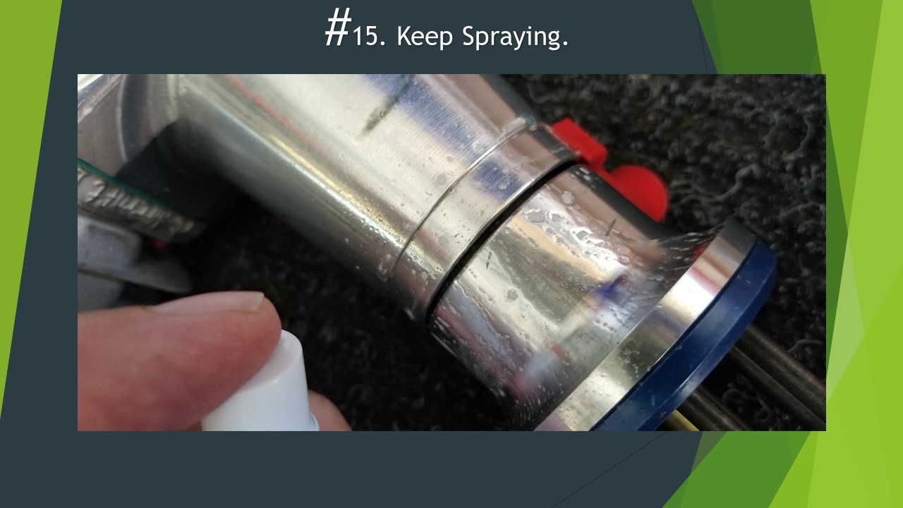

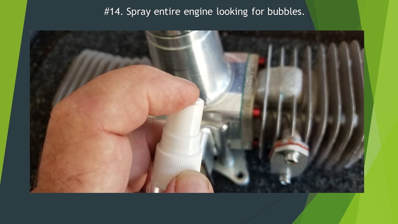

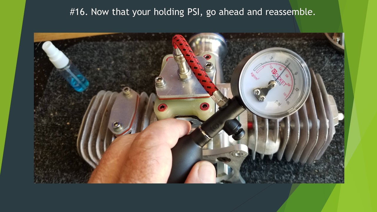

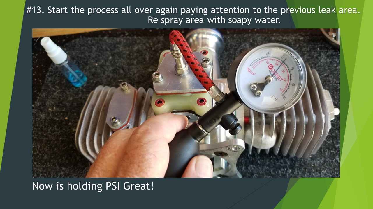

5. With all test equipment in place and the piston at bottom dead center, use the hand pump to pump 6 PSI of air pressure into engine. Never exceed 8 PSI of air pressure or damage to the seals and/or engine may occur. If loss of air pressure occurs, spray soapy water over mating surfaces to see where soap bubbles appear. Repair any leaks that may appear and redo test. A leakage rate of 1 PSI per minute is acceptable; however the lower the leakage rate the better your engine will perform.
