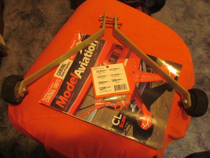

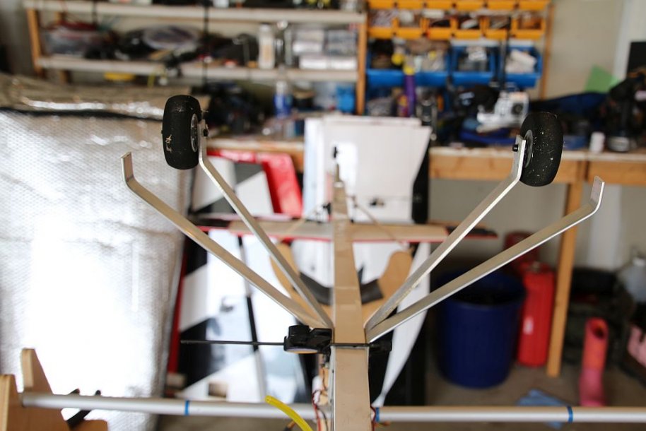

@pawnshopmike.I have used all three sizes on the many Profiles I have flown. The Small size is perfect for profiles in the 40 to 60 glow size,4 to 6 lb. TTP15. The TTP 19 is great for profile's in the 60 to 120, glow, or 20cc gas profiles, and the TTP 17 works with Profiles that weigh 9 to 15 lb. or 30cc up to the 50cc gas profiles. on these 20cc profiles I use the TTP 19. I have flexed this gear a few times to where the wheels have punched holes in the bottom of the wings and spring right back LOL!! Any aluminum gear whether light gage Or thicker will not flex Aluminum gear will just bend and twist out of shape, and will break eventually The thicker aluminum gear is hard to straighten and has to be removed to do so FWIW The Tetherlite gear will take a licking and keep on ticking
Thanks for the info Jerry.:way_to_go: I might order a set of the TTP19 for mine.
flycanic

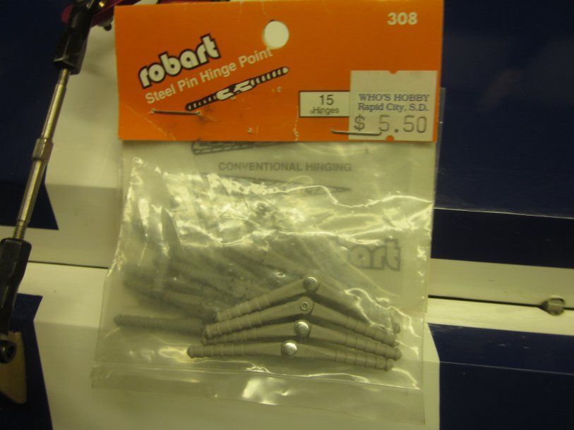

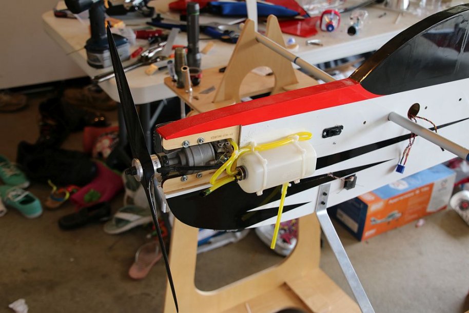

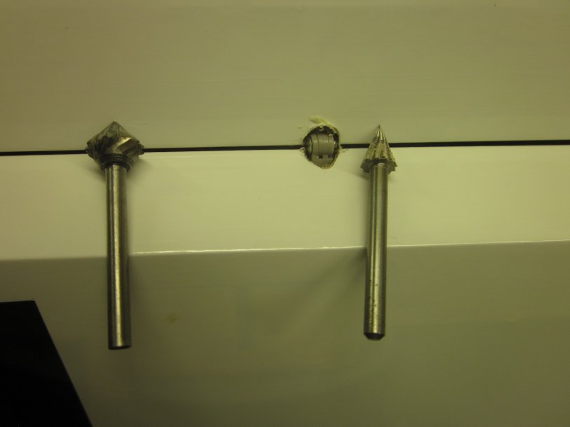

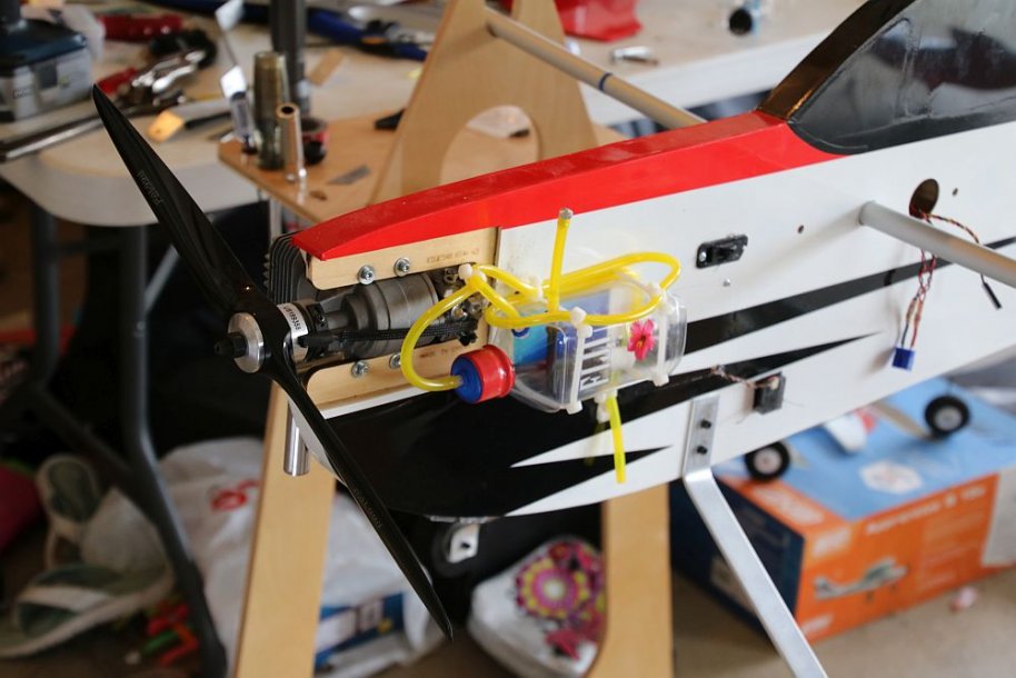

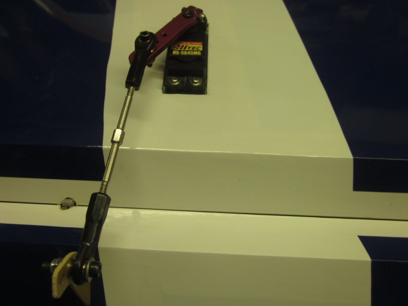

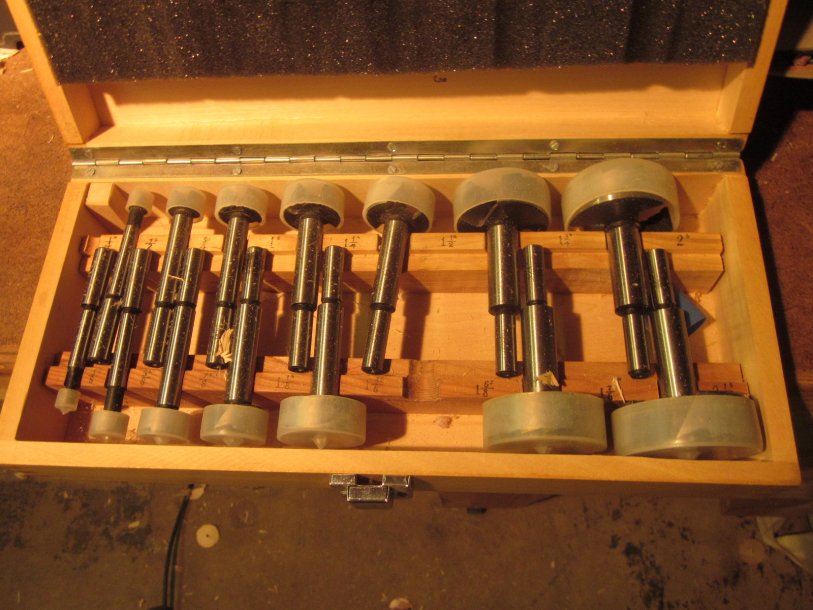

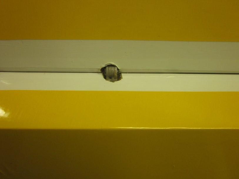

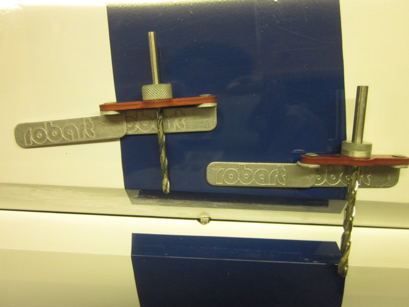

IMG_4343.JPG IMG_4344.JPG IMG_4345.JPG IMG_4346.JPG IMG_4347.JPG IMG_4348.JPG IMG_4349.JPG IMG_4350.JPG You are very welcome Mike. Know that I have the template for my fuselage doubler's I am going to cut out 3 sets, there are a couple other guys in the club that want me to help them with there profiles. On the hinges I use the Robart Hinge Point hinges 1/8". The larger or 3/16" size I use for 50cc and up. The servo extension keepers I prefer are from Aero-Works. So I can achieve a tight hinge line and a more scale appearance I counter sink the pre-drilled holes for the hinges with the bits shown the smaller bit I use for the profiles and up to 30cc planes and the larger I use for 50cc and up. There is a photo of the Tetherlite gear I use notice the Wide stance the gear provides. more to come

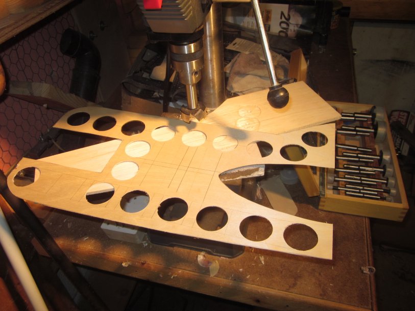

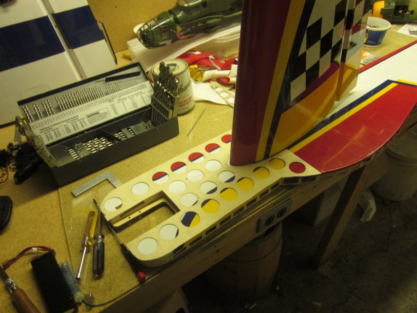

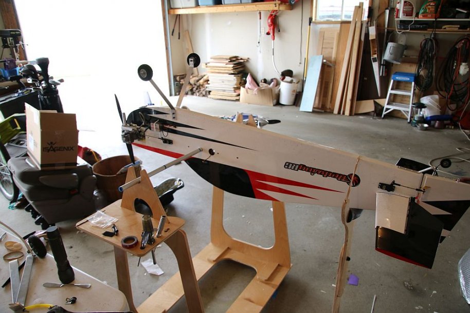

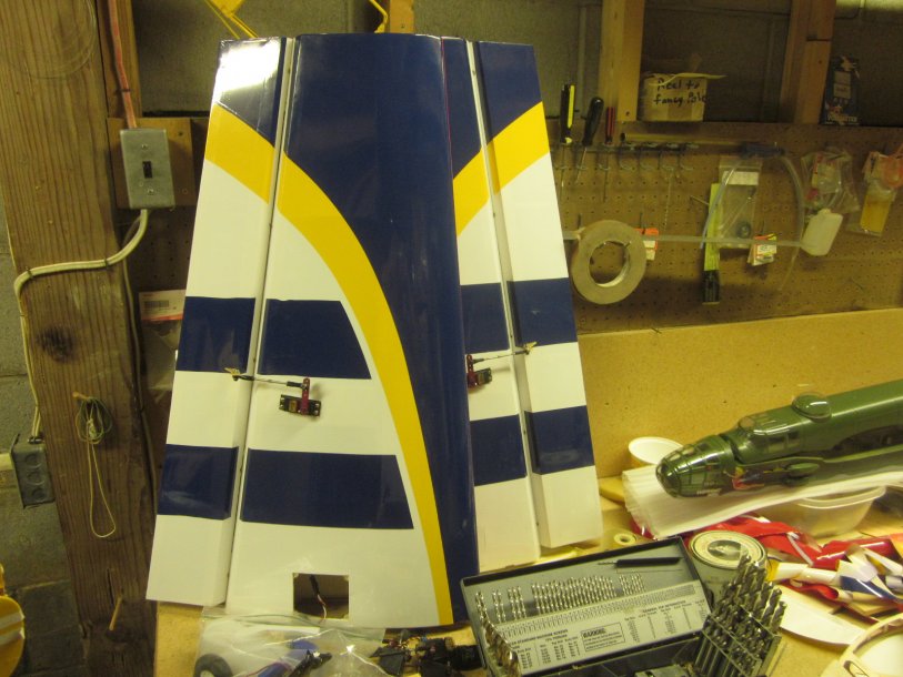

Just finished Drilling lighting holes in three sets of Fuse doulbers for the 20cc Red Wing Yaks. Fuselage enforcement and gluing the doublers on are next. Then the tail feathers. That will have to be next week until then keep um flying. A few of us are headed to Gillette Wyo. , for there yearly fun fly. Great bunch of guys. getting a pile of planes ready to take with.
