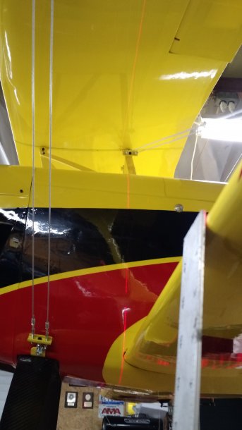

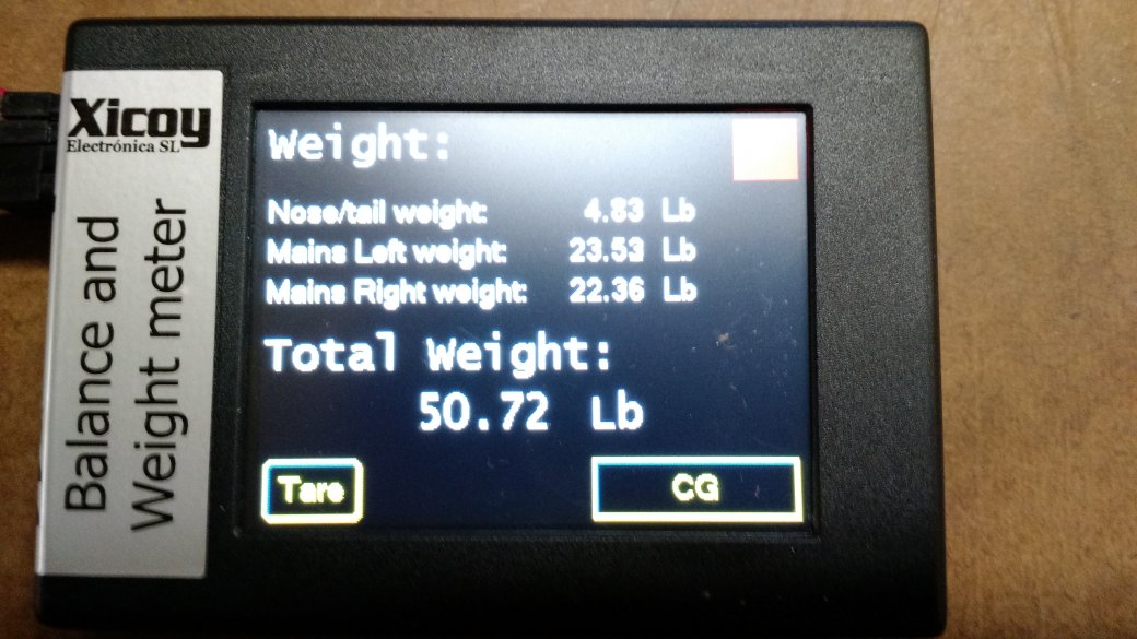

On the balancer!

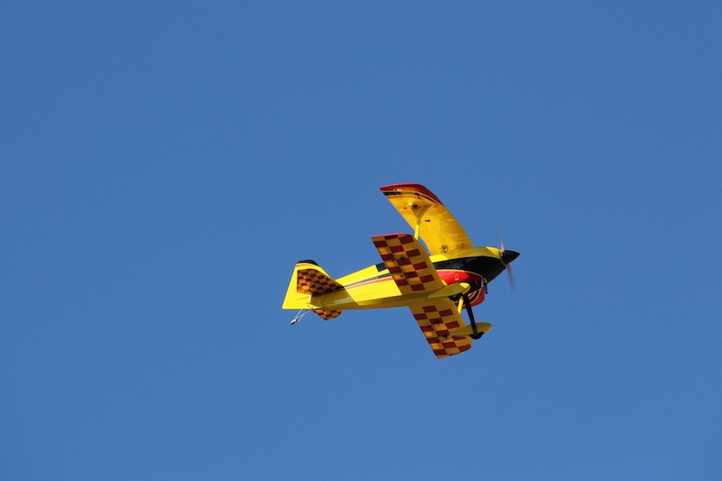

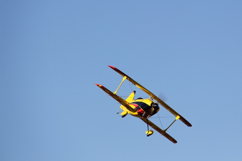

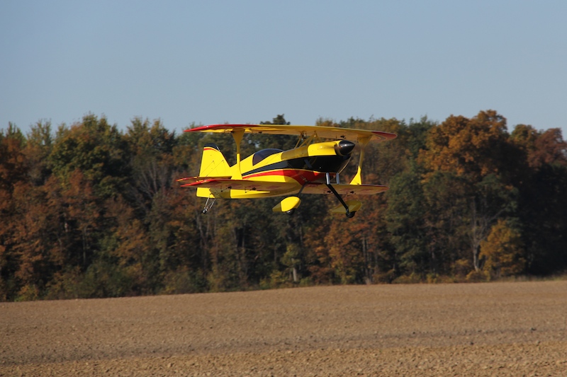

Couple of quick pics from Saturday.

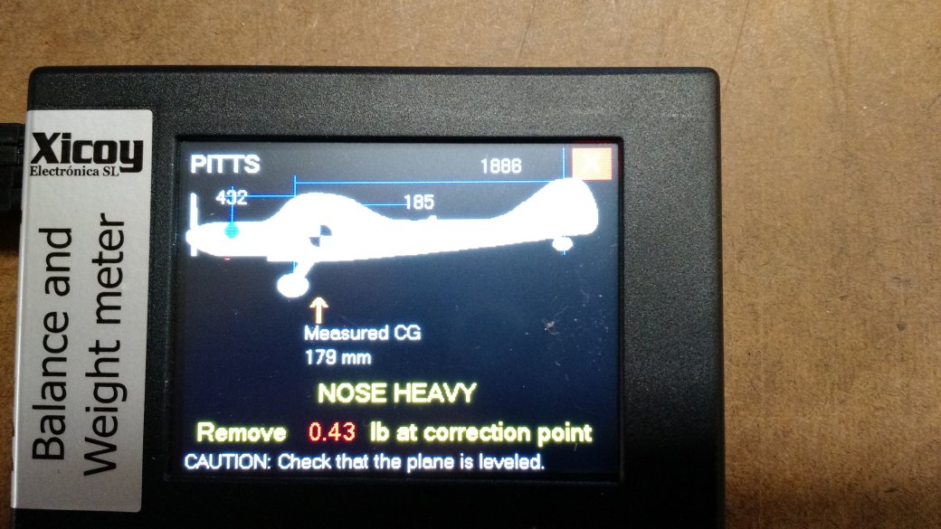

CG was spot on! Just a breath of down elevator to hold inverted level.
Knife edge pulls to belly and tries to roll to upright level flight. Added 15% elevator and 12% aileron. A bit too much on both.
Does a nice inverted flat spin, but had throttle too low and it quit... Dead stick landing, no problem.
I had too much expo on ailerons on first flight. So it felt sluggish. Reduced it, much better!
