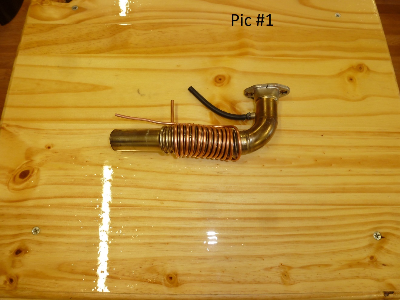

Here is how I get the most out of smoke. One first needs to install Bad Dog smoke nozzles, there is no better way to inject the oil. After that I start by wrapping the header or can numerous times with 1/8" soft copper tubing, in this example there is 26 inches of copper tubing on each header. I like to start the tubing where the oil will be going in and at he end fold it back over to the same point, this gives more tubing for the oil. Pic #1

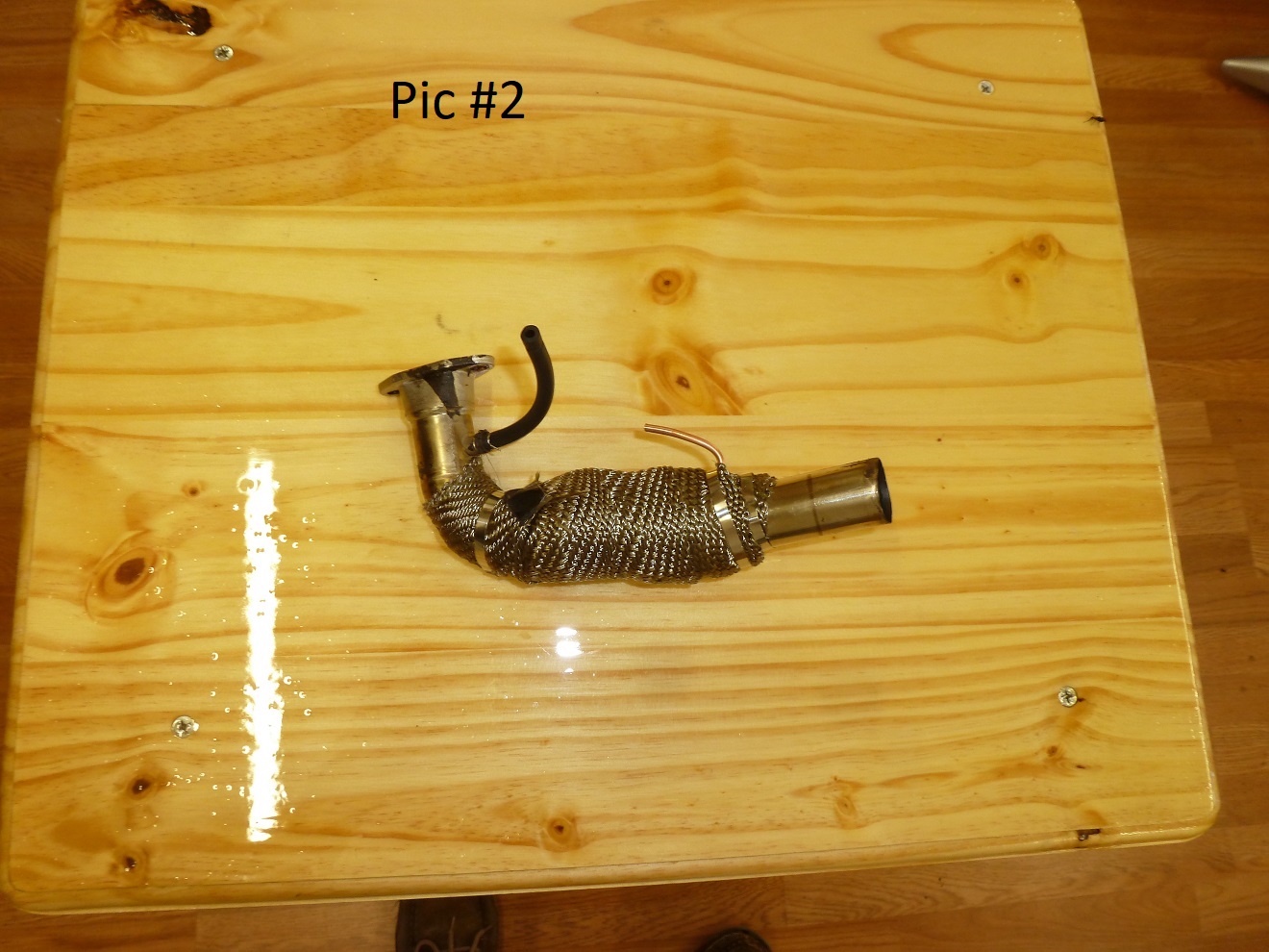

Then I wrap the tube with automotive exhaust wrap and secure it with stainless steel zip ties, just enough to hold the exhaust wrap securely. Usually one on each end and one in the middle is more than enough. Pic#2

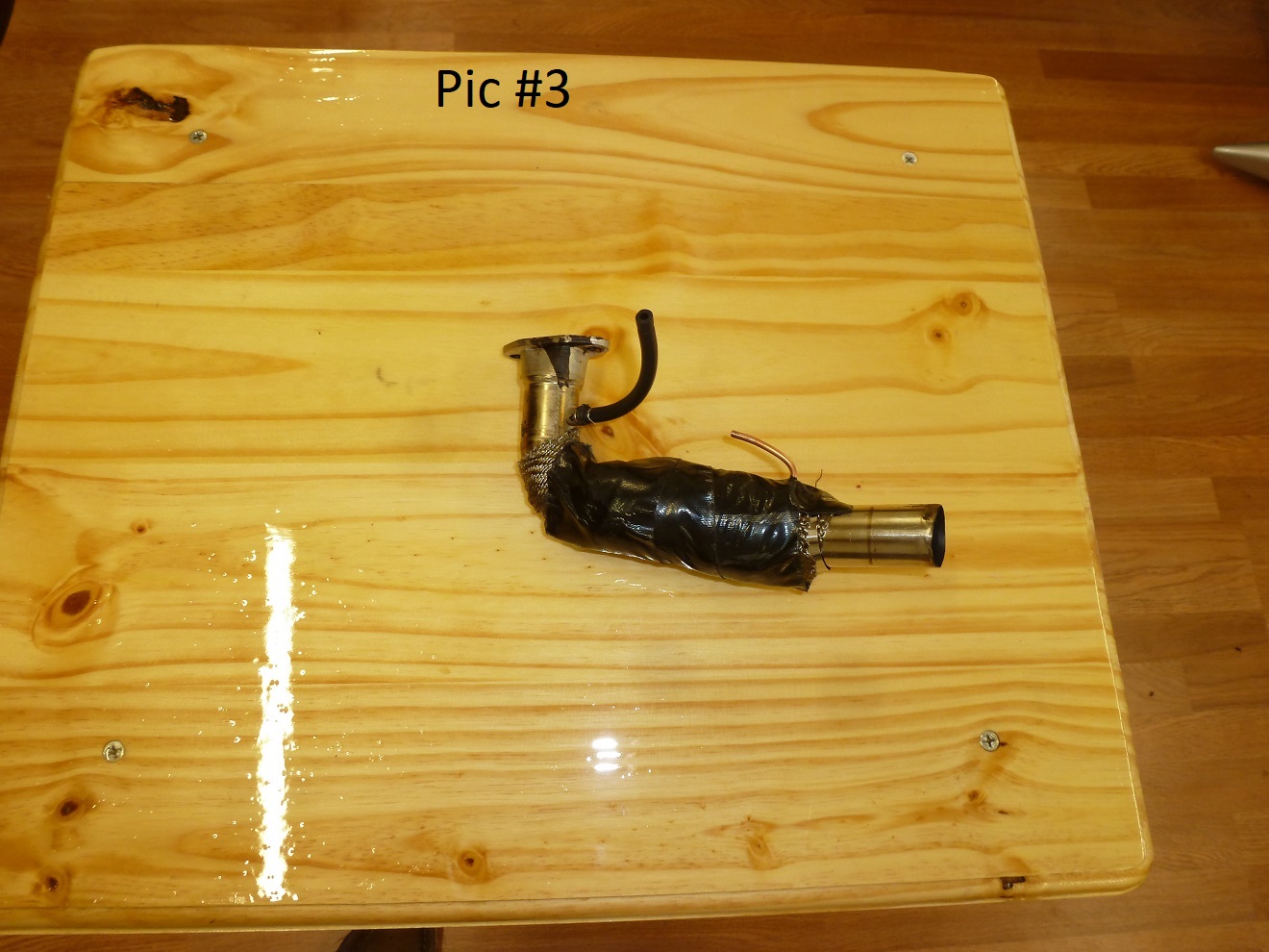

Next I cover the exhaust wrap with exhaust tape. This tape is not necessary but holds the exhaust wrap long enough for it to form itself to the header. I learned the exhaust wrap formed to the exhaust when I had to make a repair. Pic #3

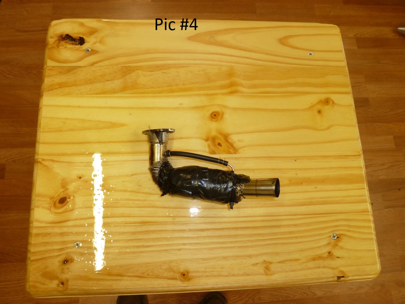

I use some normal zip ties on the tape to hold it securely until it has been heated, heating activates the adhesive. Pic#4

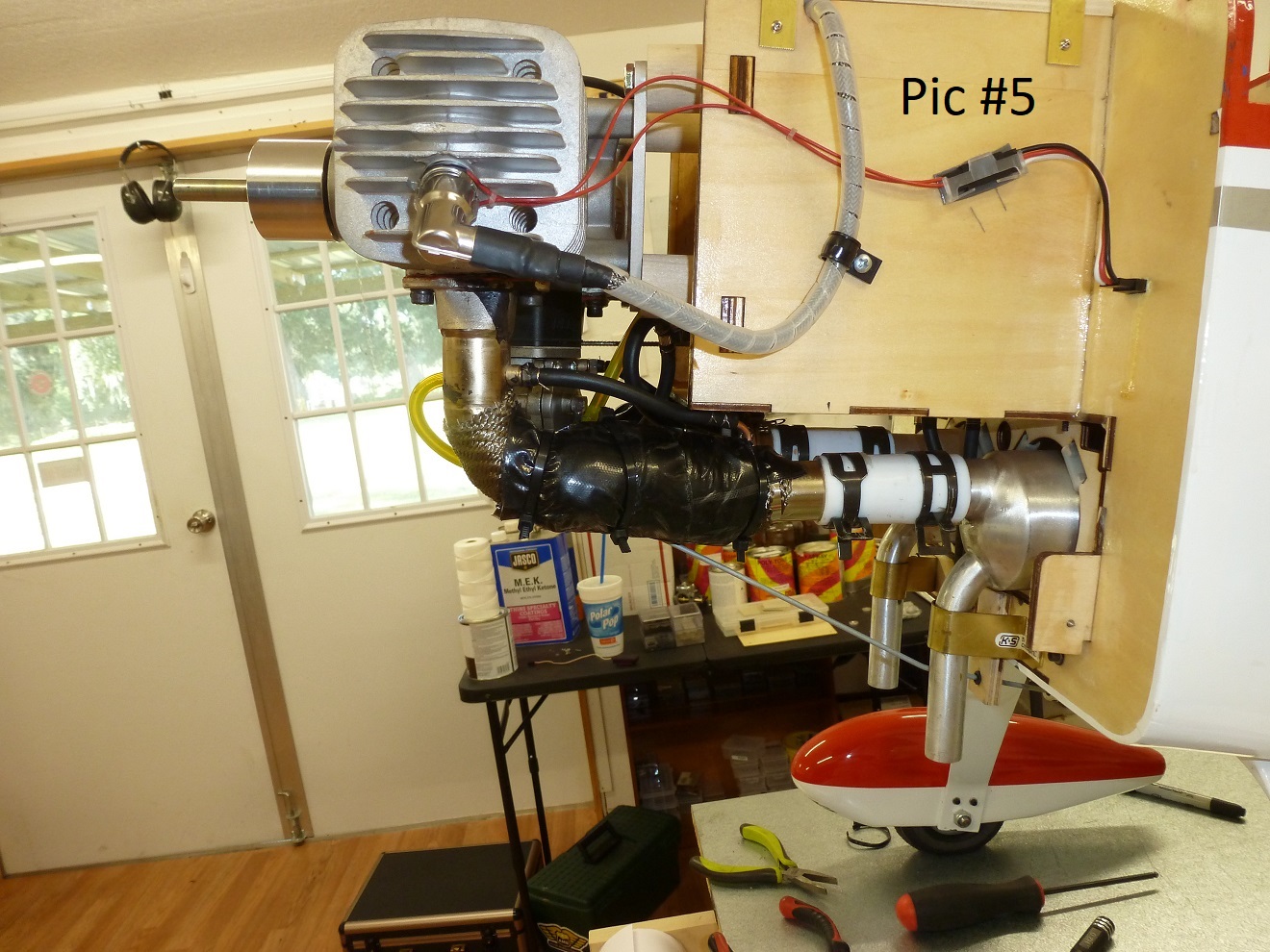

And lastly the exhaust assembled and ready for use. #5
I have measured temps under this type of wrap up to 500°. This really aids in running less oil and having no residue on an airframe.

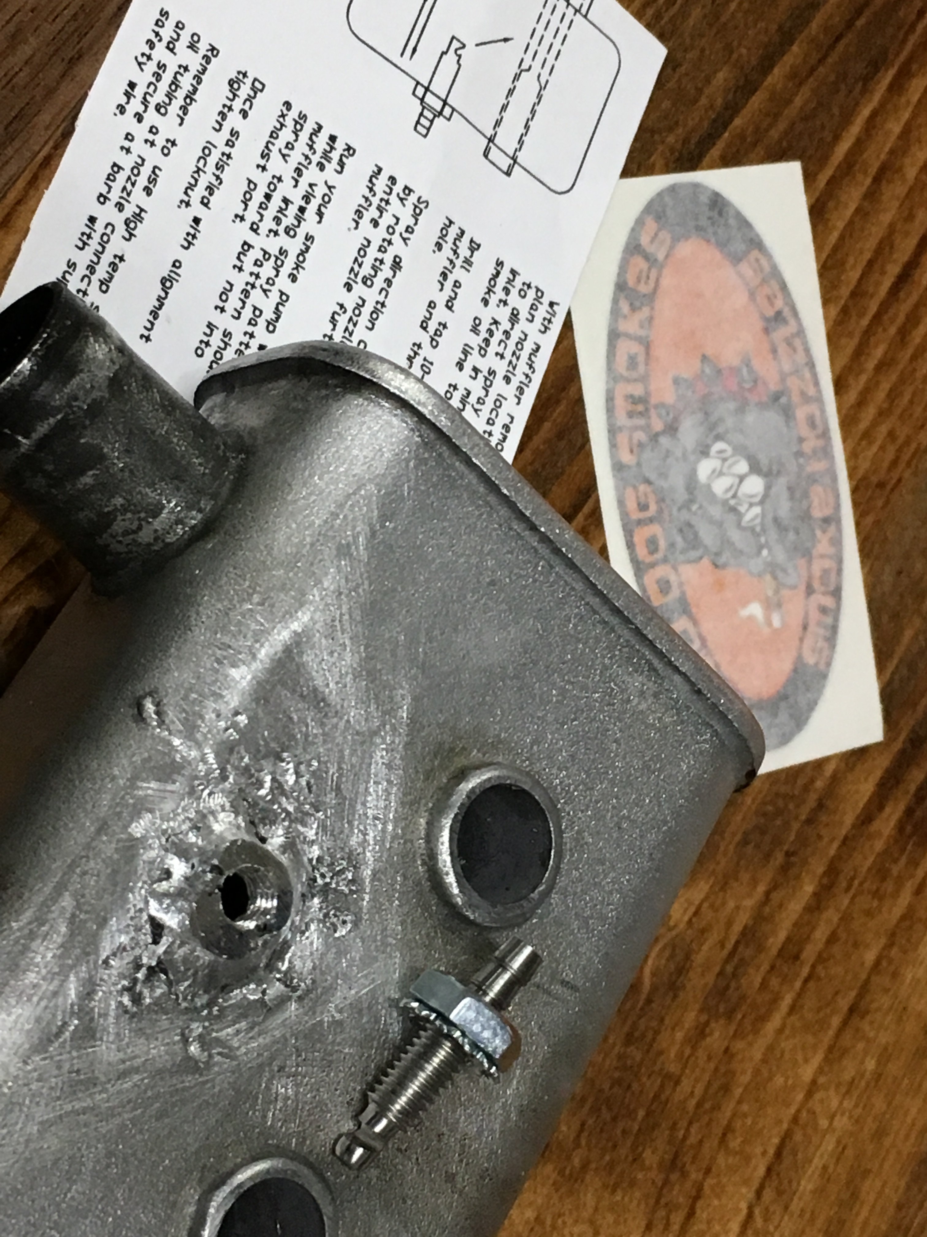

This is a Mad Dog nozzle with a powerbox smoke pump on a DLE35RA.
I would like to preheat because of the oily mess the current setup has.
336C1249-70D4-414F-9930-44A26173F655.png C26EC1CF-1115-4BF7-BDDC-4D09C8426842.jpeg
51FD9520-2327-452D-9C47-2CF22F0A4297.png 429996B8-5717-4219-9C79-37FB33A60C7E.jpeg
Had a coworker goober some more metal onto the thin muffler. It’s been holding up well.
