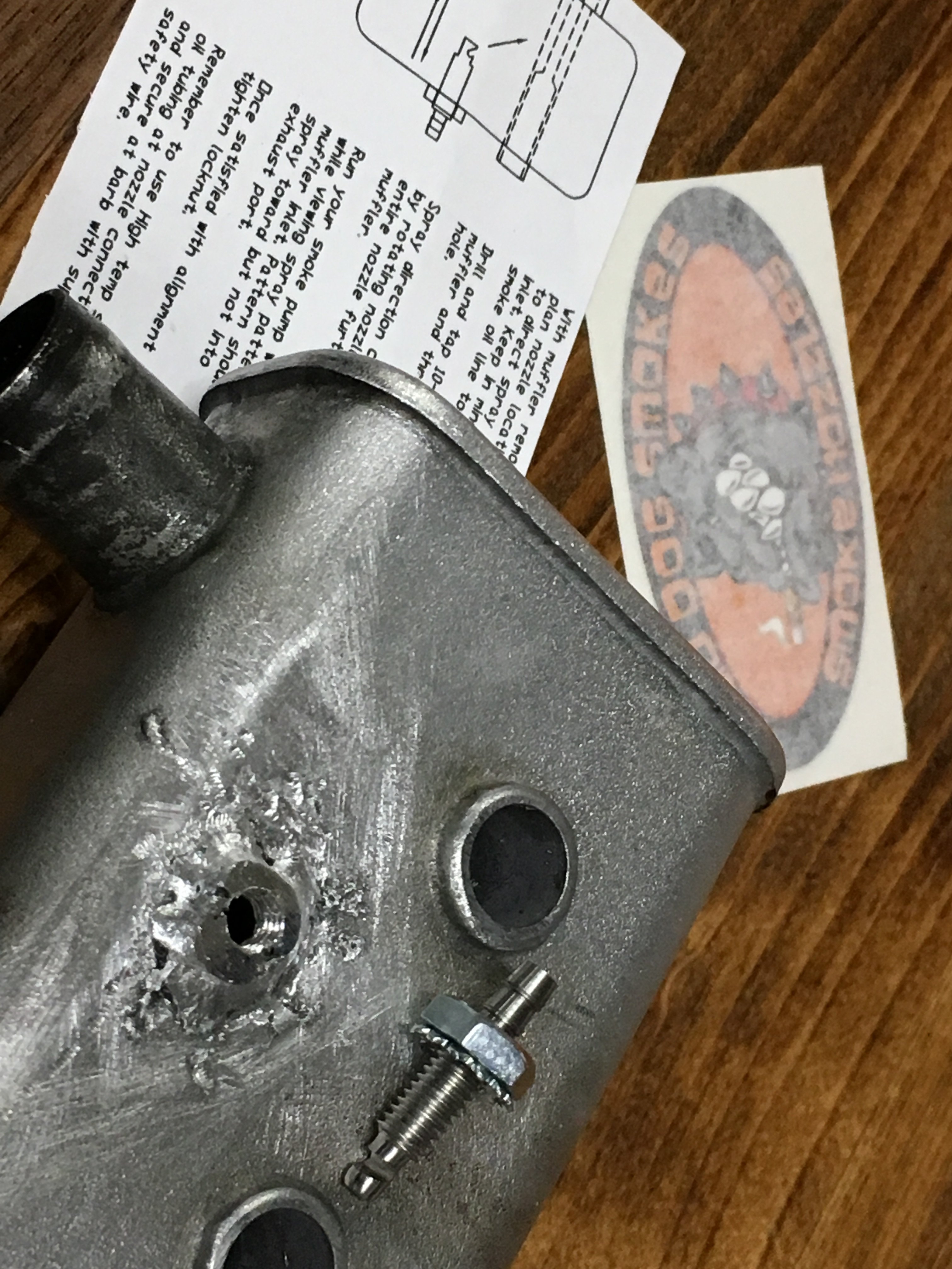

I actually did that on a silencer I made for the big Pitts. It turned out real well but that was a big can and I would not want to have to go that route every time. Just finding someone willing to weld it together was a pain, and it was way heavier than wanted. This way is easier, cheaper, and works very well.
