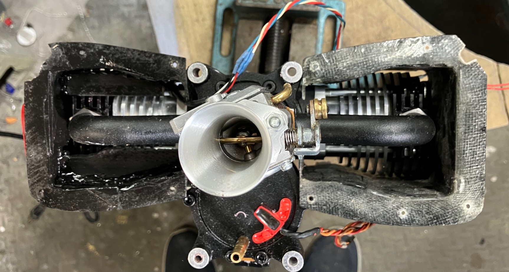

A Google search provided no insight however Google AI indicated that 300f was the high limit. When I questioned the source for the limit AI reported that it is not published however the limit was determined by experienced users of the engine. I provided a verbal description of the install and the first recommendation was to add air dams behind the cylinders to direct the airflow up and down the back side of the cylinder. The dams are installed on the left side in the photo below.
Before we go further let me explain the airflow path. Air enters the cowl though the scale like openings on each side of the spinner. There are also openings where the oil cooler and air cleaner reside in the full scale plane. These openings were never filled and provided an approximate double the size of the normal inlets. Air exits the cowl from the cheeks on both sides of the cowl since the cowl is about 3/4" wider than the fuselage, additionally there is a scale opening on the bottom of the cowl that looks to about 1" x 4" with a lip provided. I would estimate there is 2 1/2 to 3 times the exit openings than that of the inlets on each side of the spinner.

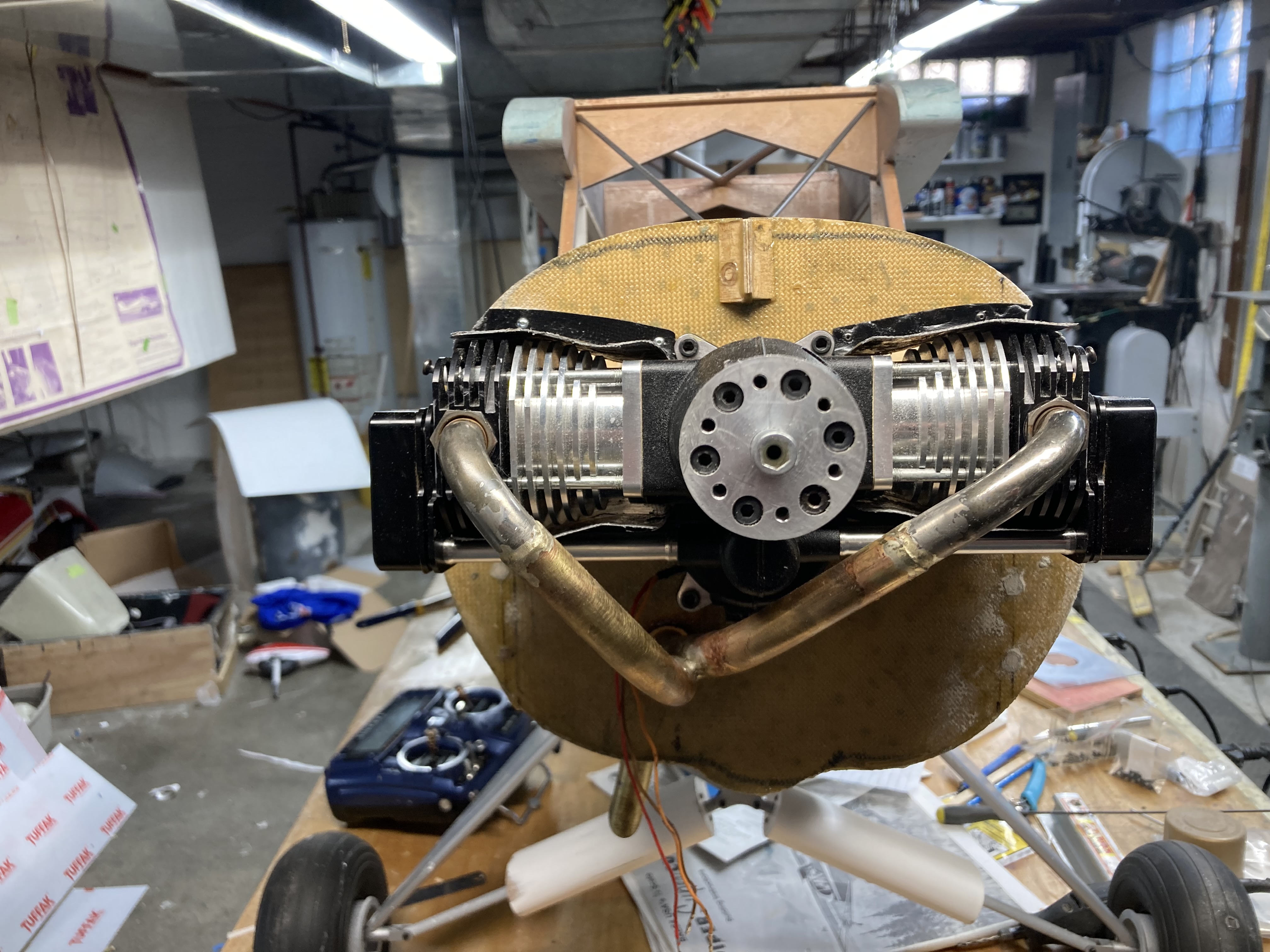

While flying this past week the air cleaner opening was covered with packing tape and the next flight seemed slightly better. The follwing flight the oil cooler was covered and that flight got worst. These results were reported to Google AI along with screen shots of the telemetry data. At this point I indicated to Google AI that I planned to insulate the exhaust tubes since the reside in the cold side of the baffle and my scale exhaust routing adds additional exposure right in front to the cylinders. See photo.
Google AI recommended using a product called Fire Sleeve rather the automotive header wrap. I ordered 5' of the product and elected to wrap the tubes with automotive insulation then wrapped the outside with Teflon tape. I suspect tightly wrapping the Teflon tape compressed the insulation and rendered it useless. The air cleaner inlet was blocked with balsa wood and the oil cooler opening is filled with 50% opening screen to simulate the oil cooler.

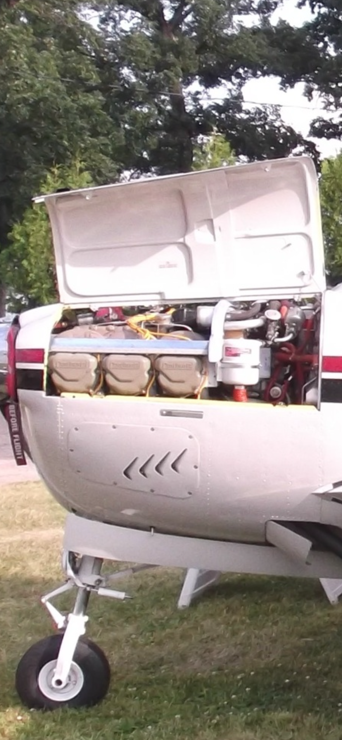

Interesting problem. If I understand the description with your accompanying photos, the ducts bolt to a baffle plate, ahead of the firewall.
Are the front to the ducts sealed against the cowl openings on either side of the spinner? What about the baffle to the cowl?

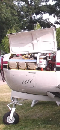

Note all the sealing between the baffle and the cowl, along with size the cowl flaps and gills on this full scale Bonanza. Obviously a lot of air moves through due to the speed of this airplane. Worst case is climbing on a hot summer day, but this engine stays cool.
