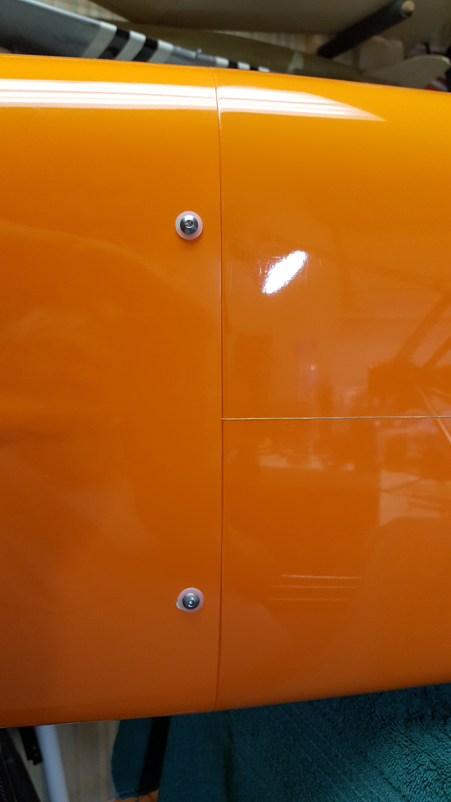

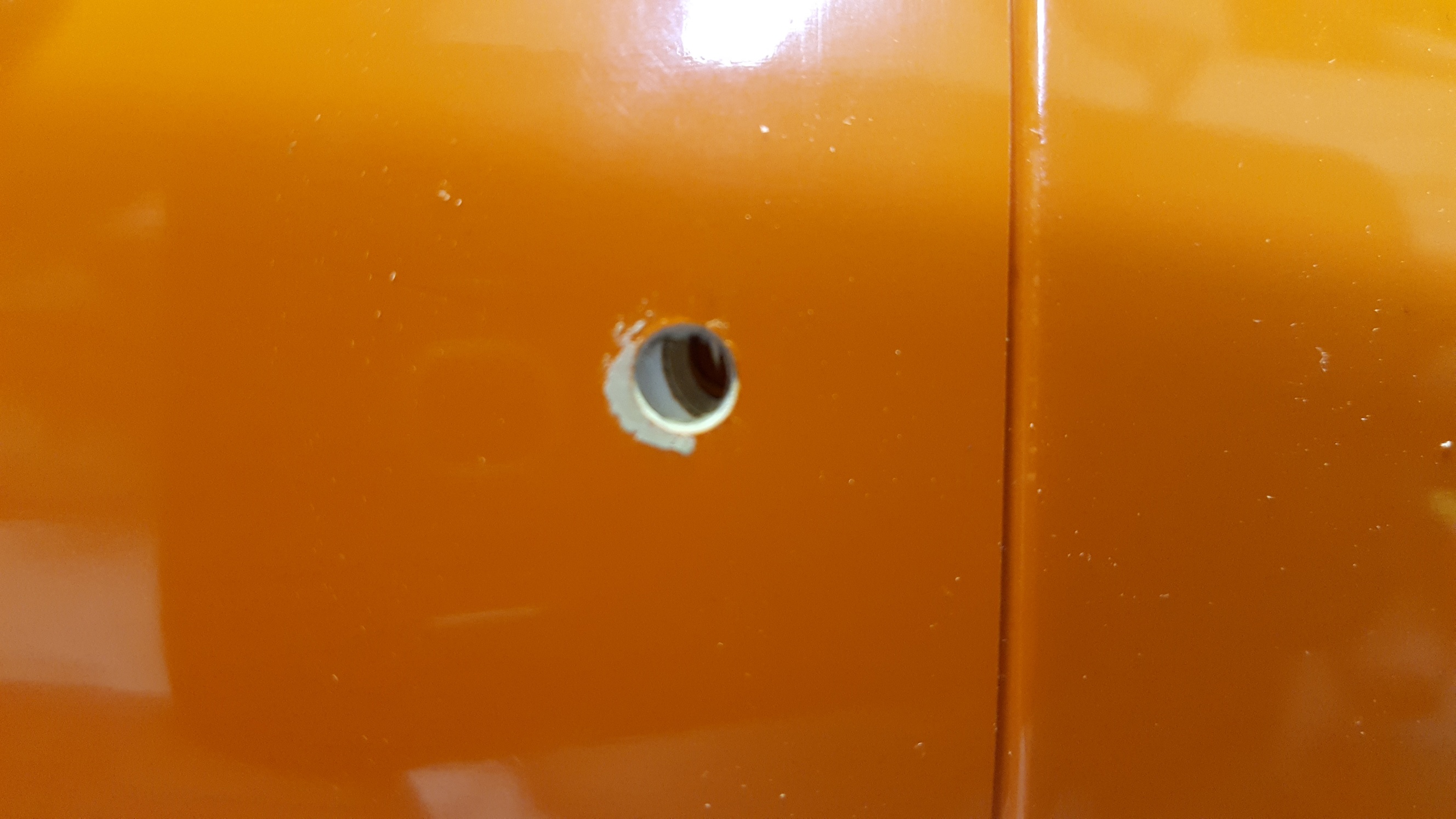

    I was able to get the cowl to fit really nicely, with a little argument. The two upper bolt holes are going to take a little filling, I had to move them a bit.

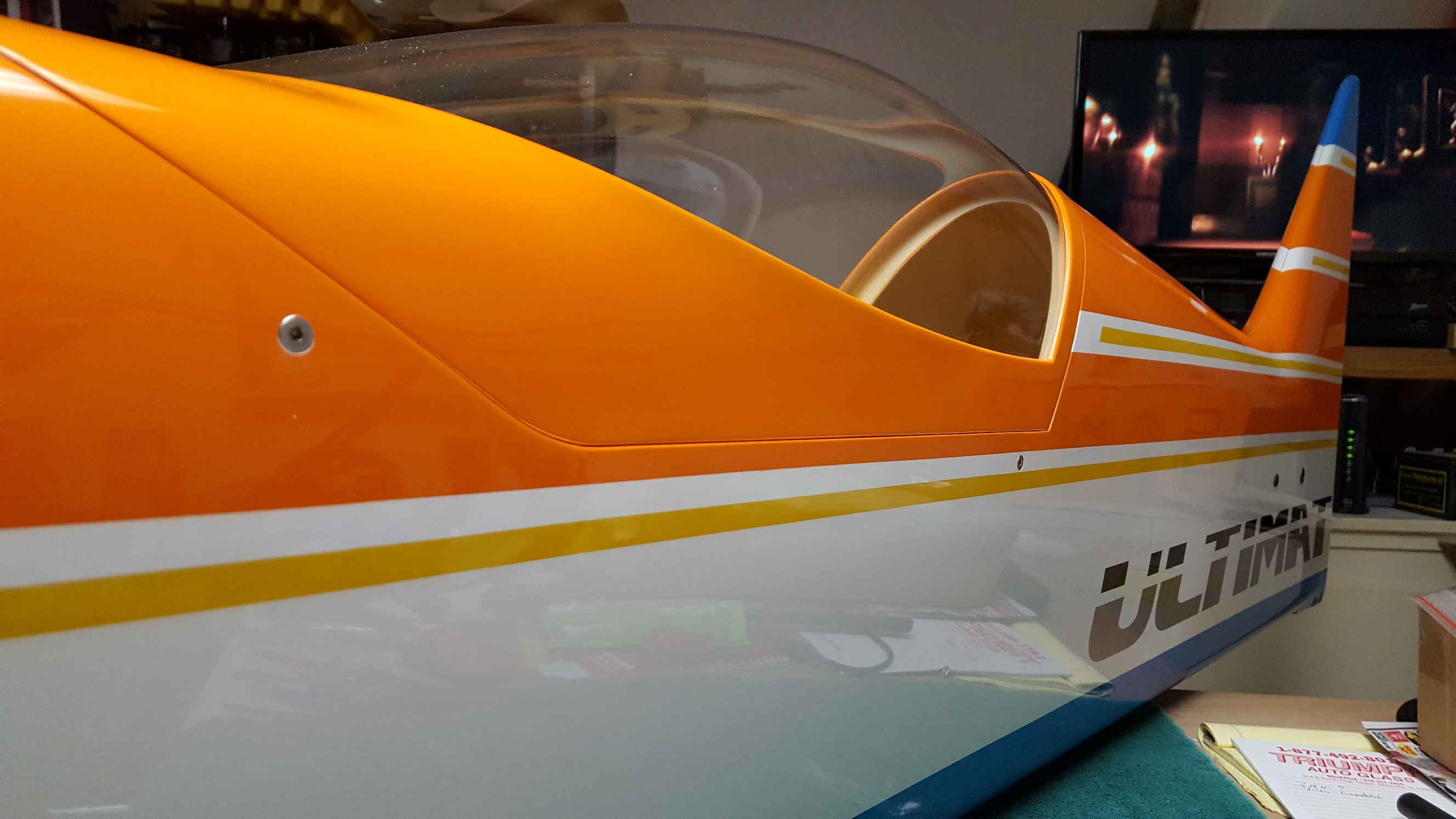

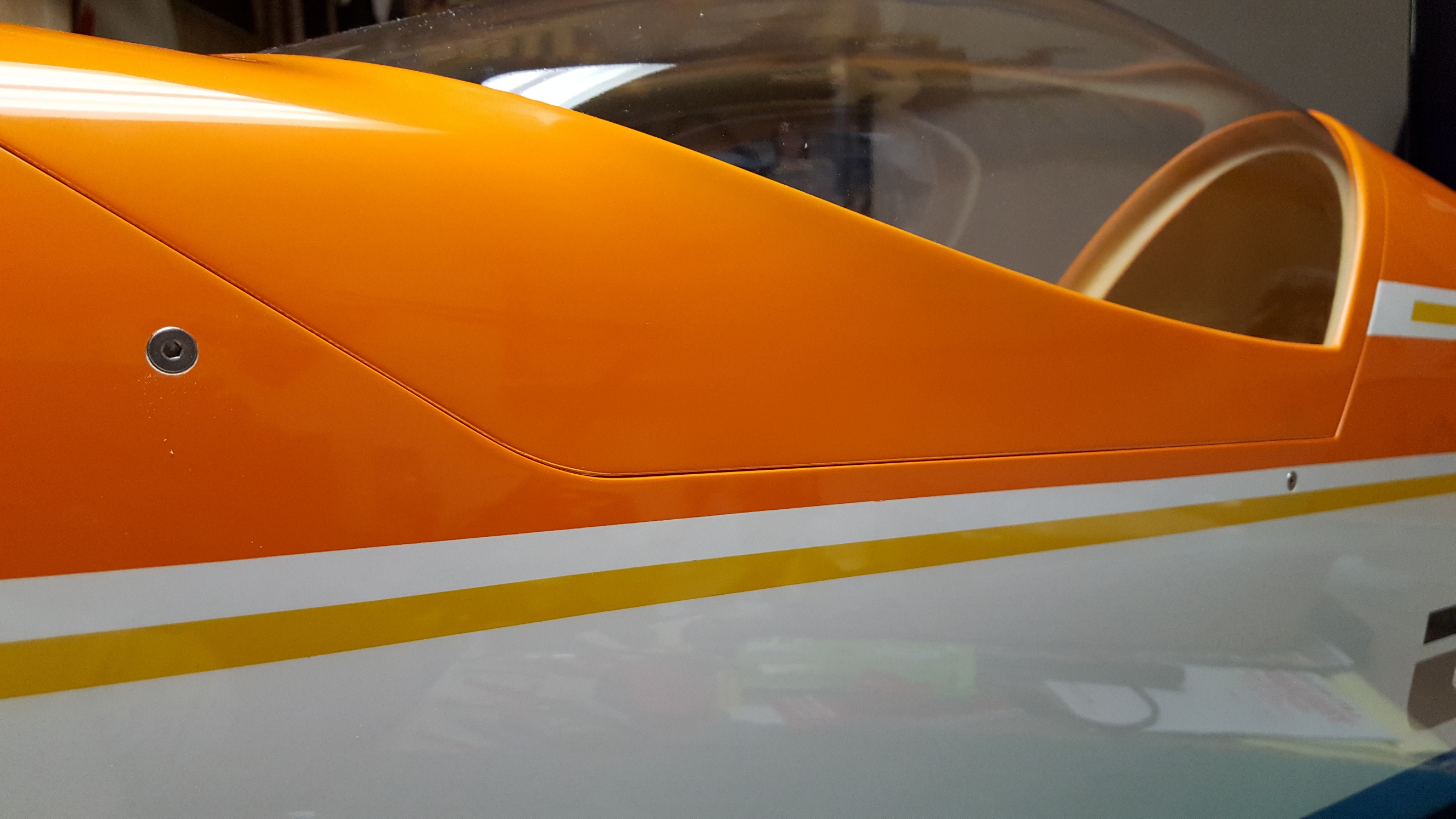

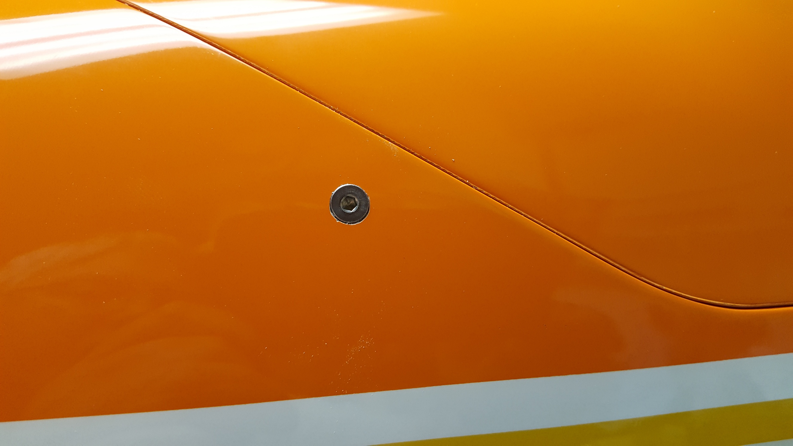

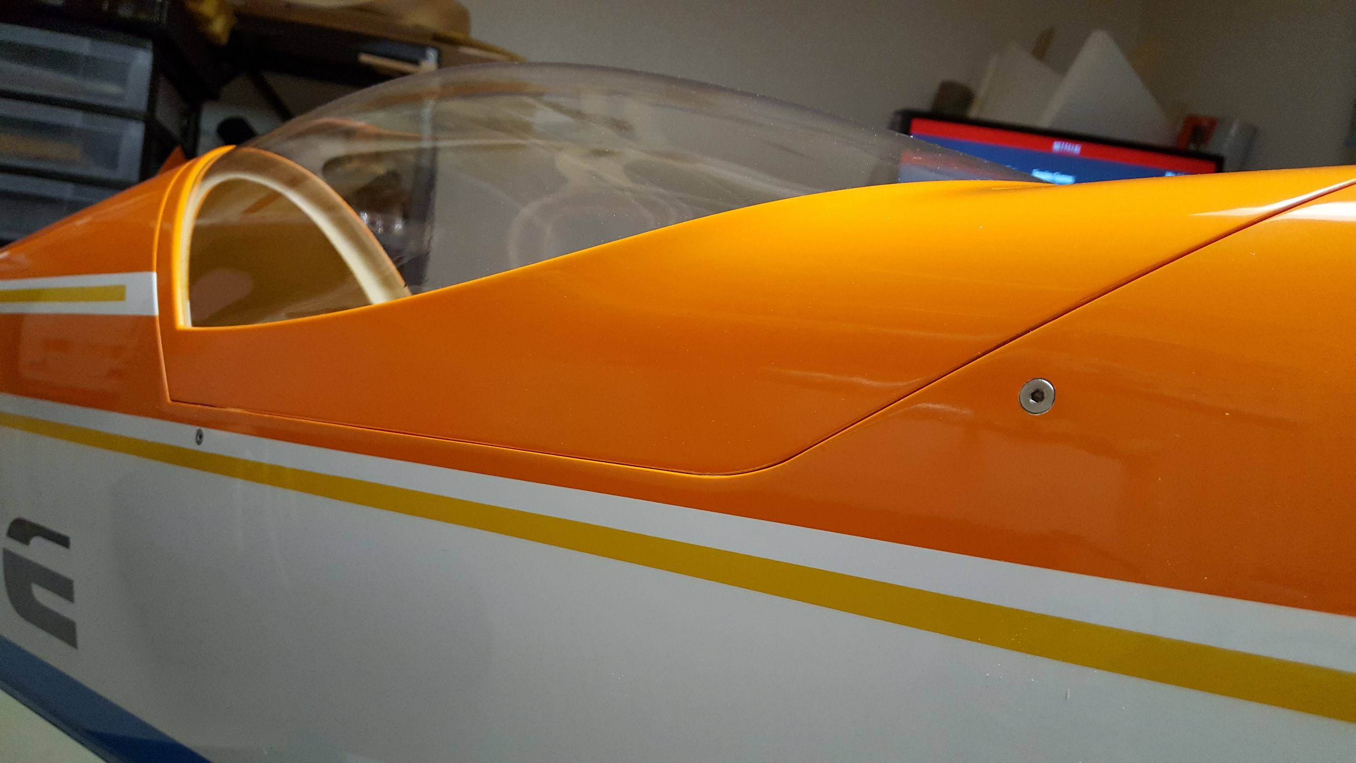

    I decided I wasn't happy with the look of the canopy bolts I used, so I decided to replace them with countersunk flat heads. I don't have the right countersink here, so I used a drill bit by hand, then a carbide burr by hand in a pinvise. It took a while to get them just right, but the results were good. I'll probably paint them to match.

    That's straight up P.I.M.P. what you did with the canopy bolts.

    That is a really terrific idea with the counter sunk canopy screws. I have often wondered why more ARF makers didn't dream up something really cool. I have resorted to the Seacraft affixing hardware. Though I think it looks nice, the counter sunk method is much cleaner and...well, just really sexy.

    Nice job on the counter sink screws, that not easy to do because the centres have to perfect.

    NICE!.....it'll be 1 mph faster now!!! Not sure i'd paint the screw heads....they'll get chipped eventually from the allen wrench.
