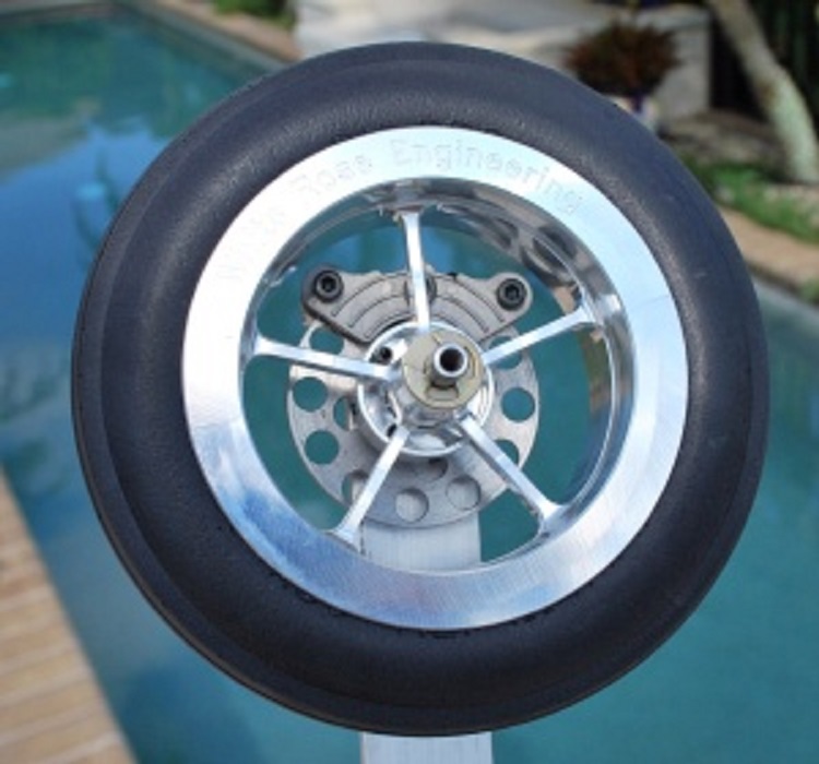

You can also try these for making it stop quicker. White Rose brakes
