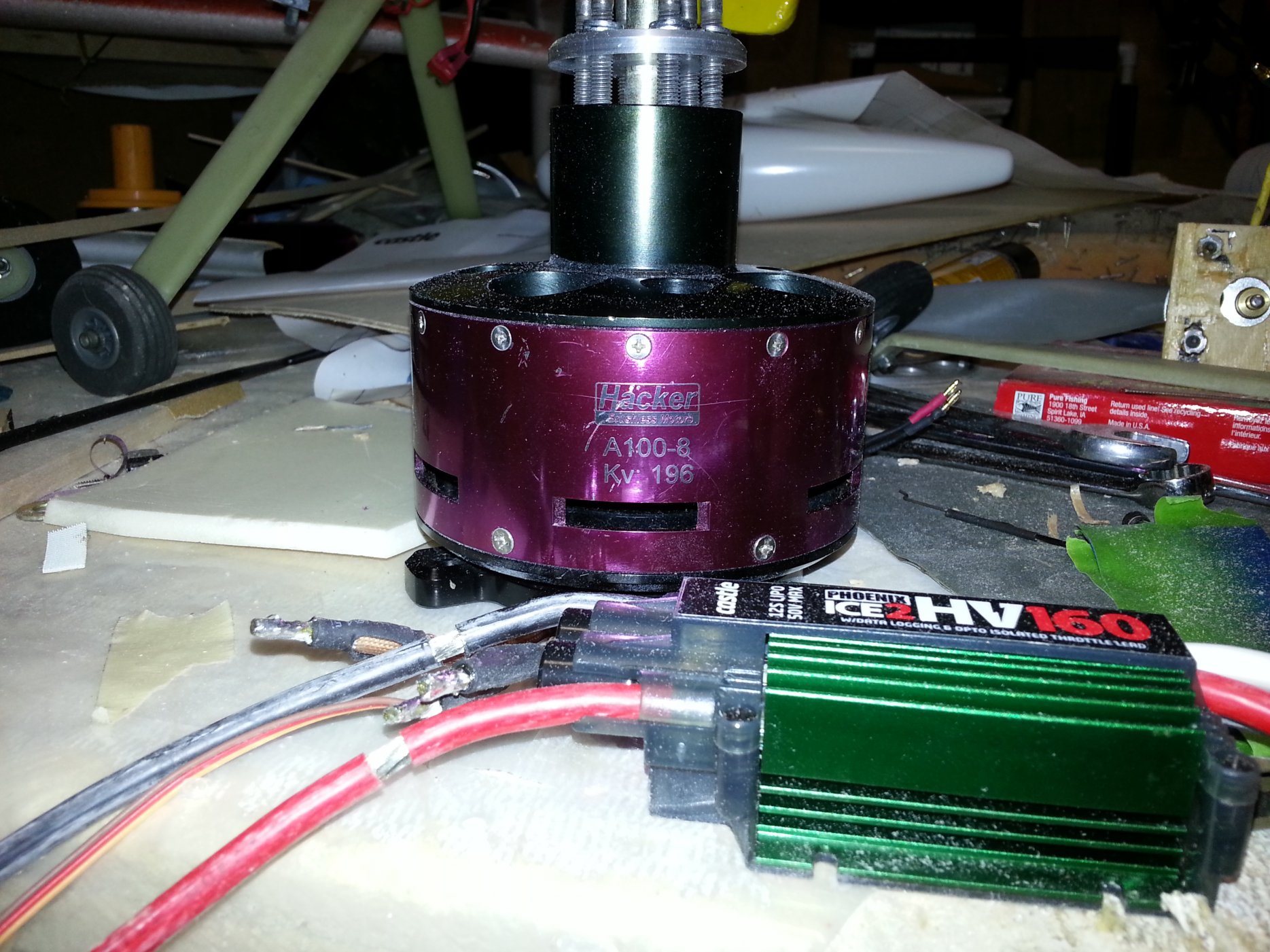

My current large set up is a Hacker A100-8 spinning a 28x10 xoar prop, with a Castle 160 HV2 on 12s 10k. Flying a 26 lb 96 inch wing Sbach profile. Its a huge floater!!!
