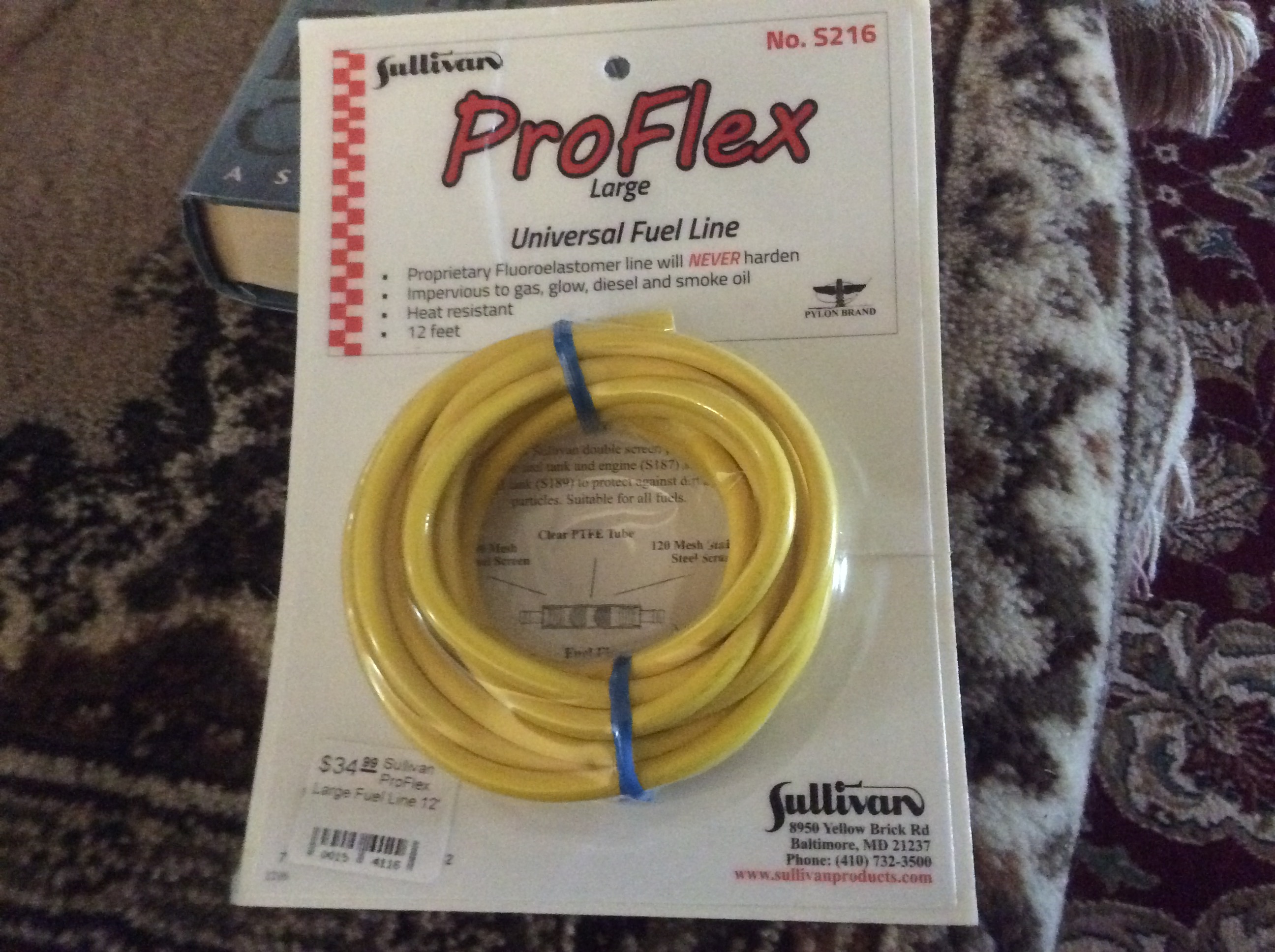

Viton = (thick wall and black unless it's the Sullivan Pro-Flex version of the stuff which is tan) best for inside the tank. It's expensive, but will last forever. PSP sells the right stuff in a thicker wall, wont kink as easy.
