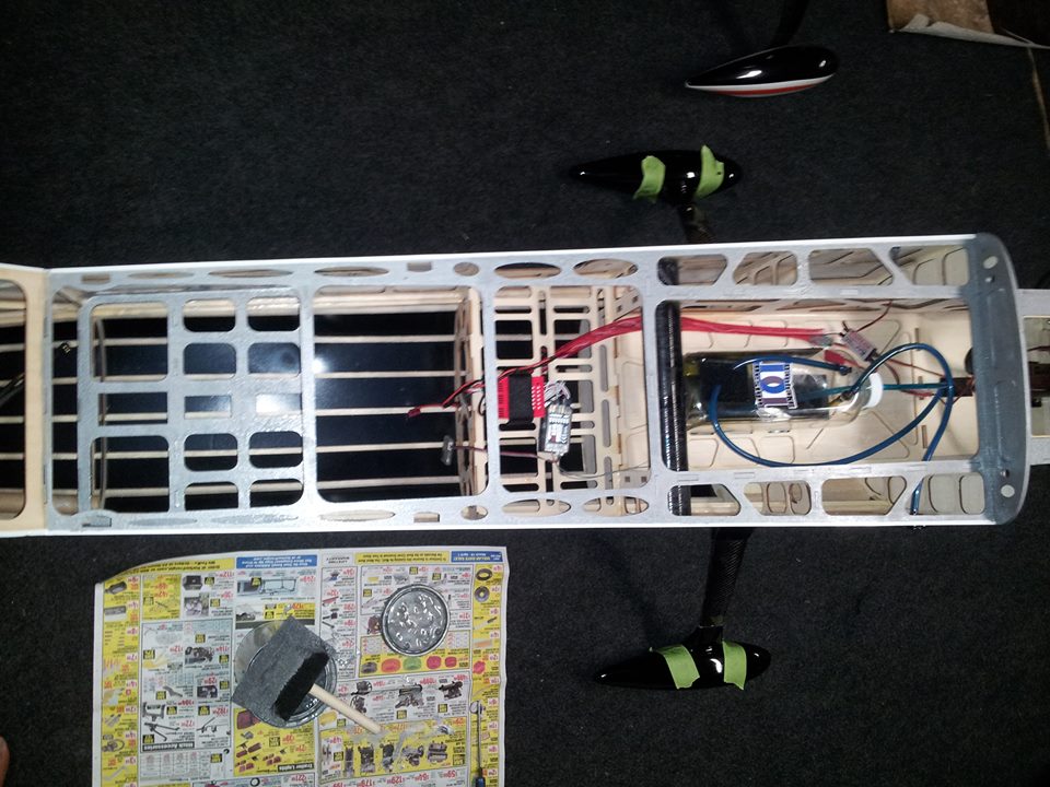

So in the down time I did get my aileron servo's and linkages set up.. I use the TDRC MPX harness's 12" rx side to 6"-20" wing panel side. Fit's purrfect!
Alos added some more hammered silver paint to the inside frame work were greasy hands at the field can touch.. Bling my friends

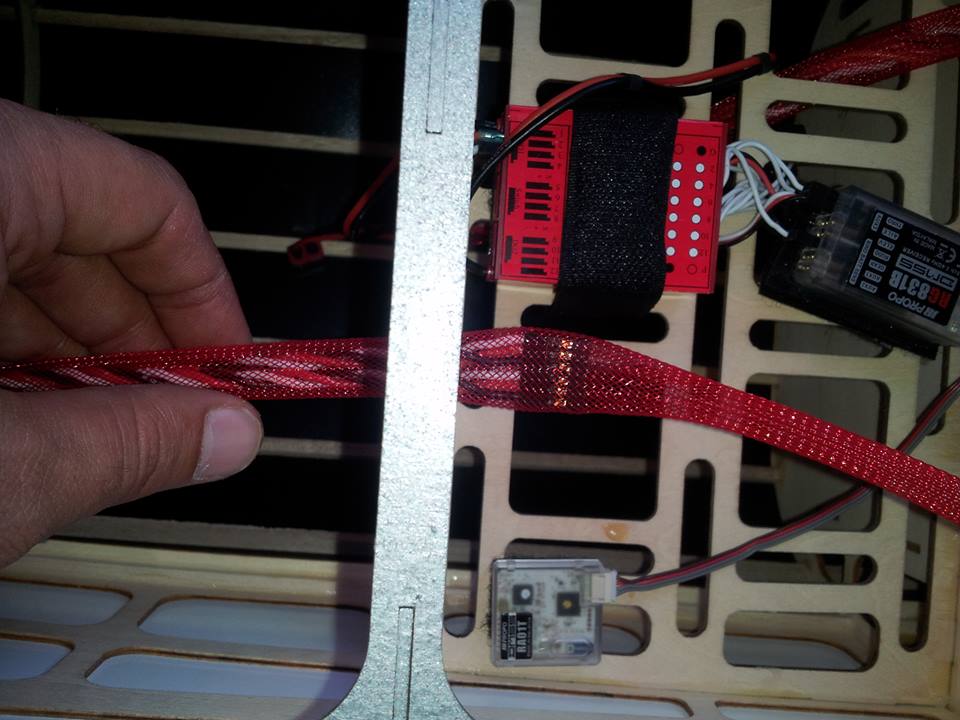

Meanwhile I have been using our TDRC snakeskin (mesh) to route our 20 AWG servo extensions. This stuff is super expandable and I easily fot 2x 20 AWG wires through it.. After it is ran I use a little shrink tubing on the end..
Also I got a new Smart fly MICRO 12 from Rob.. Has all the features of the regular larger expanders in a tiny package... Love it!

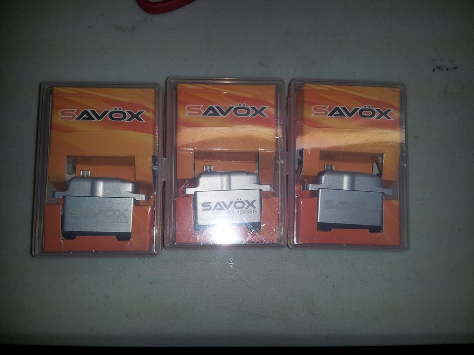

Got my savox 1283SG servo's in today! Installed them within an hour LOL!..
These servo's are the best bang for the buck on a123 voltage.. Over 400 ounces of torque at 100.00..

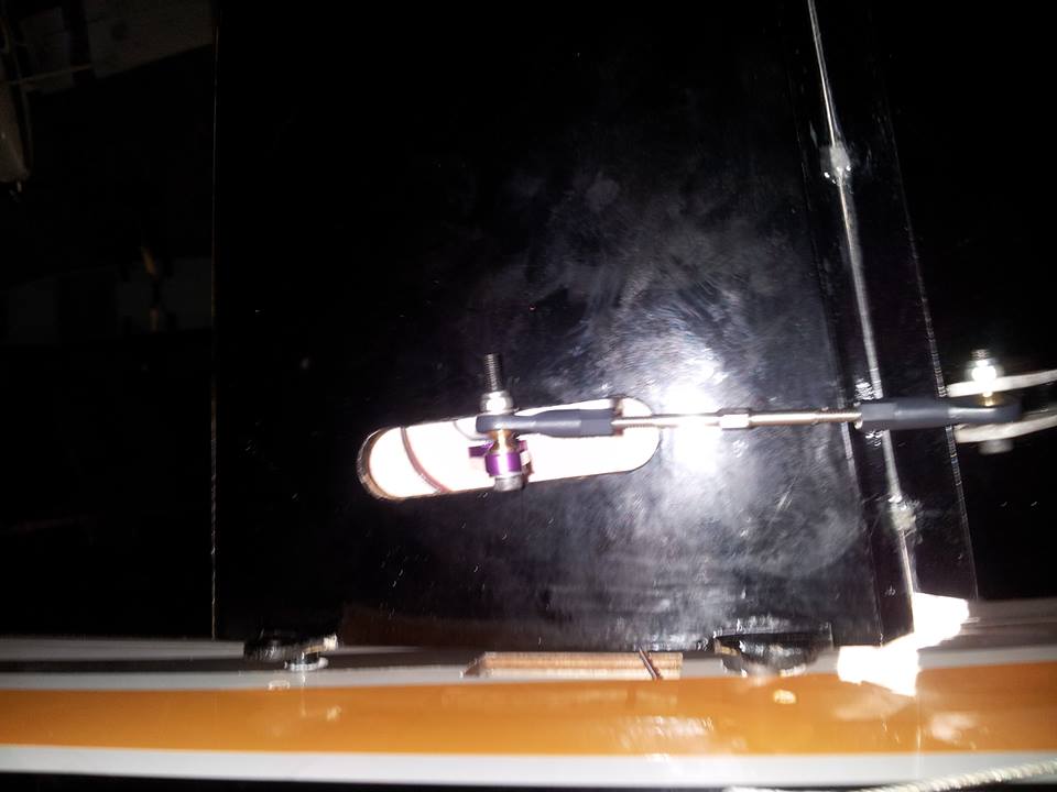

Installed one on the rudder in the TDRC carbon rudder tray to keep the strain off the servo spline and more linear rudder, looks cool, and weighs nothing.. No mods what so ever to install this.. Drops right in the existing factory cut-out's. Also used the TDRC 3.5" dual alloy servo arm for the rudder arm to the tiller arm. These are great arms for the money. They fit TIGHT..

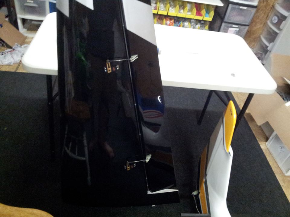

Put the other 2 on the elevators with TDRC servo arms..
