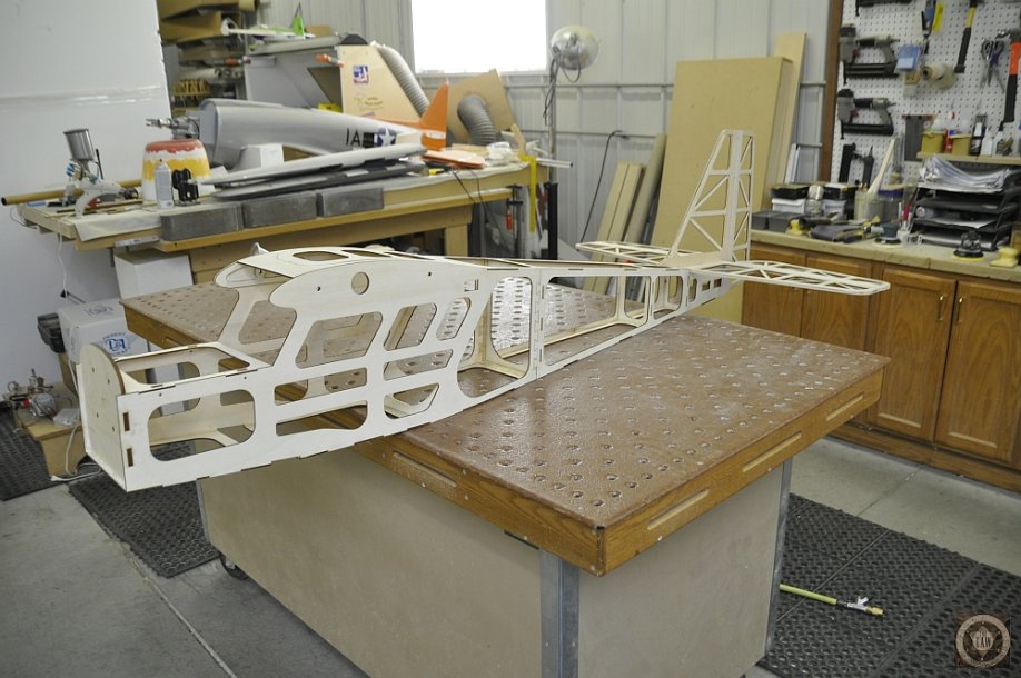

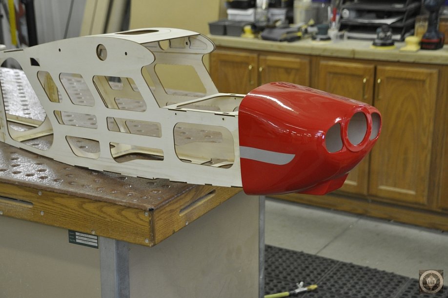

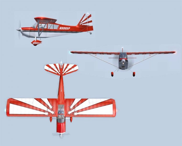

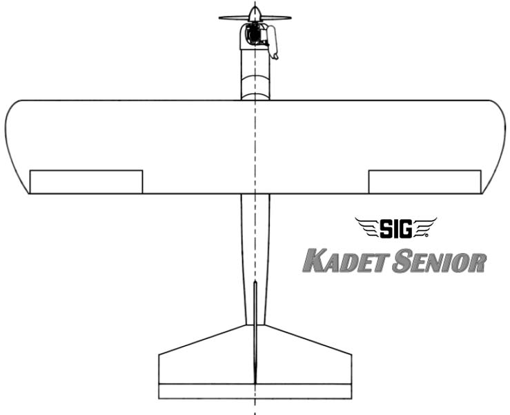

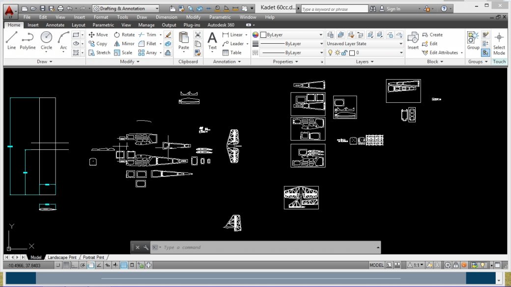

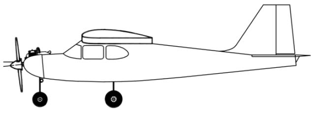

Well it seems that as I go around I see more and more 3D guy's with at least one warbird and one modified trainer or other scale flying plane in their trailer. @thelaw and I have a Decathlon but it's a bit big to just toss in the truck for a quick trip out. So, I figured I'd design my own. I cot a chance to fly a friends Kadet modified with no dihedral and with ailerons and it was a hoot. I I started sketching.
Now if anyone knows how I work it has to be two things (other than nice flying)......
1 - EASY TO BUILD
2 - Badass
What I ended up with will be 102" wing, 78" long, swamper tires, two cylinders and with luck under 17 pounds.
Took about 8 hours of drawing and so far 1.5 hours to build the fuse....

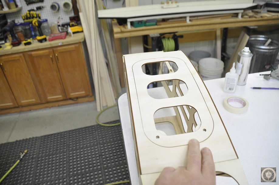

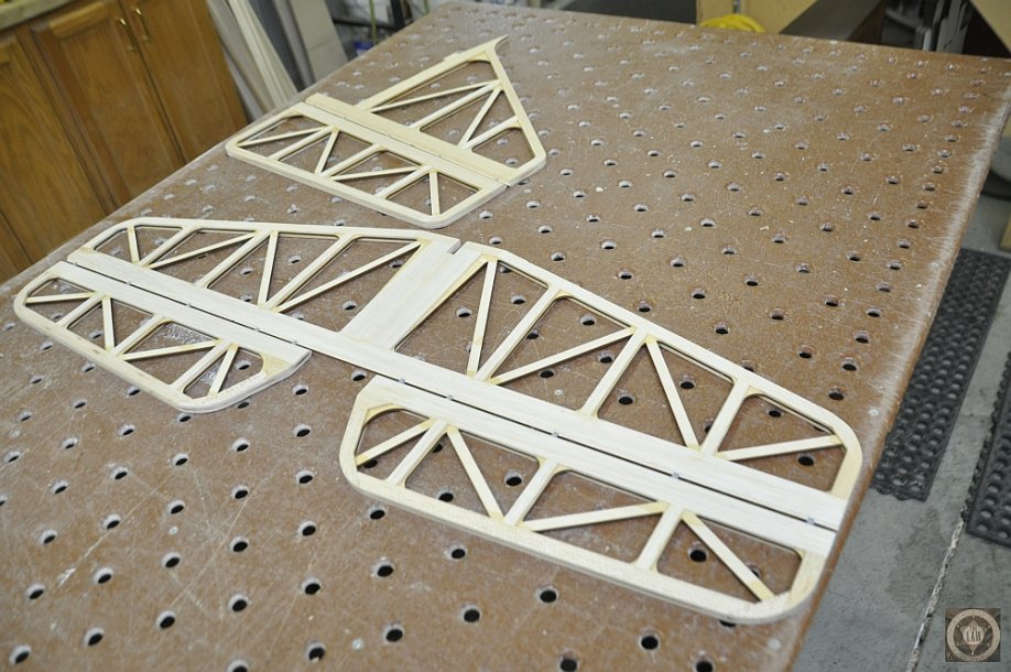

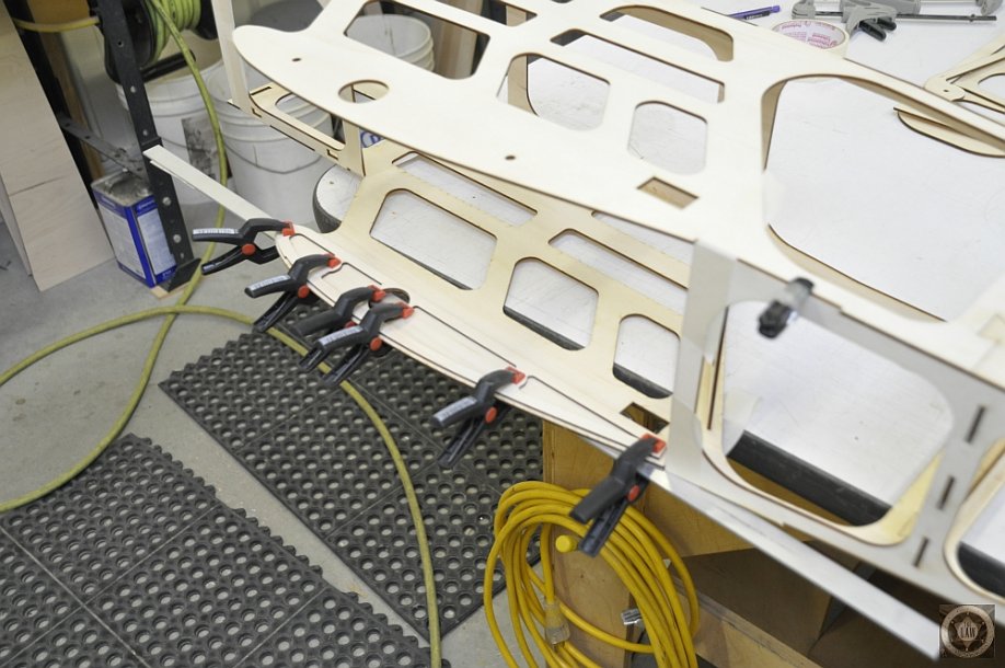

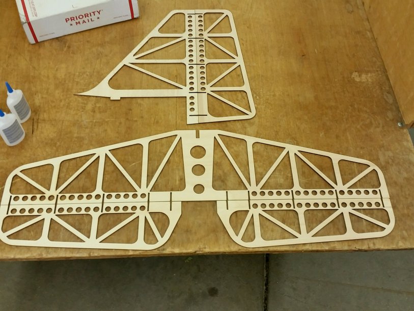

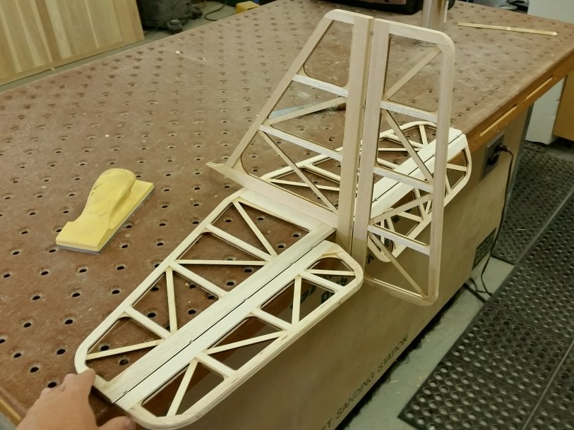

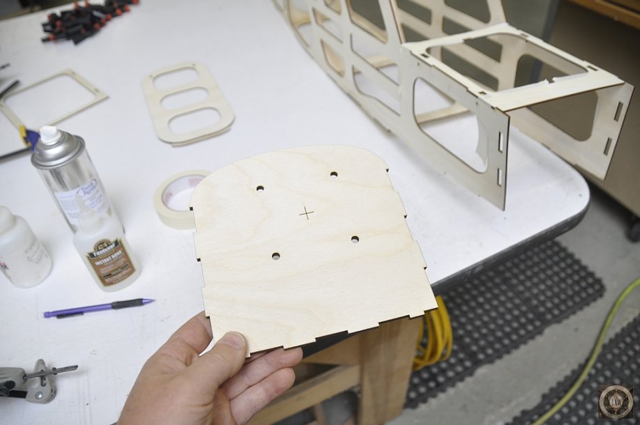

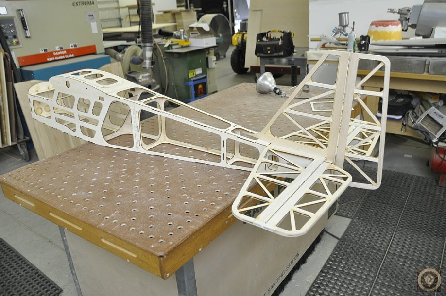

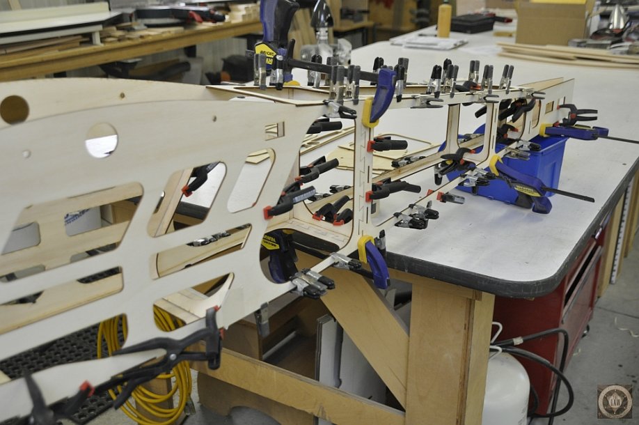

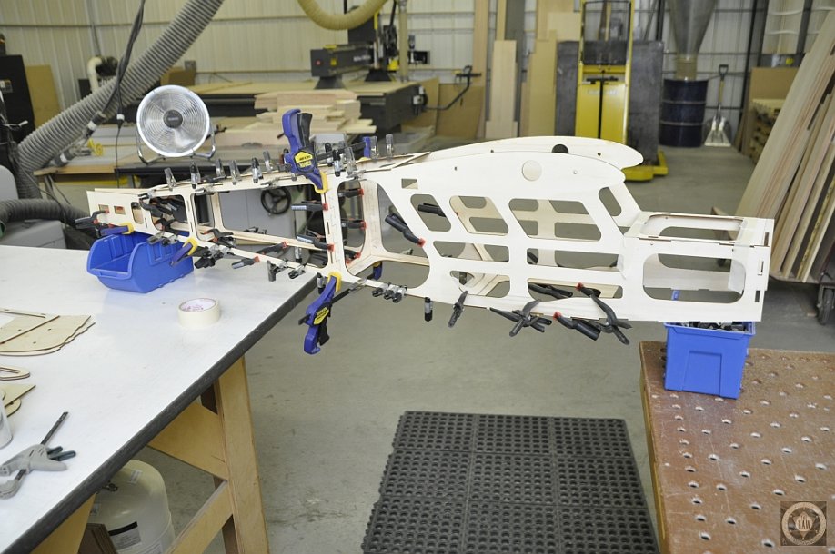

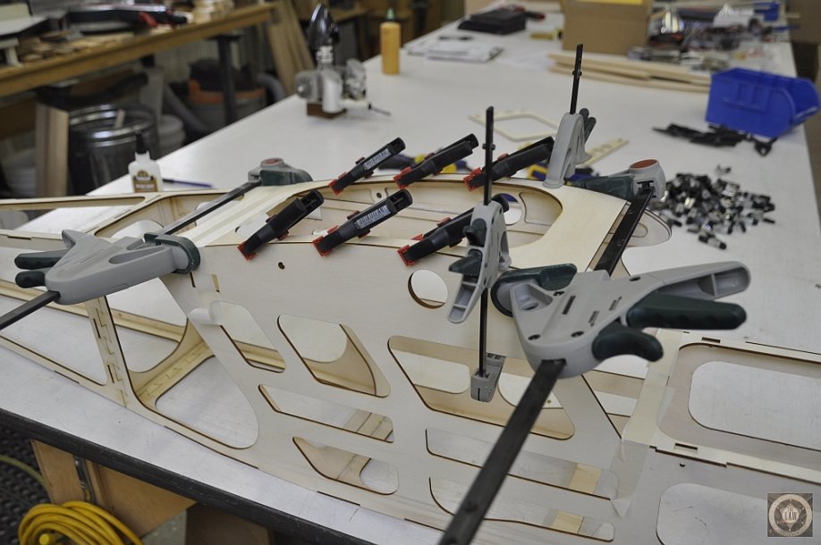

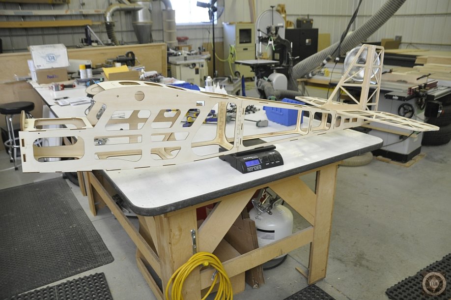

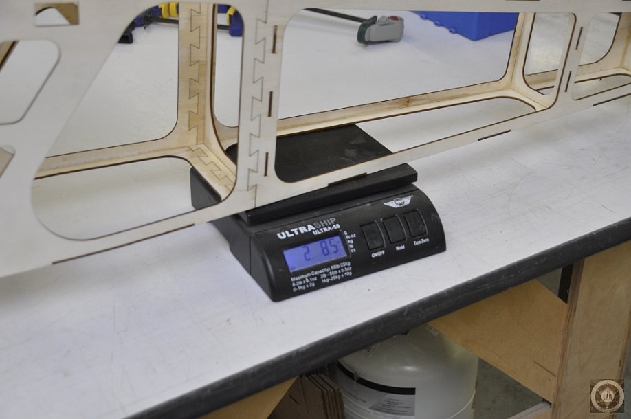

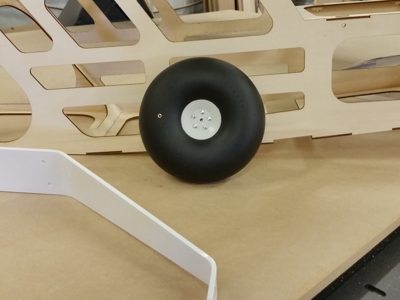

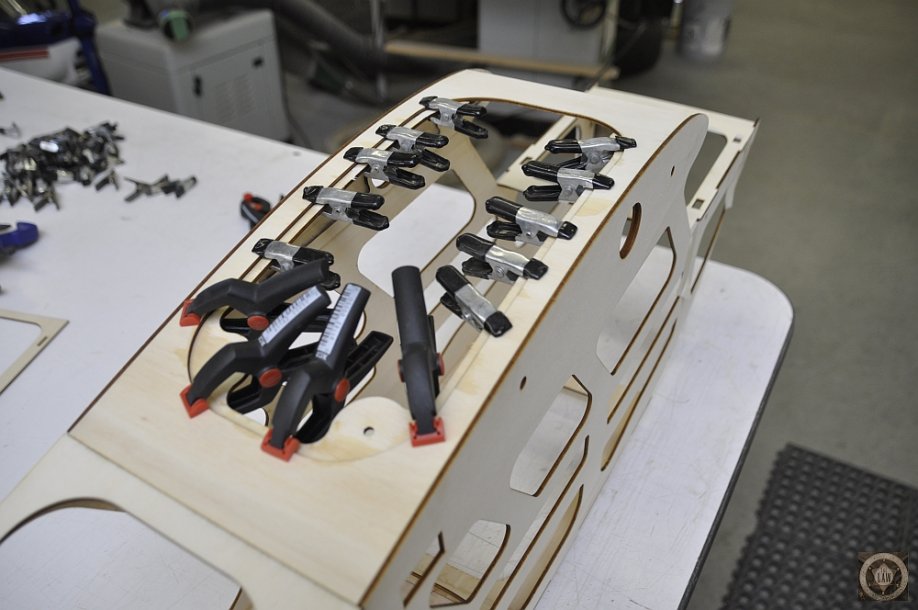

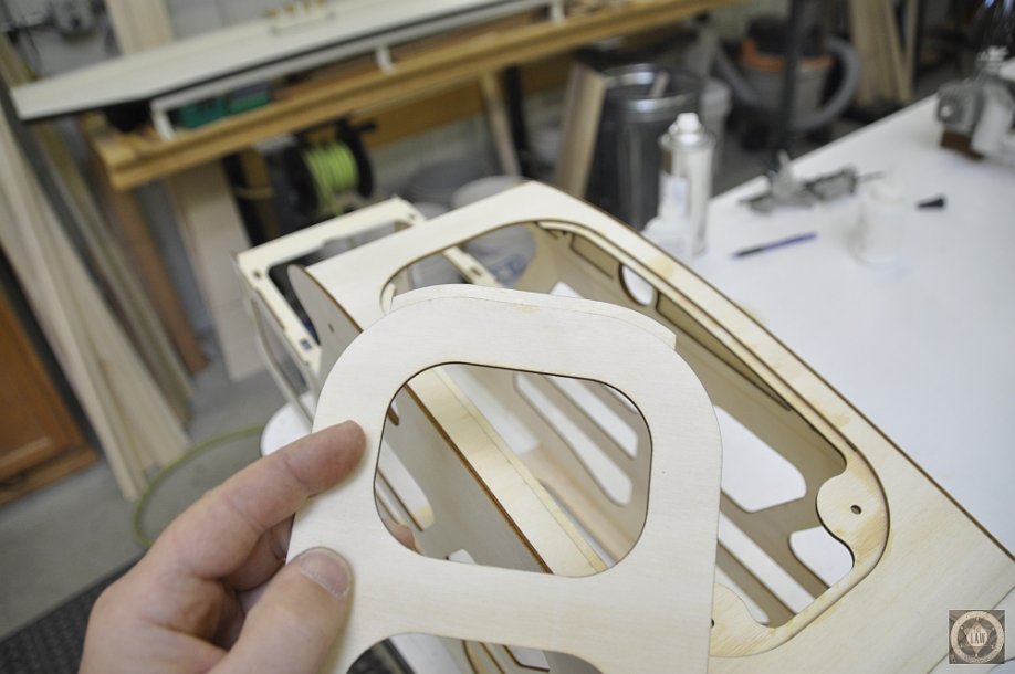

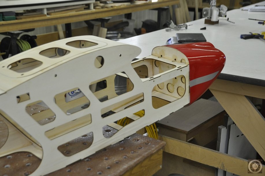

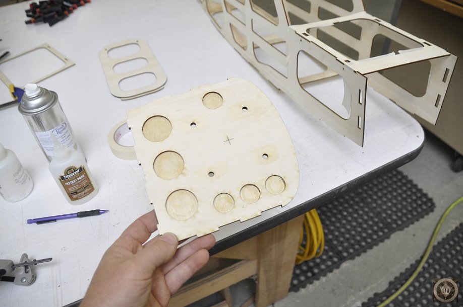

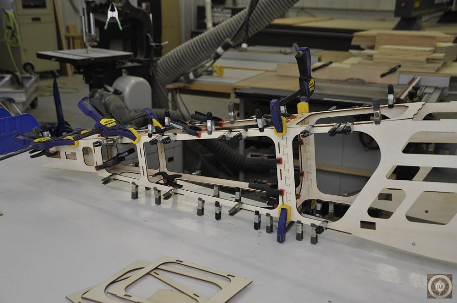

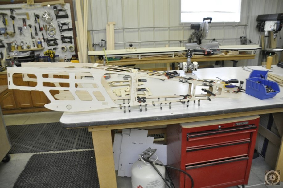

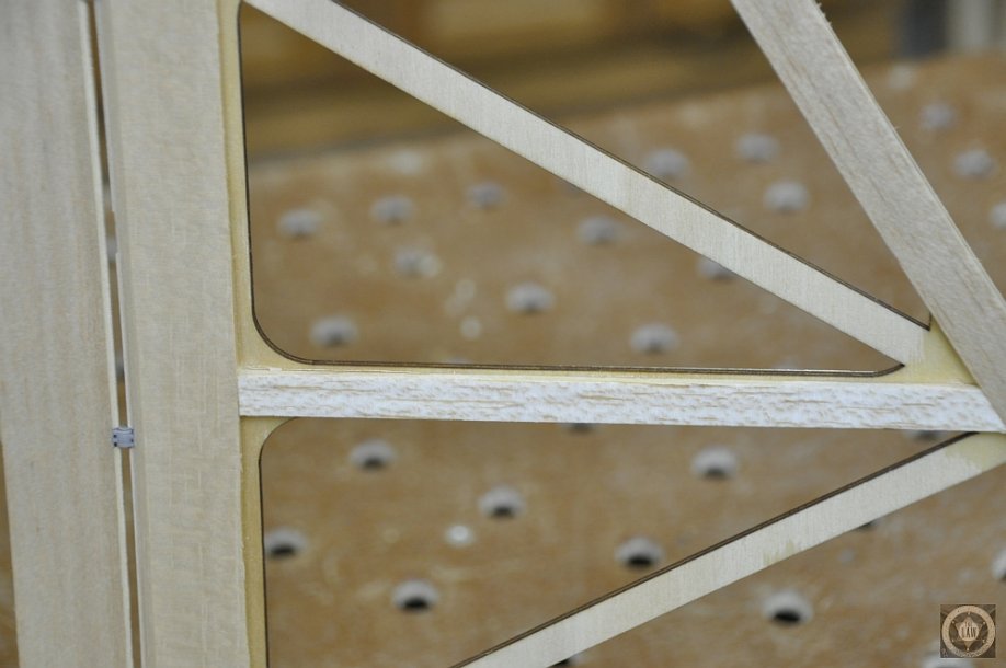

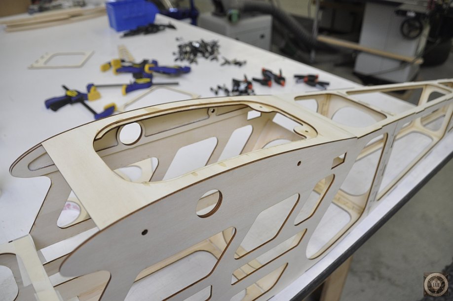

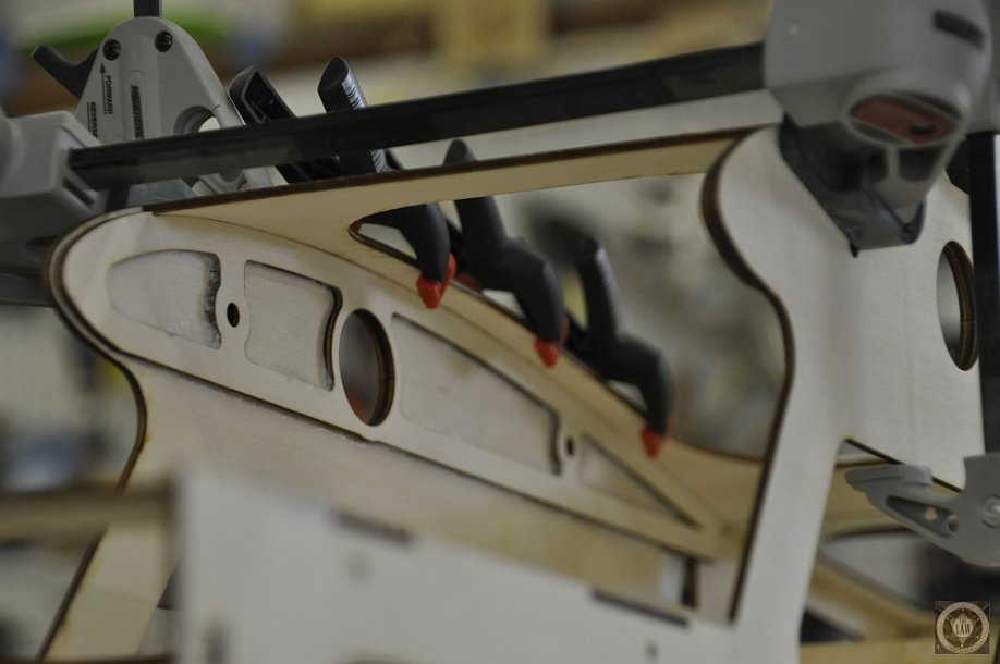

Assembly so far, cutting foam wings and canopy tonight. USPS just showed up with my landing gear and wheels:mario-banana:. LOL, if we did not have plans this weekend I could fly this thing next week!

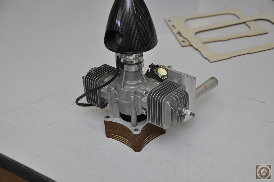

HOLY CRAP! Terry you never cease to amaze me. I'm thinking my DA70 would work well on this.:D
I like the way you think.....should I PM my address? LOL. Just kidding. DLE60 twin up front will do nicely. I picked a nice semi-symmetrical (Selig 8036) airfoil so it will fly nice inverted and should still 3D nice as well (just to scare the O.G.'s at the field).:laughing:
