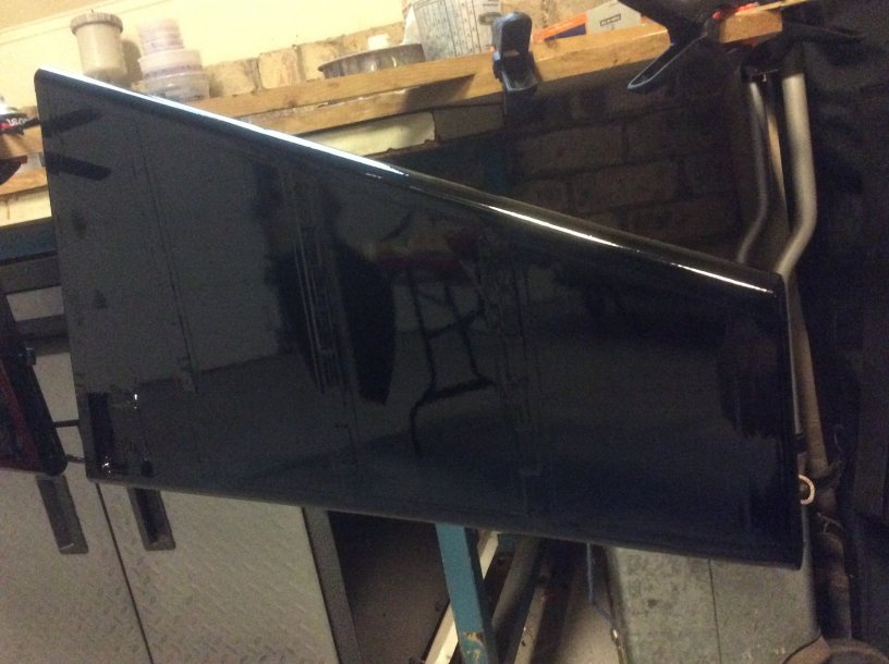

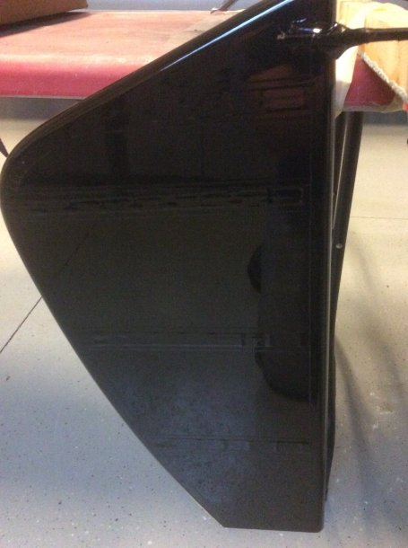

The last thing I worked on today is the canopy. I hate canopies. Lol.
Magnets and clamps with Forumula 560.

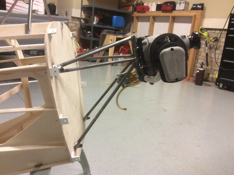

I have some interference with one of the carb mounting bolts.
I'll have to cut the bottom tube for clearance.
I also have to make the delren bushings that will go between the engine and the mount, and between the mount and the firewall.
You can see the bottom engine mount not touching the motor mount because of the carb bolt hitting the bottom bar on the mount.
did u use a little Harbor freight mig welder for the engine mount what heat setting???
