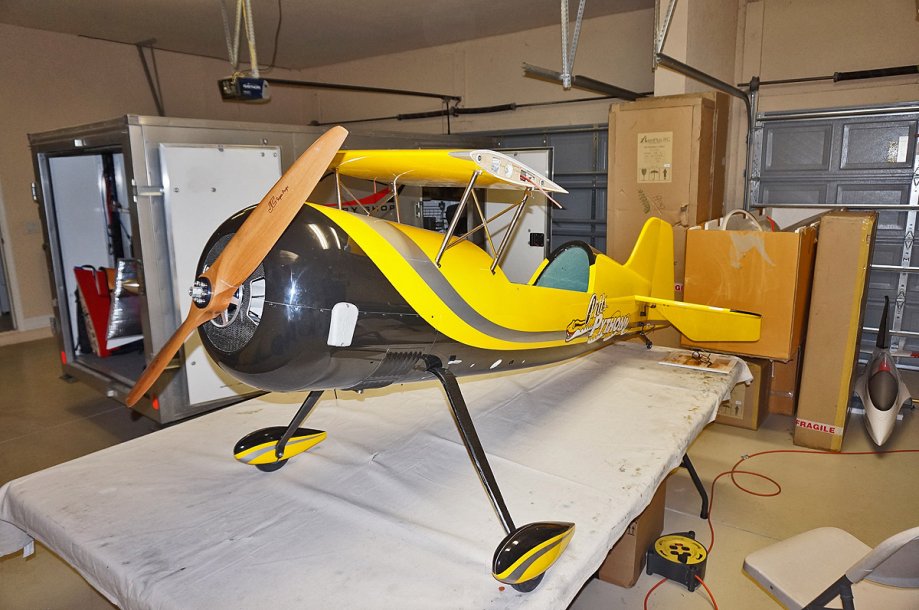

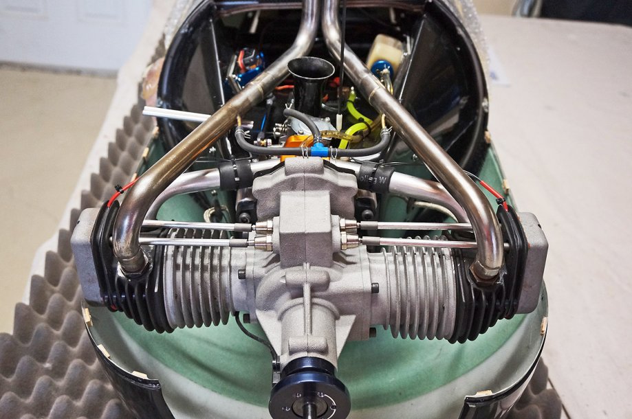

Matt, how do you like your Pitts with the Vallach so far? I have a similar plane and setup (Carf Pitts with a Valach 210) and after spending a lot of time and $$$ on finding the right prop, I enjoy it very much. My Pitts weighs "only" 49 lbs, but was lacking power on uplines and speed on straight lines. I tried the recommended Fiala 36x14 (the worst), a JC 34x16 (better) and Biela 32x18 (good).
Thomas
MattyMatt
Thomas
It's getting significantly better each flight. I turned in the top end close to a 1/4 turn after that flight.
Two things I would highly recommend:
1. Get the Y pipe and make the primaries the correct length. It will make 2-300+ rpm over stock exhaust.
2. If you aren't running a fuel pump, get one.
I was turning 46-4750 rpm with the Fiala 36-14. I will get a 34-16 to try as well for more speed, although I'm pretty happy with the power that's coming on now. It was also 92-95 degrees when I flew.
I'll finish breaking in, get the plane setup... Then play with props.
