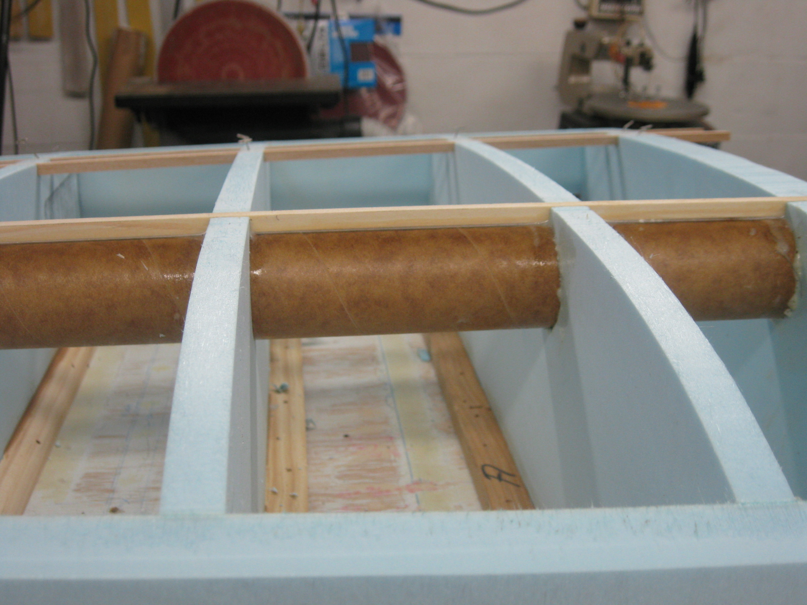

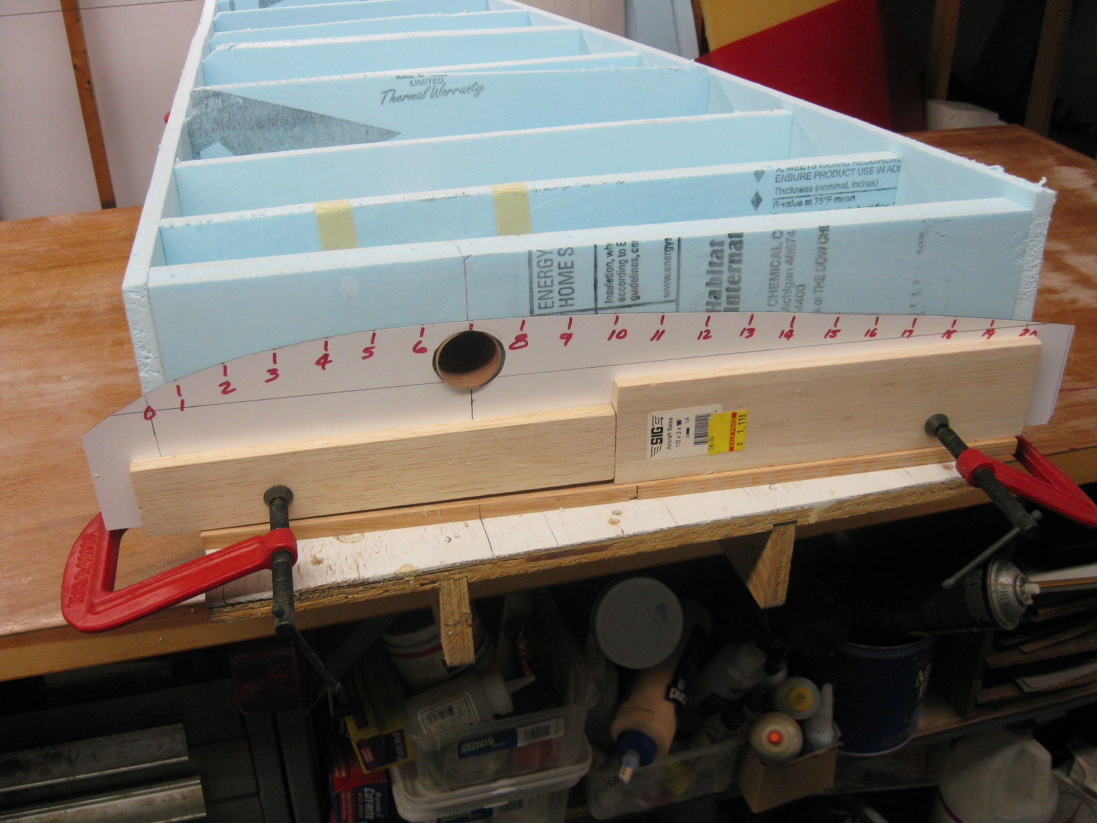

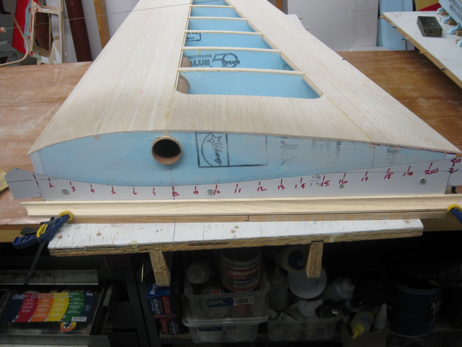

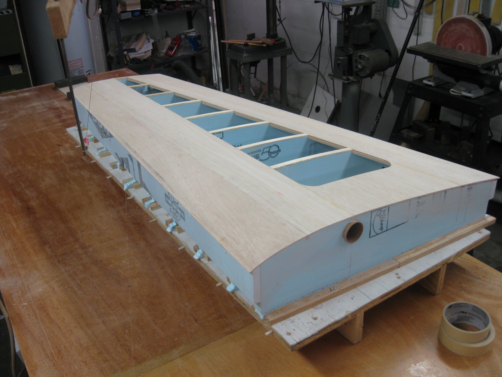

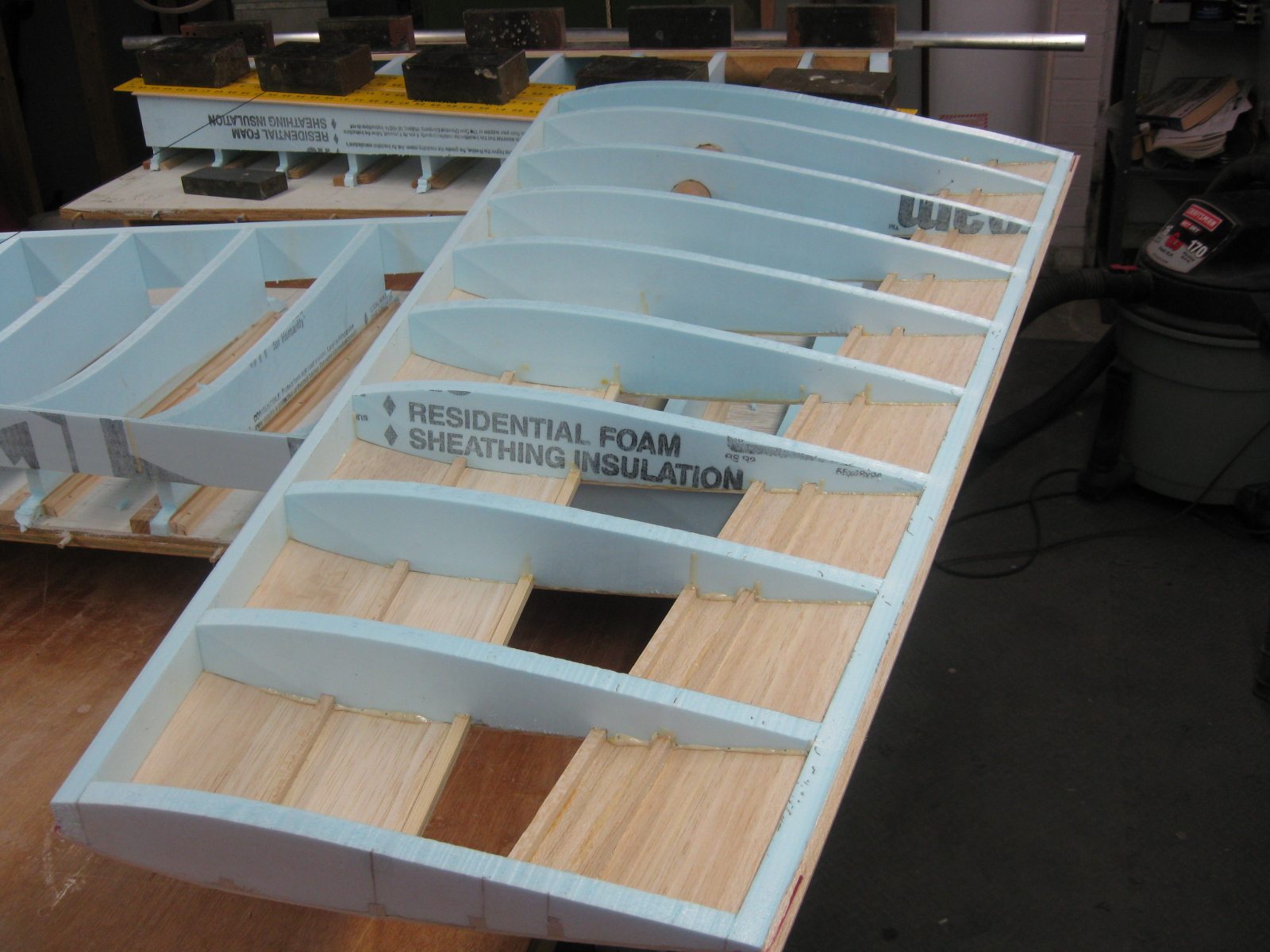

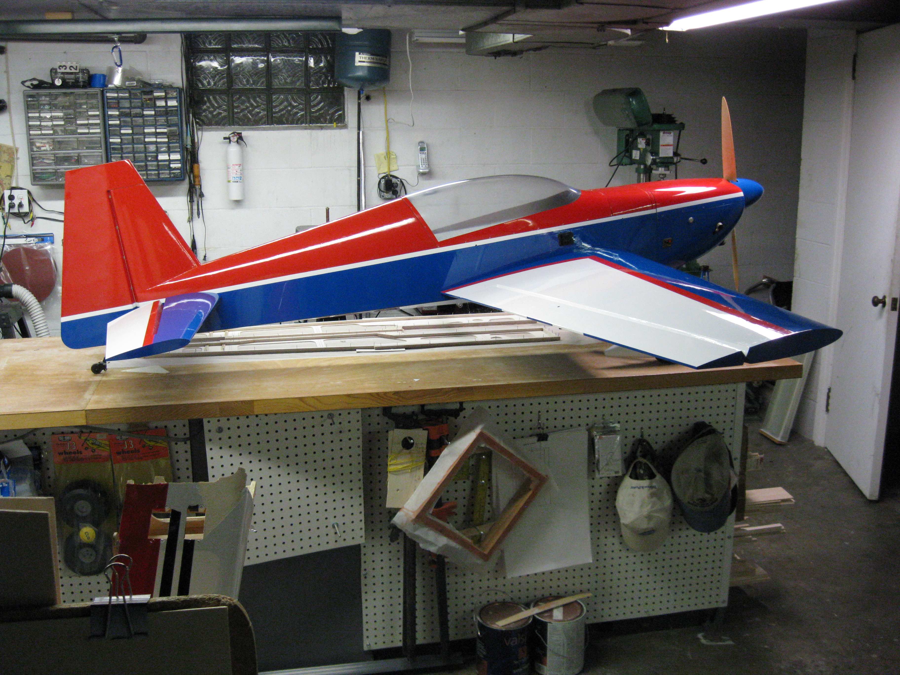

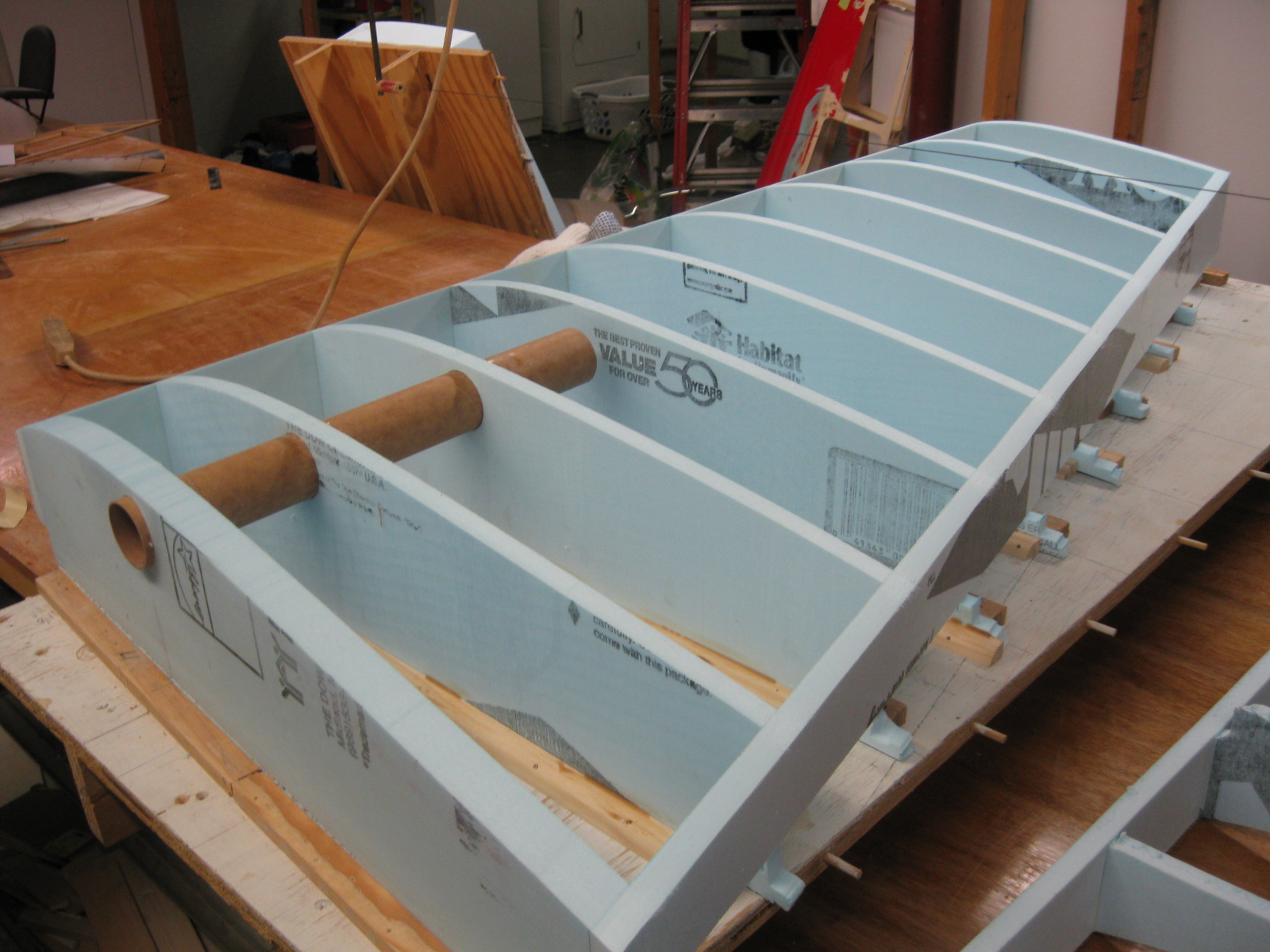

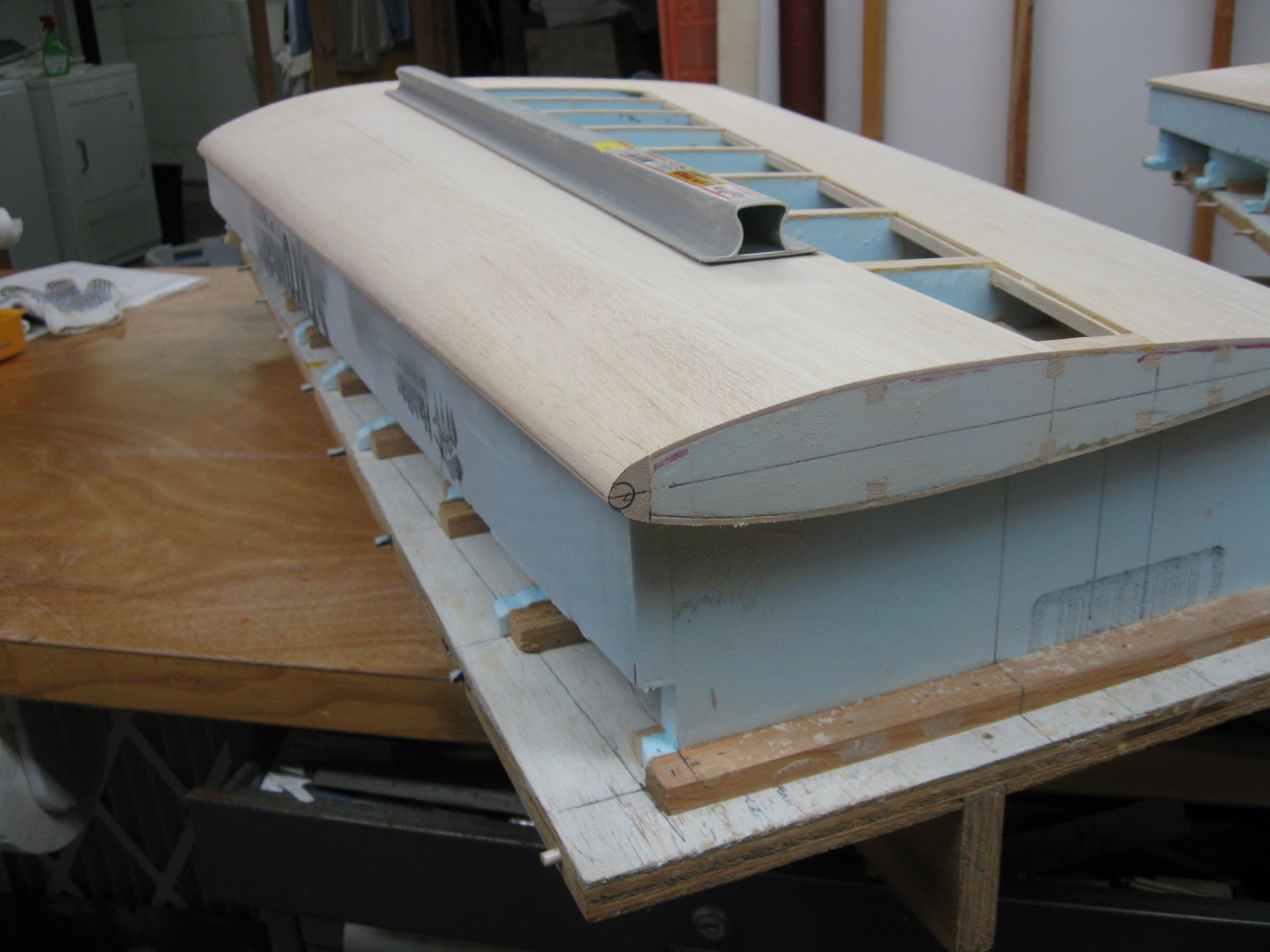

The Hurley Extra brings back some great memories. I built two back when the plane was featured in MA, flew one and sold the other in the bones. The one I flew was built with foam rib wings and the other was foam core per plans. The foam rib wings were 6 ounces lighter each than the foam core wing version. I cut the cores from 1# virgin foam. Had to borrow the neighbors pickup truck to haul all the foam blocks home.

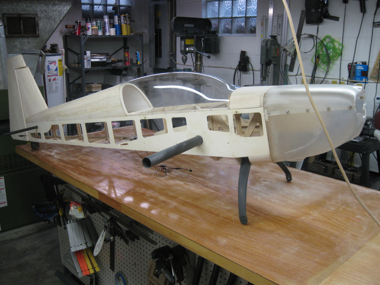

I later built an Extra 200 using three views from the Extra service manual and techniques used in the Hurley design. It was modeled after a full scale photo found on Airliners.net. Foam rib wings and stab, ZDZ80J engine.

View attachment 113552 View attachment 113553 View attachment 113554
Tony, can you share any details about the foam rib technique, especially as it applies to the Hurley Extra?
