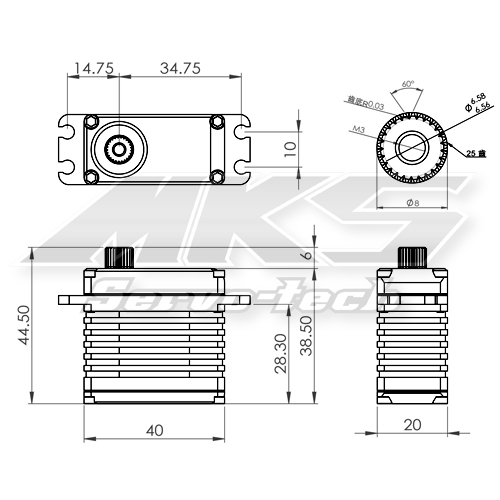

Sorry if off topic to the 777s, but since you mention 380 arms, I know Thomas said a couple weeks ago that new arms were coming in soon. They may be in stock now (FWIW). The schematic on the site still shows the 25 tooth spline.
Here is the what I have heard and know......The 777's 25 tooth like Futaba. This I know cuz I have used them. I have heard the x6 series is also 25 tooth. The HBL 380 and x8 series stands alone with its own special spline and larger diameter (even though they have a 25 tooth spline)
That is why you need the arms for the 380. Correct me if I'm wrong but this is what I've heard .
