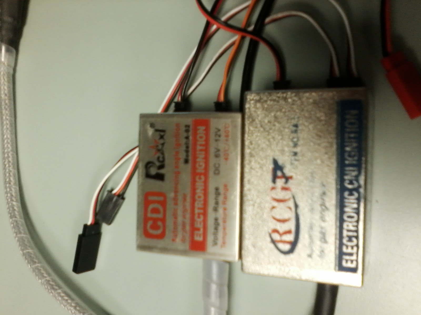

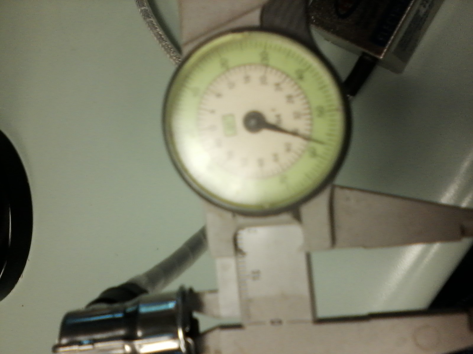

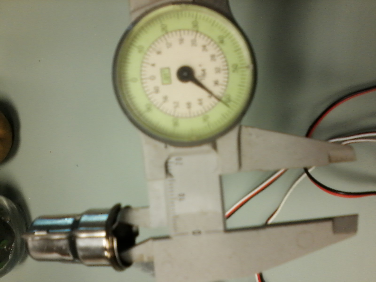

I was flying my MOJO last weekend and noticed a miss on the RCGF 26cc engine that kept getting worse. I landed the plane and inspected and noticed the spark plug cap was loose almost to the point of falling off. It looks as if the silicone inside the cap was worn so bad that it doesn't even hold now. This engine probably has 50-60 (guesstimate) flights and many of them were extremely aggressive flights.
My buddy checked his and it is still tight, but he has not flown his much at all. What we both noticed was that the spark plug caps do not fit tight like the DLE caps do. This looks like a weak area on this ignition unit. I ordered two DLE caps and installed the cap and it should be good now. This is the first time I have ever had to replace one of my spark plug caps on any of my ignitions, however I do keep this plane nailed to the wall while flying for the most part.
