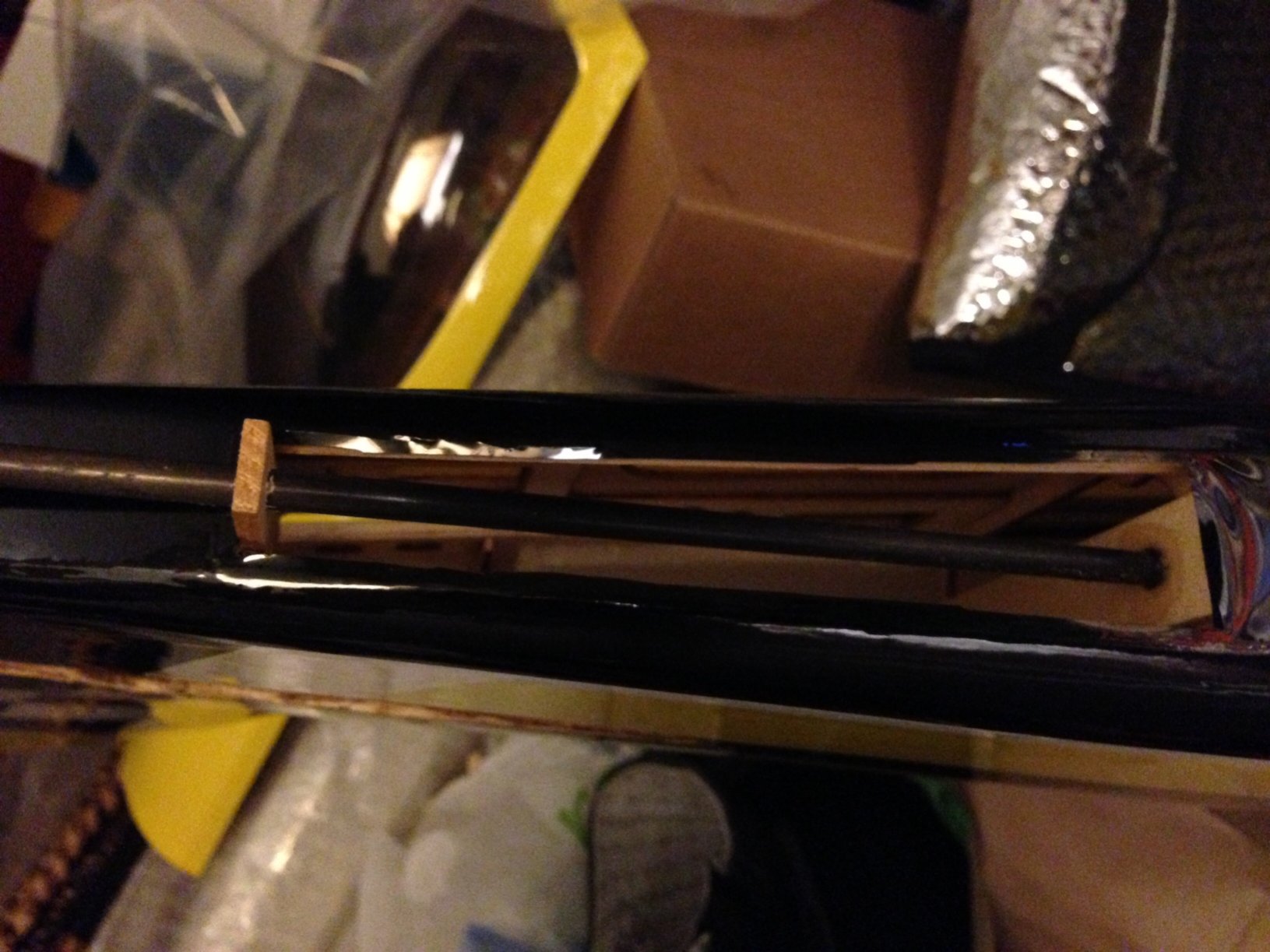

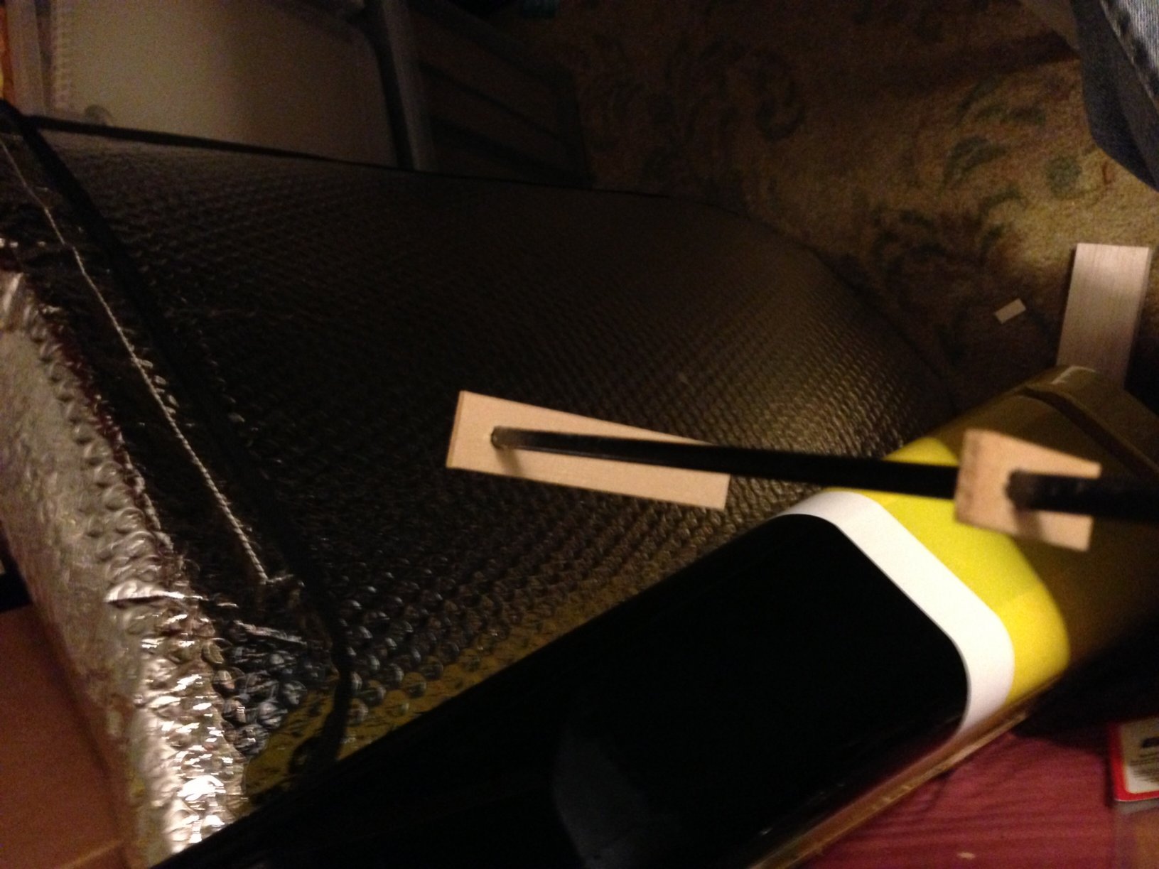

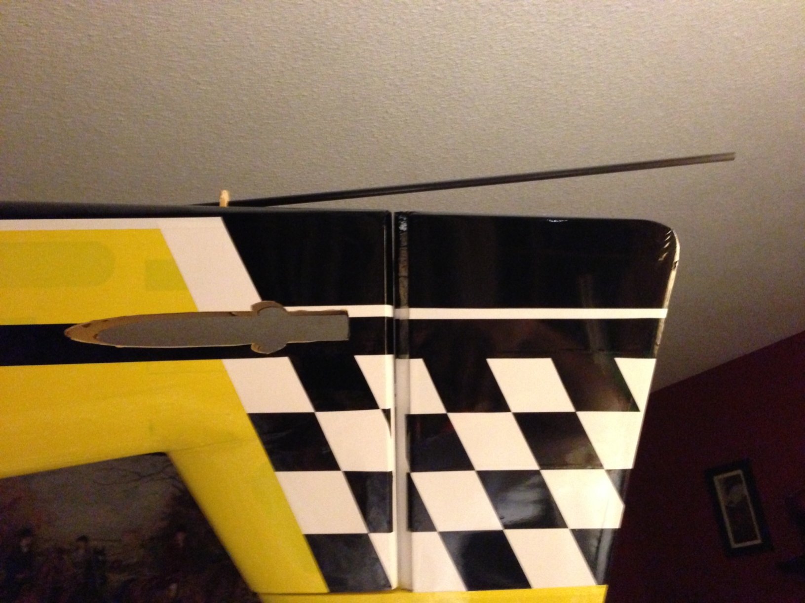

I got tired of fixing tail wheels early on. I don't like the small wheel getting caught on things and so many planes have a very flimsy design that I could break all too easily. About a year ago I decided to try a few things in place of the tail wheel and what I finally came up with is a very simple carbon fiber rod, either taped to the bottom of the plane (quick replacement for a broken tail wheel) or built into the fuselage.
I have been doing this for quite a while and received a lot of positive comments at my field, but didn't want to post it online. Then someone complained about their tail wheel in another forum and I decided to show what I did. As far as I can tell, all planes I have put a CF skid onto have turned just as well on the ground as if the had a wheel.
My newest plane is an EF 64" MXS that I just started to assemble last night and the first thing I did was to install a CF rod into it as a tail skid. I thought I would post pictures here and share this with anyone else who feels like I do about tail wheels. It just so happens that using a CF skid protects the rudder when touching the tail and also allows for a very low harrier that lets you drag the tail of the plane on the ground as you go down the runway... I have a ball with it.

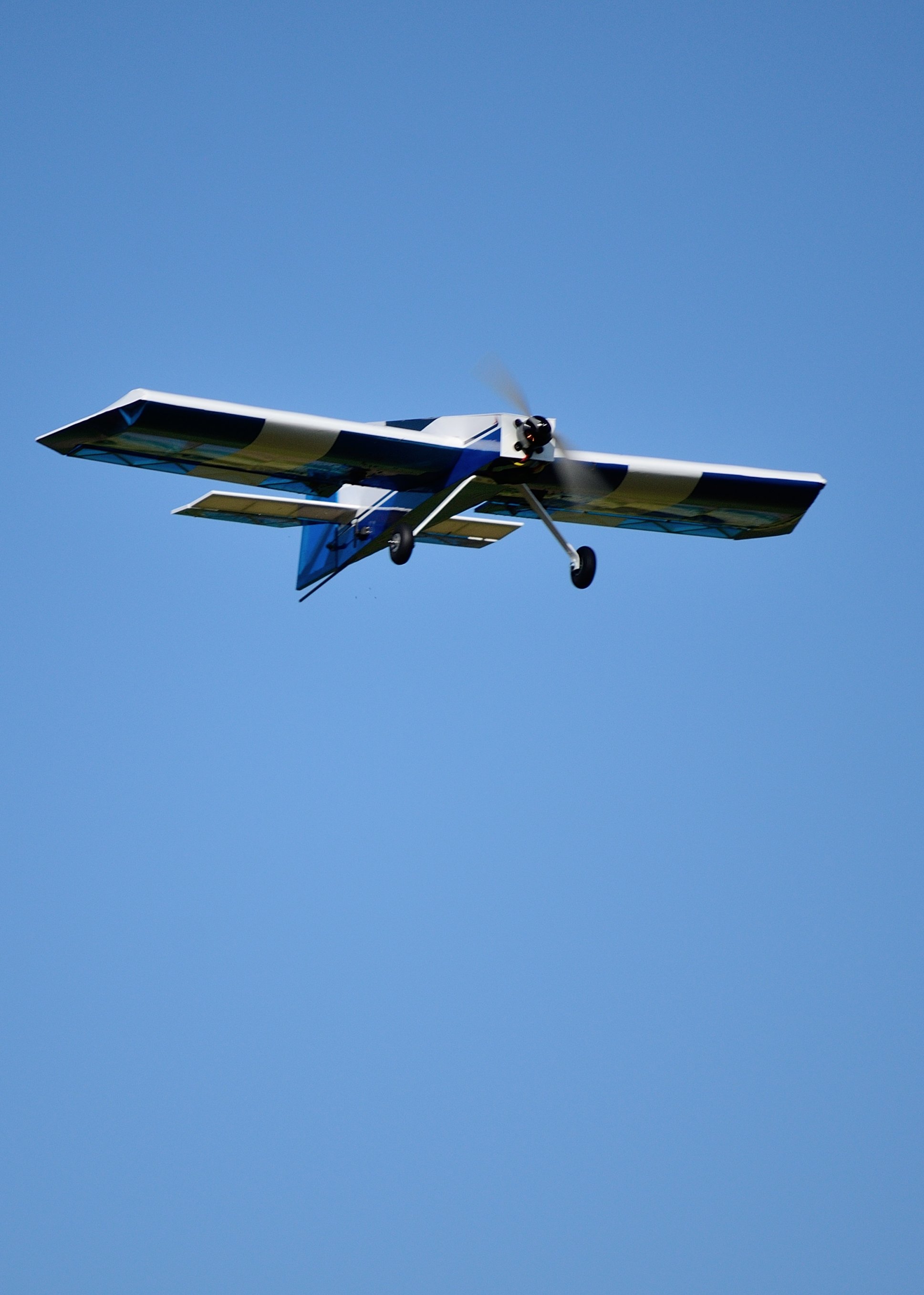

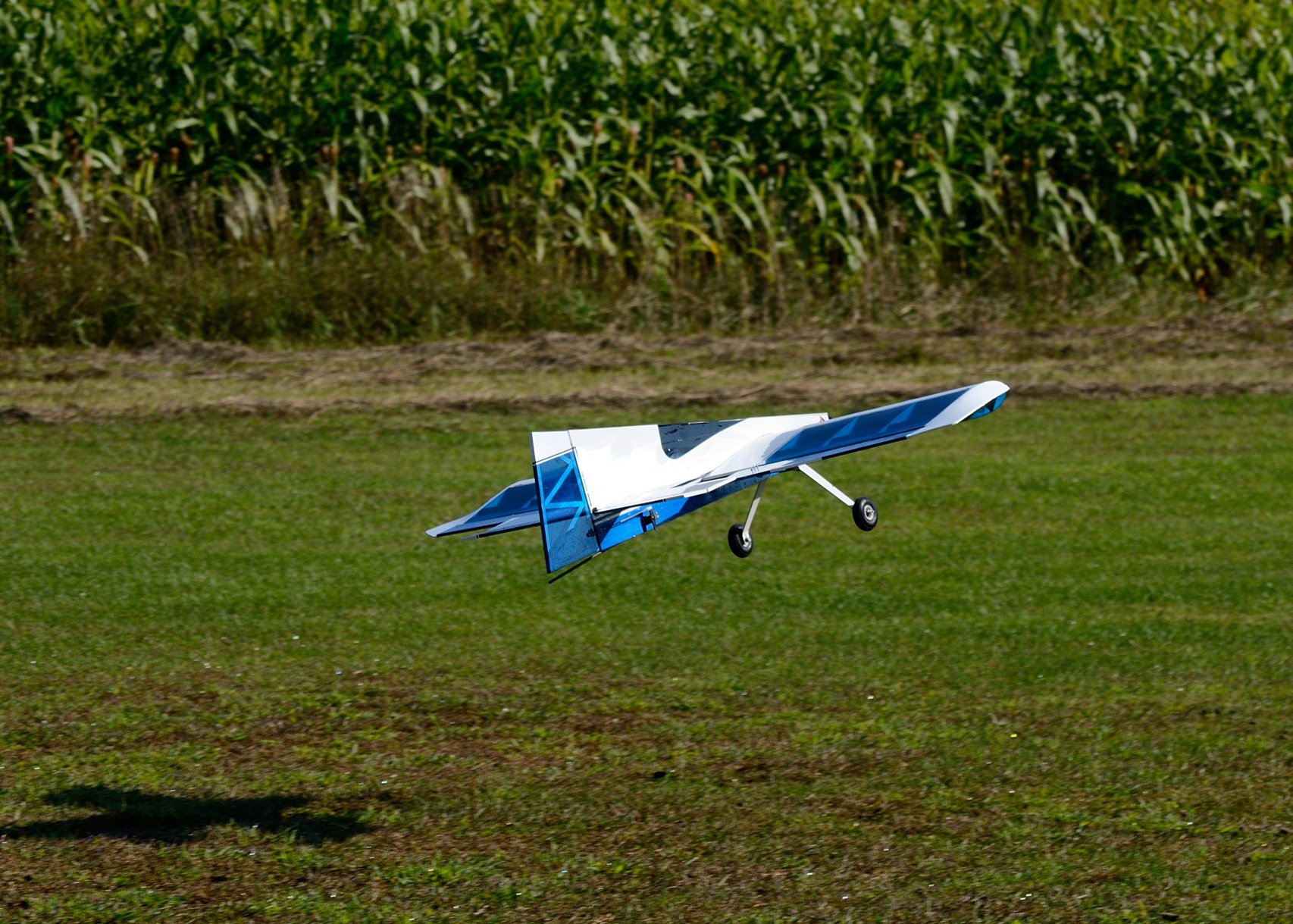

Here are some pictures of the MXS and plan-built model that I recently made for a contest at my club.

So far no. The one I have used the longest (9 months) has a flat spot on the bottom but nothing serious. Since I use CA to hold them in place, debonder should work fine to remove one if necessary.
I started out using 450 helicopter booms. They worked fantastic but were pricy, which is why I switched to CF rods. The booms were much sturdier, but by angling the CF rod down a bit they stay clear of the rudder and actually give a bit of spring, which is good too.
You just have to use rudder to steer and it's fine on the ground. You cannot tell the difference on takeoff and landing regardless of wind and I can still turn on a dime while taxiing , it just takes a bit more throttle/rudder during higher wind. I'll give up the slow tight ground steering for more strength any day.
