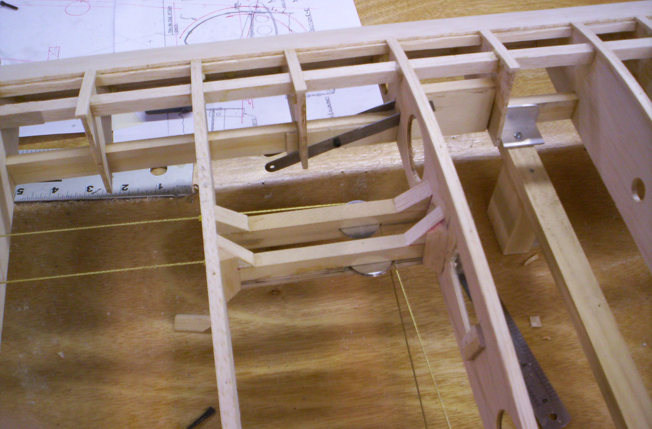

  1. Does anyone out there that has built a Balsa 1/3 SC and took photos of the build help me with step 10 on the wing build concerning the placement of the 5/16" X 3/4" X 2 1/4" spruce piece that glues to the spar ? I am legally blind and just can't see the "B-B" section on the wing plans good enough to figure out where this piece goes. Any help appreciated.
    Dave

    Post some photos here of the plans and we'll figure it out.

  4. TonyHallo
    TonyHallo 70cc twin V2

  7. I have checked it out and it will help me tremendously but can you confirm that the aforementioned 2 1/4" spruce is glued to the spar on either side between the 2 metal straps? Remember, I am operating on about 25% of normal sight and blind in the other eye.

    Yes you are correct, it is glued to the spar and provides wood for the strap bolt.
  10. Thank you. I understand now.
