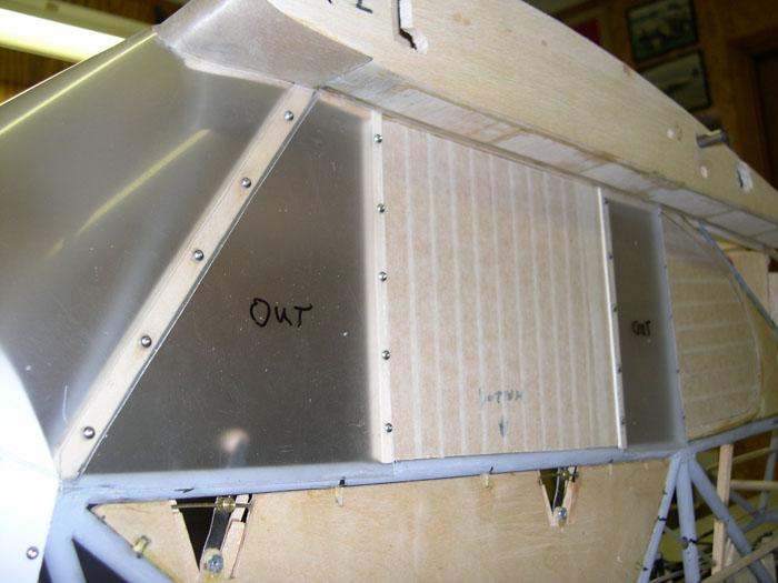

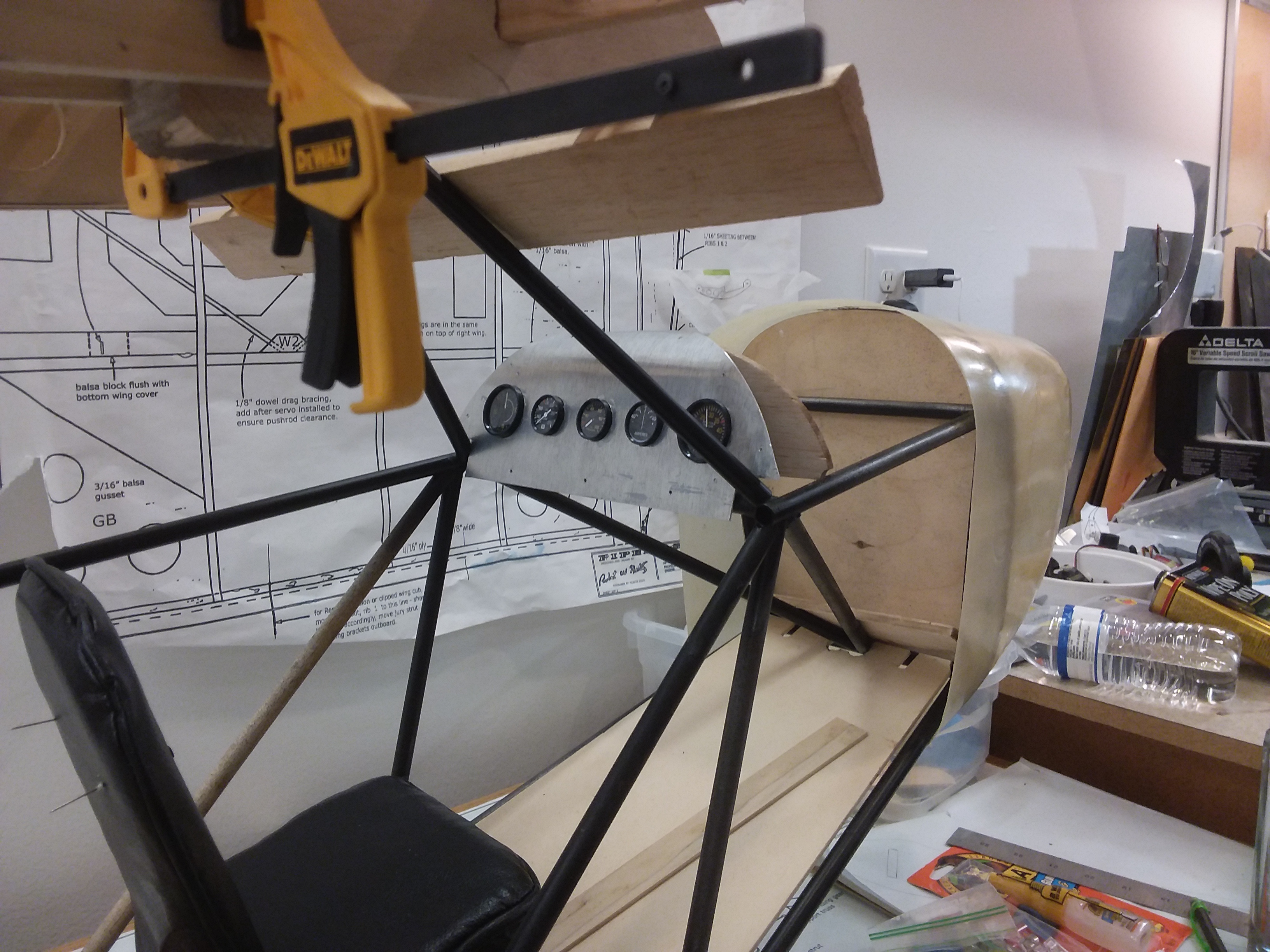

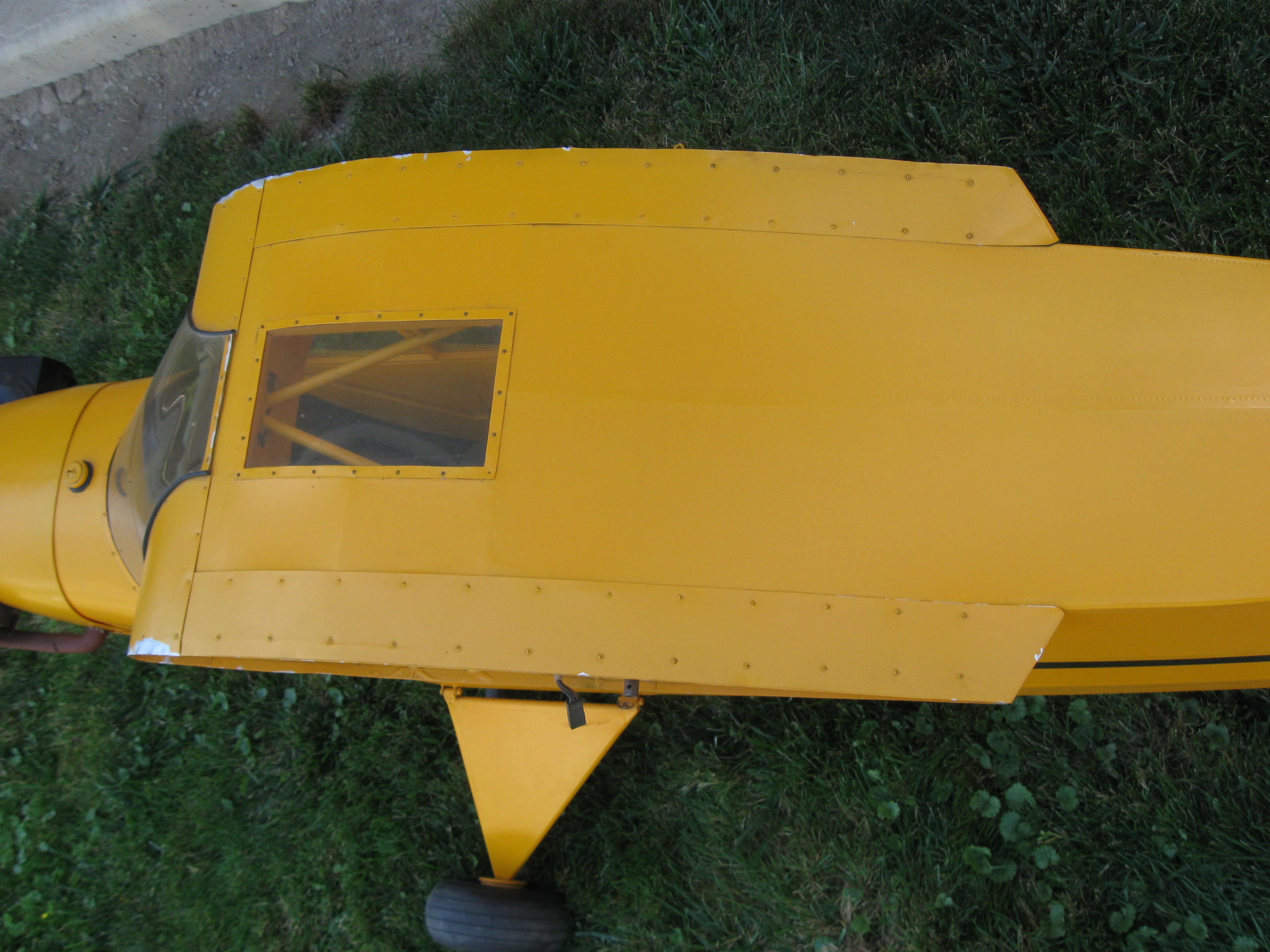

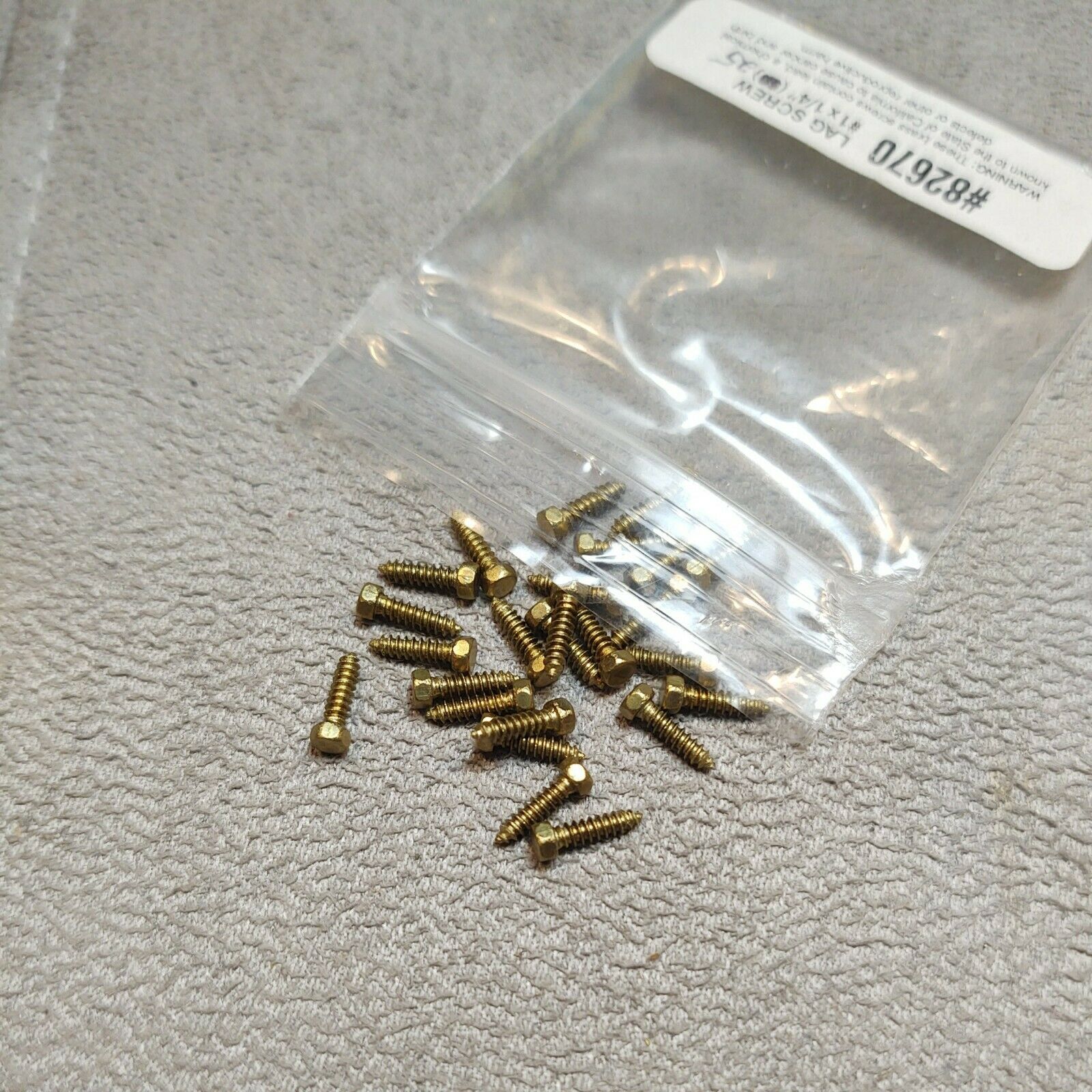

Lets see. I need screws, lag/lug bolts for scale appearance on aluminum wing shrouding at fuse connection area, engine cowling, dash screws, tiny little screws for foot pedal controls, seat mounting, etc. Some 3/4" 1-72 (?) bolts for some scale bits and pieces.

The wing on the Champ has the same cord as the Cub, I used #0 screws. They appear to be much smaller than the ones in the photo you posted.
The 00-90 would be the right size for the dash and other parts inside the cabin.
