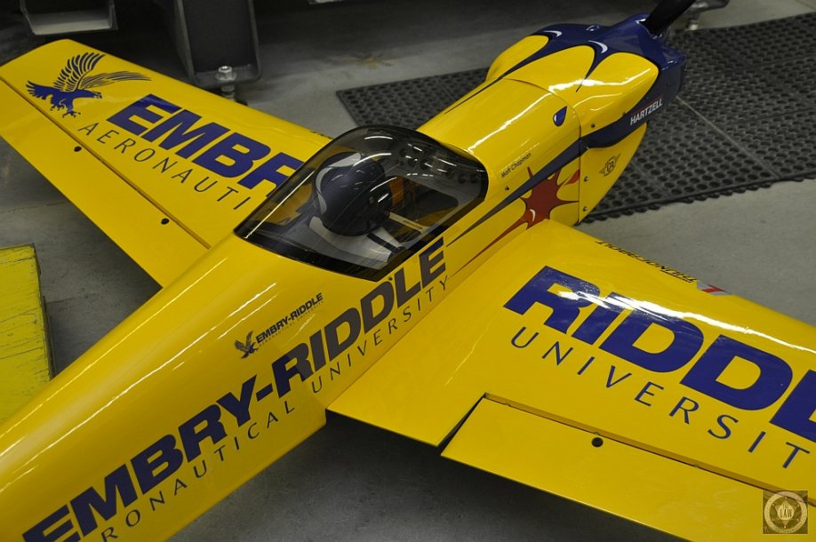

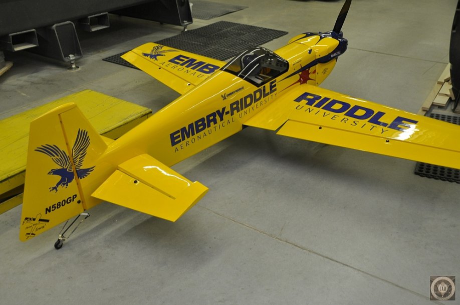

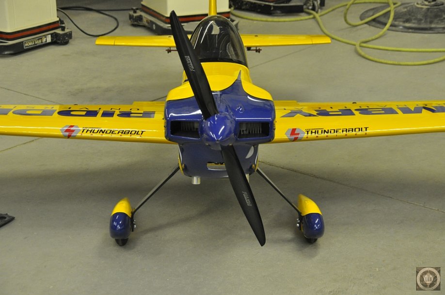

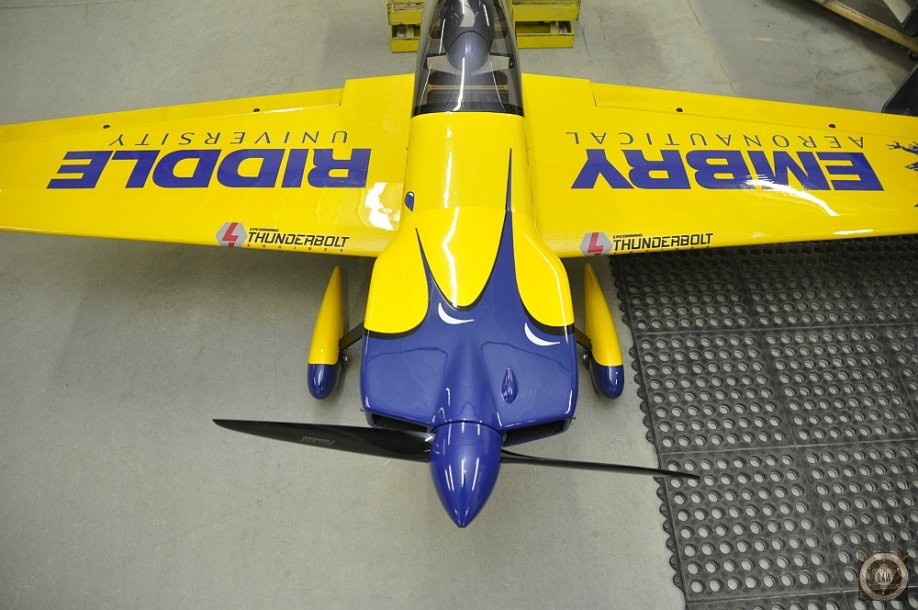

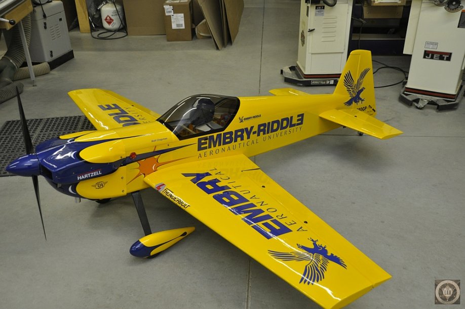

Well she's all wrapped up and ready to rock. Too bad it's going to be 9 freakin degrees and windy as hell tomorrow:(:confused:.
But, the fleet is about wrapped up for the 2015 flying season. Going to start on my warbird in the next week so my friend @iahawkflyer can't give me crap about my two year old warbird build!!!
So, the crazy thing about this cap is I took out a whole bunch of weight.....mainly from the front. Then I installed an "old" style DA100 with DLE stock mufflers and a lightweight Falcon prop. Then I put the rudder servo in the tail, and used a water bottle fuel tank to shave more weight off the front. Grand total is just over 2lb. in weight savings. And it comes out a hair nose heavy!! So I had to build in a battery tray just inside the turtle deck behind the pilot, with dual A123's and it comes out pretty good.
Grand total RTF weight..............25 lb. 1 oz. Very nice, won't be stellar power but will be plenty of power for what this plane will do. I'm looking forward to practicing Sportsman IMAC with it as soon as it's warm!
Thanks for watching, thought some of you that may have experience with this older plane would like to see it go together. Thanks again @stangflyer for the sweet deal on this bird as well.

Sooo, Sooo Sweet Terry. Glad you are happy with the Cap.....

Well it looks you put the CAP on the right "diet"! 25lbs and a DA 100 will be awesome! Looking forward to some vid!!!!
