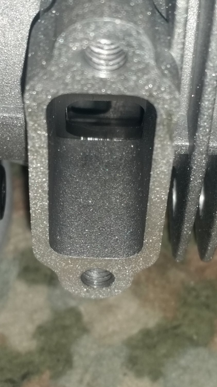

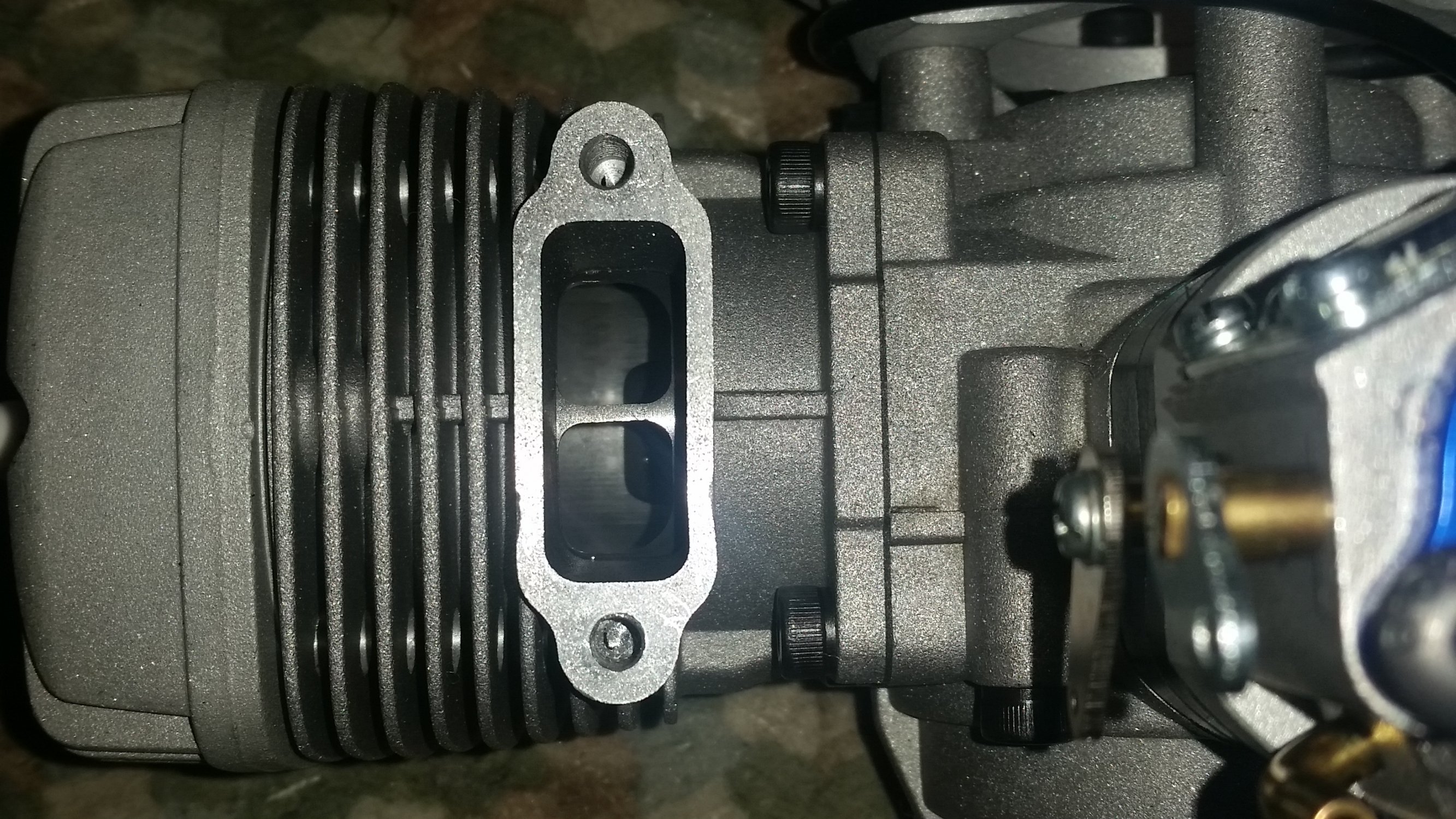

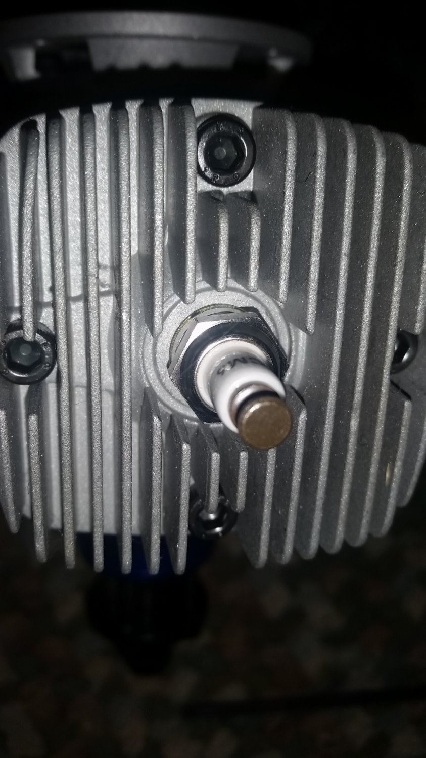

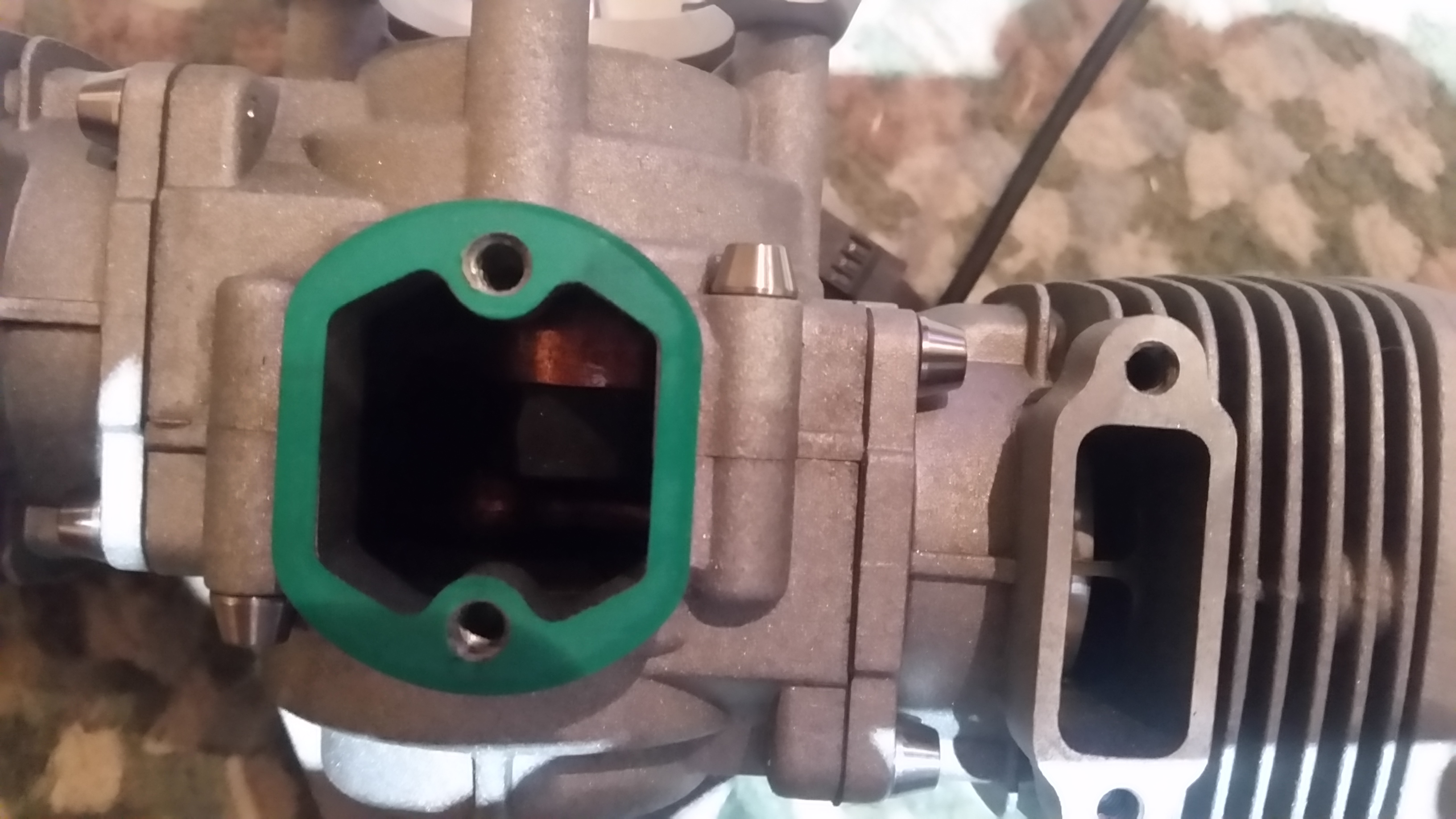

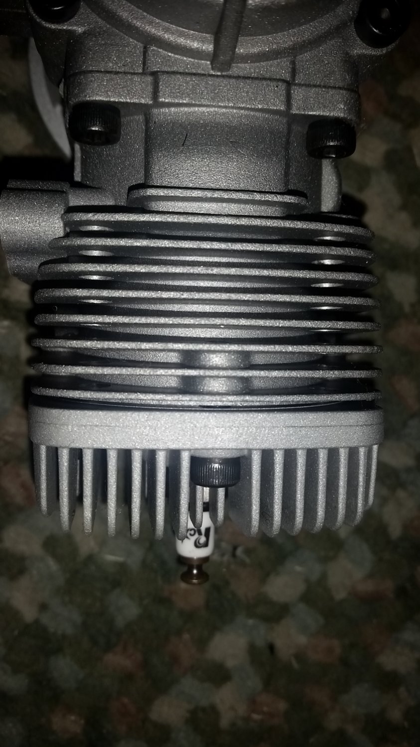

Here are some pics of the casting. By request, there are a few of the exhaust ports. I zoomed in and used a flash so any imperfect
ions can be highlighted.
JoeT
s tons of pictures.

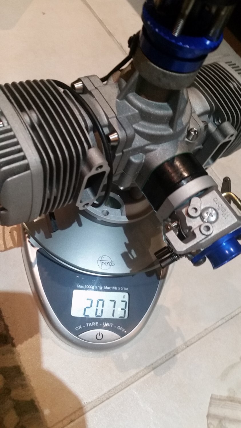

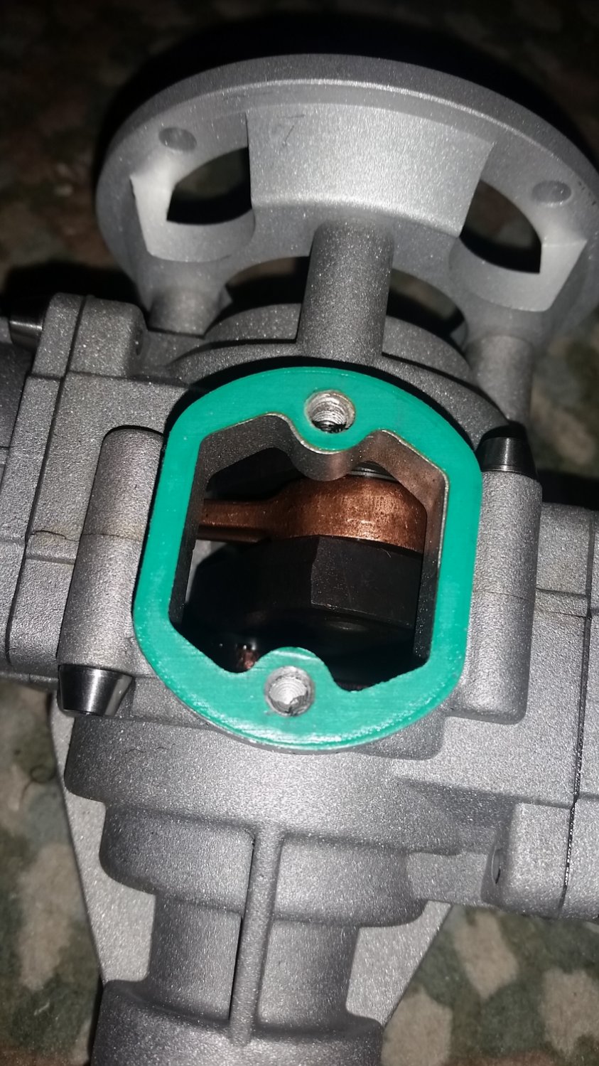

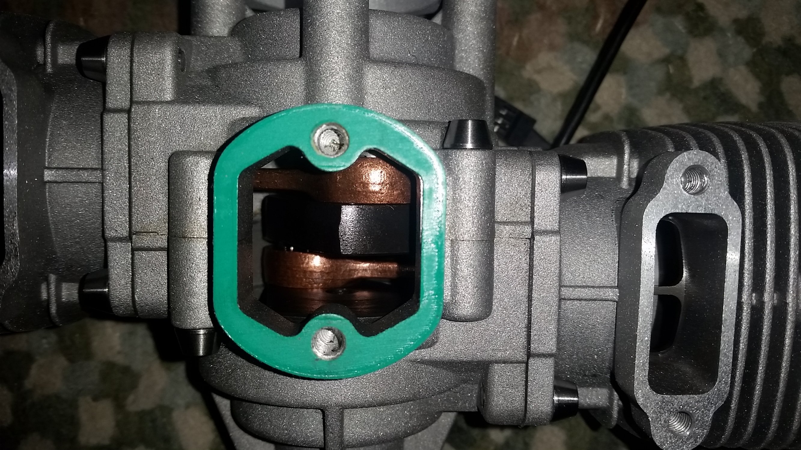

I'm really impressed with the quality of this engine. What you'll see here is the internals of the crank case, with the HUGE beefy bottom end.

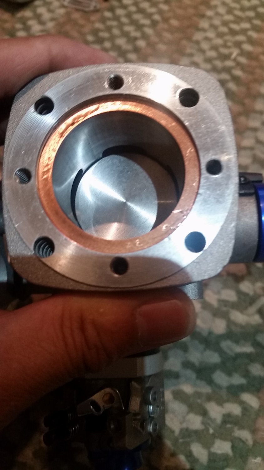

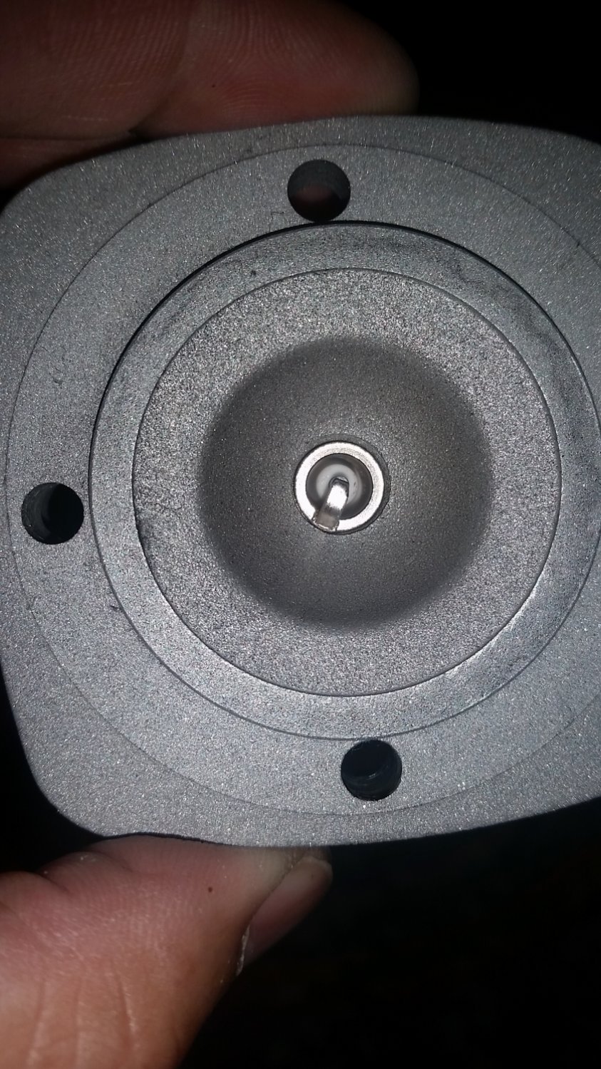

The cylinder castings are also amazing, no machining required. The cylinder liners are floating inside the cylinder casting, nicely machined and slip fitted in.
The top of the cylinder liners have a copper head gasket as well. The inside of the cylinder head is smooth as can be.

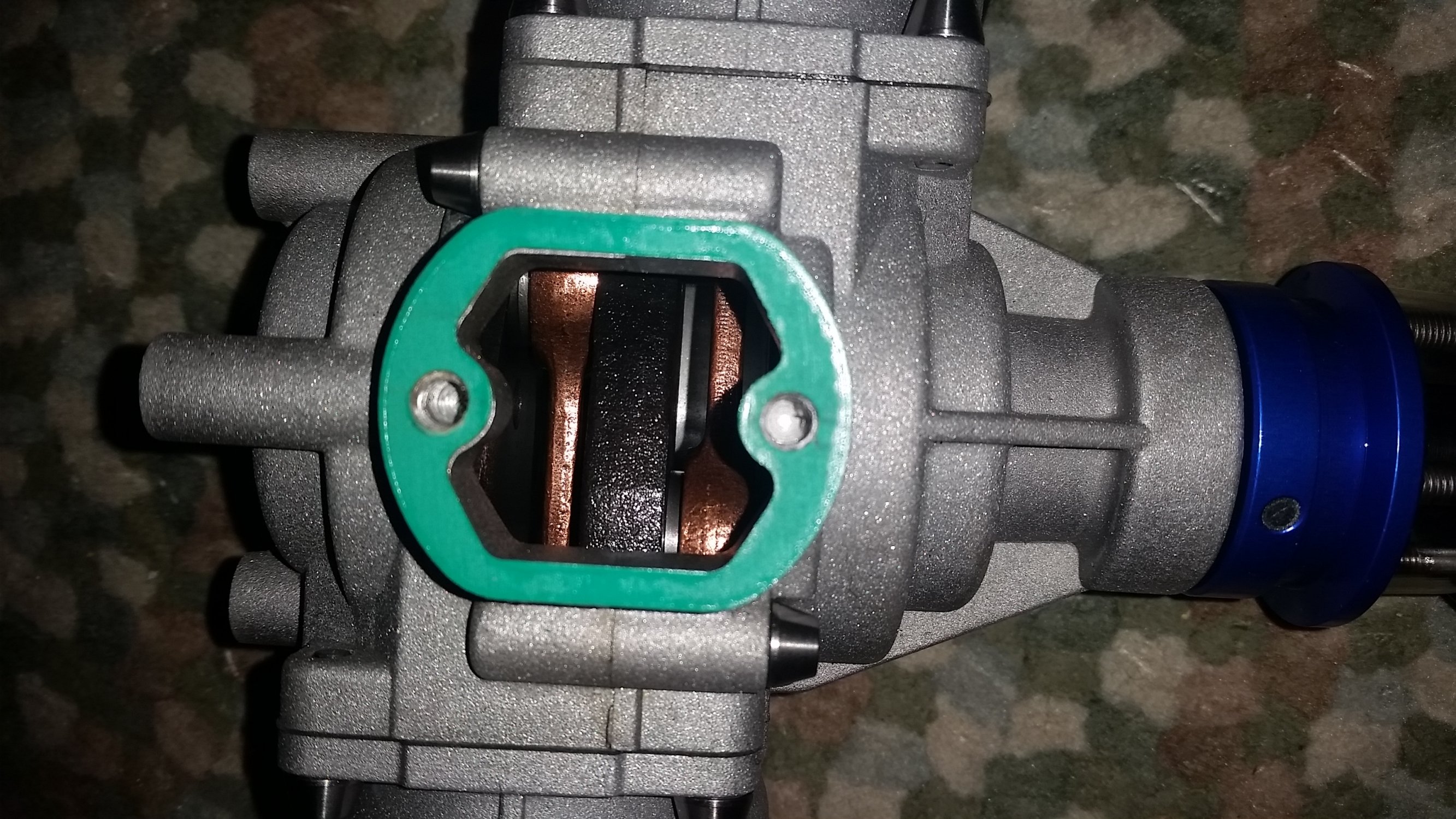

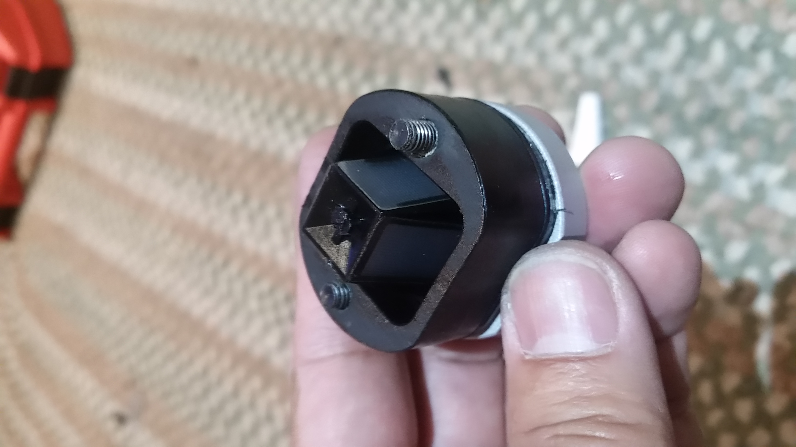

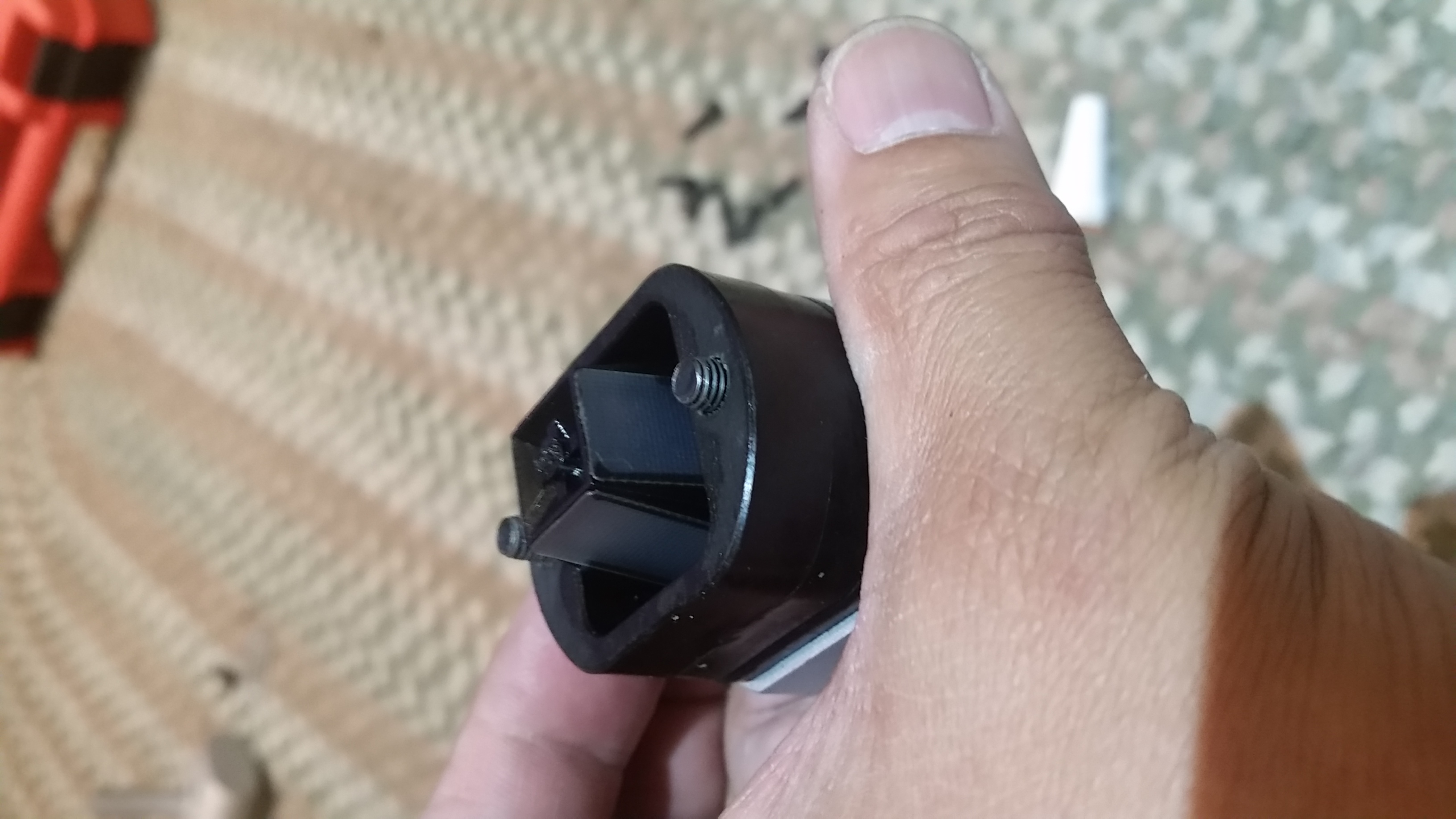

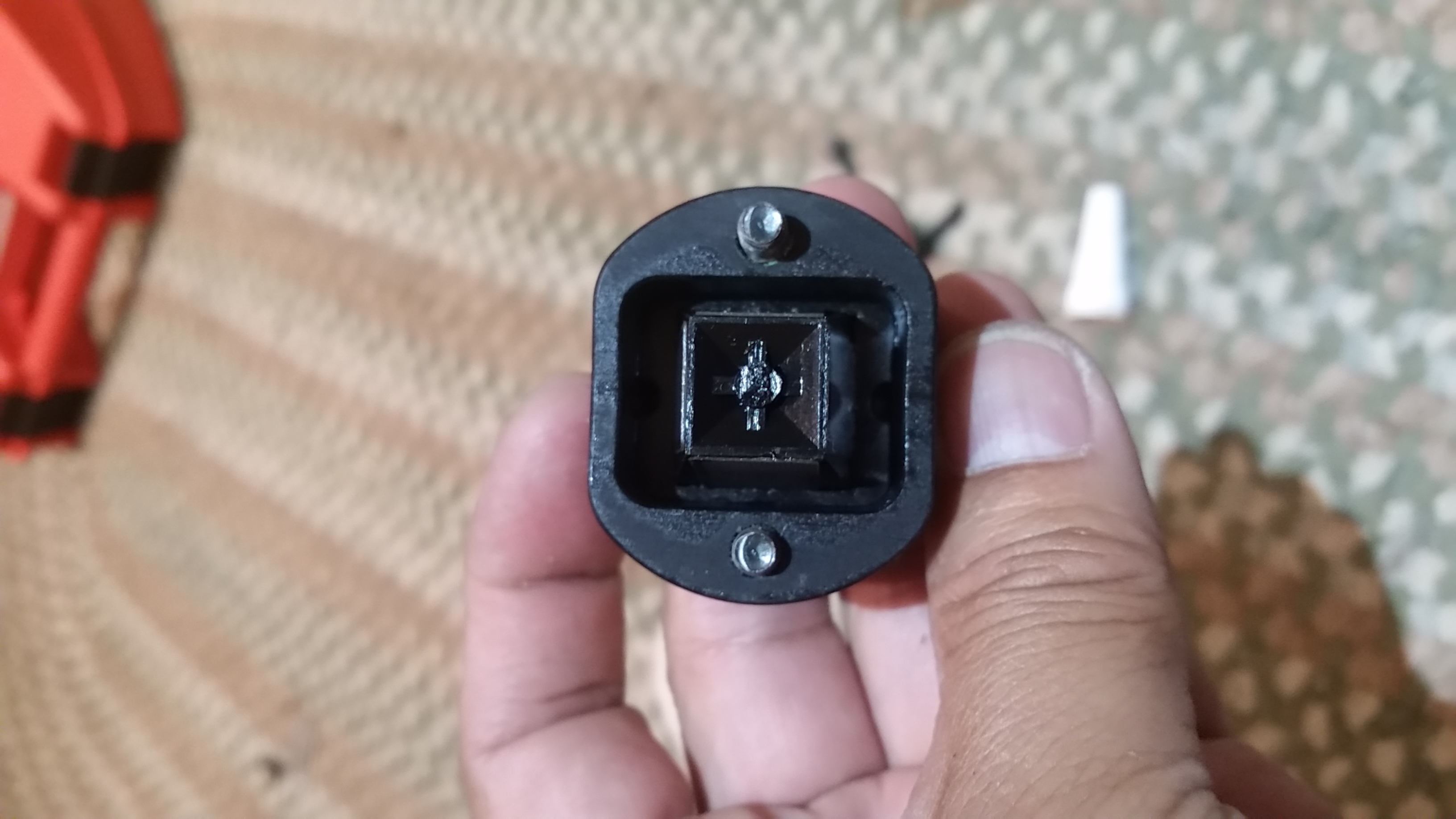

Reed valve body is a 4 sided semi pyramid box. There are 4 small petals, and is housed within a composite / plastic body. There is a 1/8" thick rubber gasket on top and on the bottom that seal it against the aluminum top and bottom plate. There is no need for an external pulse port since it uses a carb orfice that leads to a tiny pulse port on the base plate.

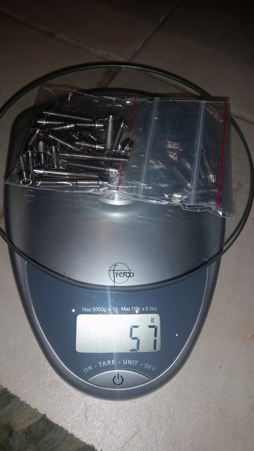

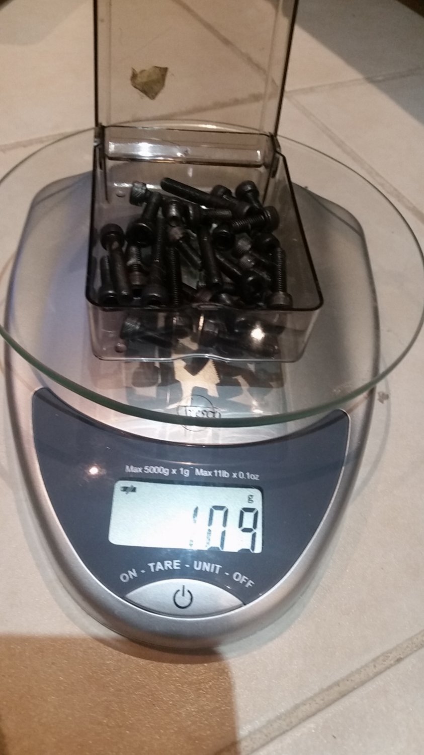

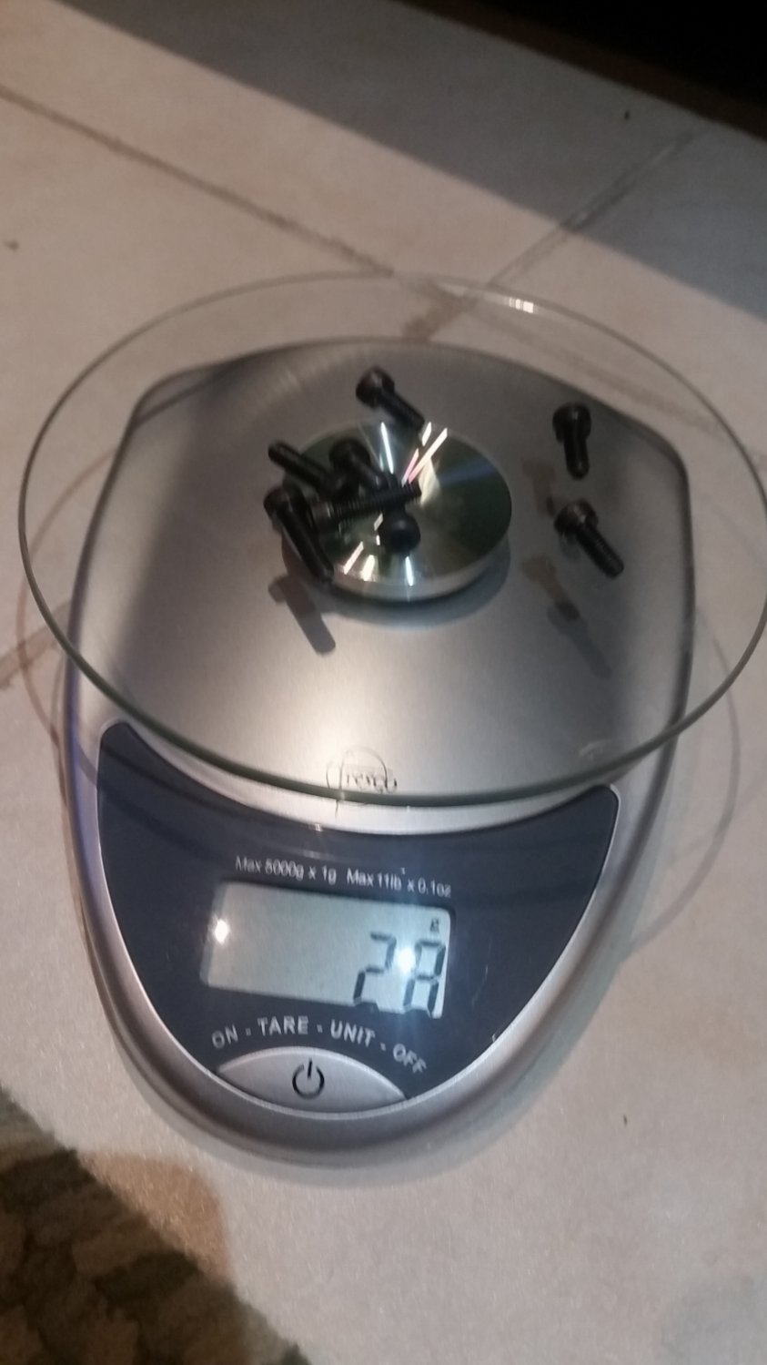

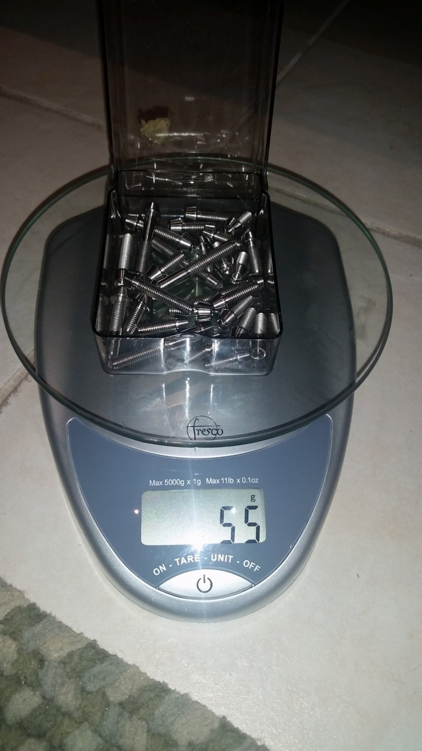

There is also a weight difference after removing all the steel bolts and replacing all of them with titanium.
