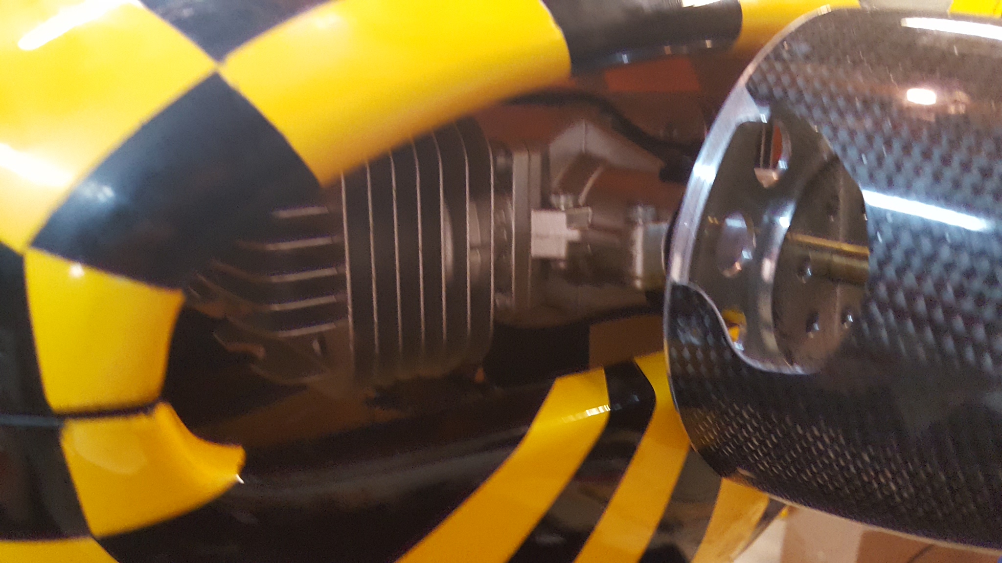

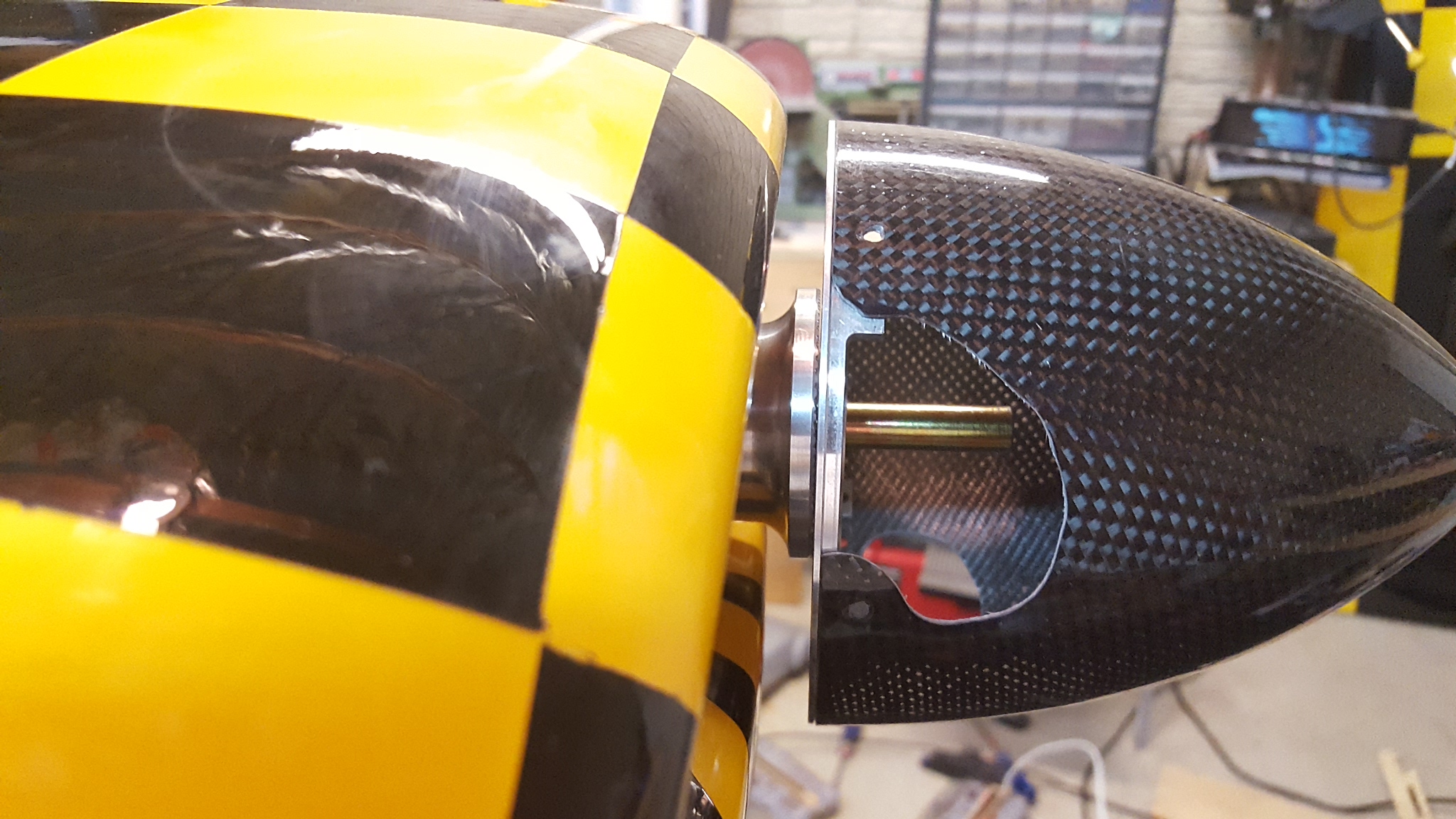

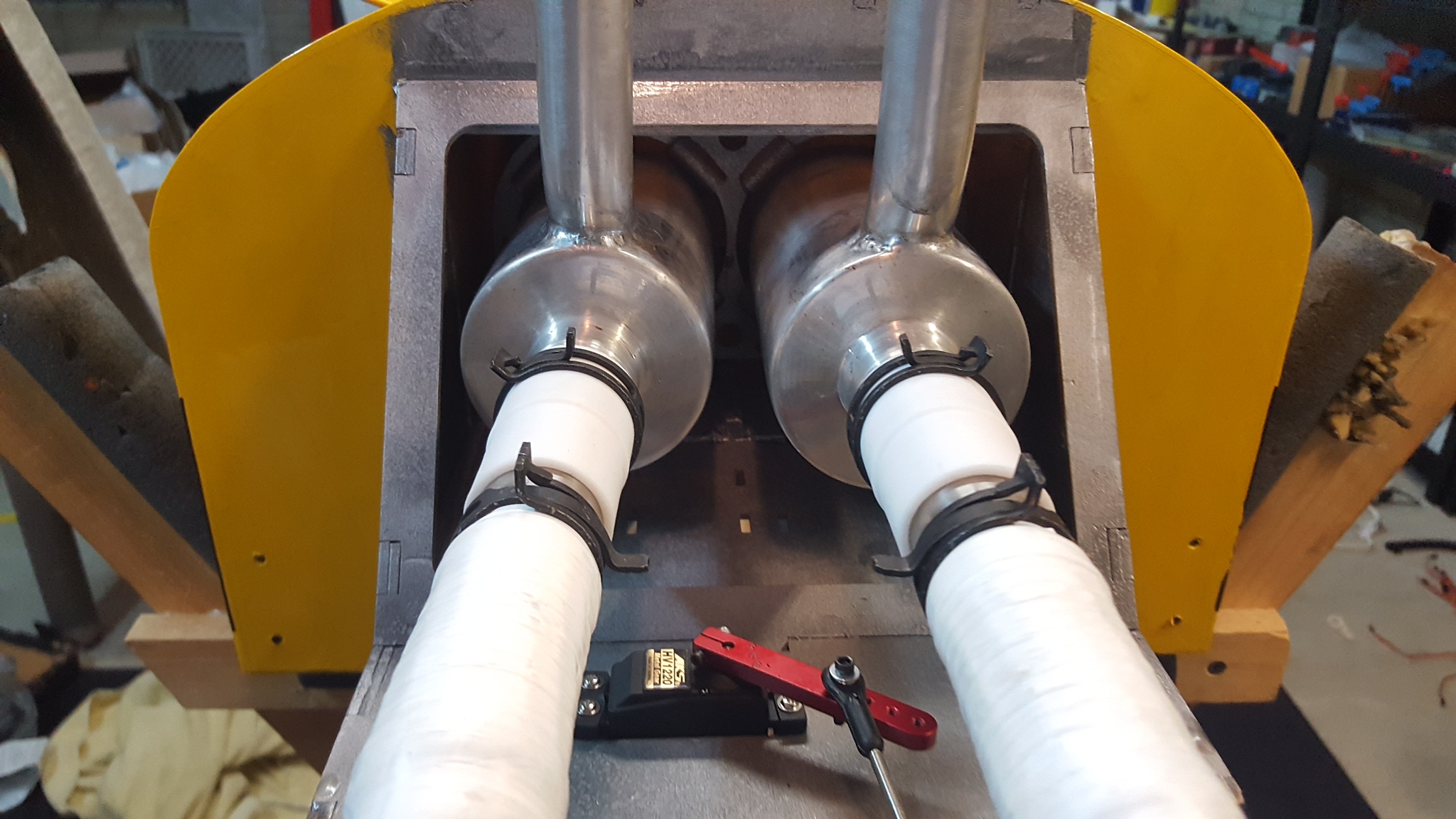

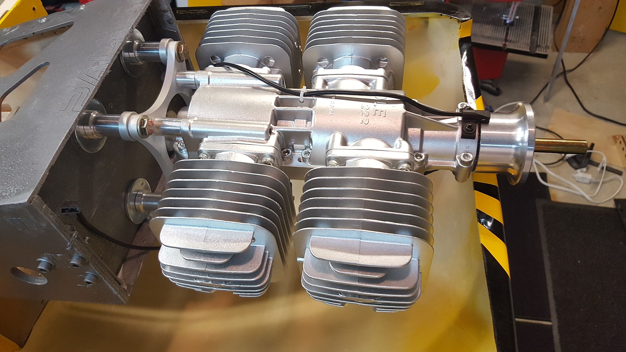

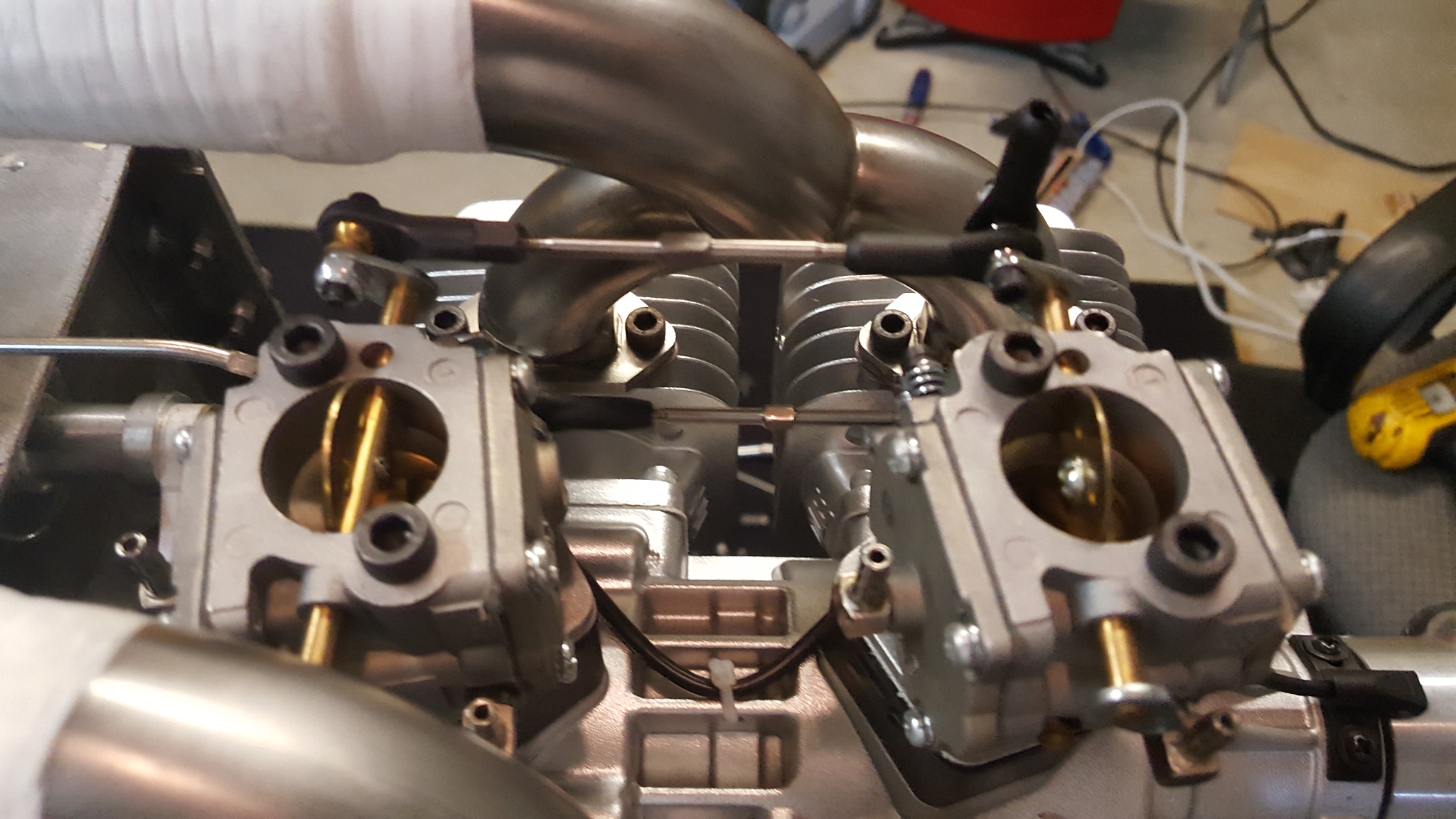

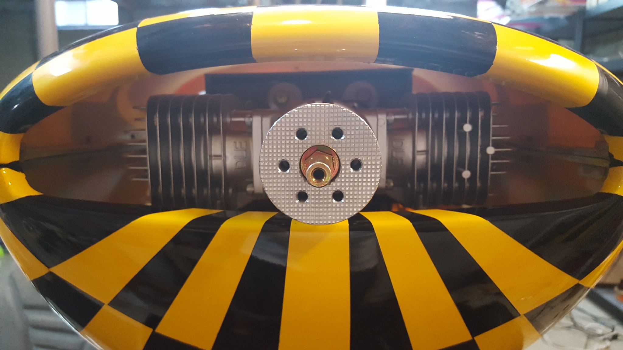

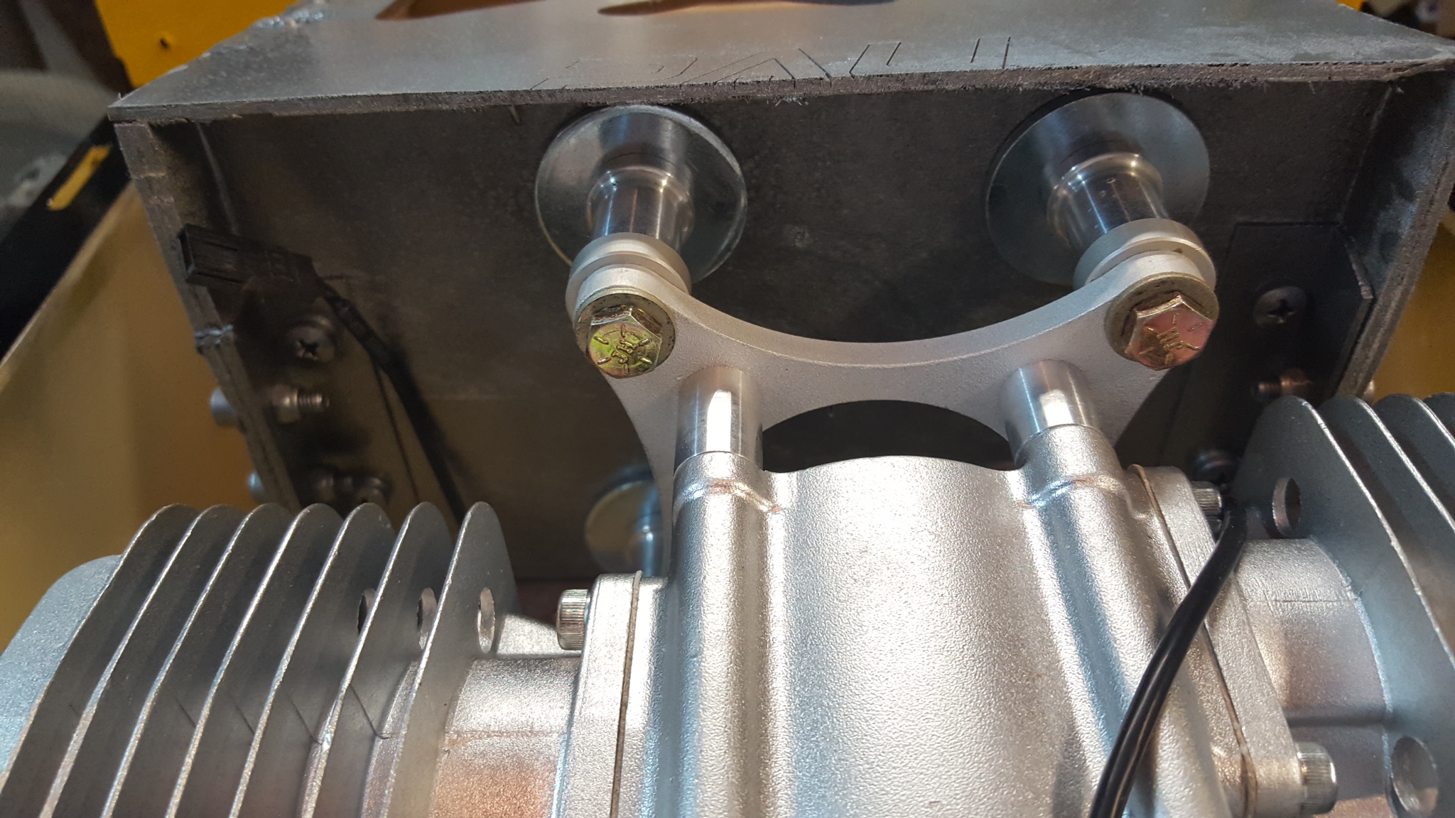

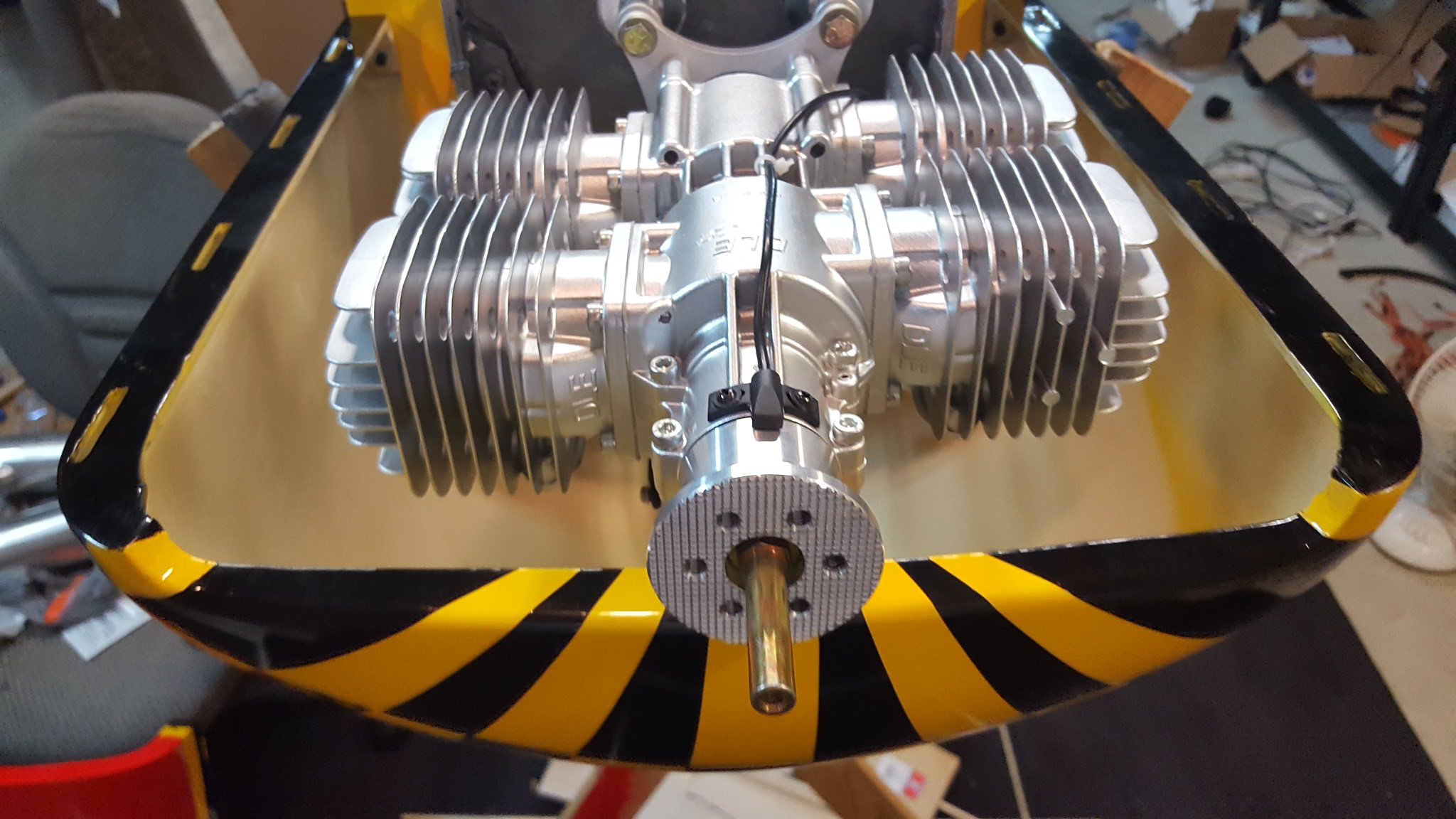

Mounted the engine and installed the cans and linkages. The DLE222 required 1 1/4" spacing. It give a 1/4" space between the cowl and spinner plate. You almost need that much due to the size of the hub. I did a Z bend for throttle linkage. Not sure I I like it but it seems to be pretty solid. Since there is no pressure on the carbs I should not have to worry about anything bending. Set up rudder throws and elevator throws also. Starting from the tail and moving forward.
Once I get the carb linkages balanced I will use some glue on a ball link exchange do to keep the linkage from moving.
