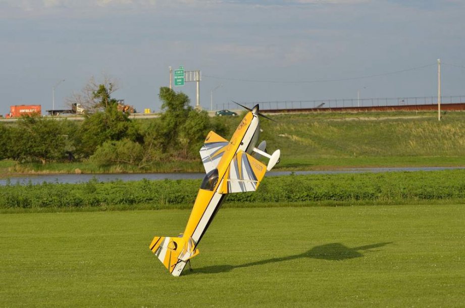

Maiden completed today on the 60cc edge, got about 4 flights in on it. I am going to have to pull it down and put more right thrust into it I guess. It pulls to the left in an upline harder than any plane that I have ever flown. I think I'll have to move more weight to the front also as center of the tube seems to be a little tail heavy. Other than those two things, it flew great.

Looks great.
Both of mine pull hard left on up lines also.
I mixed in rudder to throttle, but it took a lot to make it fly straight.
I added weight to the right wing tip and this helped a lot.
Wings still stay level pulling from a dive, even with the weight on the right wing tip.
