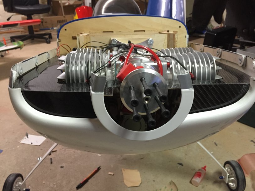

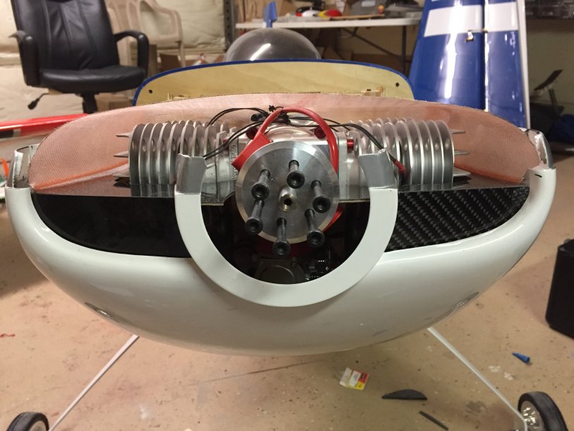

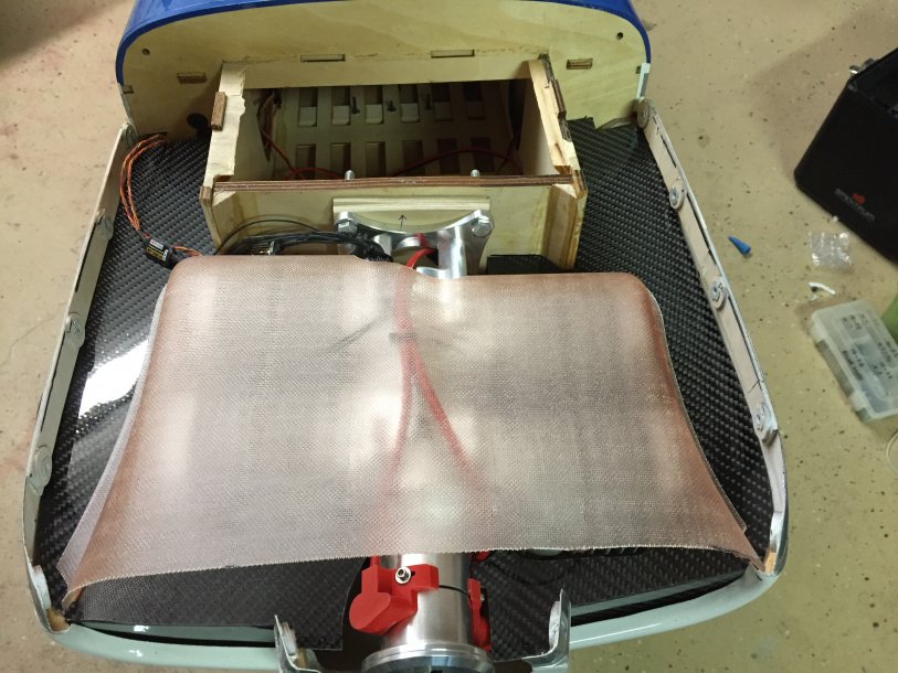

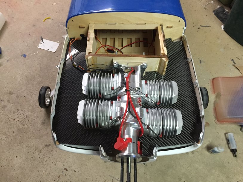

Yeah Capt...I am very happy now that I have got this one side almost ready to paint. Installed mounting plates and blind nuts in bottom half of cowling, also installed the cap on the rear former and it is ready to have 1/8" foam glued to seal the gap between former and top half of cowl.
I am sort of glad it is winter and I am in no rush to finish...as I started on the left side baffle last night and just didn't have it in me...so came up from the basement and watched TV with Jenni! LOL...Maybe tonight? Maybe this weekend!
