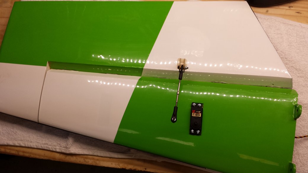

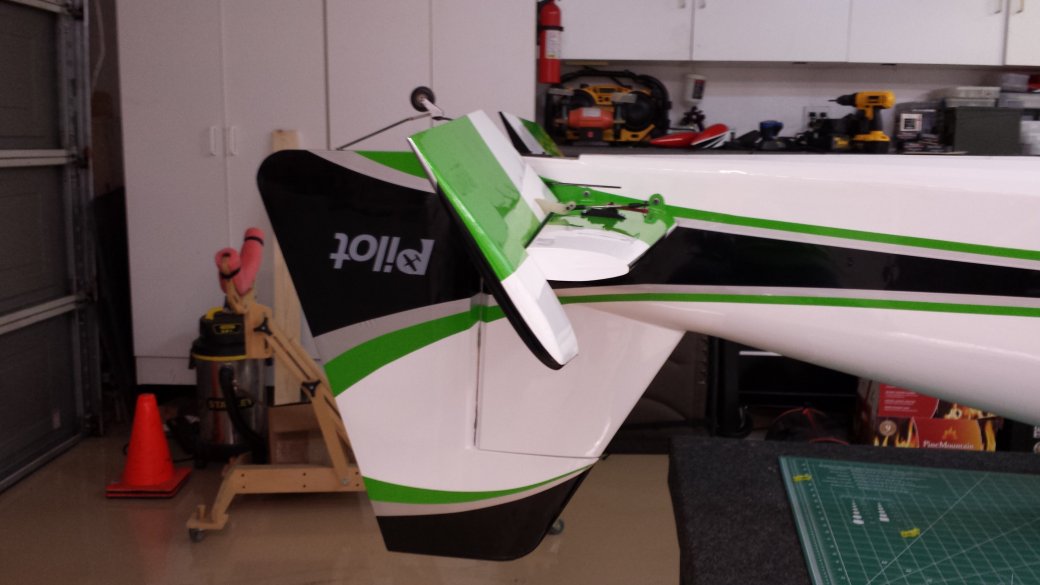

HI TERRY! :) Tell me more! So far this summer I assembled the H9 Sukhoi (control horn pivot point over the hinge line, control horns drilled for approx. same height over the hinge line compensating for tapered wing/aileron, but not finely adjustable, and not able to offset for make throw), the AW Yak (pilot holes for control horn pivot point over the hinge line but not installed and adjustable for offset, 3 hole control horn for height adjustment due to tapering wings/ailerons but not finely adjustable), and this Pilot Extra which also has control horn pivot point over the hinge line and three holes for height adjustment due to the tapering wings/ailerons.
What H9 and Pilot don't give you is either 1) the control horns laterally in the correct place, or 2) and option to move them. You can mount the AW anywhere on the hard point. So with the AW you can get your leverage and your offset max throw correct. But, not your synchronization. None of the three offer perfect synchronization of servos as possible. Although, they are all probably relatively close. A bolt style control horn allows for fine adjustment and therefore perfect servo synchronization. It could be done with the style horns the three planes I mention use... but the manufacturers would have to understand it and work it out with the placement of the hardpoint.

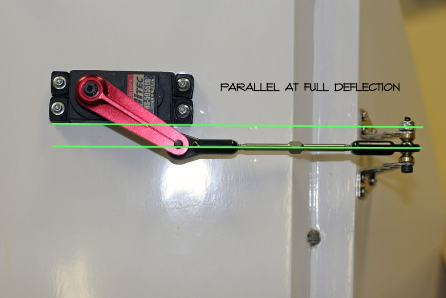

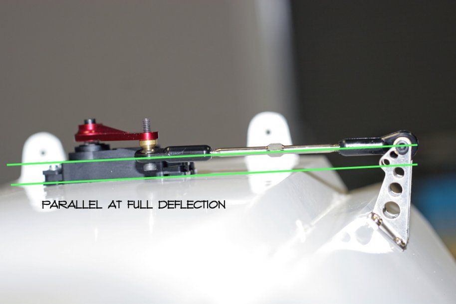

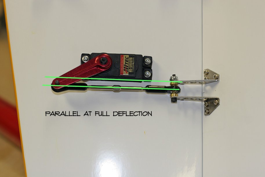

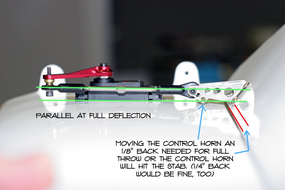

Here's what I'm looking for in terms of leverage and side load vs pry load:
View attachment 43665 View attachment 43666 View attachment 43667 View attachment 43668
Notice too, that I have my control horns wide spread for conicals. This should be standard, too.

I fully understand how servo geometry works. I'm not going to get into a brand war, just saying there are ARF mfg's that actually do the math for horn location in relation to the servo. However even doing that they need to leave it somewhat flexible for different setups. There are also mfg's out there that use threaded rods for horns. I've built ARF's from every mfg. sold in the USA (short of some of the small fanboy supported POS planes and also not any composite planes). Very few will "fine tune" for one specific setup because people use all kinds of different servo arm options. There are also people who choose to use 1" arms because they only fly a certain way, 1.5" on wings because it's typical, some use 1.75 on wings, and on the tail feathers anything from 1.5 to 2 is typical depending on flying style.
For this reason, many times I will CNC cut my own custom horns, especially on the ailerons, for dual servo ARF's. You can't easily change the placement, but it's easy to change the height and depth of the arm if needed (if you have options to make your own).
Like Stangflyer mentioned, this is where the servo balance feature in transmitters comes in extremely handy. I used to fly JR and switched to Spektrum after they moved away from DSMX (too heavily invested in receivers). With this feature you set your max throw and best geometry you can on the inside servo, then match the outside servo as close as possible mechanically and using servo travel adjustments. Then fine balance the outside using an amp meter and the balance feature. This is quick and easy but it does point out the mistakes with horns that are not visible without doing some math.
