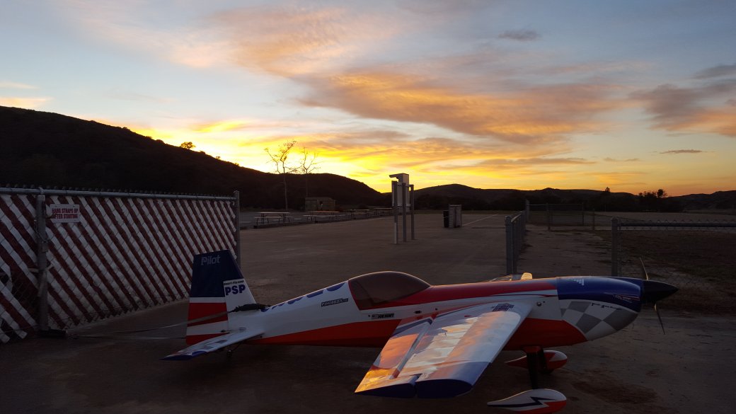

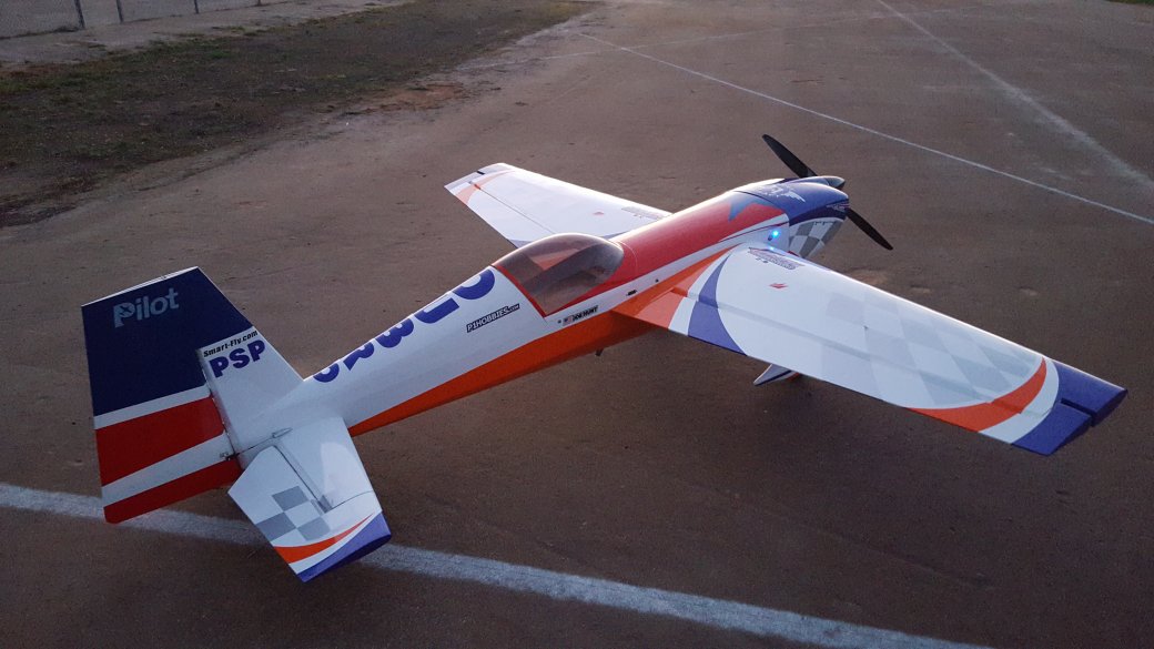

Flew in a t-shirt until 6pm... not a breath of wind... this plane really loves no wind... anyway, it was awesome. Funny, I now have as many flights on it with a red hatch as I had on the stock scheme. lol
Fly until you need to use your IBEC light to find your plane. haha
