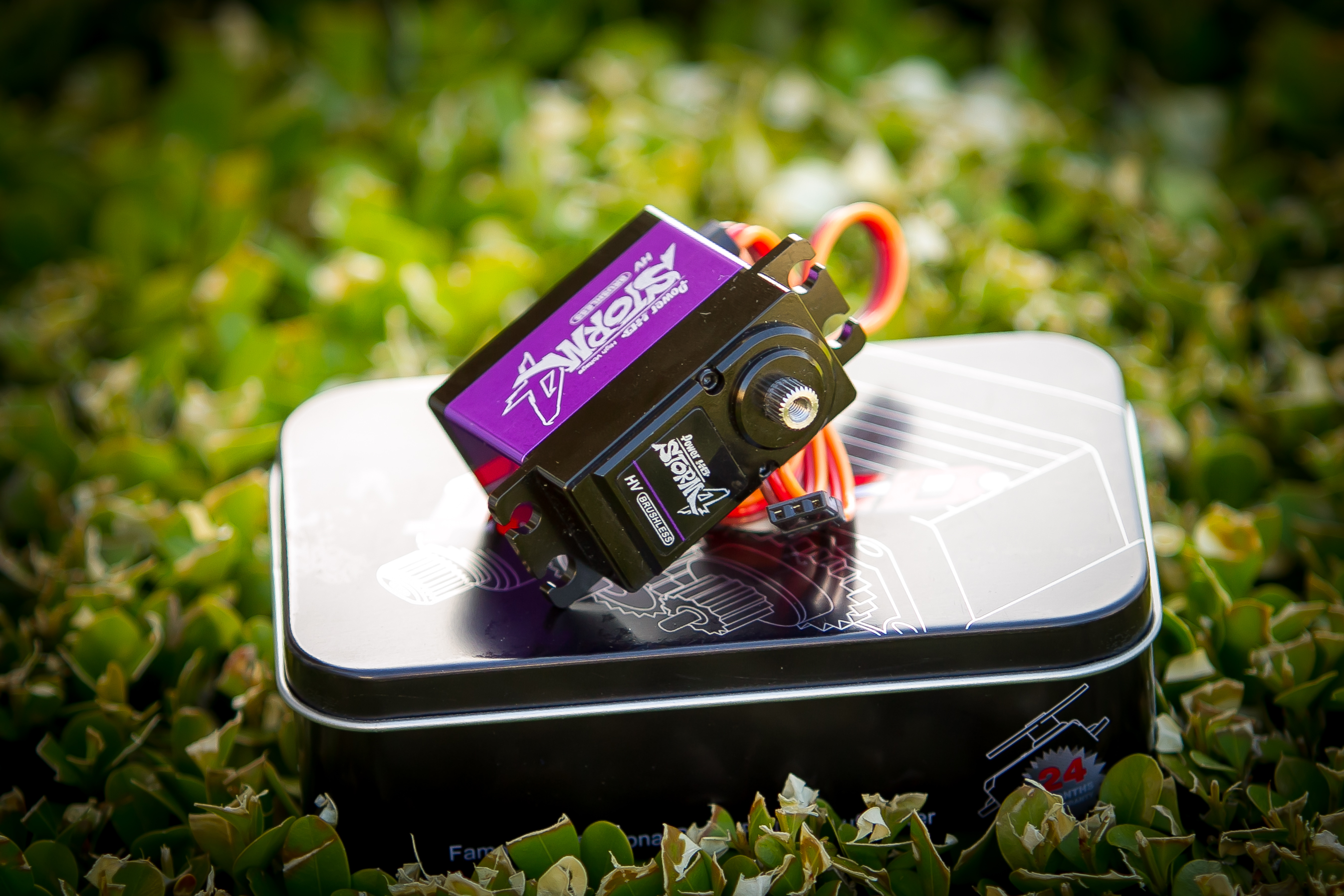

Hey guys, I got my hands on an amazing new servo. I'm going to be putting it on the rudder of my 50cc Extra 300. I'm using the Redwing Pro Series red powerbox which is perfect for running high voltage servos because it keeps the voltage to the RX at 5v while sending full battery voltage to the servos. Unfortunately the rest of the plane has XQ Power 4020 digitals that can't handle high voltage, so I'm using two 6.6v LiFe packs.

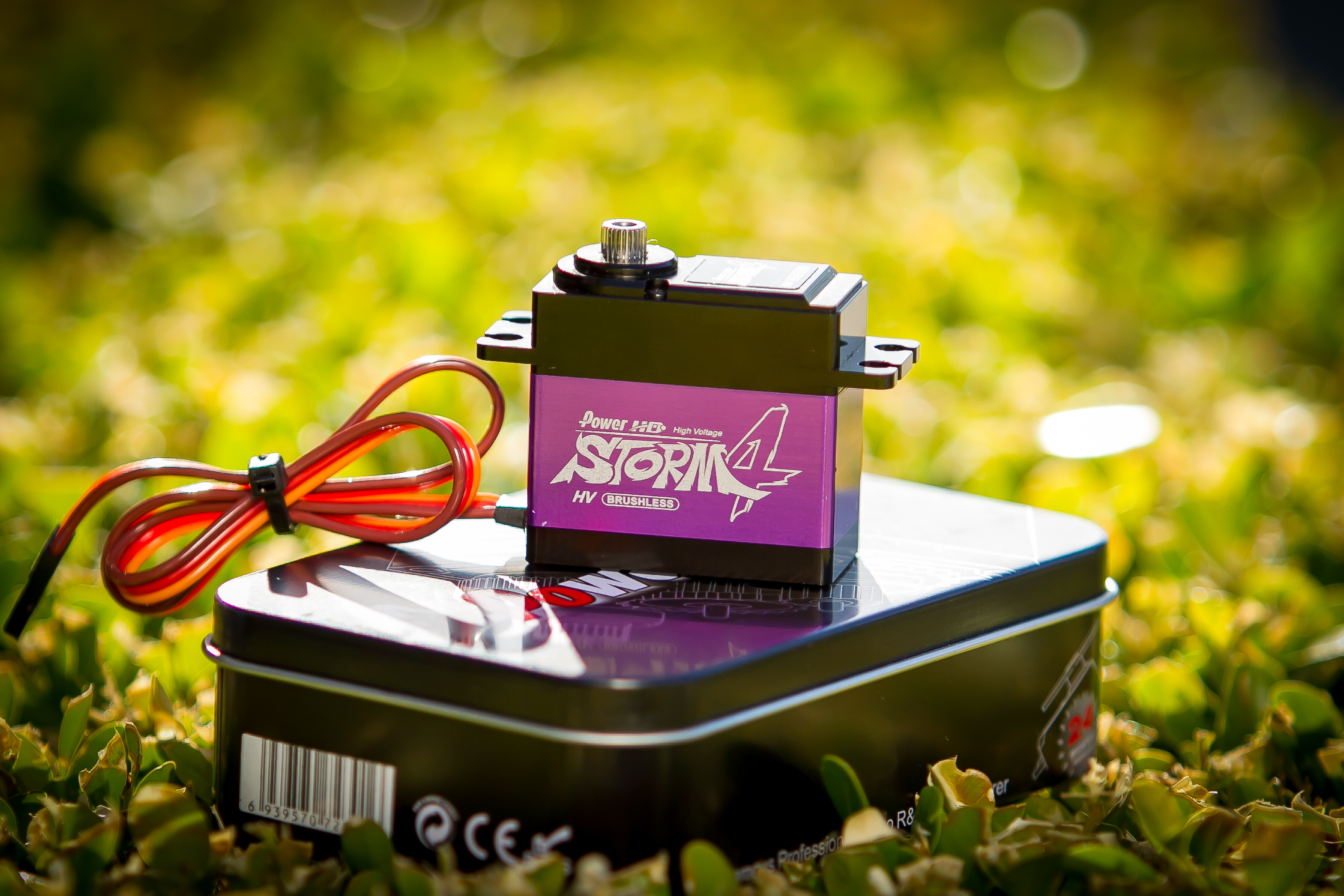

This brushless servo is a pretty impressive unit. The entire exterior is solid aluminum. No plastic covers on the top or bottom. I've had to get replacement cases for servos that have been through a crash, but I don't see this happening with the Storm 4. It's got titanium gears, dual ball bearings on the shaft (absolutely no play in this servo) and is fully weather sealed.
The specs on the Storm 4 are pretty impressive. At 7.4v it puts out 347 oz/in of torque and the speed is .085 sec! At 6v it produces 291 oz/in and the speed is .10 sec. Still pretty respectable.
One of the coolest aspects of the brushless servos is that they are efficient. Unlike strong digital servos that consume large amounts of power, the brushless servos only use the amount of power needed to perform the movement signaled by the radio, but no more. So since these HV servos use much less power, smaller and lighter LiPo flight batteries can be used.
Since the Storm 4 has similar power and speed ratings at 6v as my XQ 4020, I wanted to see the difference in how they operated next to one another. I put them on a board and checked some movement. The brushless servos are said to operate smoother, and from what I can see, it's true. The Storm seemed to be in perfect sink with what my stick movements were while the XQ had some variation. The XQ hesitated on initial movement, then moved quickly to catch up. It just seemed to move a little, slow down, then move again to catch up. It did the same thing coming back to center. It would get close, hang up, then drop down quickly. The Storm's movement was very smooth and linear. It's also darn near silent. No buzzing like digitals. Both servos come back to center perfectly.
