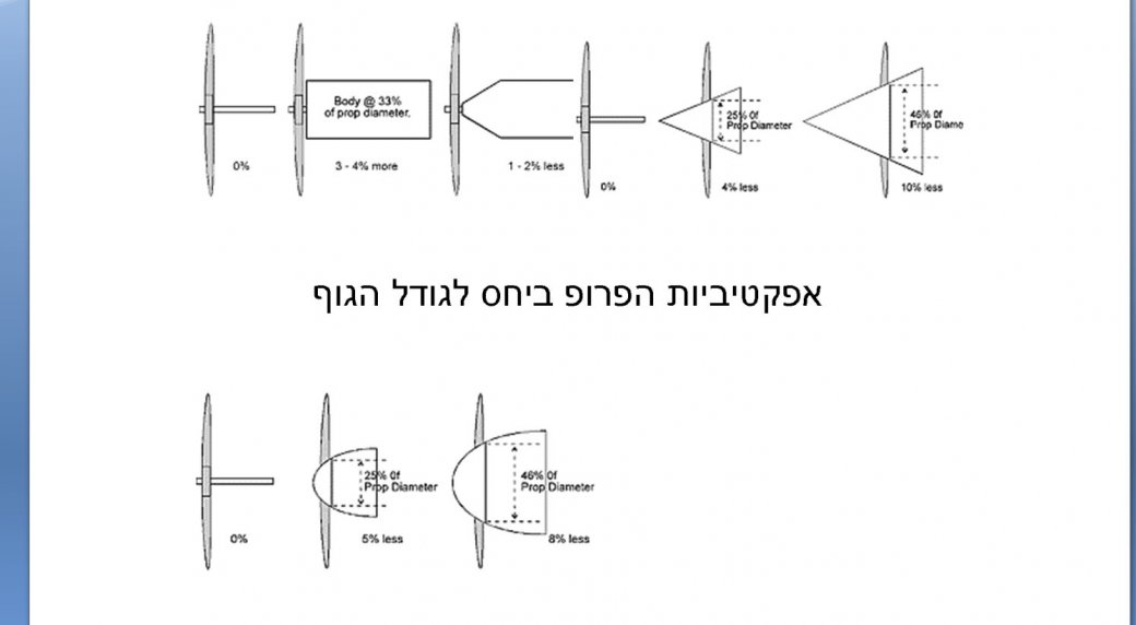

Yes, I had a 30x12 on my Solution and it worked fine. But on the Yak it just did not cut it. Have been thinking that it may be due to the large cowl on the Yak and the extra 2" out past the cowl.

Now I'm flying with a different engine, much bigger in a different but same concept plane.
Its the Krill SU 29, and the prop I've seen and try that does the best work for IMAC was the 32-12, for 3D the 31-12.
See the file, its a myth baster as for large cowls.
So thats why the 32-12 is best for that Krill SU 29, big round cowl, the prop Di is bigger than the 33% of the round cowl.
