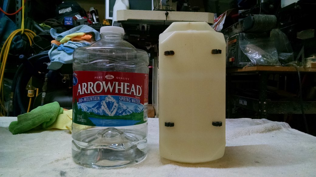

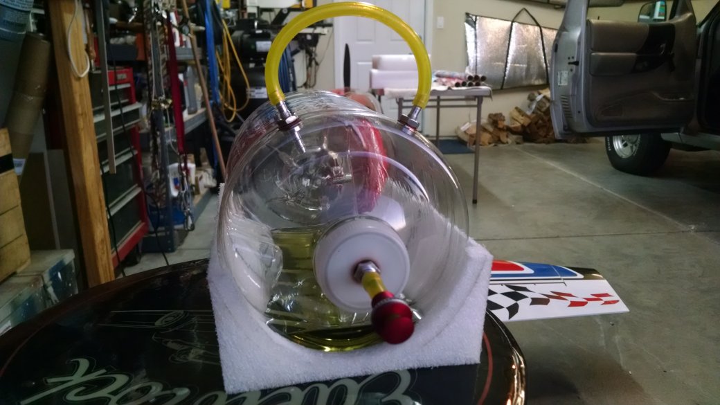

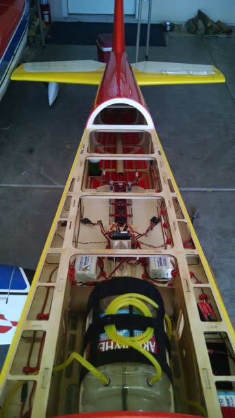

I made my water bottle tank a little while ago,,, very simple to do. 101.4 oz water bottle, PSP fittings and the 1/4in. feeder nipple from McMasters
