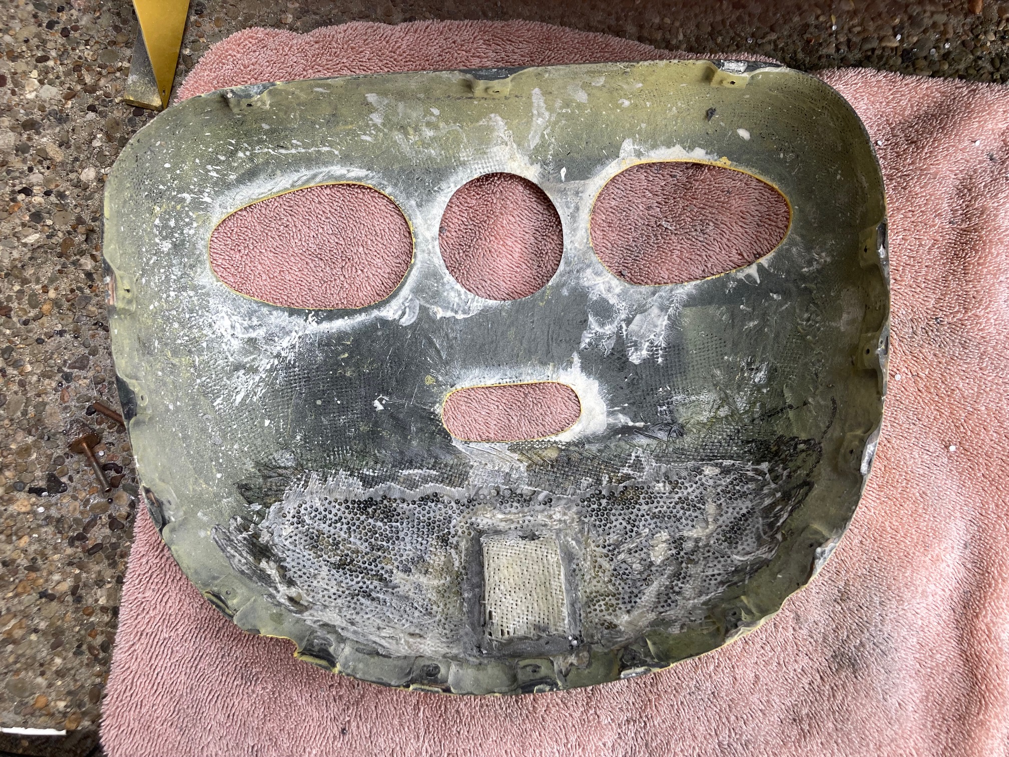

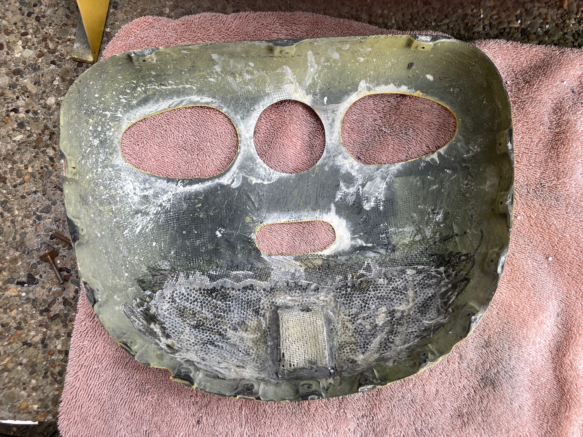

Quick update on the Champ. Last time out had a bad landing and blew out one of the DuBro pneumatic 5 1/2" tires. I've given up on the idea of pneumatic tires and switched to Sullivan 6" Skylite wheels. The 38 pound per inch landing gear springs seemed a little soft so 50 pound per were ordered and installed. Added 2 degrees washout to the wings by adjusting the lift struts, added aileron to rudder mix, dialed in more aileron differential, removed 1 pound of the previously added 2 1/2 pounds. Two flights yesterday each about 5 minutes, getting better. Plan to remove move weight that was added next time out. Pretty sure I over reacted adding the weight, the flights yesterday convinced me that tail heavy condition was not the problem.
I can summarize the control as sluggish then all of sudden overcontrol. The Roto 85 runs great and sound greats, have a total of 4 temperature monitors on the cylinders, 210f was the maximum reached yesterday of course it was a mid 50's day. If weather cooperates may get another flight in this year, wore my arm out propping on the first start!
