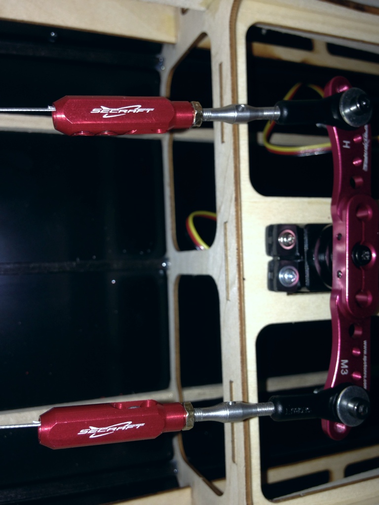

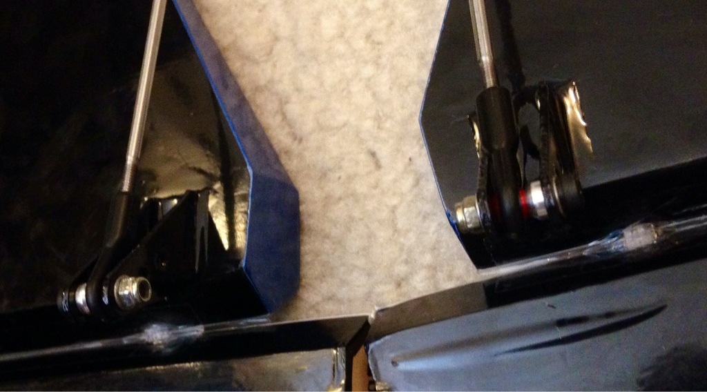

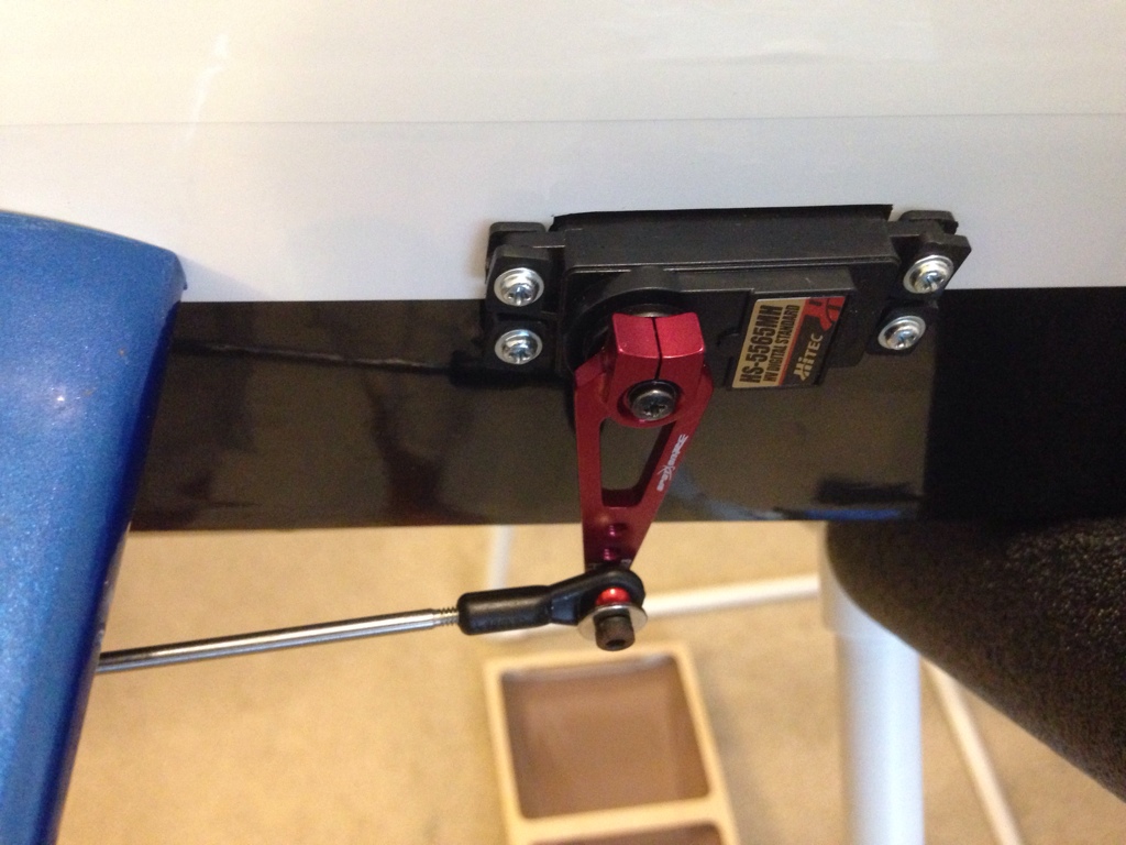

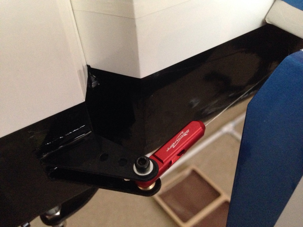

Ok, time for the servo install. Got them all done, and put some bling on too! Got the [MENTION=388]Aztech Aeromodels[/MENTION] goodies, including the Spot-on arms all around, matching red ball links, and the Secraft Tensioners for the pull-pull setup; also did a permanent install on the Secraft removable rudder turnbuckles. I like these much better than the factory ball links with brass eyelet for the wire. These don't have any sharp edges that can wear through the wire over time. Another awesome feature is that it's really simple to keep your wires tight as they relax over time. And, last but not least, they look bad ass. I went with the red to provide some contrast to the plane.

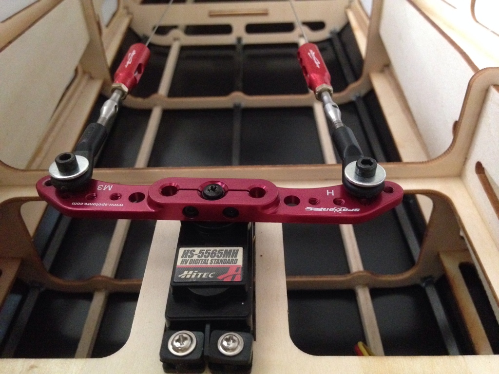

Clean and good looking pull-pull install.

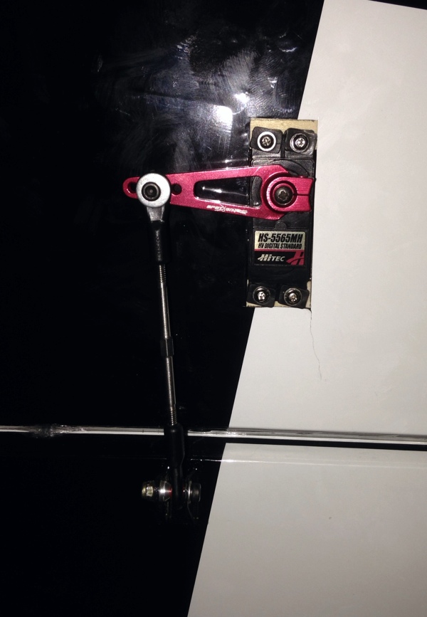

Flashy red arms and ball links

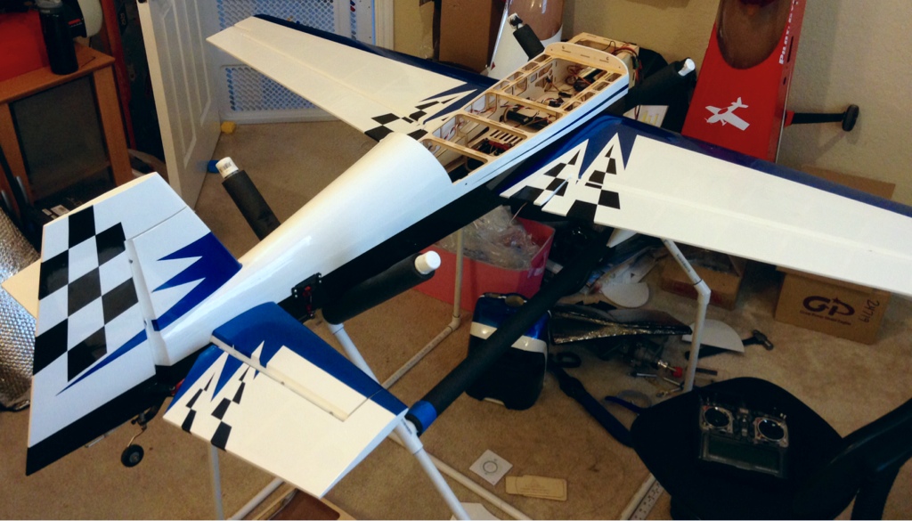

Got all the servos installed and setup on the receiver. Test fit of the wings and installation of the stab went perfect.
