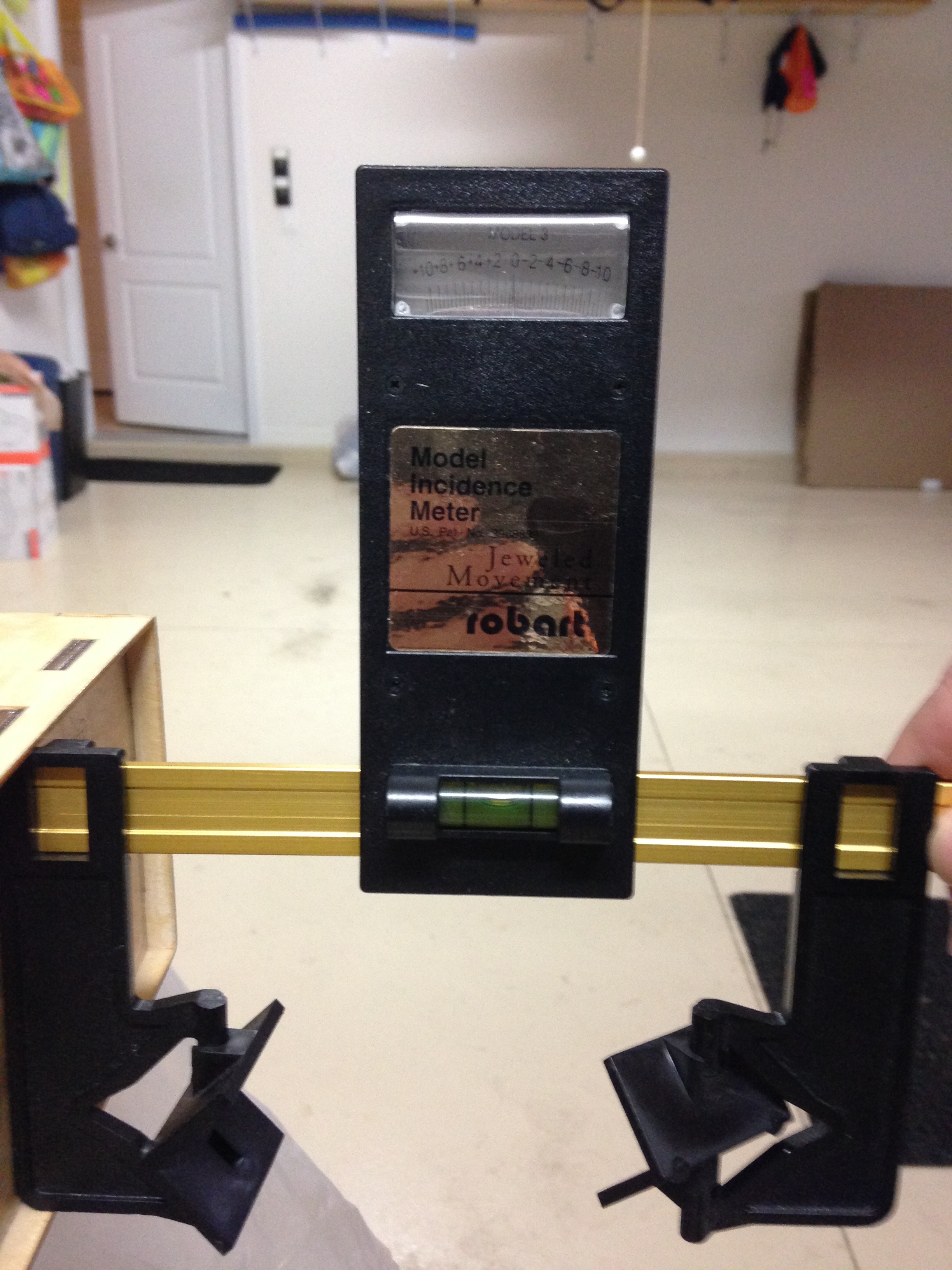

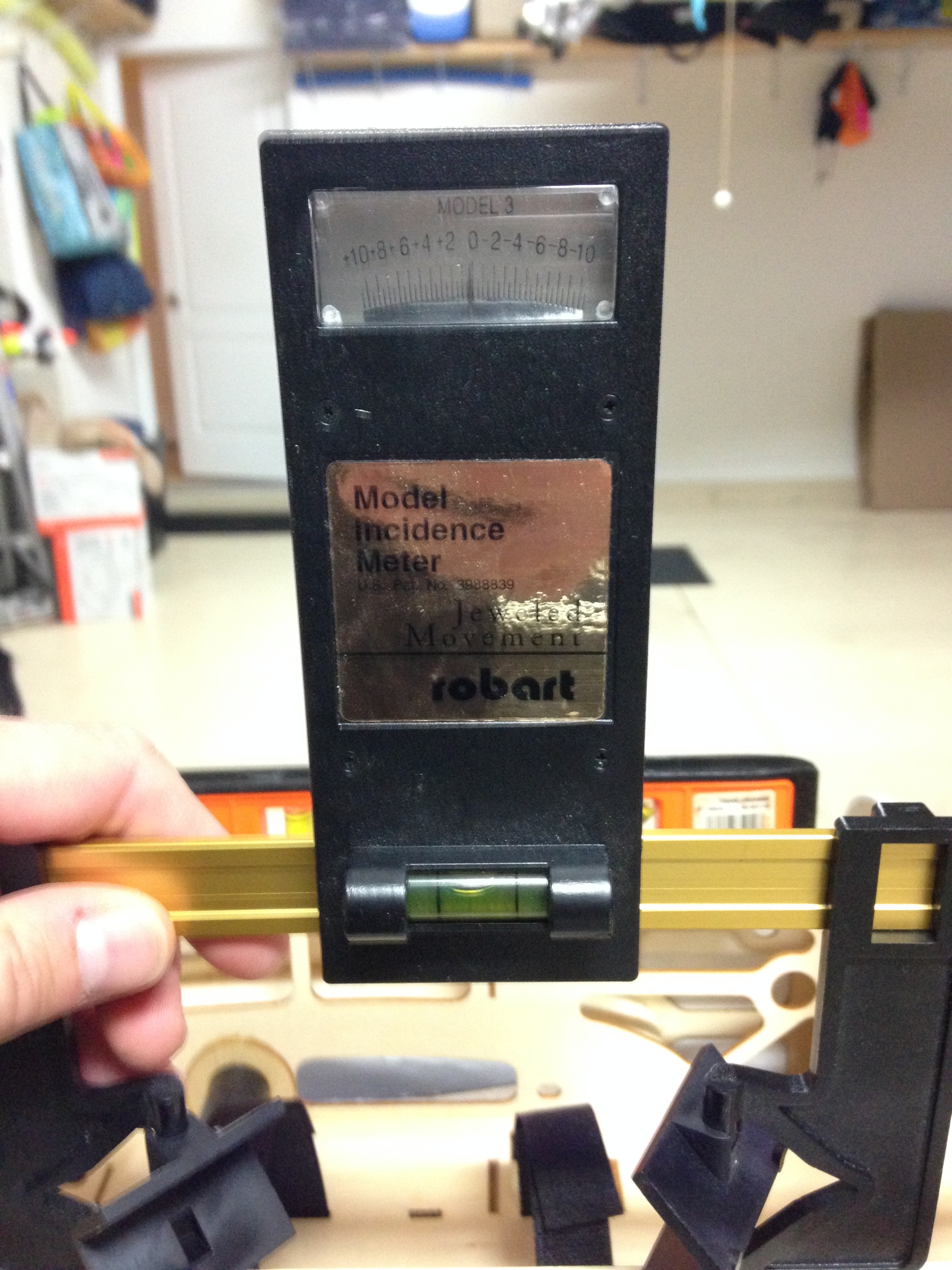

Did you have to add any upthrust to your model. I believe your serial is 105 and mine is 106.
Redwing produced an upthrust mod video for the 30cc. Some of the Extras did not have the required upthrust built into the firewall.

We hadn't done the mod yet in that video.
I've done the mod now, and I'm working on getting it dialed in

Do you think it needed the mod?? Im starting on my plane next week, and would like to drill the holes 1/4" lower, assuming all the planes need the upthrust.

I think it's worthwhile to do the mod... but I need a little more time to get mine working for me the way I like. I hope to get some work done with it Friday

No problem. The way I did the mod with washers, so I can easily adjust. Maybe that'll work good for you too, so you can dial it in

Have you flown your extra any more since the upthrust mod?? I'm curious of your results as I'm following a thread on rcgroups that talks about it as well.
Did you confirm that your plane did not have upthrust installed? Tim thought it was only an issue with <#100, however I checked mine and it appears to have zero upthrust. I have #106 and I beleive you have #105.
