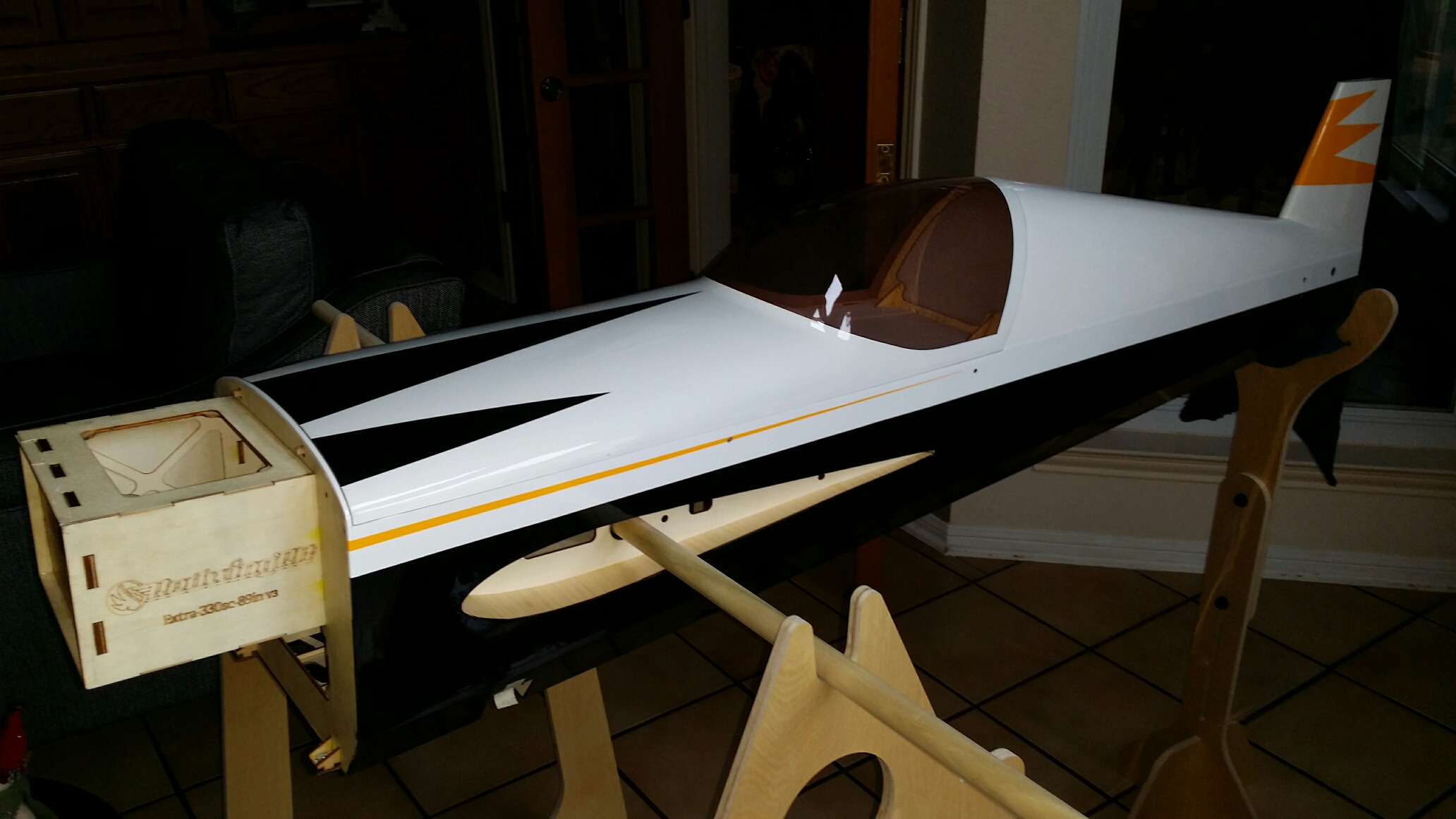

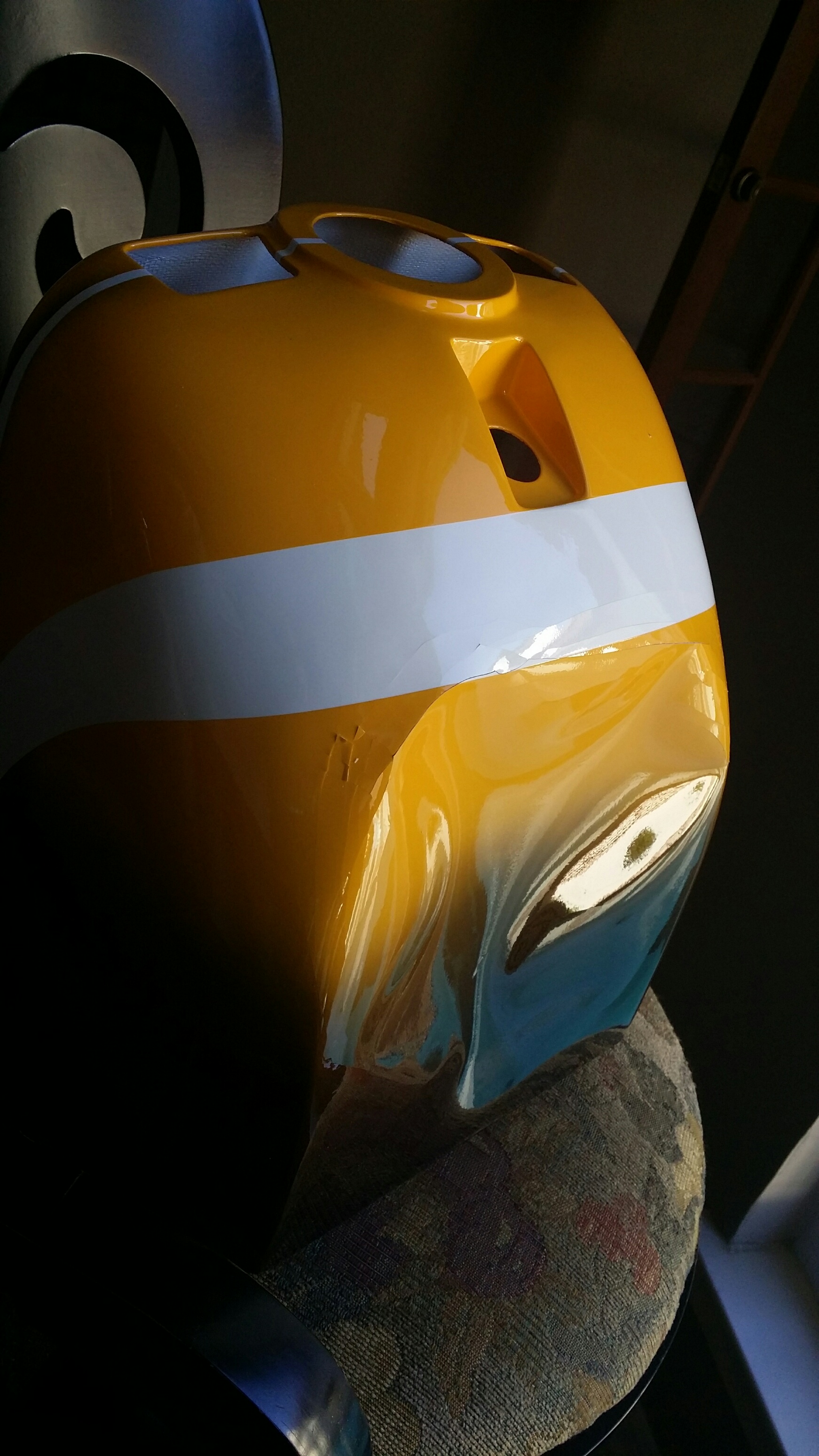

I decided to begin the build today. I am still waiting on the replacement cowl but that could be awhile as Redwing is shut down due to the flooding going on in their area. In the mean time I can get everything else going. I put it on the stand today went over all the joints with CA and thinned some epoxy and reinforced the inside of the motor box. Next up is ailerons, elevators, and rudder.
Cowl was crushed during shipment.
Here is what is going into the plane:
Motor: EME 70 (Yes, Bipenut talked me into it) :thumbup:
Servos: XQ 4020 (I have these in all of my gas planes)
Receiver: Spektrum AR8000
Electrics: Electro-Dynamics A123 battery, dual output switch with charge port and optic kill. (I have this setup on the YAK and love it for being simple, lightweight and easy to charge)

Boy that cowl did take some damage.... That's too bad!
