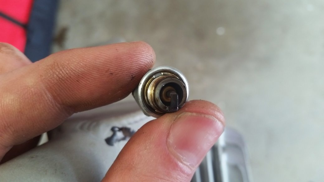

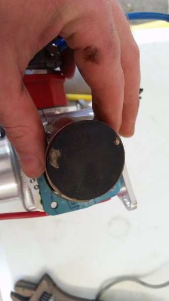

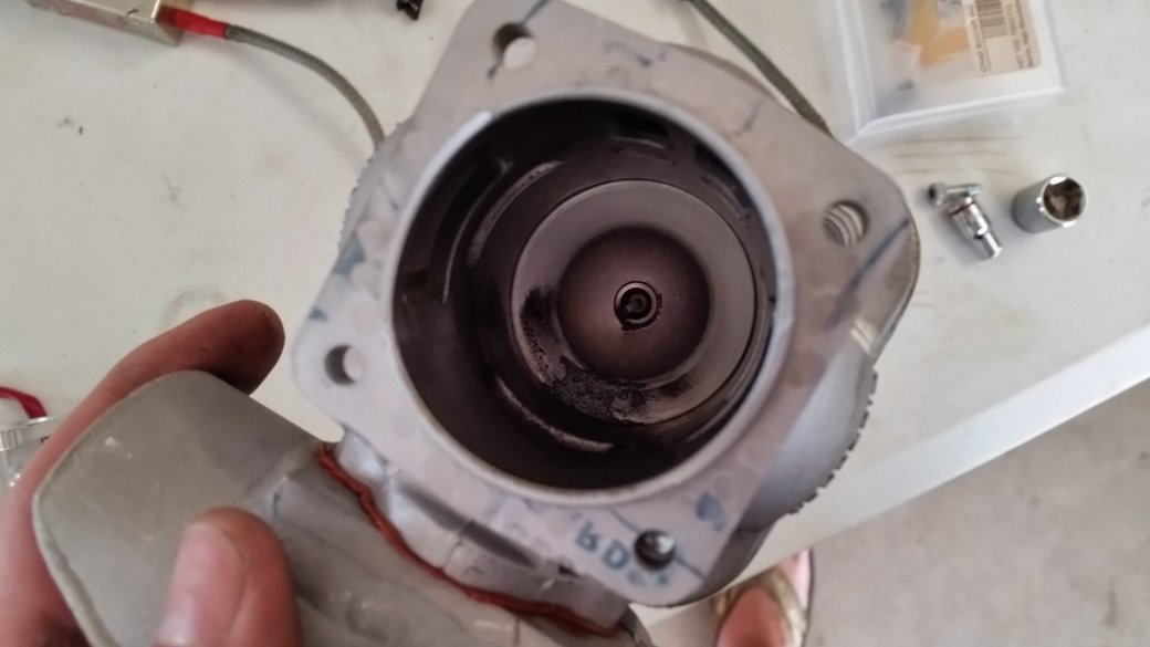

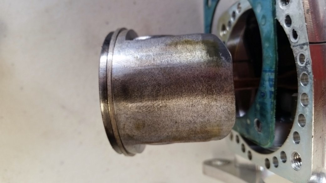

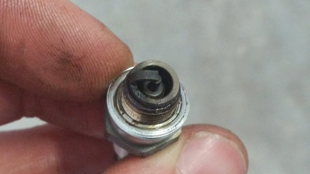

Okay, for fun I decided to pull a cylinder off of one of my DA120's. This one has been run exclusively on Stihl HP and has in the ball park of 150-170 flights over the course of about a year and a half. The engine was on my slick which I took out of commission back in October of last year. I ended up selling the airframe a few days ago to make room for a new one :). Any how, I have another DA120 that was recently returned from DA with 2 new pistons and cylinders in my PAU edge and has been flown exclusively on Redline since its return. It has roughly 35 flights since returning from DA. When I get 150 or so more flights on it, I will pull one of the jugs off for comparison to the pics below. I also plan to keep track of this engine on its new airframe and pull the same jug off in 100 or so flights to see if the redline cleans up any of the carbon deposits on top of the cylinder and piston. The cylinder below is the rear cylinder/piston. I also put a pic of my plugs on there for sh!ts and giggles. The desert tan plug is the rear one and the chocolate brown one is the front.
