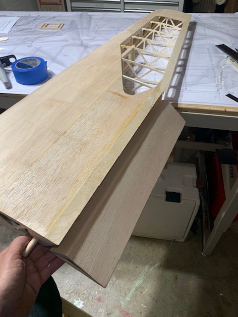

Tony, I put a piece of trinagle stock underneath 30, it seemed to fix the issue. Anyone seen a wing that has part of it not sheeted like this? I plan on using Ultracoate or something similar. Any suggestions on what type of covering to use?

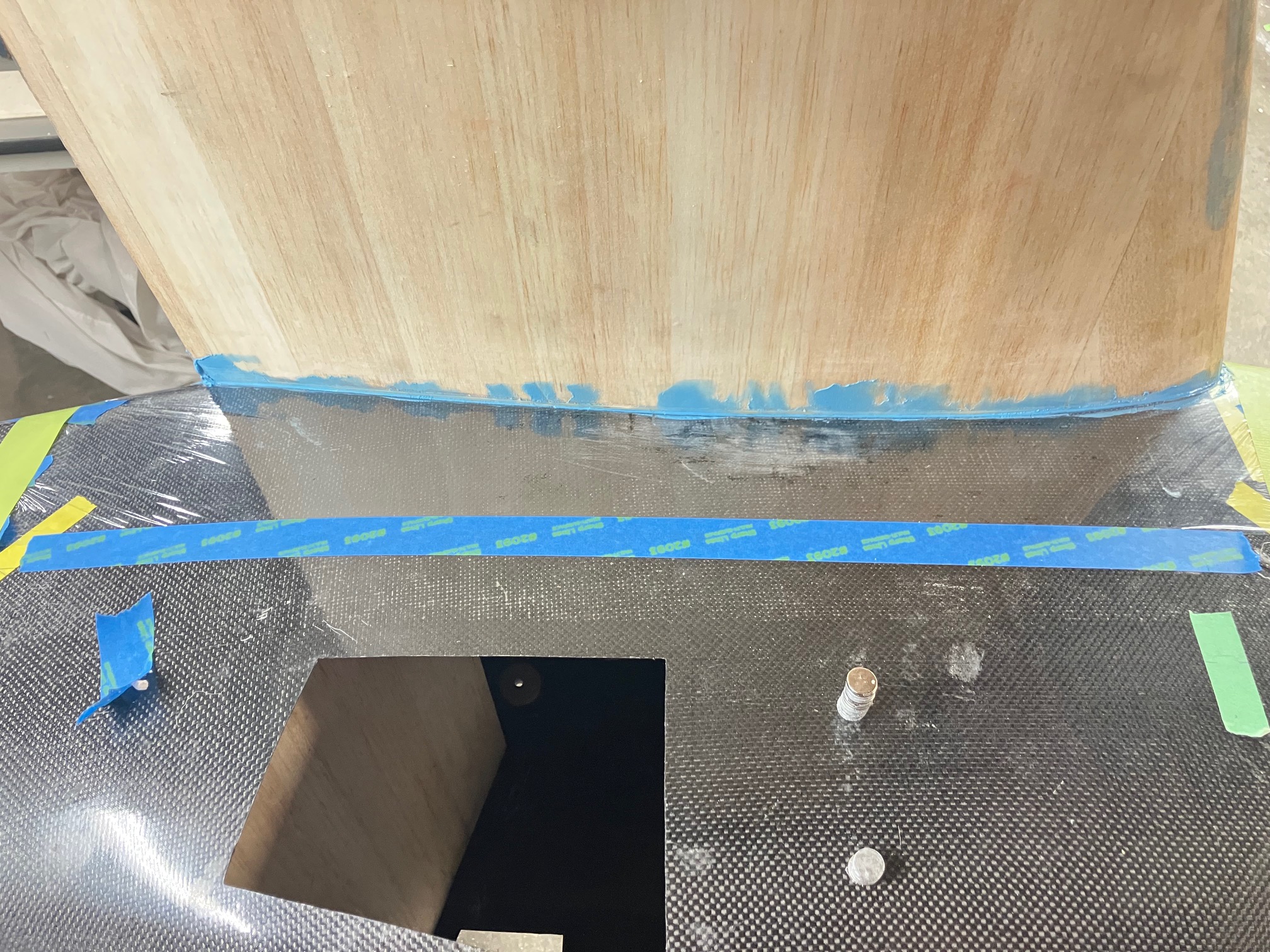

I would finish the wing, mount the wing with plastic wrapping film install on the wing, then fill the gap a Bondo like product or epoxy thickened with microballoons and chopped fibers. You will want to add dams around the wing dowels and bolts to prevent sticking. Here is a photo of the Cherokee wing, I did the opposite, plastic film on the fuselage, installed the wing, I used Superfil to fill the gap. Superfil is a thickened epoxy product. You can do the wing of the fuselage, your choice. If you do the wing, make sure to use something easy to sand.
