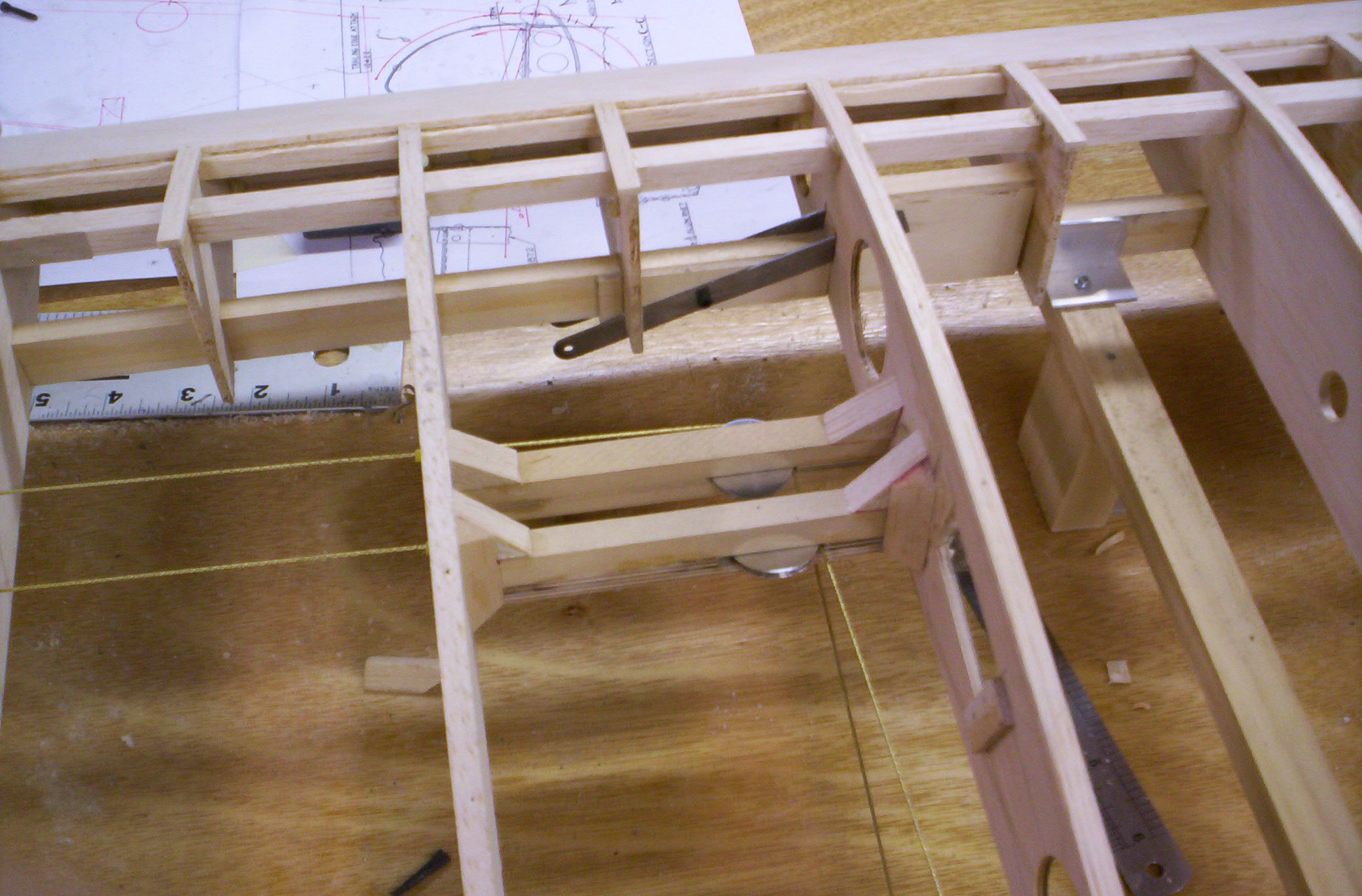

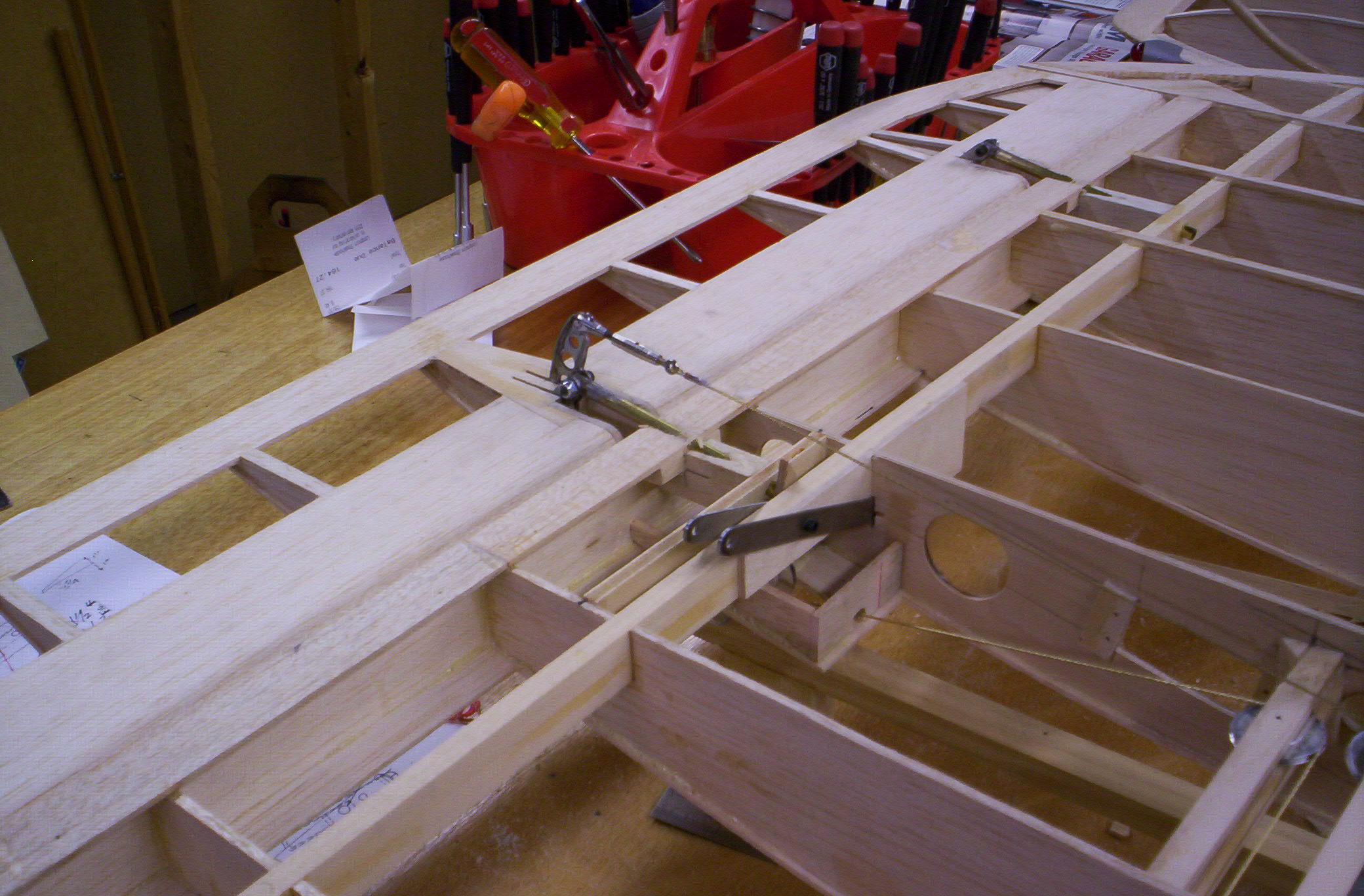

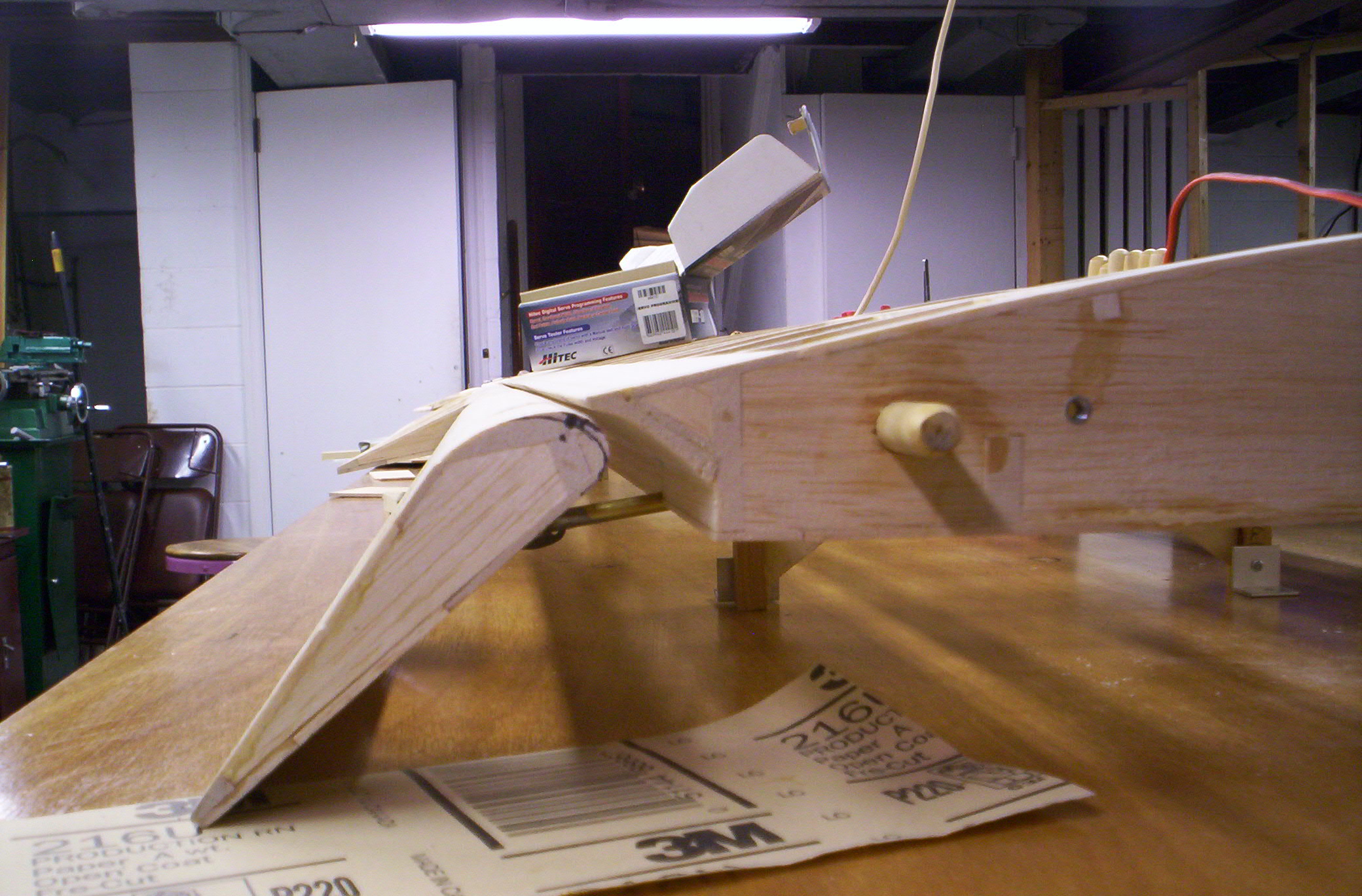

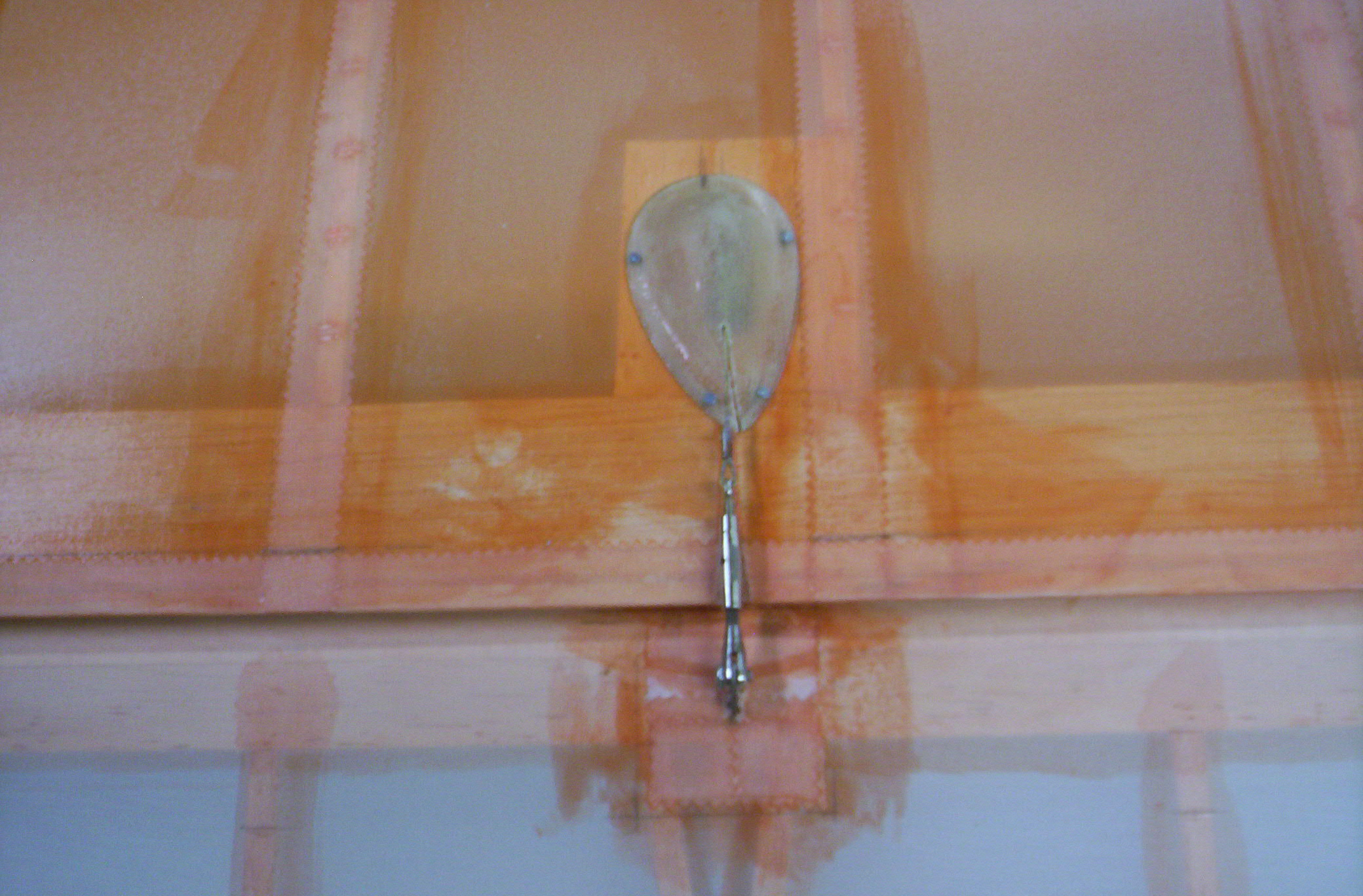

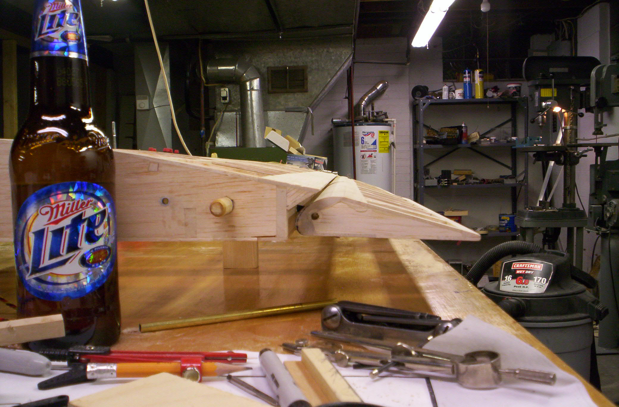

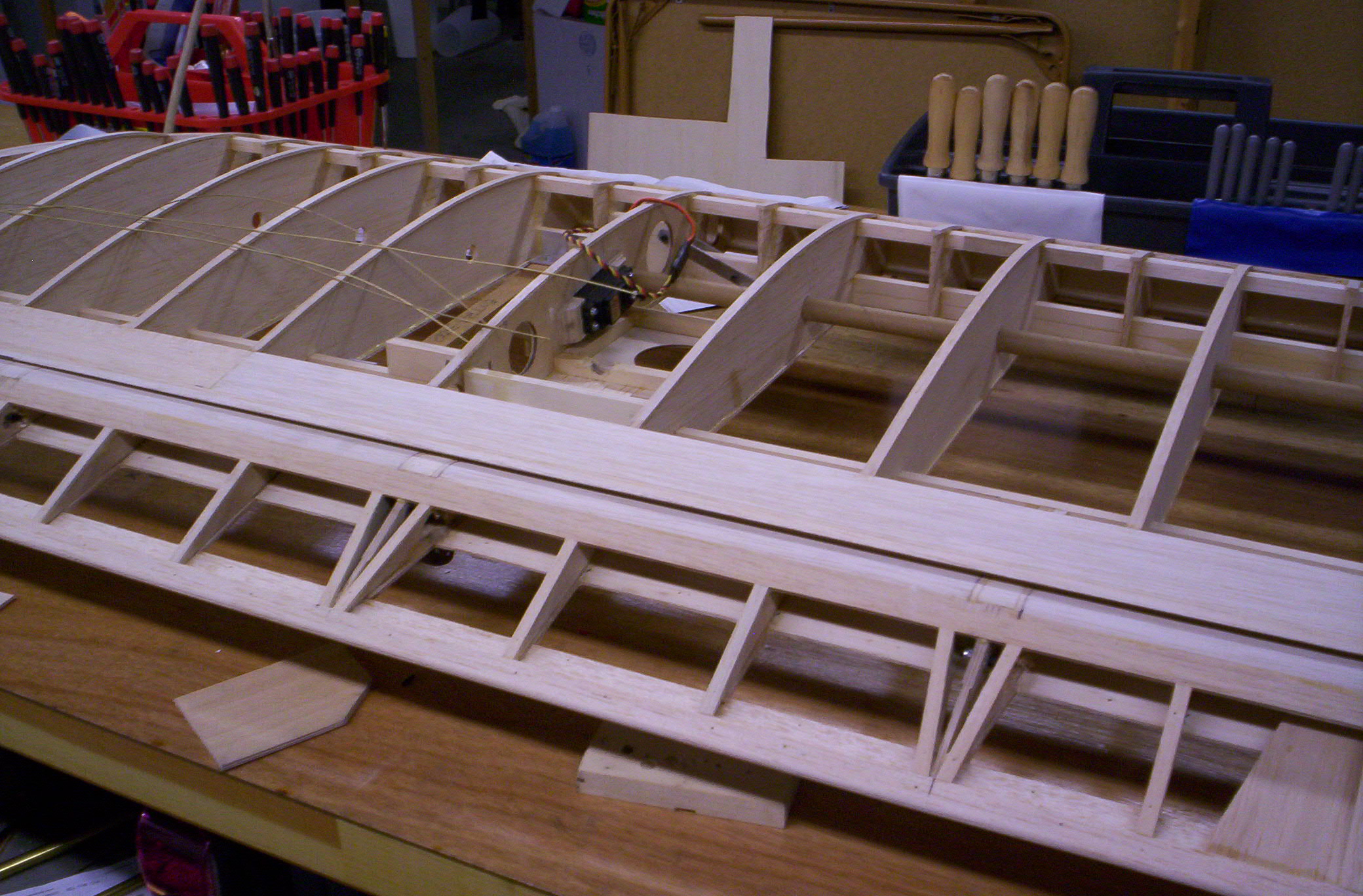

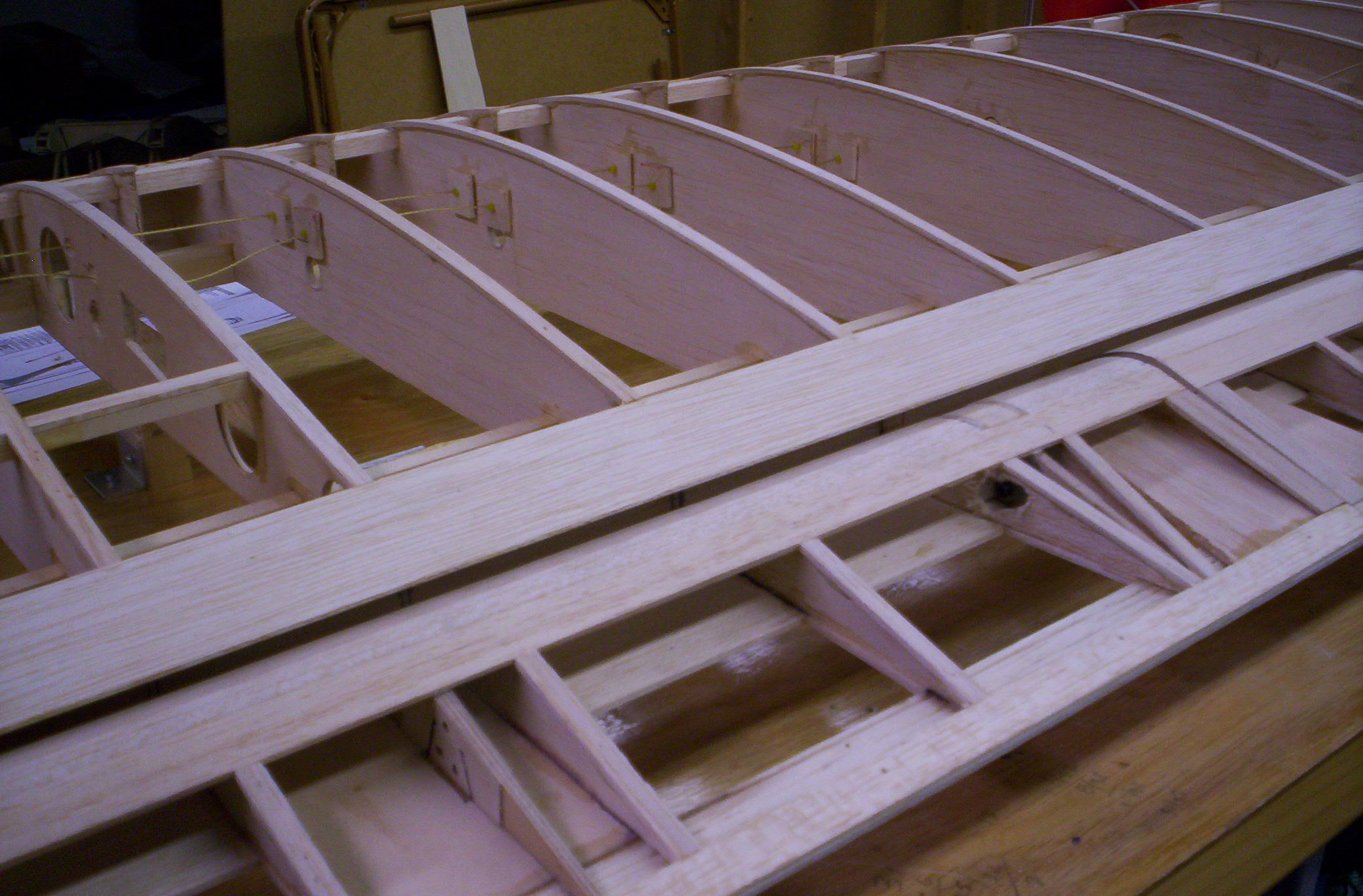

The attached photos shown the scale ailerons and flaps. You get the balsa, plywood and metal in the kit. You will need to shorten the aileron kit for the flaps.

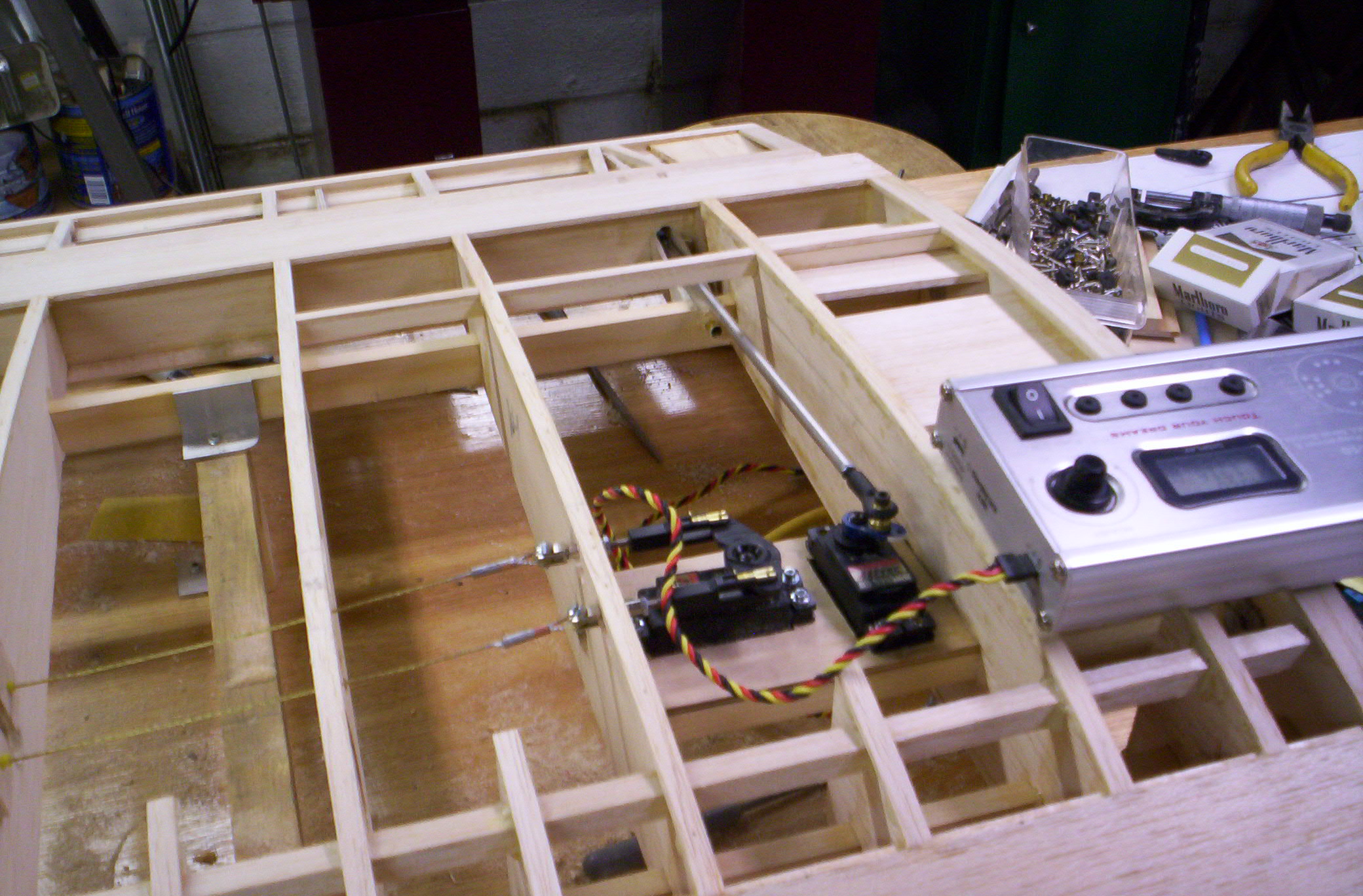

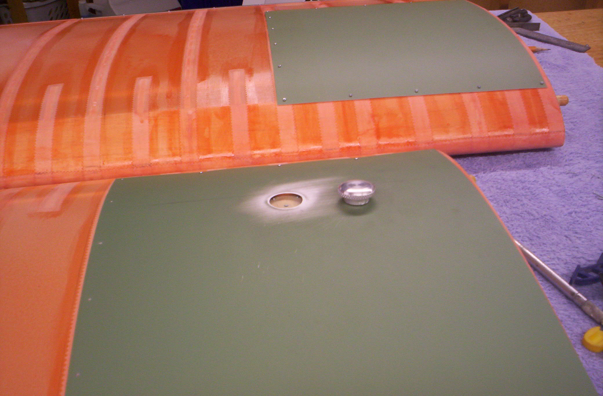

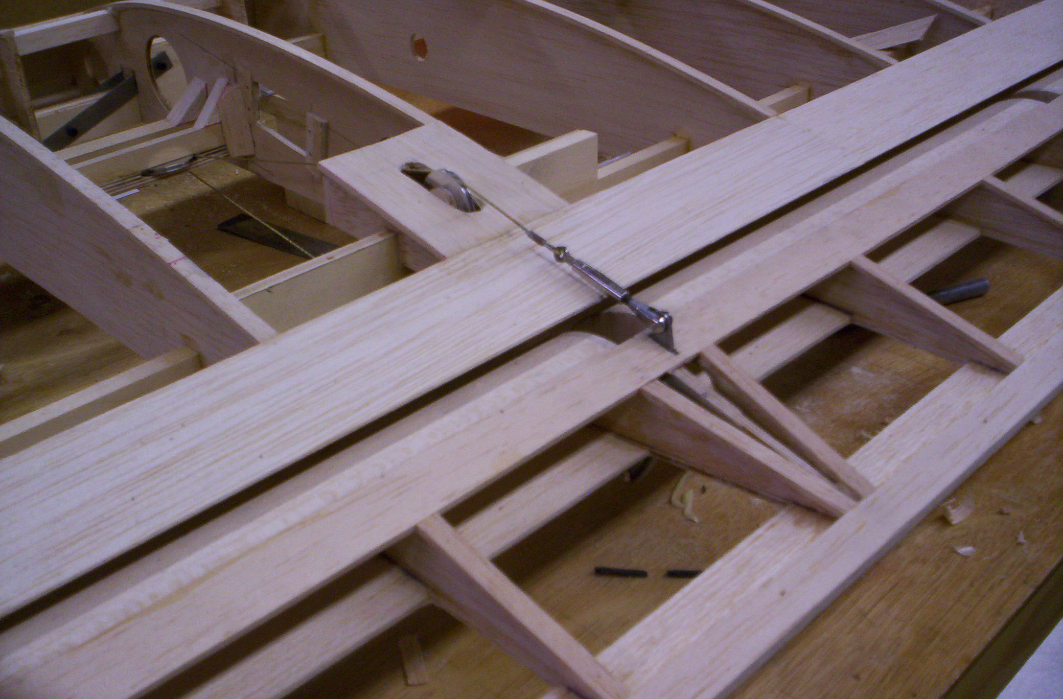

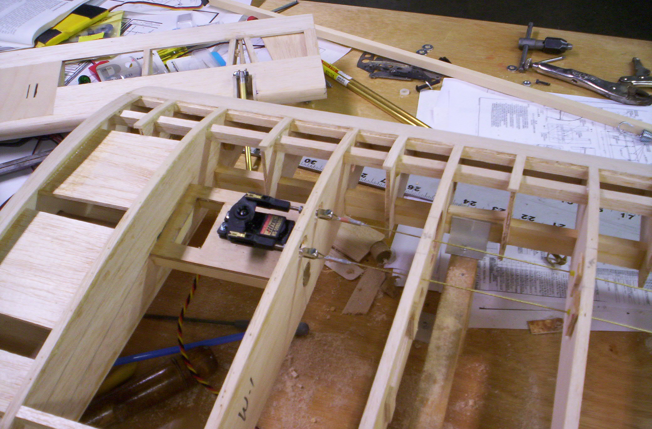

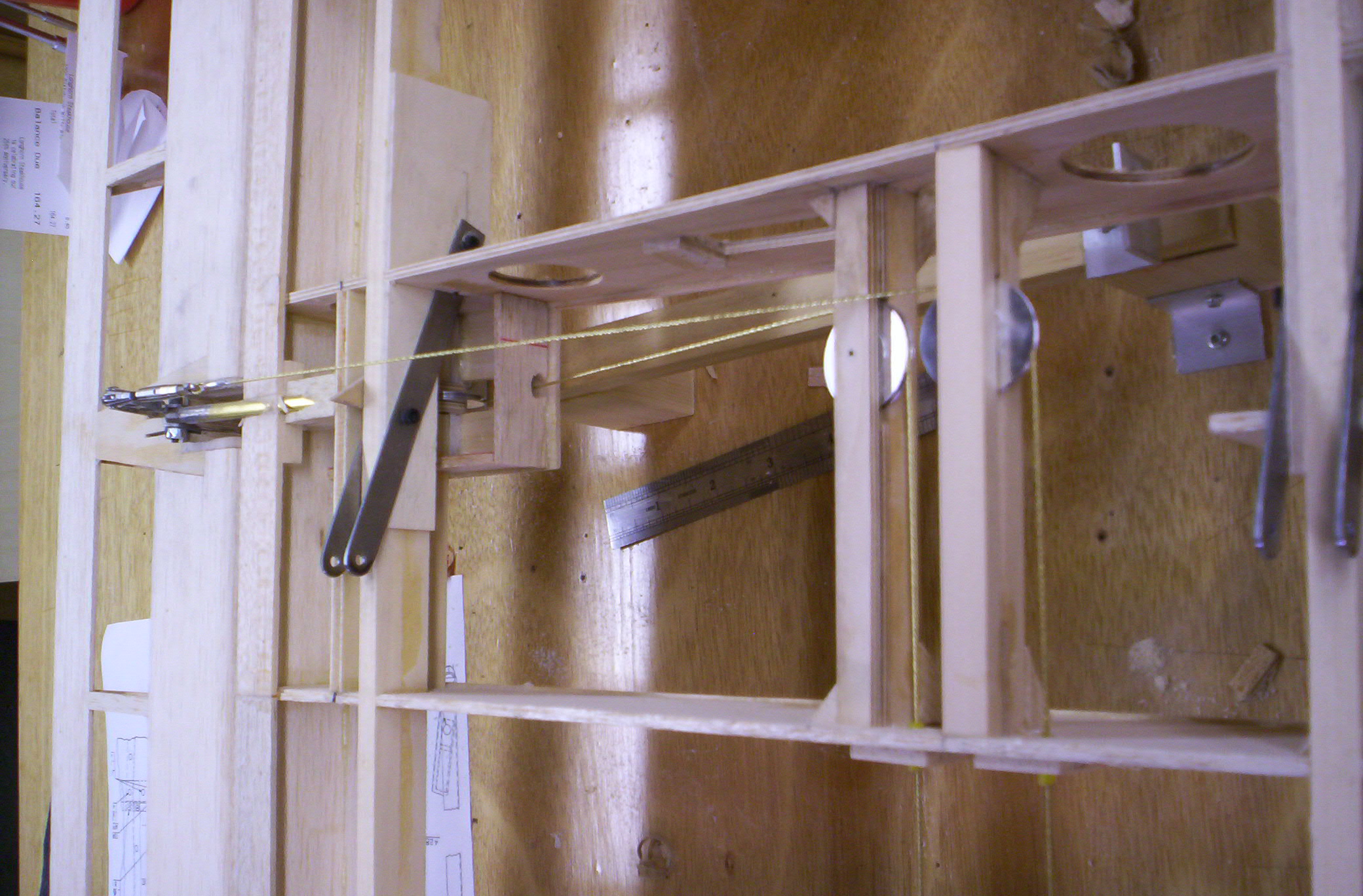

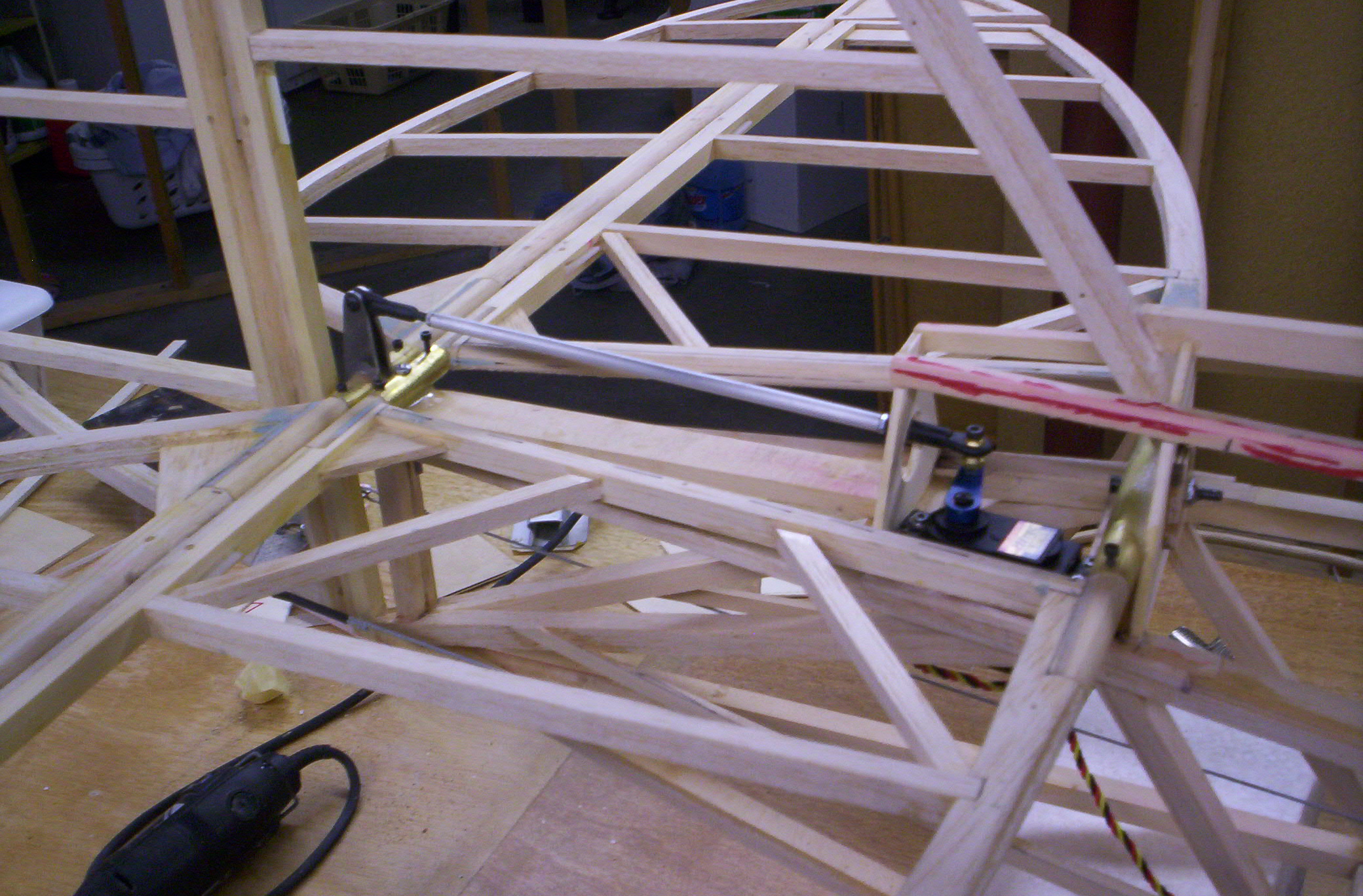

I mounted both the flap and aileron servo under the fuel tank cover near the root of the wing. The aileron is a pull-pull arrangement with scale horns, the flap is push pull hidden in the wing.

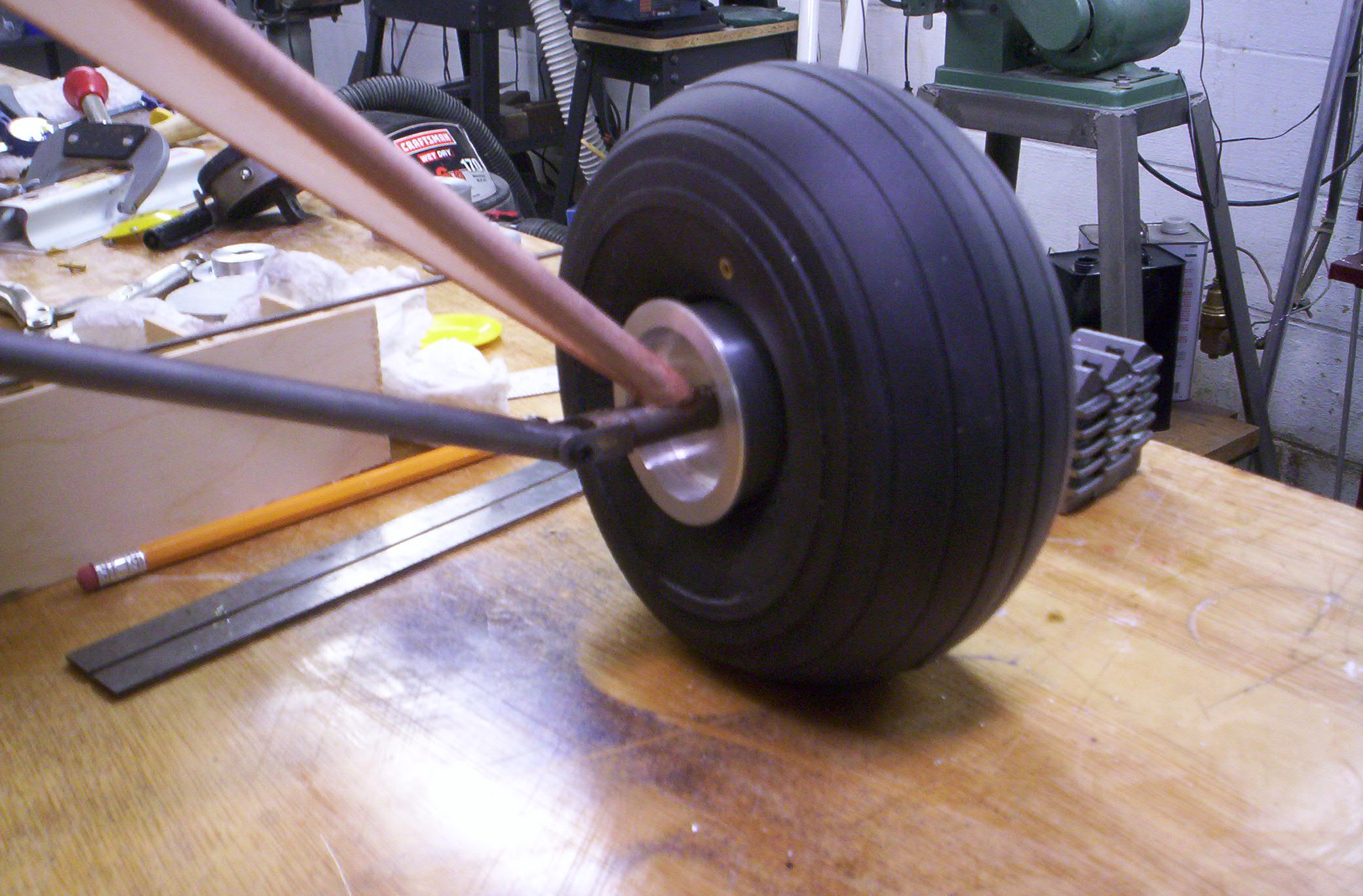

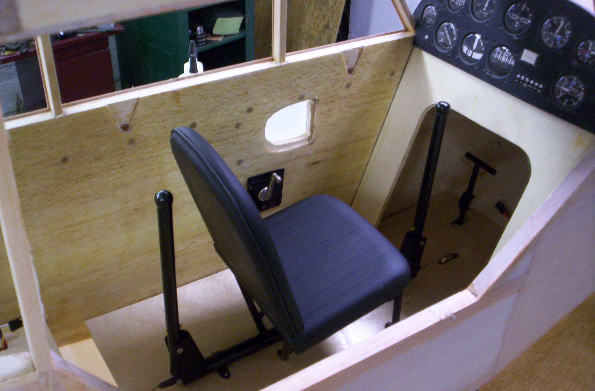

The kit contains the wood and metal parts to build and hinge the ailerons. The controls are provided by the builder. When I first built the plane I was using under wing controls for both flaps and ailerons. As the build progressed and more scale detail was added, I decided to go back and made the controls more scale like. Attached are some examples of what was added.
